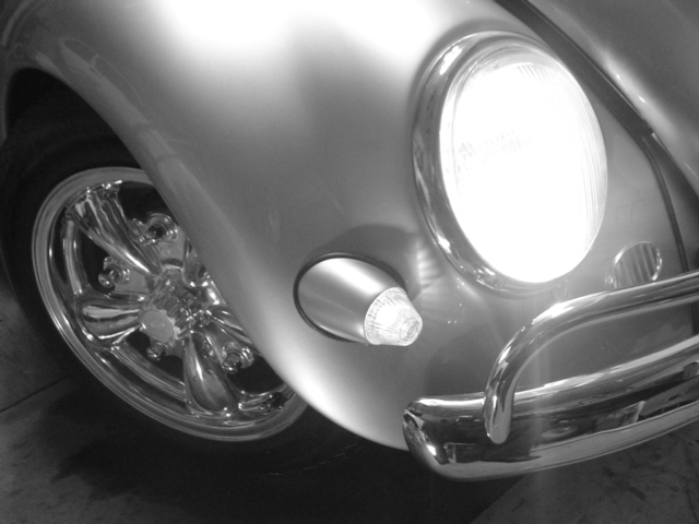

Unless you are going for 'original' look, don't worry about those front turn signals. I have a 70 vert I'm going to use NOS bullets. I HATE those wrap around..........just plain ugly!!! If they would have done something like Porsche with the smooth rounded signals, that might have not been so bad.
JMHO, I think the bullets look good.

Yes, I am kinda leaning with the bullet indicator. I do think they look better as well. Just a personal opinion. When it comes time to paint I'll have to seal off the hole.
