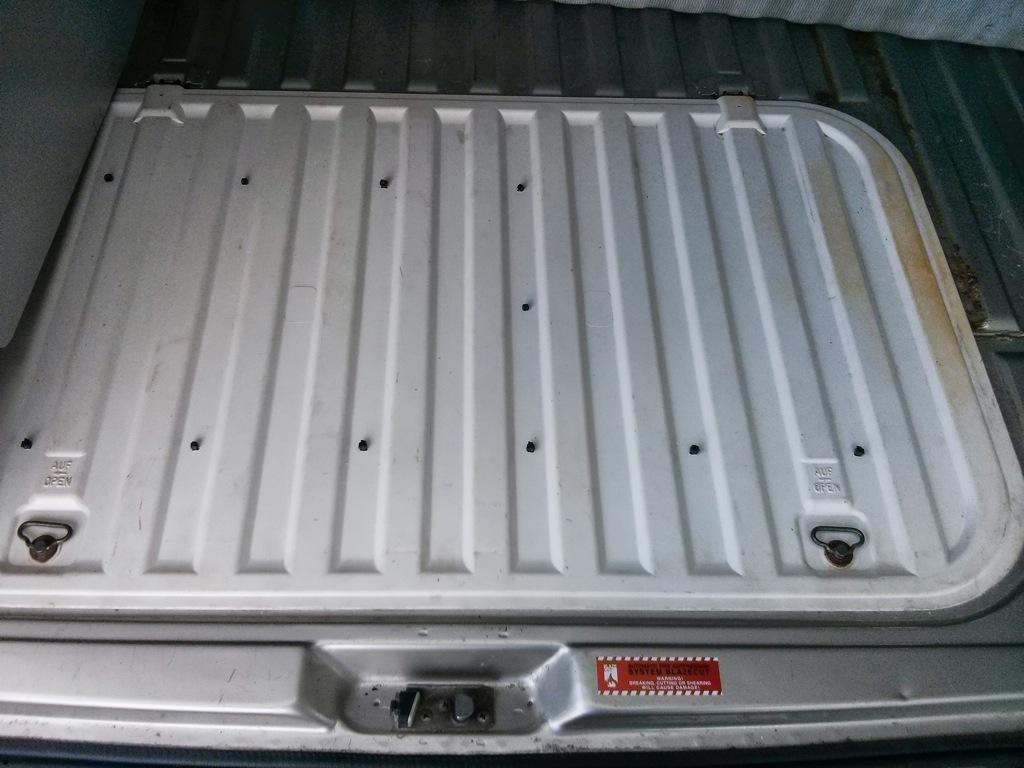

Blazecut is a tube of pressurized fire suppressant (Kyoto compliant). When the heat gets above 120C, the tube ruptures and puts out the fire.
It cost $200 including shipping from JOGR, and arrived in 2 days.
http://jogrusa.com/products/blazecut-fire-suppression-system
Here's what you get:
There's a nifty little pressure gauge on one end of the tube:
I installed mine directly on the engine cover. Drilled small holes 6 inches from the edge, every second rib and strapped it down with the included zipties.
The swirly pattern maximizes coverage of the engine, avoids interference with the air filter housing in the upper right of the engine bay, and makes checking the gauge easy.
Here's a shot through the license plate door.
This is certainly no replacement for changing and maintaining your fuel lines, or a full blown fire suppression system like some folks have installed: http://www.thesamba.com/vw/forum/viewtopic.php?t=521827
But it's a small price to pay for a little peace of mind. Maintenance free, small and unobtrusive and installs easily in just a few minutes.

noganav wrote:
...I installed mine directly on the engine cover. Drilled small holes 6 inches from the edge, every second rib and strapped it down with the included zipties...
I like the way you installed that. Do you recall what size holes you drilled? I looks like one hole per zip tie and the fastener bit of the zip tie is large enough to hold it in place - right?
noganav
Joined: January 06, 2006
Posts: 1236
Location: San Diego CA
noganav is offline
PostPosted: Sat Aug 03, 2013 5:36 pm    Post subject: Reply with quote
Exactly, the fastener holds it in place. I drilled two small 1/16 holes side by side the width of my zip ties and connected them. Just big enough for the strap to come back up through the same hole. I also sealed them up with a dab of silicone. It leaves the fastener heads exposed, but they are in the recesses of the engine cover, and it's under the mattress most of the time anyway.

I now have the Blazecut in place. Hopefully I will not be the one to 'test' it under any circumstances.
We can certainly debate if it will be effective protection and what other, possibly better systems could be crafted. But whilst debating I at least have it in there and, I think, most would agree it is better than nothing - which is what I would have if Blazecut hadn't been available.
true,adding to my wish list...

It would be a good idea to mount a second system inside the dash. Most of the interior fires start there. Of course installing circuit breakers at the battery would help it not catching fire in the first place as mentioned before.
