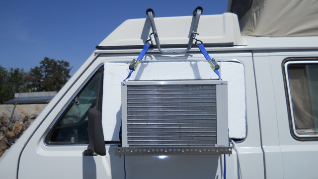

Have a bracket made to hold a unit in the passenger window.
It works great.
They used to be sold in the classifieds but the seller is having health issue, I think.

I have a similar set up to TK's set up. Not as nice looking. I also bought one of those portable units that vent out with a hose. It can't cool the inside once the temp gets over 90 or so, it just blows hot air after a few minutes. Wishing for some new technology or something that was a "new" idea!
Debbie-
What BTU rating did your portable unit have? I had a 5200 BTU window unit and it was not up to the task.

The portable unit is 7000 btu. Guess the kind with 2'hoses would work better. Kind of an expensive experiment though. Window unit is 6300 btu. I think we will try some insulation,and a fan. We are parking where there isn't even shade. Maybe should find a motel instead....save the camper for the tall pines (those few places not on fire)
I could probably sell both acs on Craig's list and get one bigger one
Here is my post from 2 years ago. Installed on my Dad's van so my brother could sleep in comfort out there.
