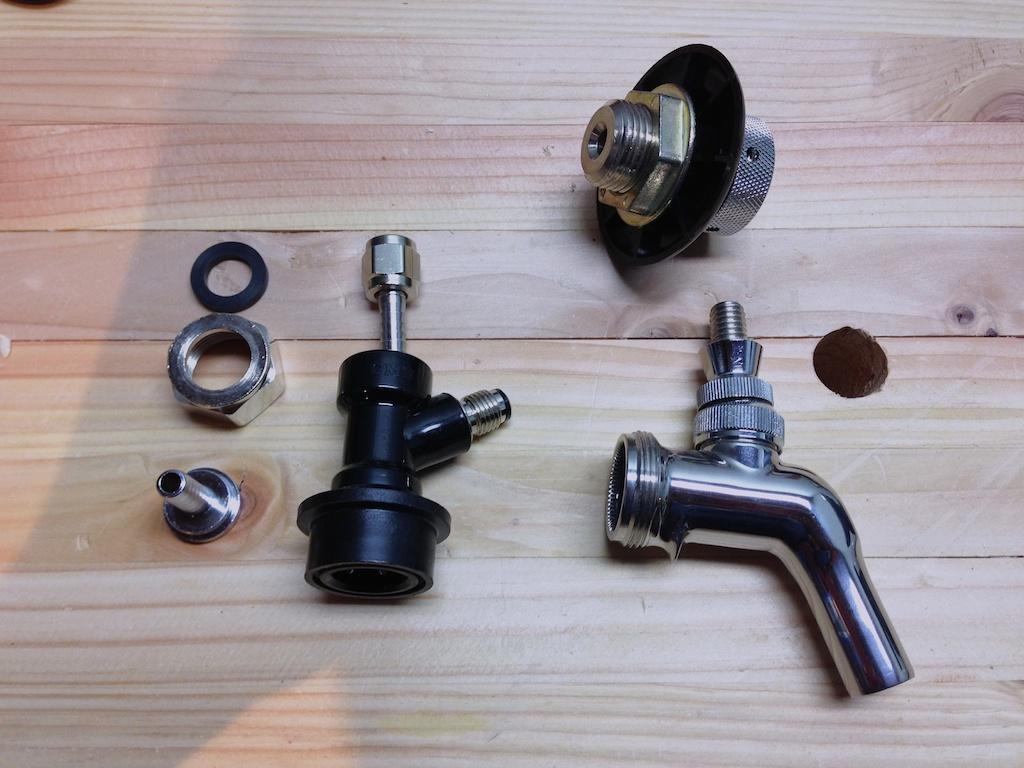

Okay, as promised I've written up the way I installed a 1.75 gallon setup in my Westy in the cabinet after removing the fridge. All told I needed the following parts:
    5 gallon bucket
    5 gallon bucket lid
    2 bucket styrofoam cooler inserts
    1.75 gallon keg (available from Williams Brewing)
    Beer faucet
    Beer shank (preferably the shortest you can get, about 2" long)
    Beer nut, tailpiece, and washer
    ~8' of 3/16" ID beer line
    Beer quick disconnect with threaded connector assembly
    Williams Brewing Mini-CO2 regulator with CO2 cartridge and gas line with quick disconnect
Much of that can be seen below:
I started by drilling a 1" diameter hole in the vent block out plate I had installed and then mounted the shank:

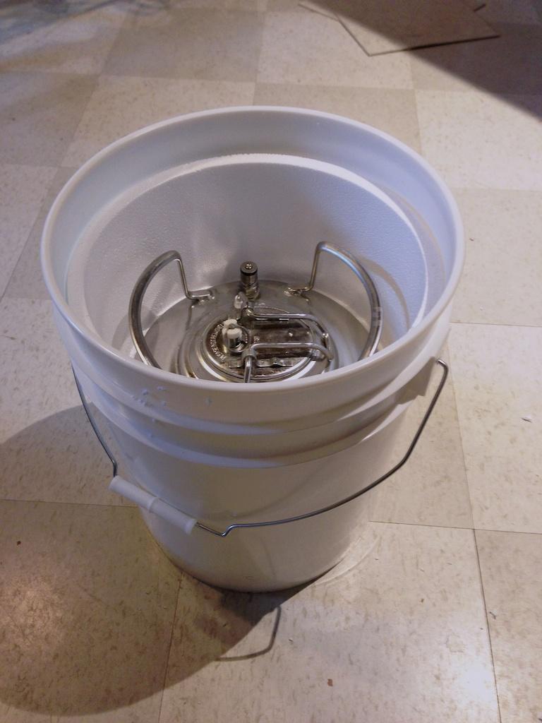

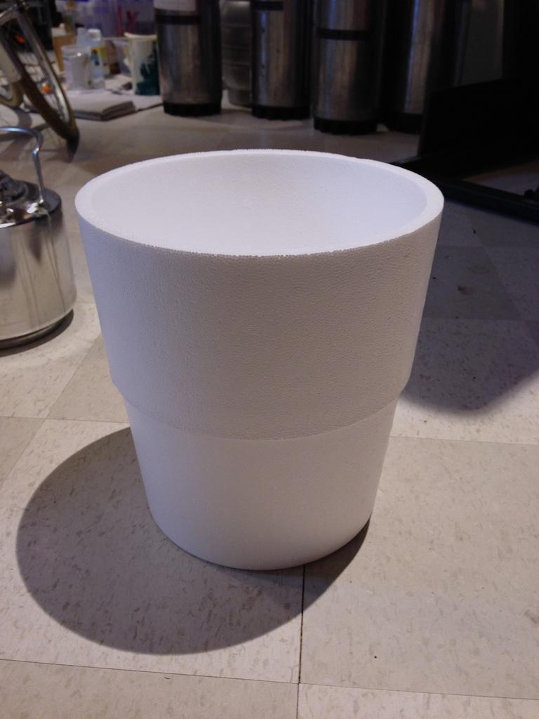

Then I prepared the bucket. I had to use two of the styrofoam bucket inserts because they tapered too much to fit a keg in there. So I cut the wider top half off of two of them. I put one lid piece in the bottom and saved the other lid piece to put on the top. Here you can see the keg sitting in there:

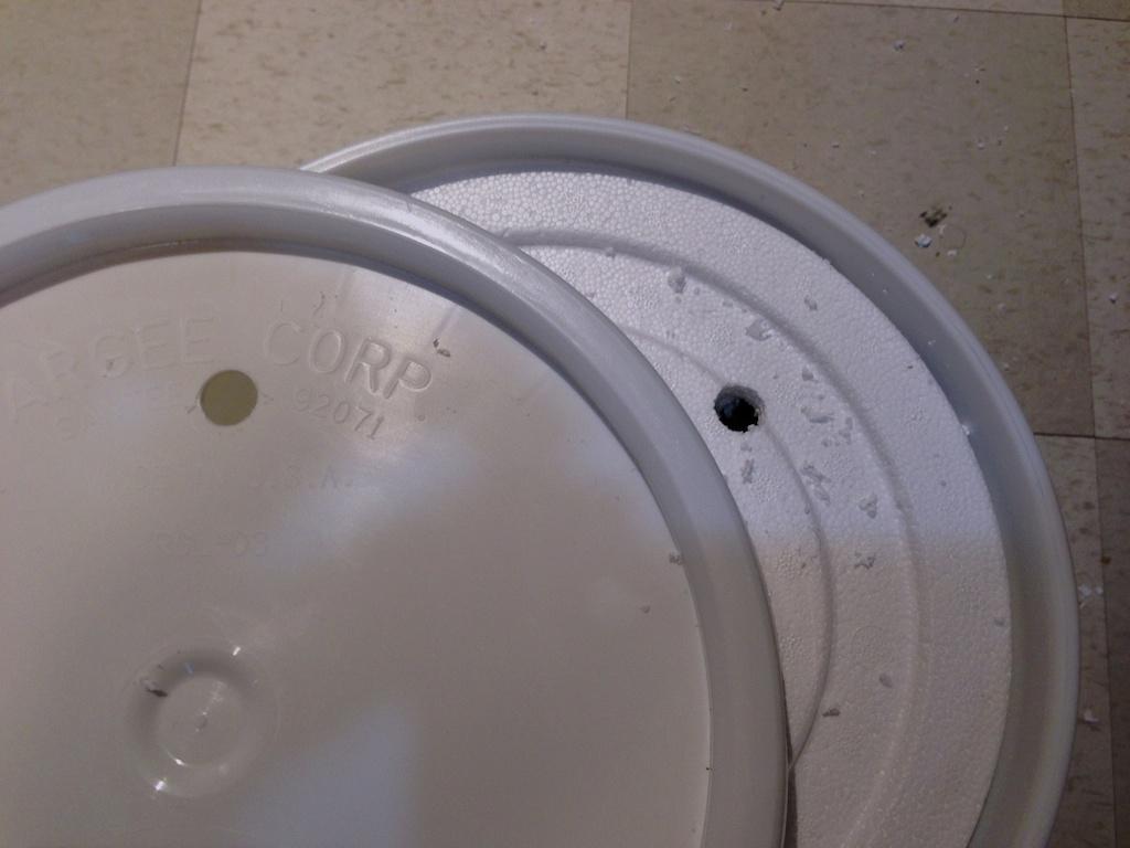

Drill a hole in the lid and foam lid big enough to thread through the beer line:

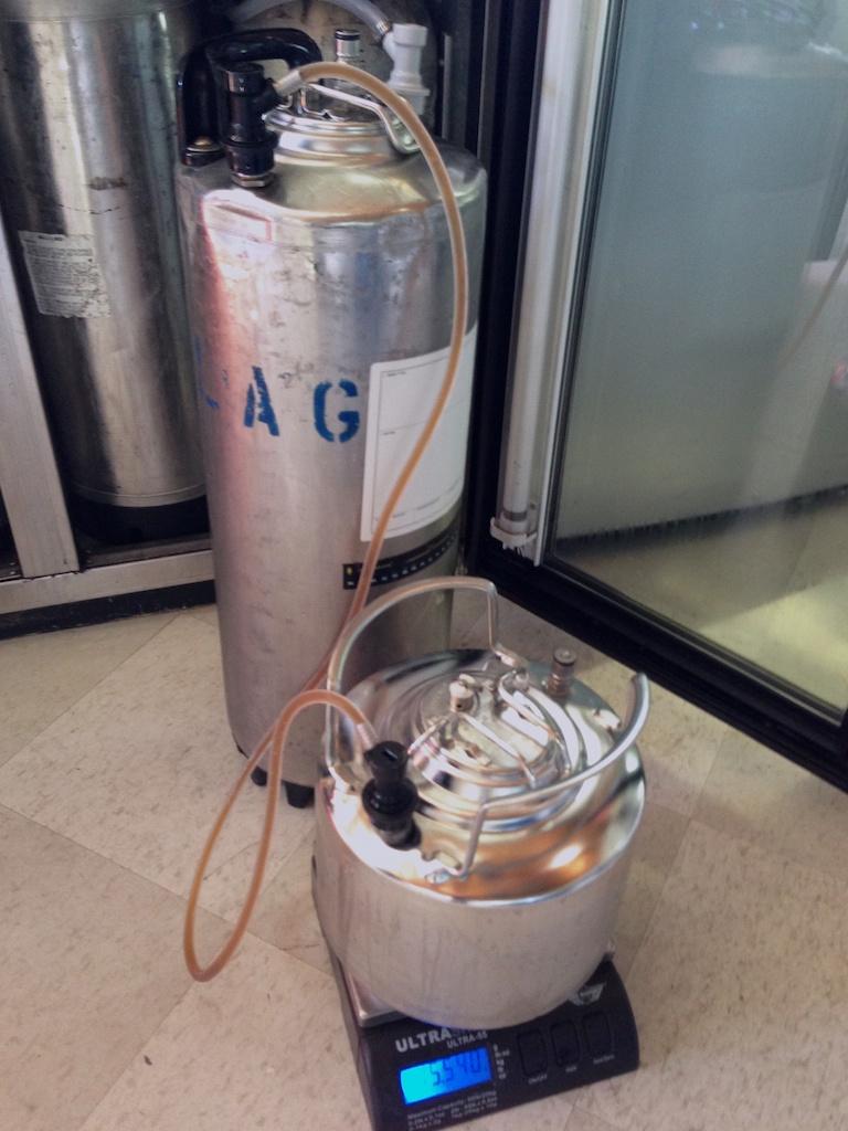

The transfer your beer from your larger keg to the 1.75 gallon keg. Here you can see me doing a transfer under pressure with a jumper connection. That prevents foaming and oxidation. I put the target get on a scale and I've tared the scale with the keg filled with water to the target amount I want to take. Then I just transfer and bleed pressure off the target keg to keep the beer flowing until the scale reads zero.

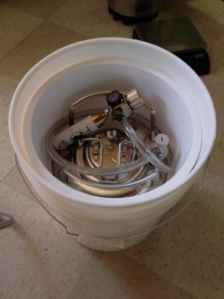

Drop your keg into your bucket and hook up the gas and set your pressure to whatever you typically use (I do about 10-12 PSI.)

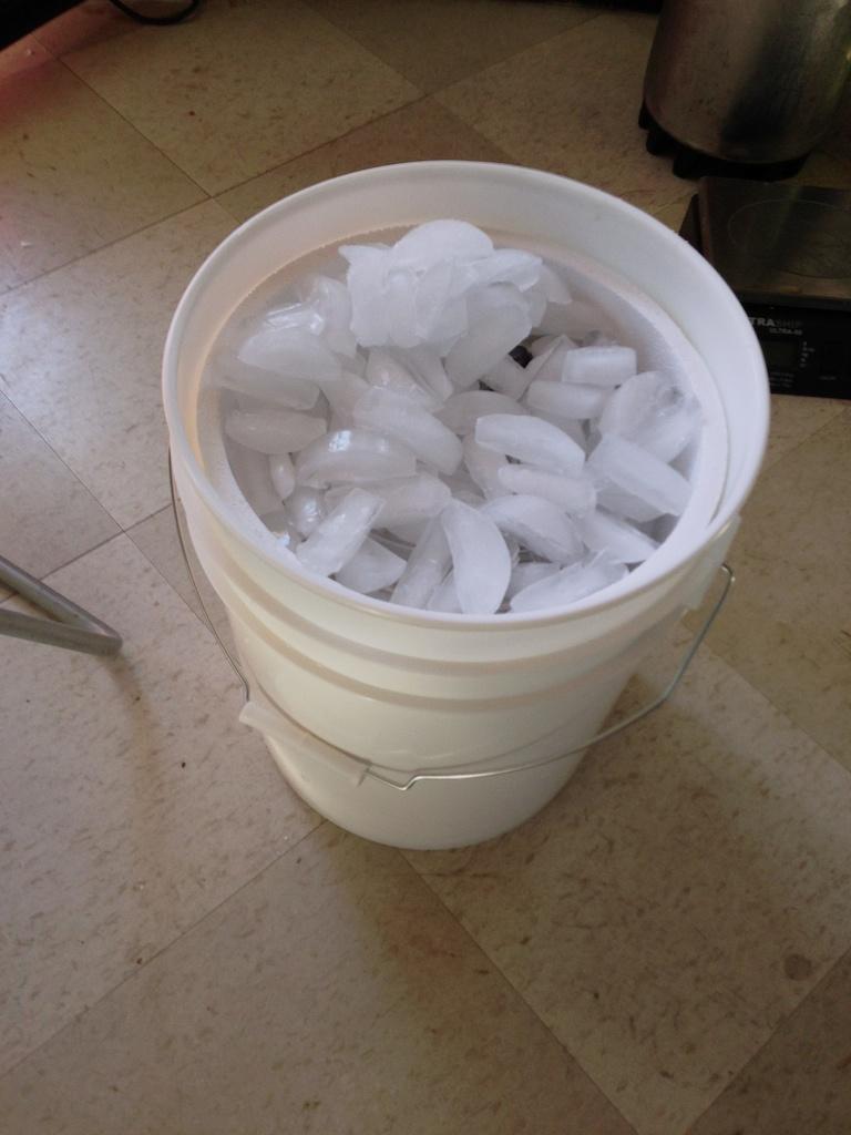

Add ice and close her up:

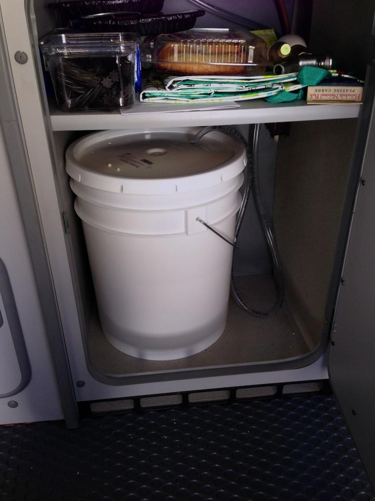

I ran the beer line to the shank and through into the cabinet. I mounted the block off plate with the shank back into the vent hole. Sorry, I didn't get a good picture of that step. The whole bucket easily fits into the storage cabinet with plenty of space for other things:

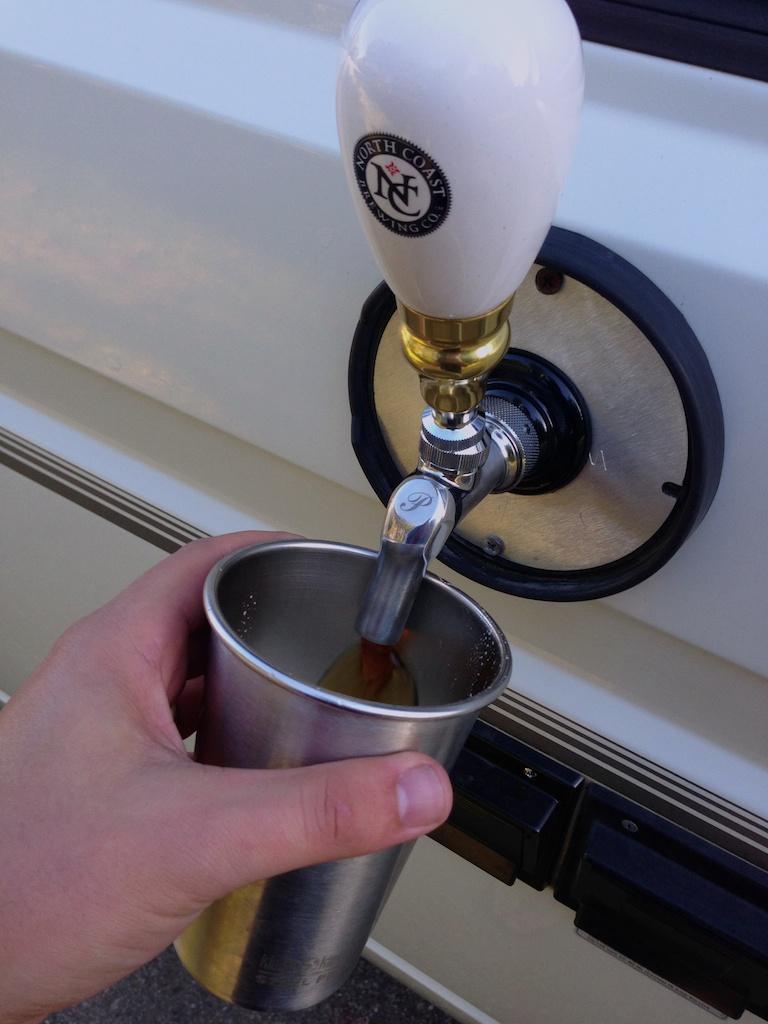

When you get to camp just pop the beer quick disconnect onto the keg and pour away:
In that picture I'm pouring a nice 3.9% ABV dry stout I brewed a couple of weeks ago.
I'm pretty sure of this, but to clarify, you're jumping the beer-out on the large keg to the beer-out on the small keg. I like the scale trick for keeping it all under pressure.
Yup, beer out to beer out. That ensures the keg fills from the bottom. Having a jumper like that around is useful whenever you need to do keg to keg transfers.
