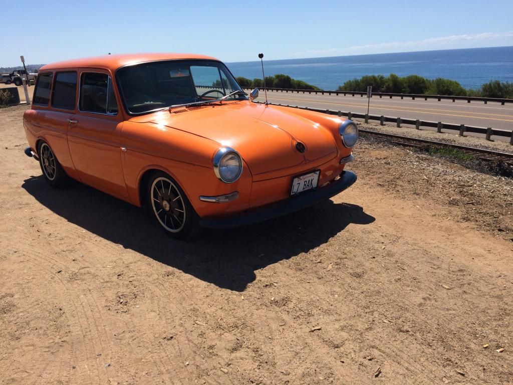

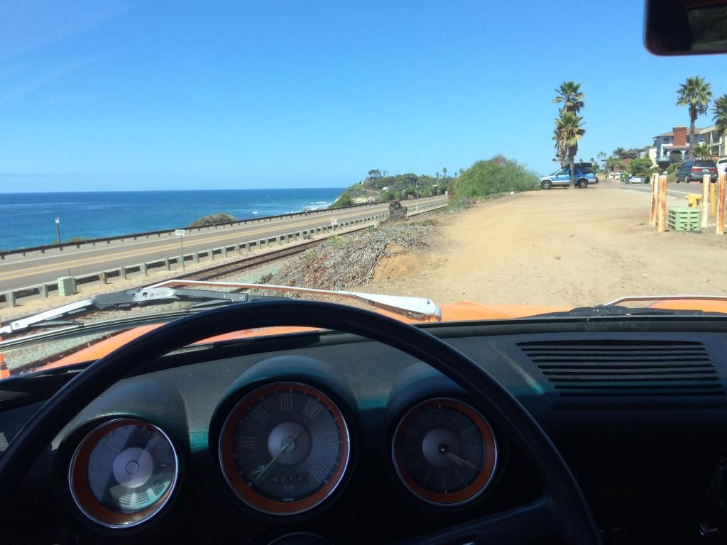

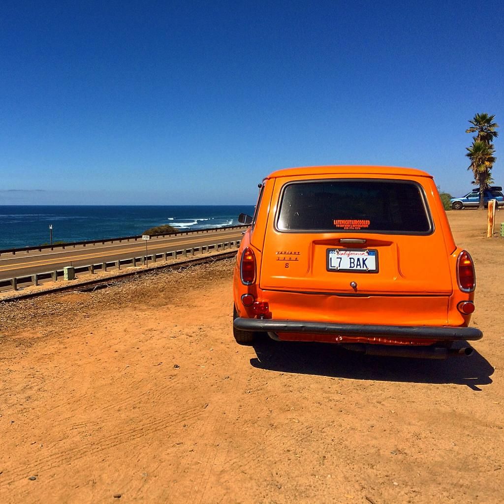

Here are some pictures. Thanks in advance for the help, and looking forward to joining this community!!

Beautiful car by the way, ok needs a little bodywork. If I didn't absolutely love the beetle, a squareback, especially a bright orange squareback would be a great car and a lot more practicle than the beetle.
