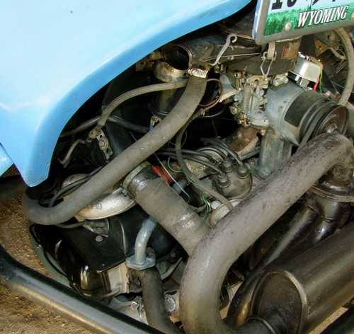

I've run my 61 Baja with 1200 and 1300 air cleaners for 20 years now - always with either 1585 or 1641cc dual ports, and 34PICT-3 and 30PICT-1 carbs, never had a problem. Currently running a 66 air cleaner. And I happen to have a heater box with a preheat fitting and I use it. And I have the crankcase vent hooked up to it as well.
-Andy
