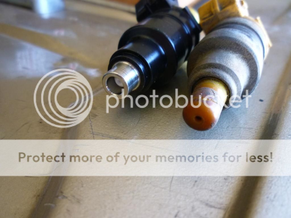

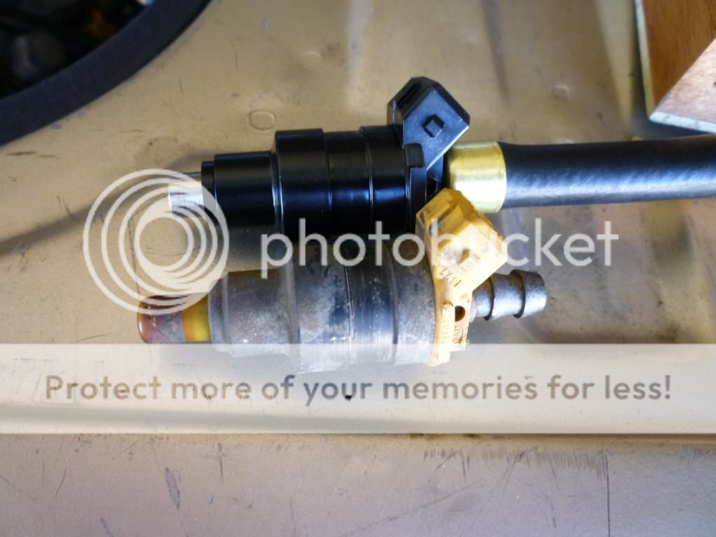

I did the search with nothing coming up with pics. So I bought a reman. injector at O'Reilly's. Houston do I have a problem?
[img]
[/img]
Obvious they are different, but does that mean I can't use the new one? Can I install it?
The counter guy looked through their system and it's apparent the new one above is what they are showing as correct.

Your new part is a disc style injector..made by Siemens/Lucas/ Delphi.. your old one is a Bosch pintle style.
The disc injectors work just fine..but replace them in a set of four..they spray differently and have some different flow numbers.
If you are in a jam and need just one old Bosch injector..I have a few laying around..just pay for postage.
Better still..get four new disc injectors..

I replaced with the disc style from GP Sorensen via Autozone.
No worries.

I did pull that link and read about the first two pages and then went to the last page. The links on the first 2 pages didn't work so I went to the last page. Now, after reading ALL pages I see where I must be patient and read ALL. Yes, it did answer my questions and I bow my head in shame. Embarassed
Now, I am ordering 3 more for a full set.
