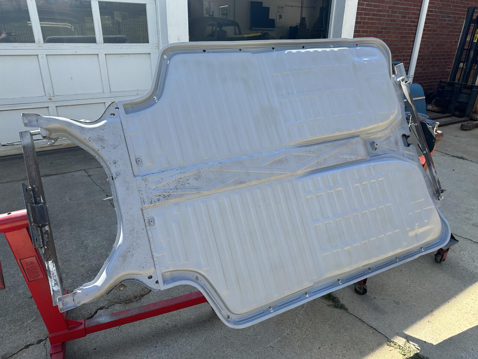

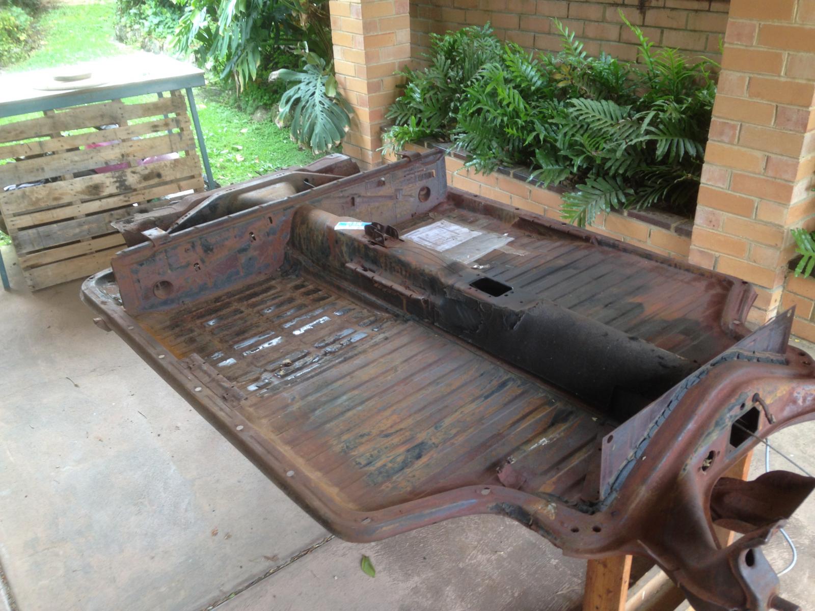

I have a donor pan and was hoping to transplant the whole one piece pan into my original tunnel and front and rear of my pan, There will be much drilling of spot welds and carefully splitting seams to get the donor out and in as a one piece replacement. Has anyone done this? What are the pitfalls?
My donor pan:

Keep in mind that the type 3 floor section (pan area) is all 1 piece, and the tunnel is spot welded to it. You're actually better off getting as many dimensions as you possibly can before doing any cutting or drilling, so you'll know where to line everything up. Also keep in mind that the pan to body holes on the outside edge might be off and need adjusting.
I hope this helps.
Bob 65 Notch S with Sunroof

Thanks Bob. I aim to drill out all the spot welds and unpick this one piece pan from the tunnel and transplant it to my car. I'm borrowing a rotisserie to make life easier
I'm hoping it will all line up properly given it's a VW pan but I'll take your advice and make plenty of reference marks from tunnel to pan and other random measurements.
Cheers. Dave

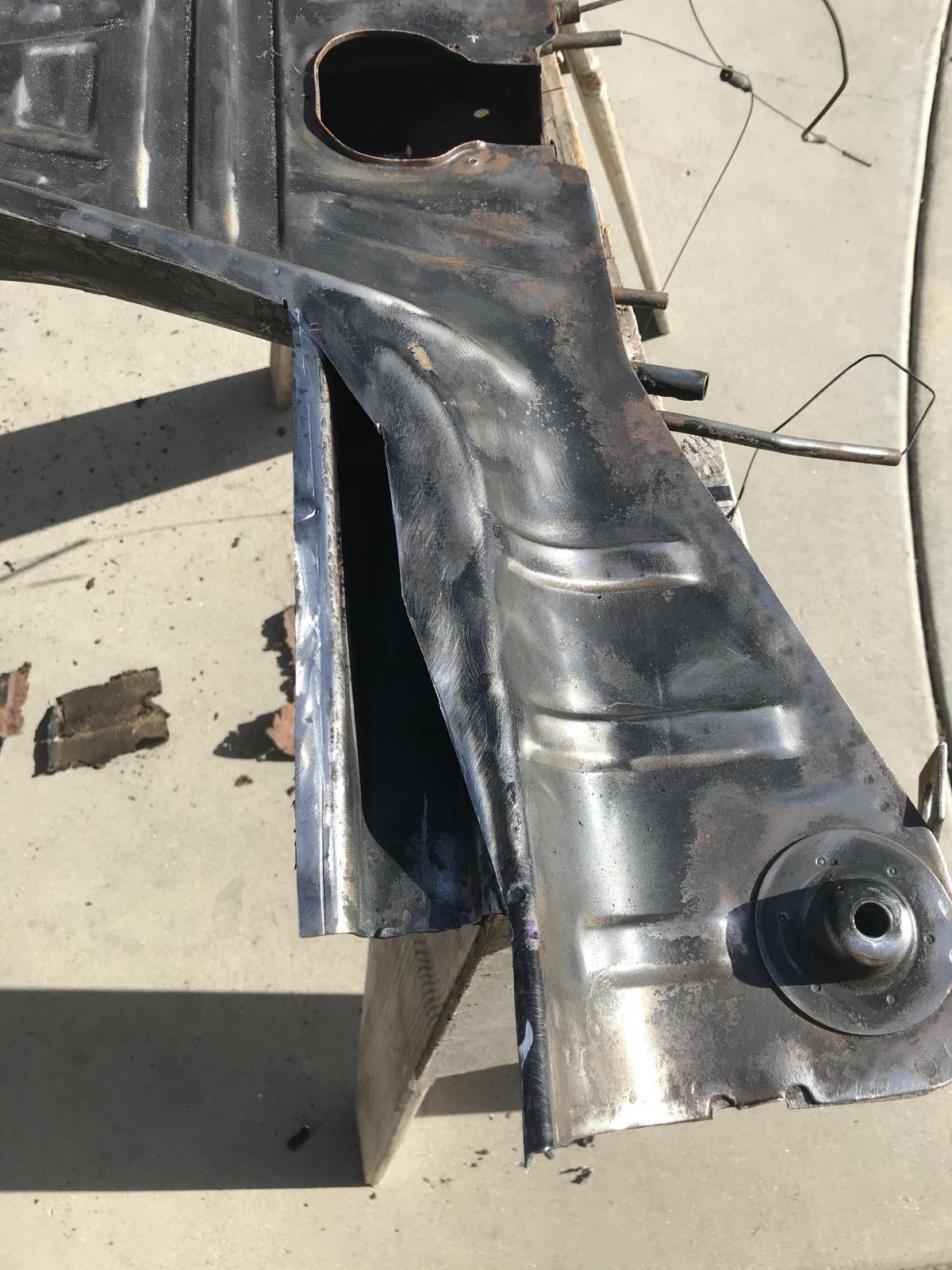

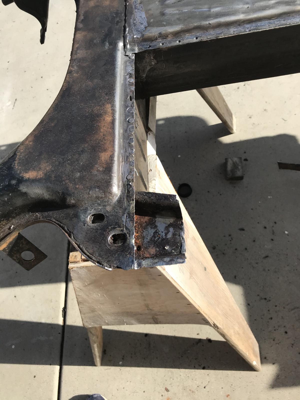

These photos help.
