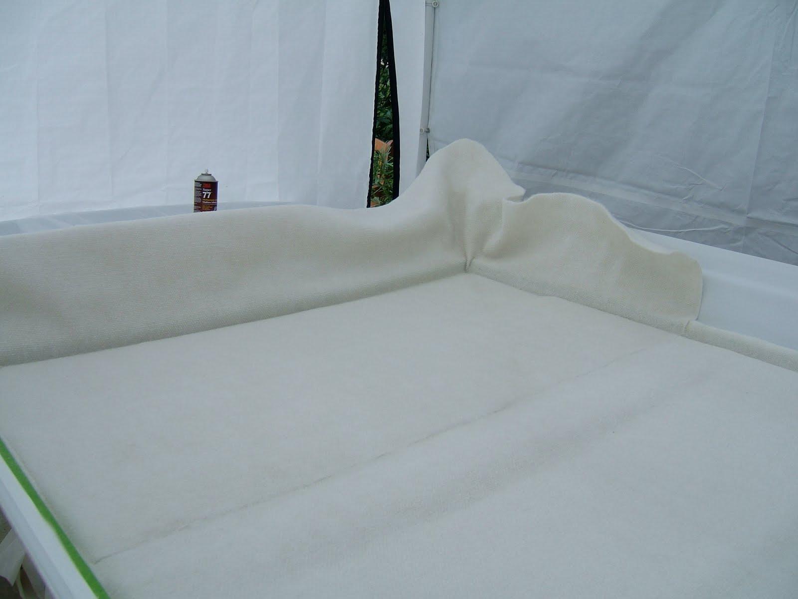

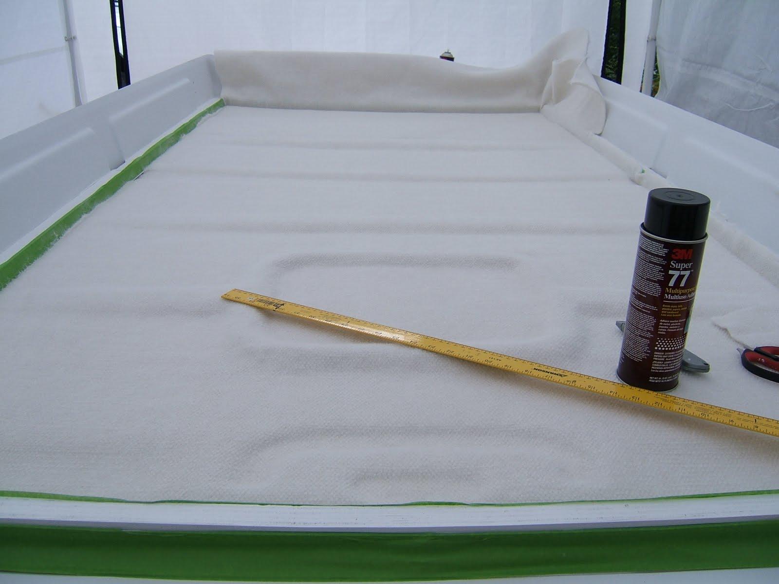

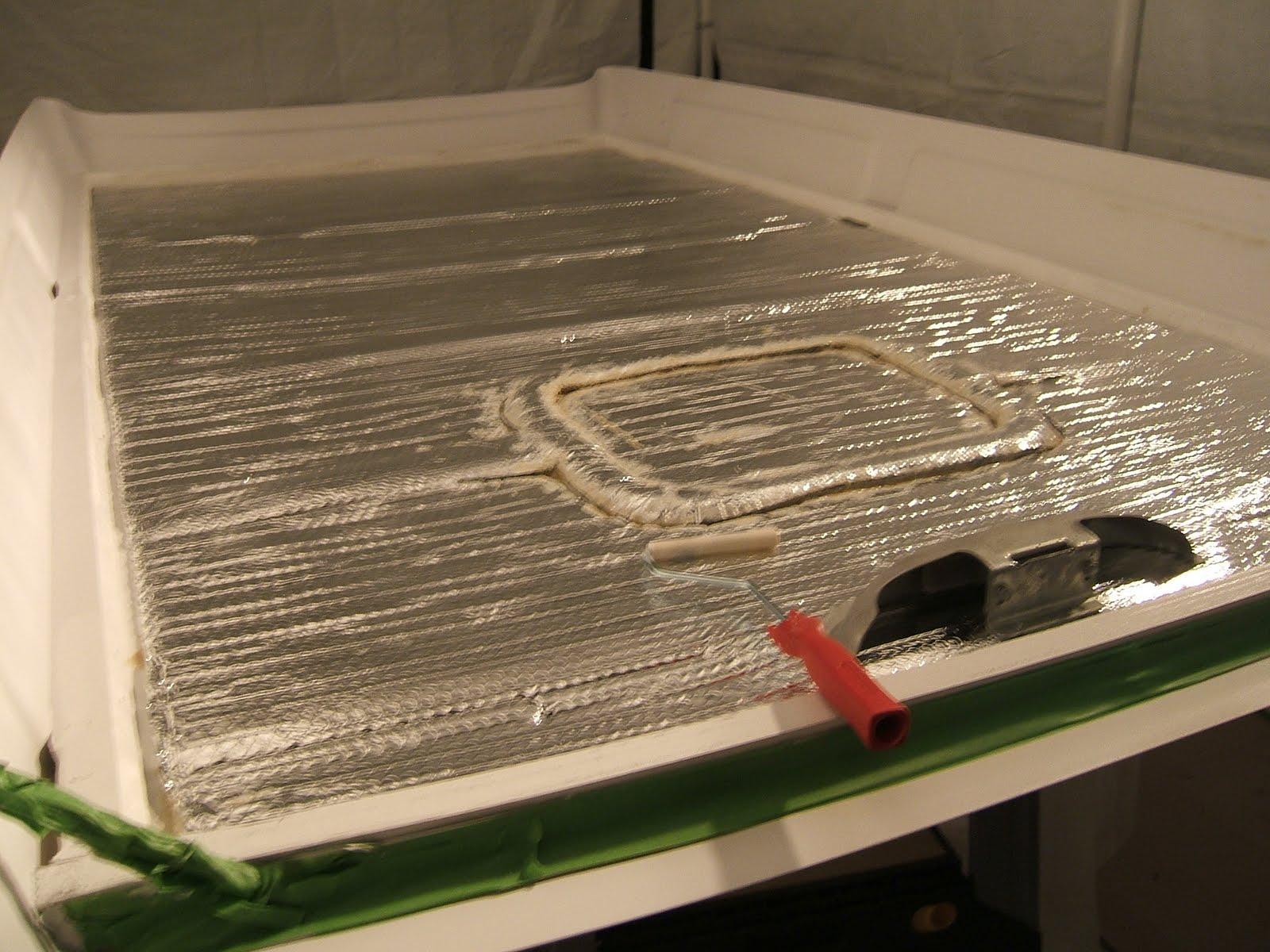

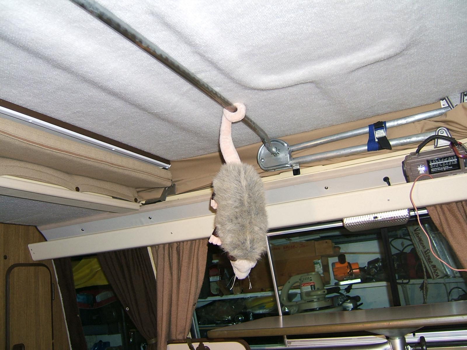

I did this to my poptop..
The headliner I bought online from a boat supply store..off white, it's mold and mildew resistant polyester, the mylar NASA (bubble) insulation I got form HD or Lowes, 4' width., cleaned the surface of the top with lacquer thinner, gluedup the mylar insulation with polyurethane adhesive, applied 3M90 liberally to both surfaces and glued the headliner on. The latch hardware fits over this, sealed the bolts with RTV, snug but fits back on. The foldout upper bunk just clears but no problem, really. Should help keep cooler in summer, hold the heat in winter and gives the top much needed insulation and sound abatement...you don't have to go this far, this is what OCD will make you do..the possum likes it.

JEL91WESTY that would have been a better choice, but it has held up well.

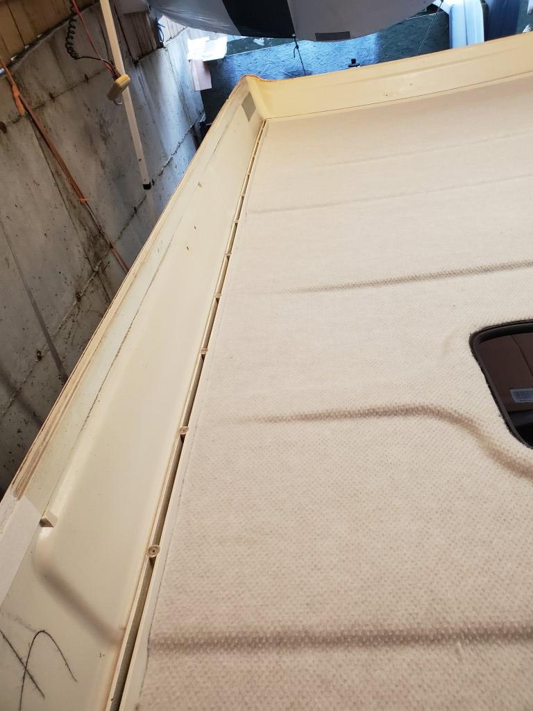

I found that a large blade type scraper was best, for the more stubborn areas I soaked these with acetone for about 5 mins and then used the blade to scrape of the sludge. I covered this on page 3 of my build log
https://www.thesamba.com/vw/forum/viewtopic.php?t=...p;start=40
I finally got around to re-covering the inside of the pop top about 2 weeks ago, for this I used a good quality marine grade headliner. You don’t want to use anything too thick otherwise it will could the pop top latch and the bolts that hold down skylight, lift arms etc will be too short. The marine headliner offered a good balance for thickness/insulation, and tolerance to a potential moist environment.

Thanks for the reply. I'm about to dive into my pop-top. I can't stand that flocking material. I was thinking of installing a preforated headliner material used in early Buses, Beetles, etc...

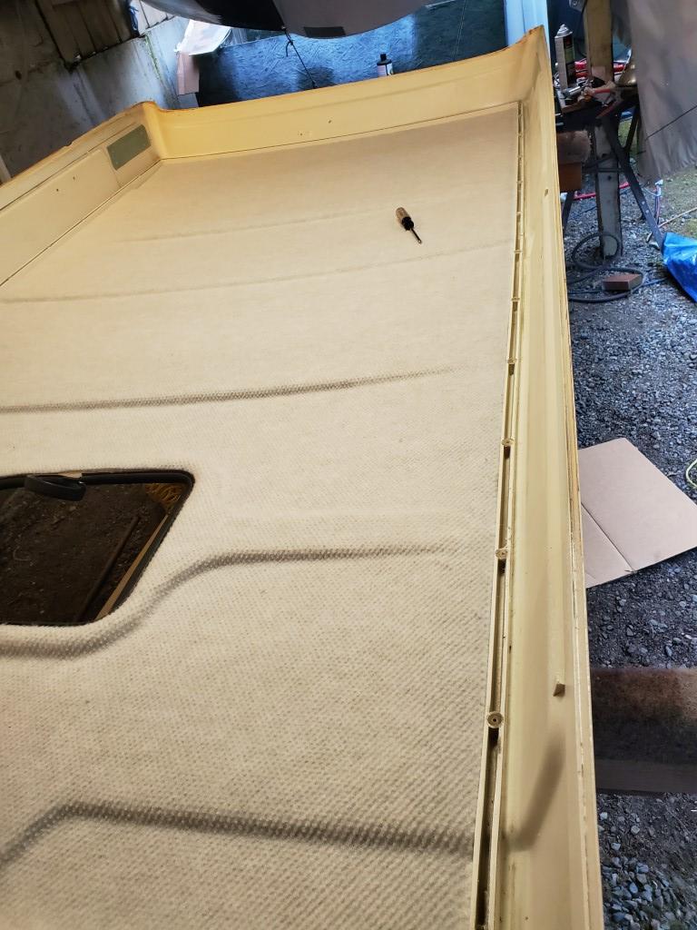

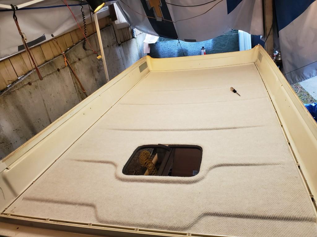

PostPosted: Tue Feb 02, 2021 2:22 pm    Post subject: Re: Headliner material for interior of pop-top Reply with quote
I also couldn't stand the flocking, no matter how much I cleaned it, it still got moldy after every winter. so this summer I attacked the pop top. cleaned, 3 coats or pre-kote, 5 coats of brightside. removed old flocking with a 1/2 gallon of acetone, used a marine contact adhesive for the polypropylene hull liner material. I purchased mine through Albright Supply - Can't recommend them enough, great people, good products, price and shipping. Polypro hull liner is mold and mildew resistant. I am sure the through cleaning and multi layers of paint are helping with condensation too. a couple of tips, don't get any paint or primer on the top where you are going to spray adhesive, the adhesive and paint don't mix and the paint will lift. Heat a punch with a torch to make your bolt penetrations, don't try to drill the material.
Heated brass tube used for penetrations:
