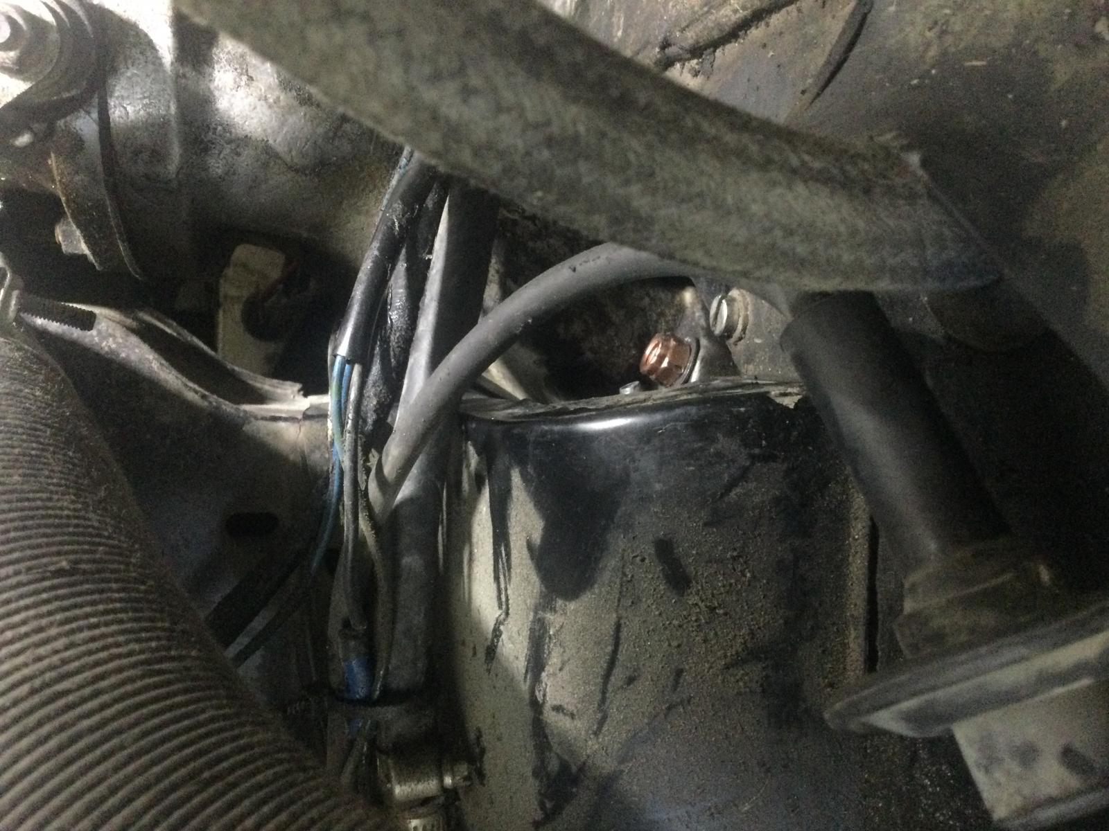

It appears I have an intake manifold leak on the 1-2 side where the dual Weber IDF 40 manifold meets the DP head. When idling if I spray carb cleaner on the top/back of the location where the manifold meets the head, it noticeably changes the idle.
I can see the near side manifold stud bolt and can feel the far side bolt if the spark plug wires are out - so my question is: do I need to drop the engine to fix the manifold leak? This is a split bus, so the space is tight around the carb and it’s manifold.
Have people taken off the intake manifold, replaced the gasket and reattached the manifold without dropping the engine? (Basically should I attempt this with the engine in place?)
I am mainly concerned about either dropping something in there or not being able to reach the studs/bolts well enough - or worse yet - maybe it is something worse than a gasket leak, like a crack or something and I am not sure I would see it…
I think I even hear a periodic “hiss” out of that side at idle, and the carb cleaner definitely is getting in there and changing the idle…. The 3-4 side does not do that at all…

I'd try to remove the manifold before dropping an engine for a vacuum leak.
I have never worked on a Bus. So I can't speak to the difficulty in the engine compartment.
In a beetle. You have about a 1-1.5" circle between the firewall and the carb body. Where you can get a socket and extension on the forward manifold nuts. It's a tricky location.
I use a 1/4 drive 11" extension with a socket on the end. I reach down on that very small space and guide the socket onto the manifold nut. After that, I attach the ratchet to the extension and remove the nut.
It takes practice. But after a few times removing the manifolds. It becomes easier.
Can't you reach around the sides of the manifolds in a bus engine compartment to get to the nuts?

I can reach the nuts on both sides. I cannot get a small 12mm socket onto the nut or a the box side of a combination wrench, so my only choice is an open 12mm wrench which should work. The bend in the intake manifold kind of covers up the nut at an angle so you can not quite get a socket or box wrench on there.
I think I will give it a try tomorrow - and just be very careful not to drop anything in the intake ports. It seems like a lower flanged exhaust nut would allow a socket or box wrench to fit on there, so I might consider swapping the nut.
Since I cannot see where the vacuum leak is, I don’t really know what problem I am solving, so I am assuming with a thick fiber gasket and a properly seated intake manifold, that it will seal up.
Might put on some permatex aviation or something (non RTV) that can be used on intake manifolds…

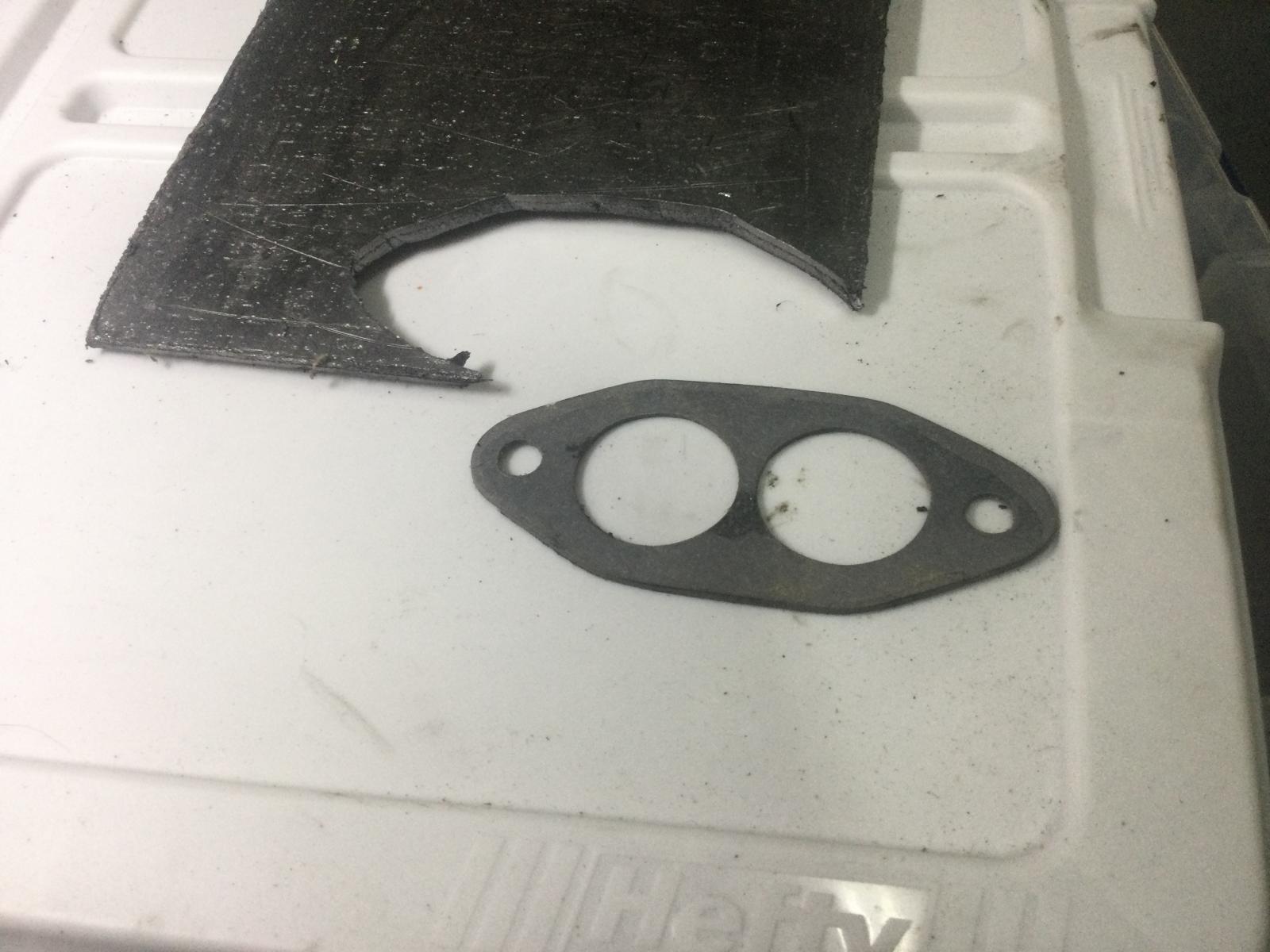

Hmm, can I use Remflex GS16511 as an intake gasket? Or is this stuff only for exhaust gaskets?
https://www.amazon.com/dp/B006G30D6Q/ref=cm_sw_em_r_mt_dp_Y6J98PVCNEPZW7C1GNKJ
(I have a sheet of this and need a DP intake manifold gasket…)

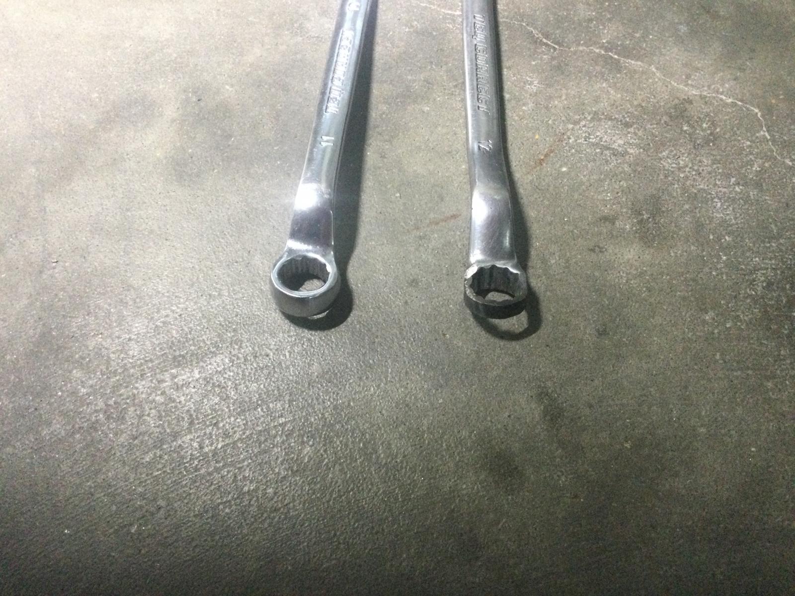

Ok - very happy - fixed this all before 8:30am:
1. Ground down my 12mm box wrench to be thin
2. Removed larger 12mm nuts - a pain to get at the back one
3. Retrieve back nut/washer with a magnet (didn’t want this in the port!)

5. Made a thick gasket from Remflex (I had thin metal and thin fiber ones, but this Remflex is pretty thick and I read about people being happy with it)
6. Slipped the fat gasket in there and manifold on top seated well

(That fiber gasket in the image above was just used as the cut out template - the fat one was already on the car!)
I wanted a super fat gasket to be sure the leak went away…
3. Disconnected linkage to 1-2 carb
4. Lifted carb and manifold up and to the back (still otherwise connected)
7. Used copper exhaust bolts with thin washers because they have a rounded top I can get the box wrench onto easily. Tightened down
8. Reconnected everything
9. Started engine and sprayed carb cleaner - NO LEAK!
Then when I measured the carbs with the snail, the one I fixed was pulling like 8, so I had to synch them as best I could to 5.5.
I've a collection of bent spanners, shaved sockets, bent and shaved ring spanners that fit sockets., screwdrivers with reground ends... Laughing VW 'Special tools' Hope everything owrks out with the new heads....bet you can't wait
