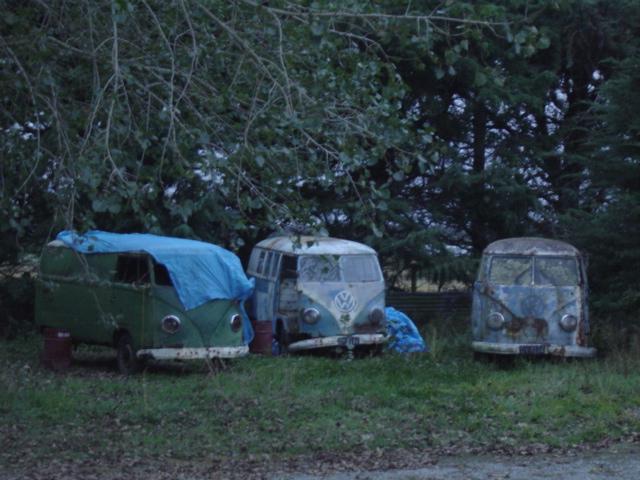

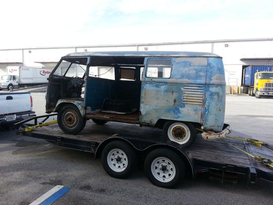

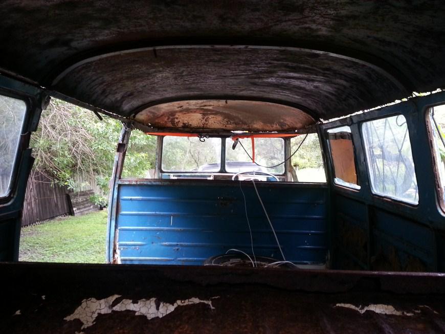

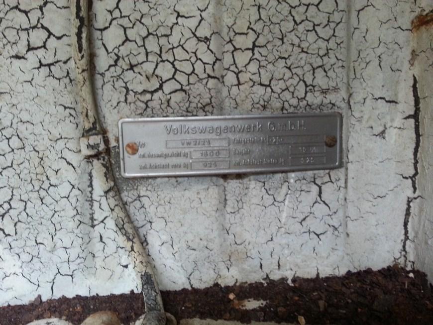

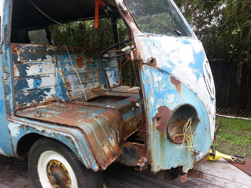

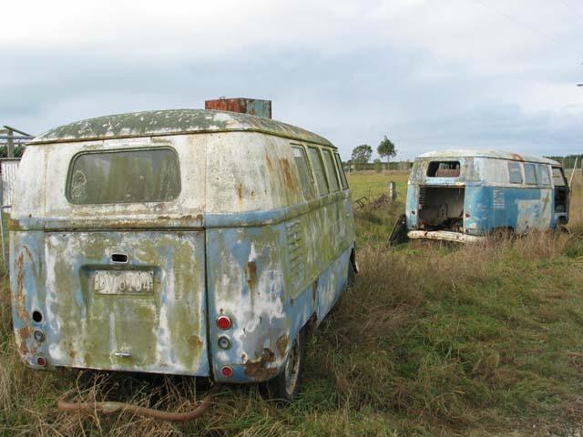

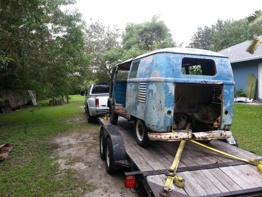

here are some picture of when this bus was found and moved.
this bus came out of New Zealand, it is part of a 3 bus stash that was found about 3 or 4 years ago, the chassis no. is 20-086871, it was last used by a church in NZ............
a little fun fact since this bus was sold in New Zealand it meant that a certain percentage of it parts had to be made in NZ. (any one else that knows the exact number can chime in) things such as the glass, headlamps, paint (a darker shade of blue) etc had to be made there in order for the bus to be sold there. silly rule if you ask me but it's what makes the bus unique.

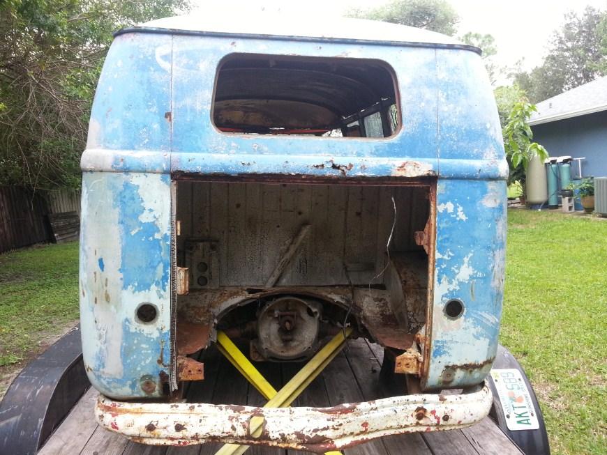

PostPosted: Tue Dec 17, 2013 8:44 am    Post subject: Reply with quote

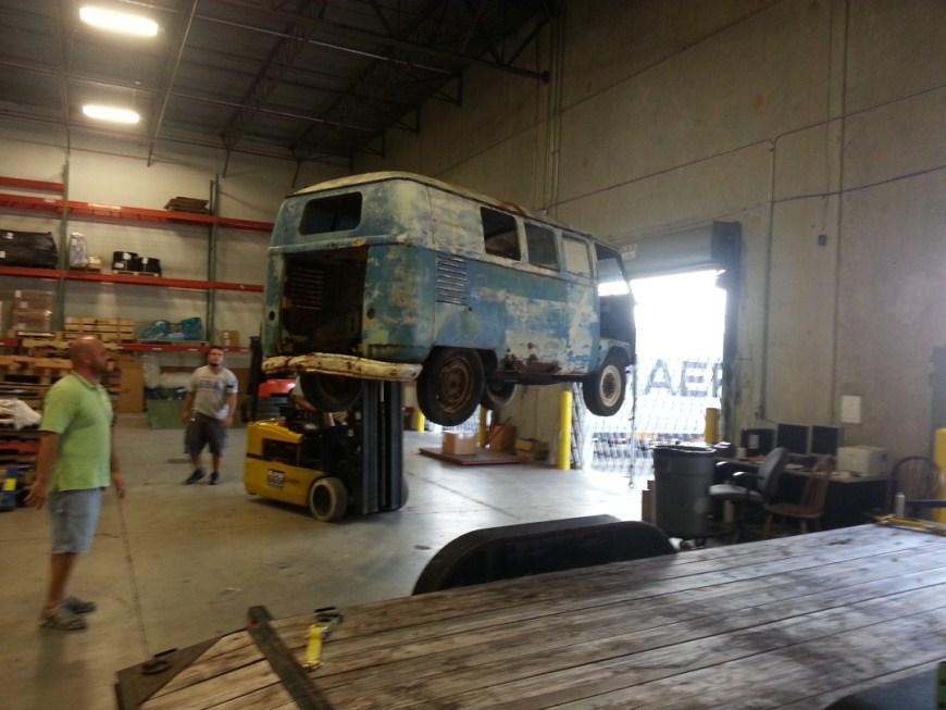

here it is getting picked up, literally, from the shippers once it got into the states

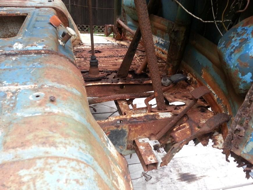

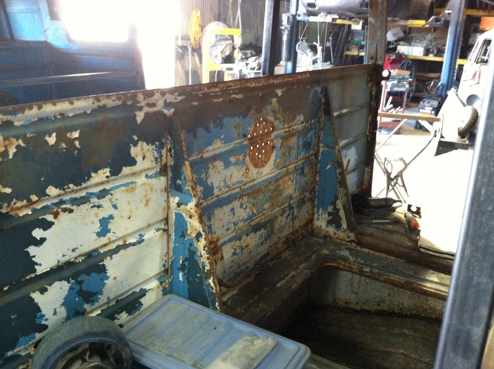

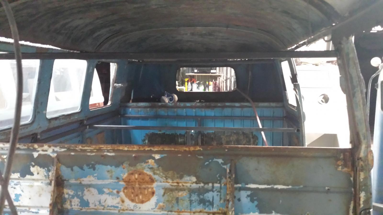

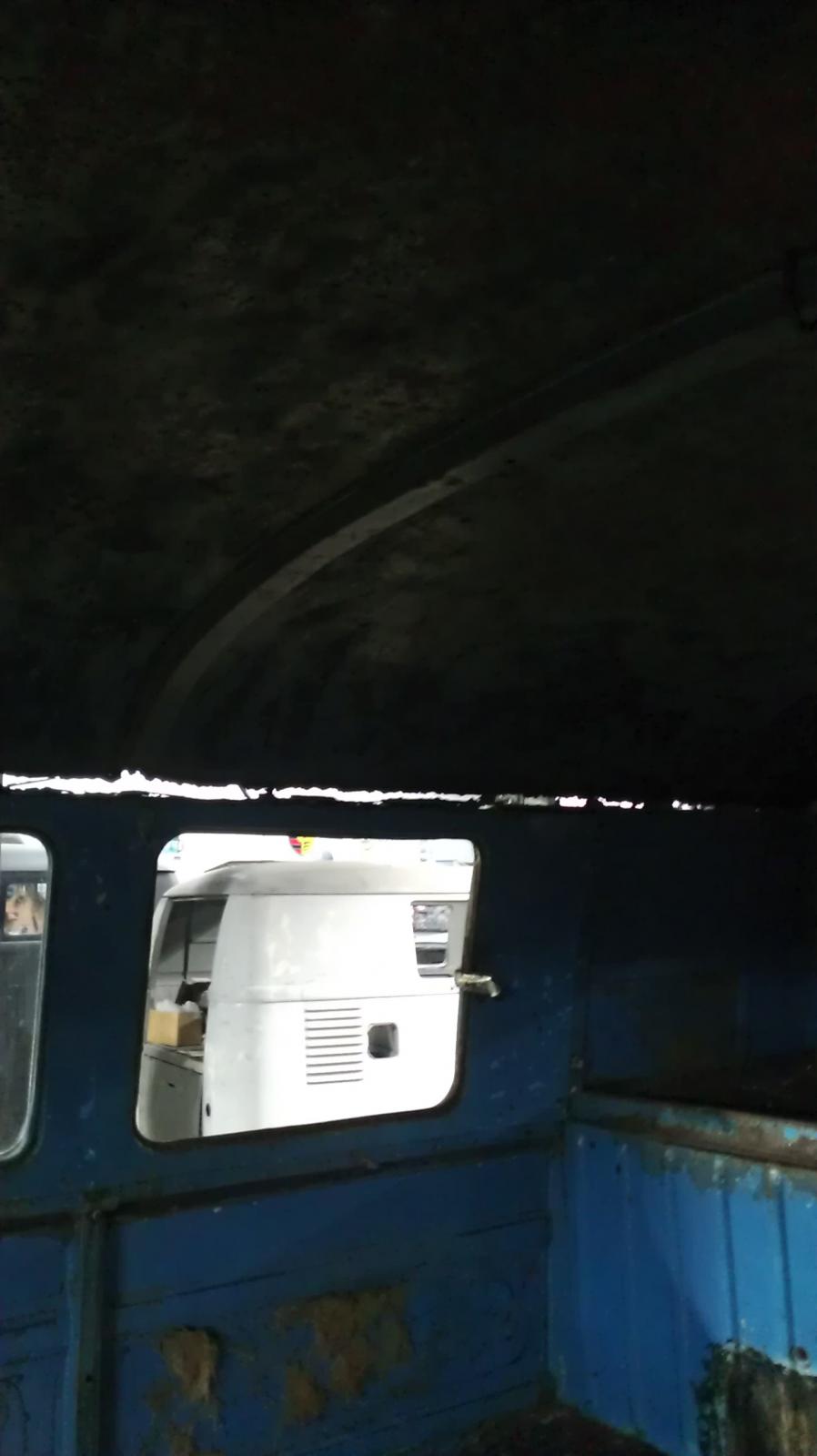

the body is pretty rough.
basically it has to come off the frame and since the roof line is held on by 3 spots that are about 3 inches long the roof has to come off.

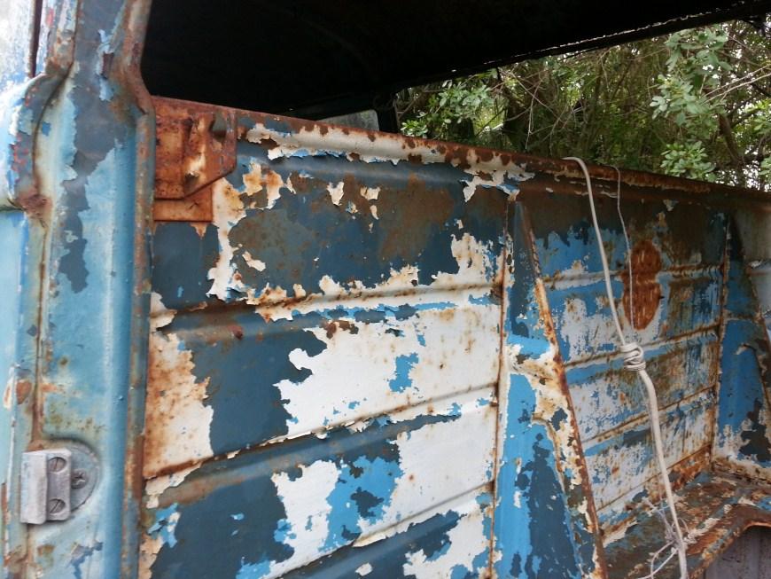

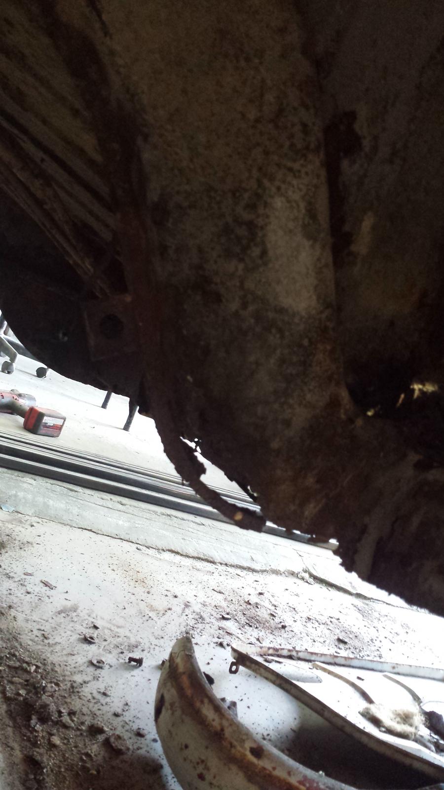

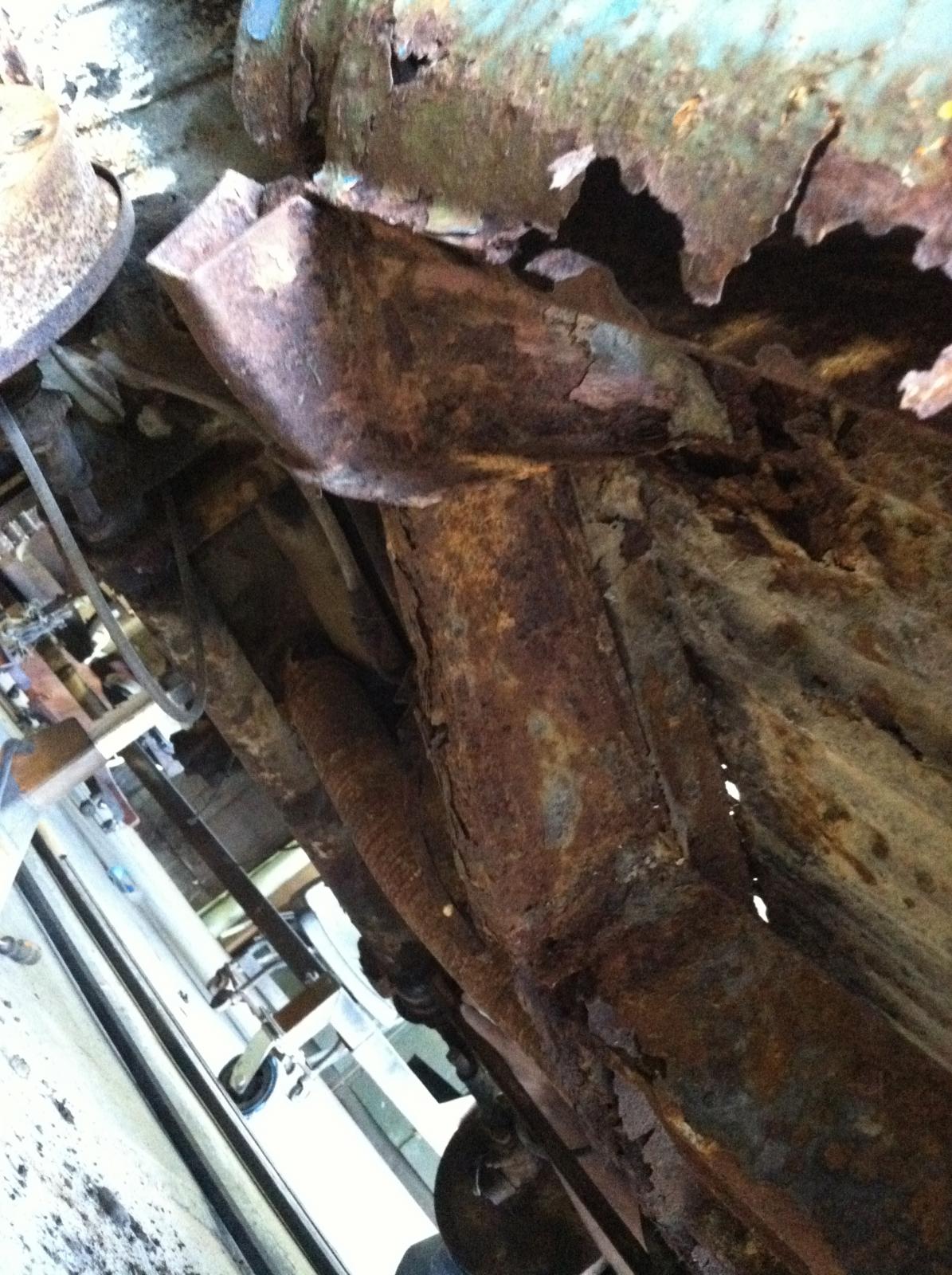

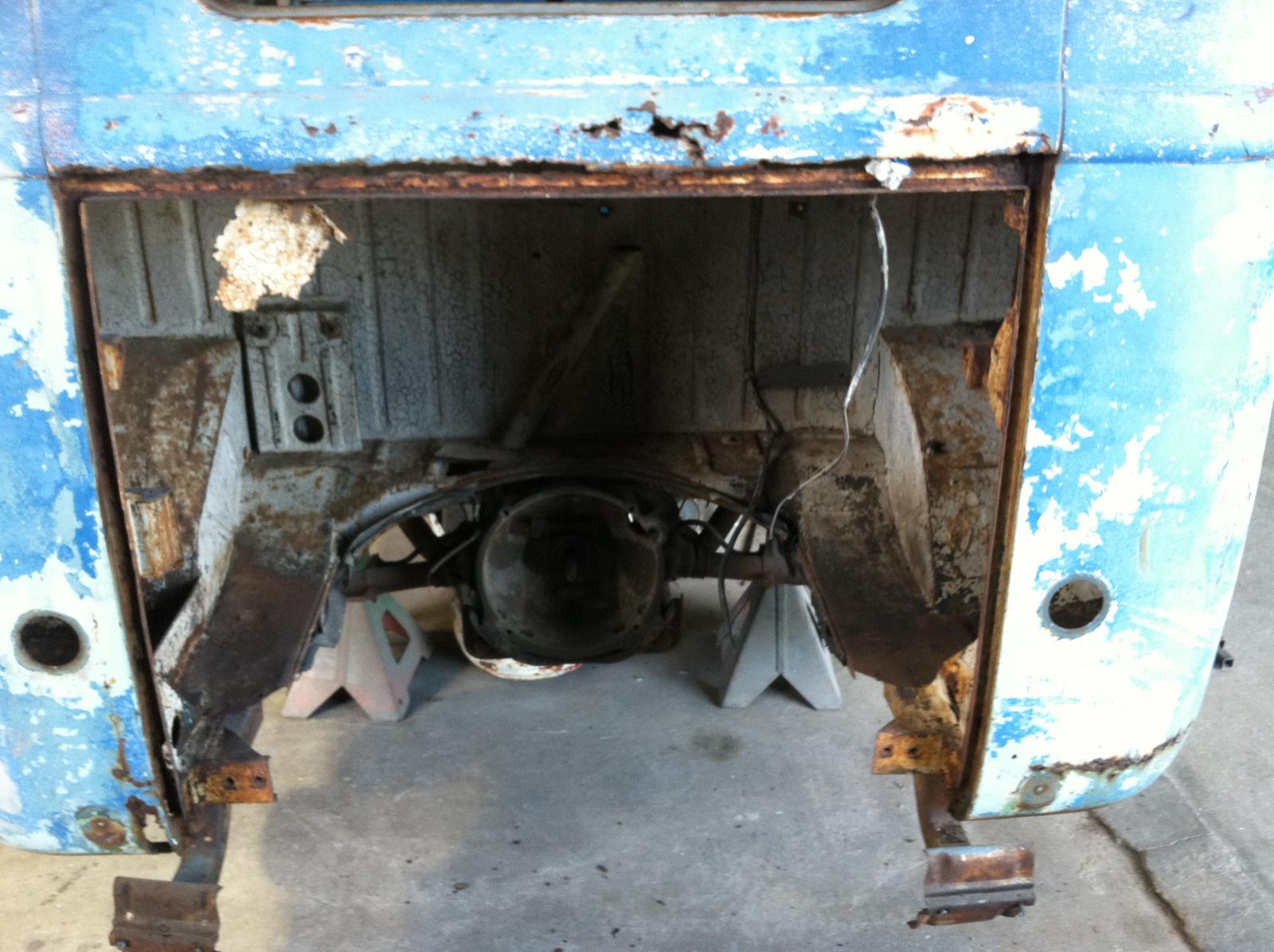

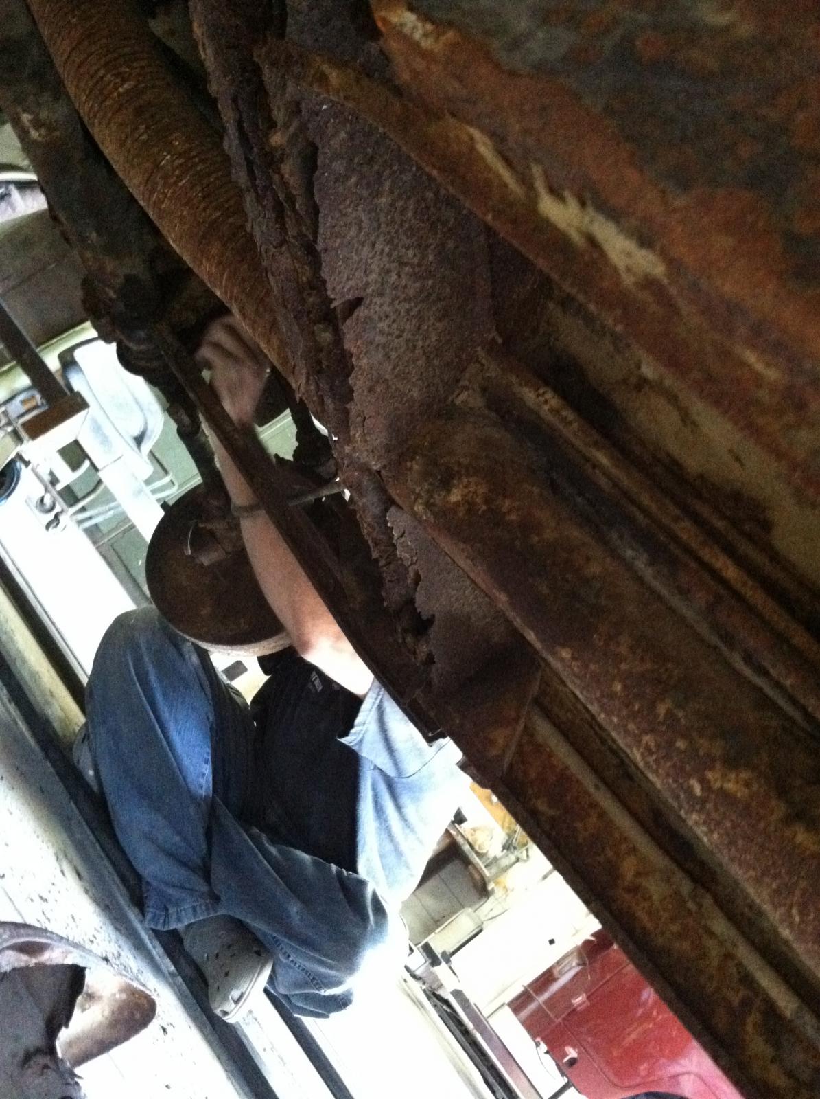

PostPosted: Tue Dec 17, 2013 7:03 pm    Post subject: Reply with quote

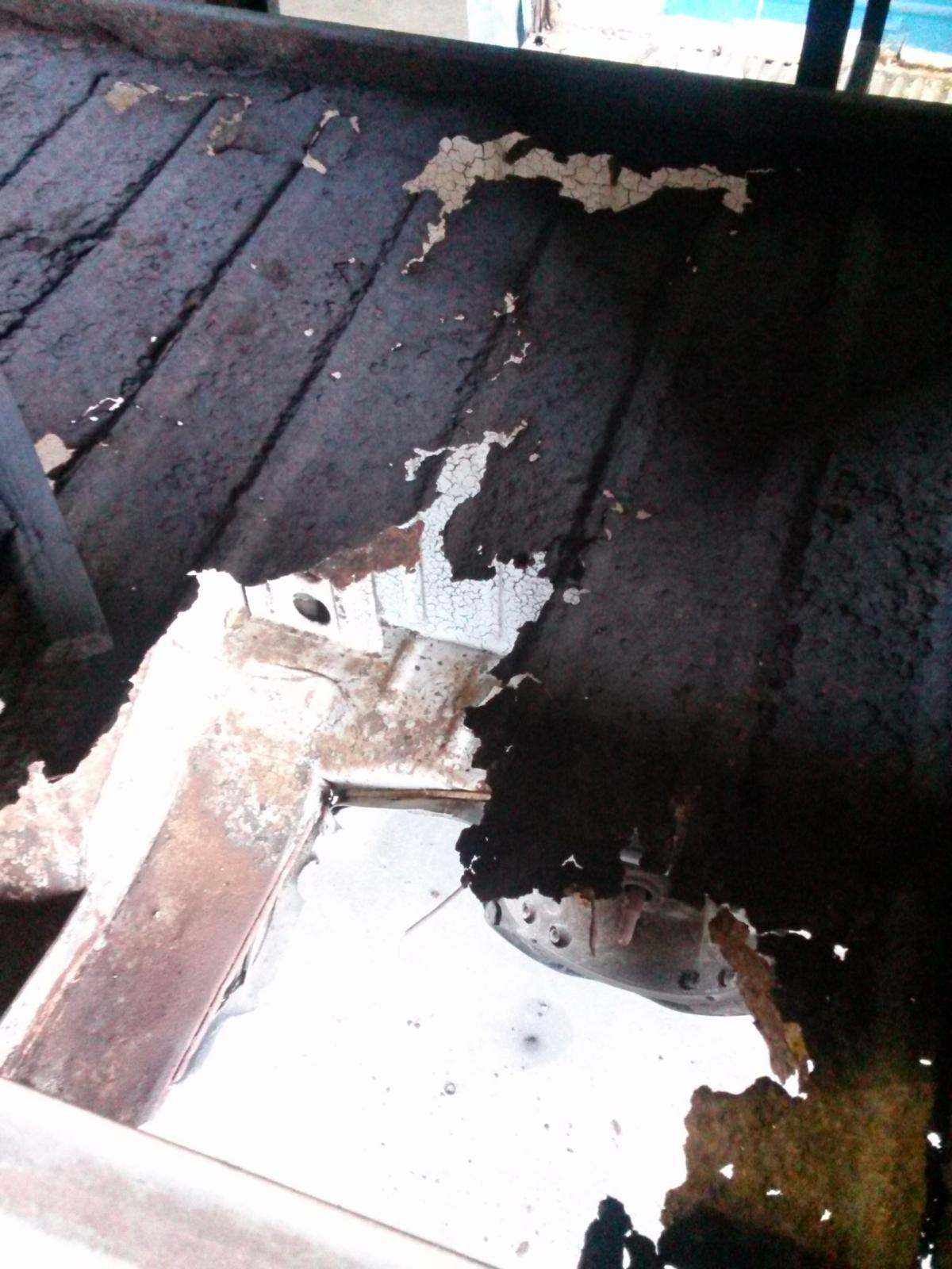

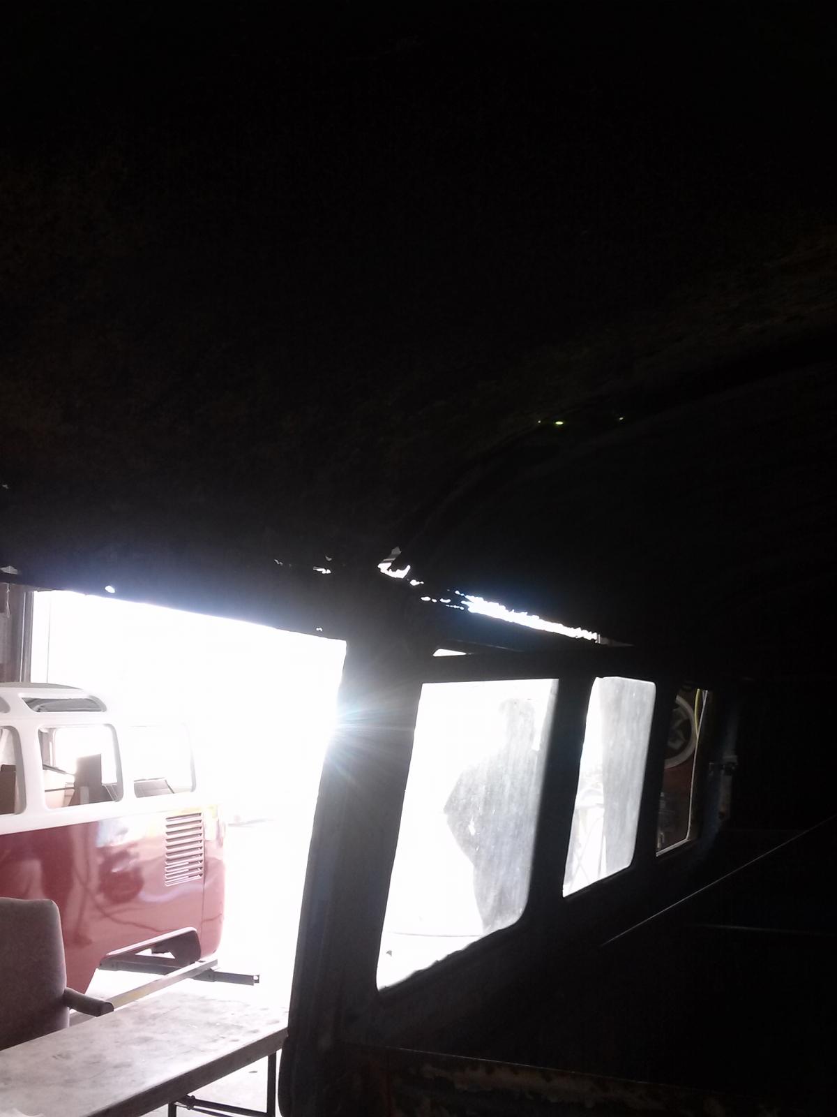

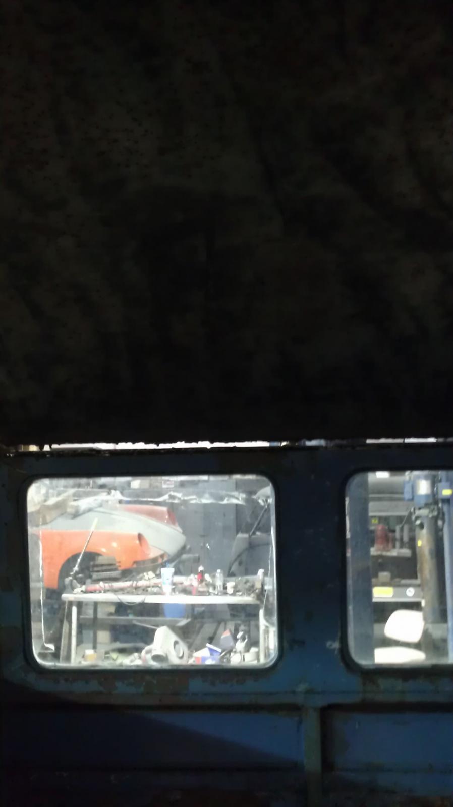

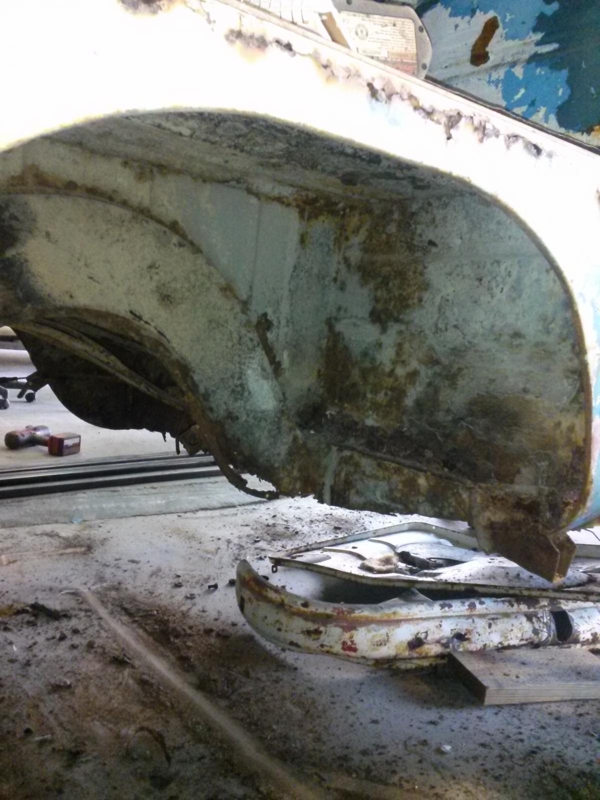

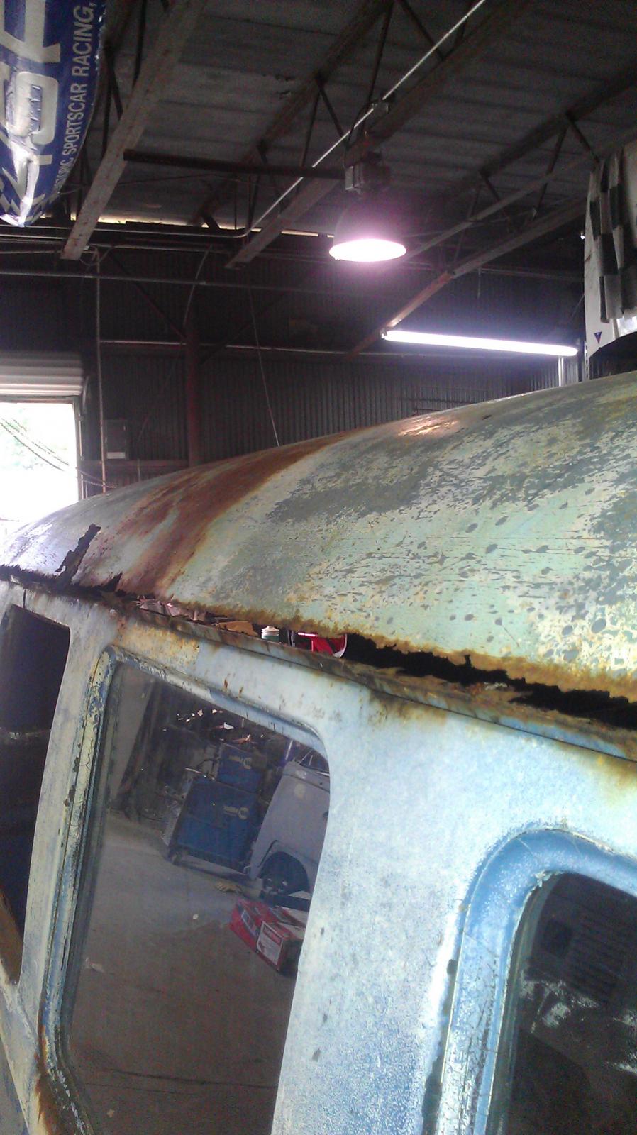

here are some more shots of how bad the roof line was.
I'm surprised that the roof stayed on from NZ to Florida
frame rot

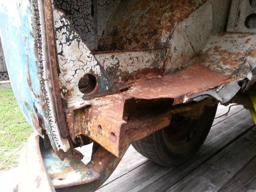

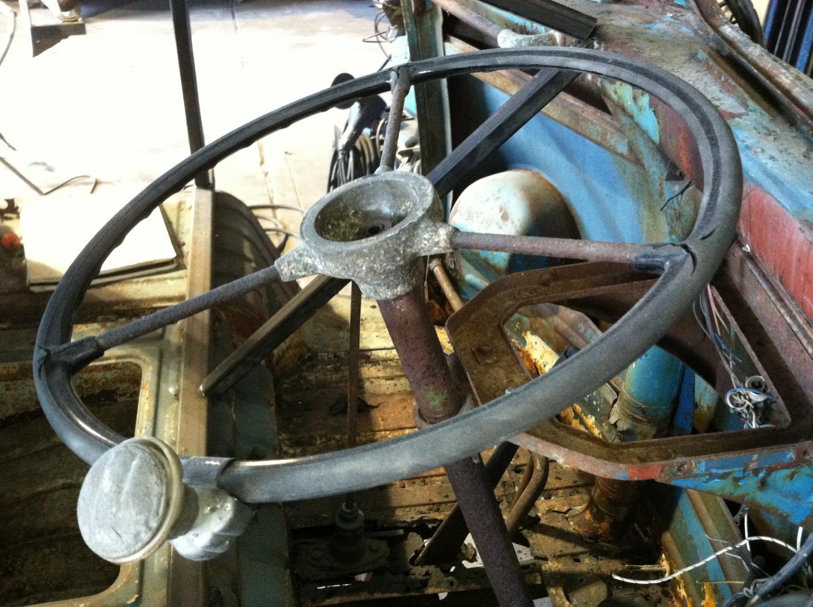

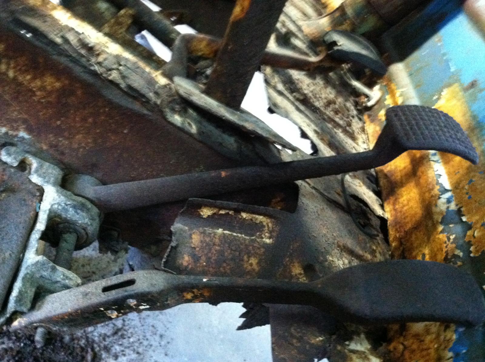

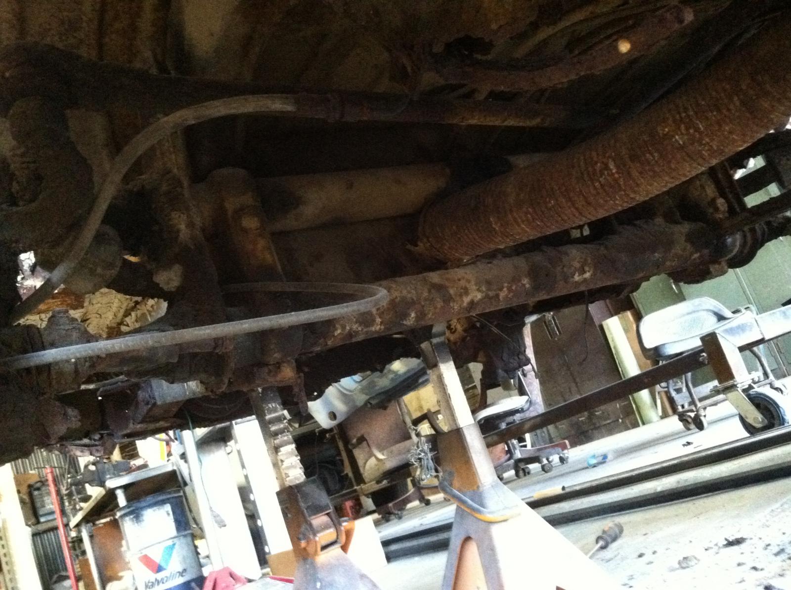

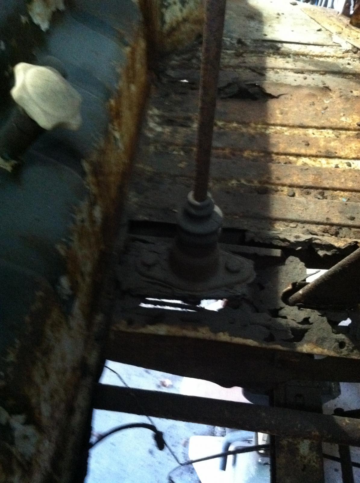

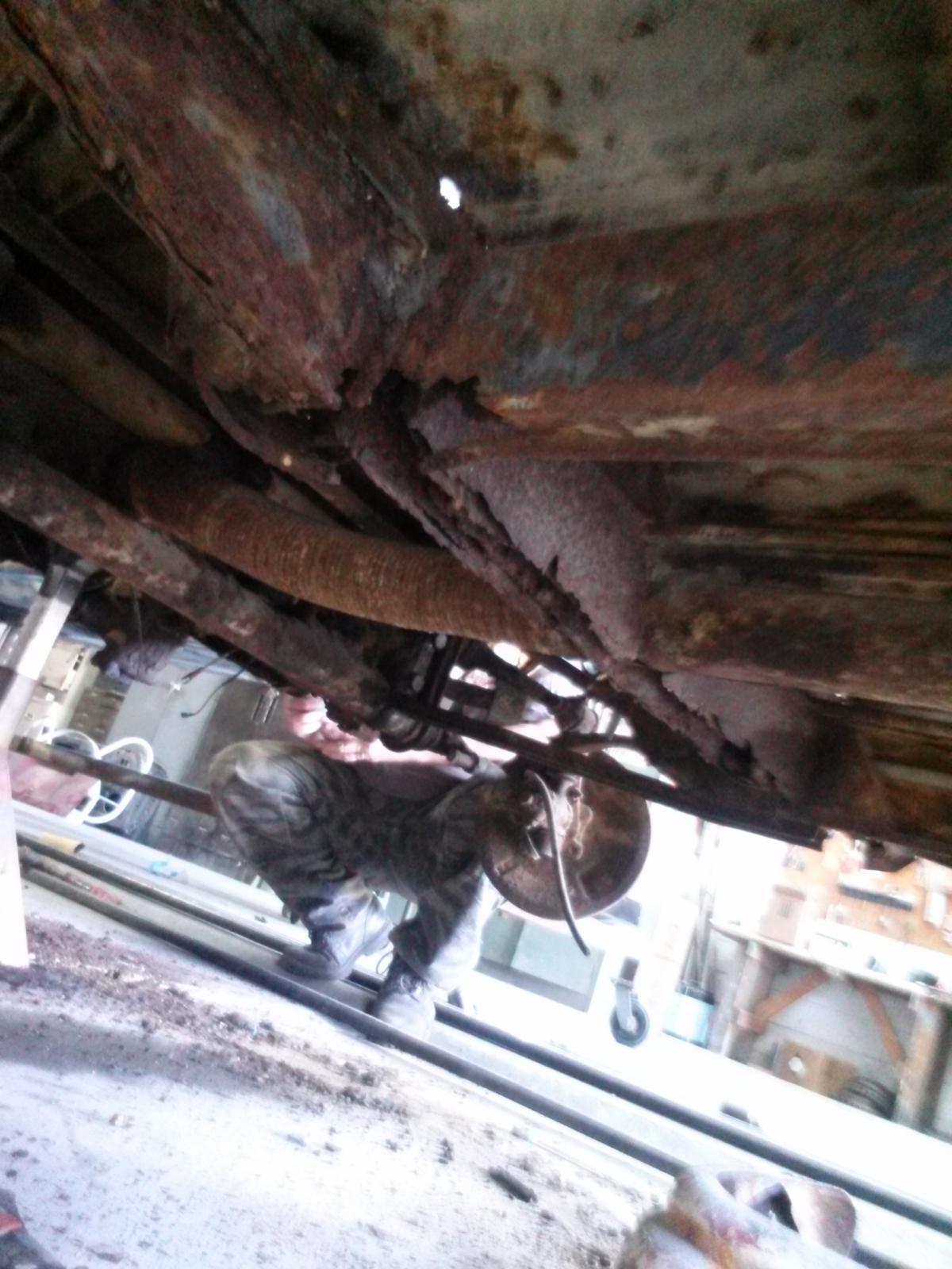

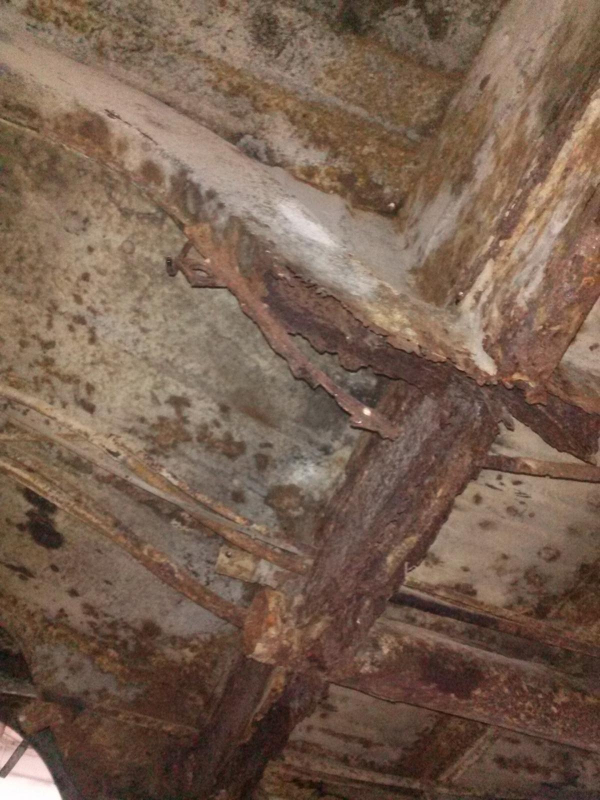

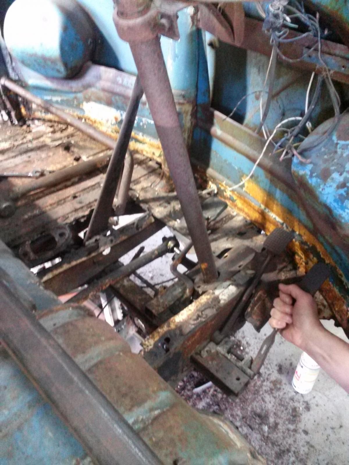

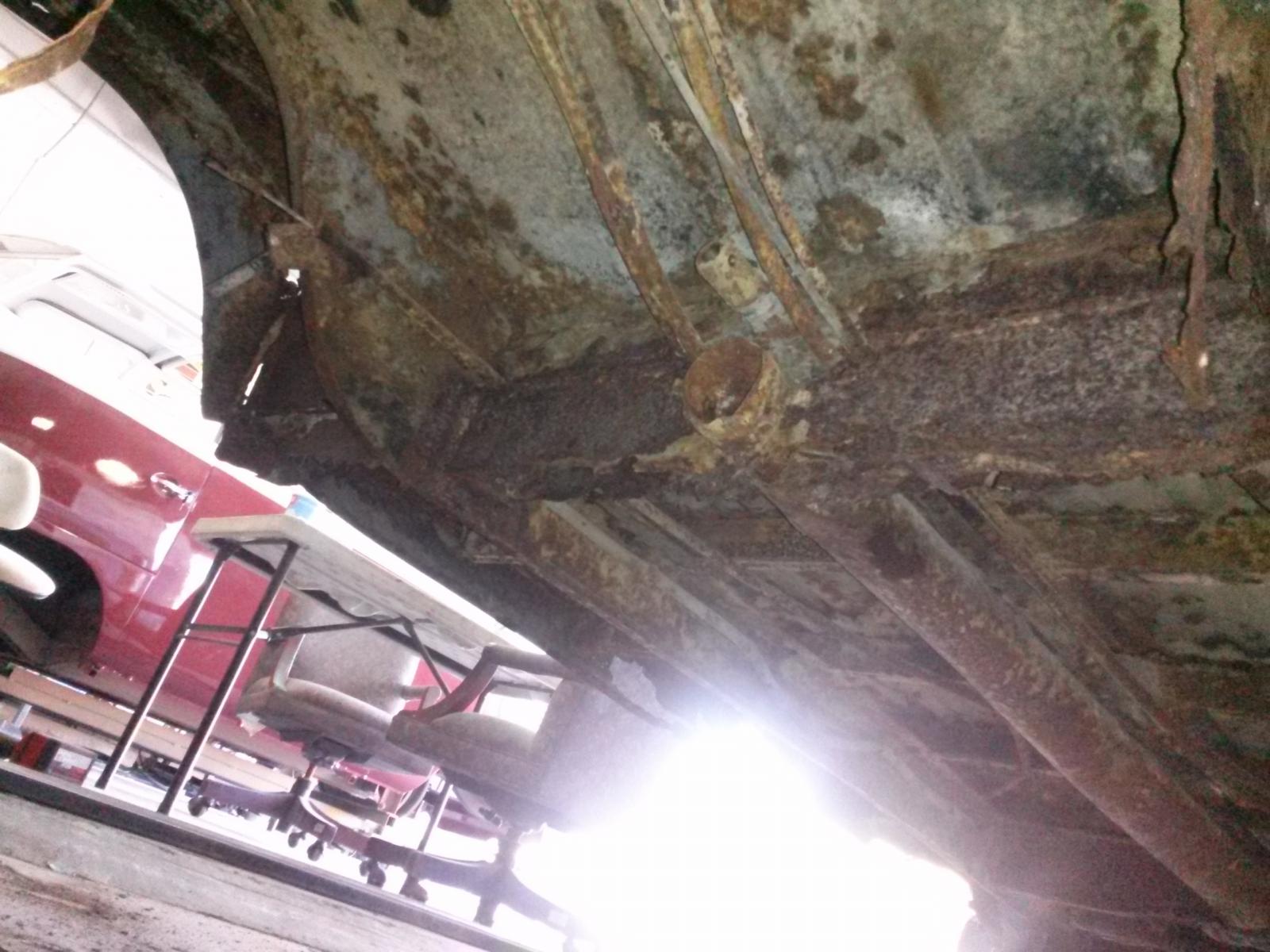

PostPosted: Tue Dec 17, 2013 7:13 pm    Post subject: Reply with quote
here are some pictures of the frame rot. this is why the body has to come off.
and one really cool angle of the RHD barn door pedal assembly

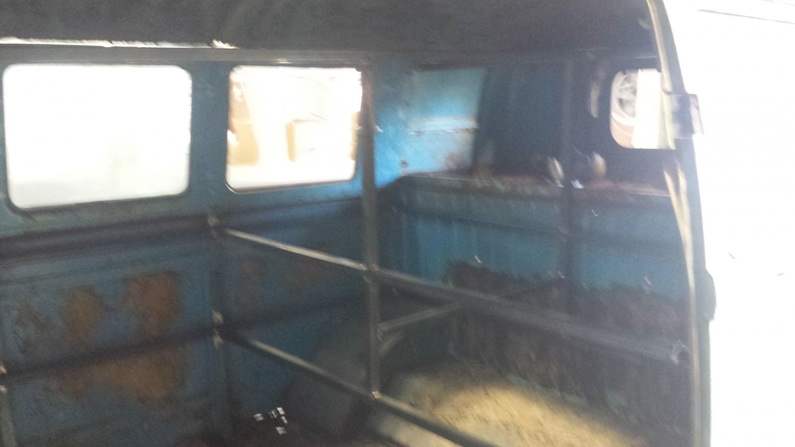

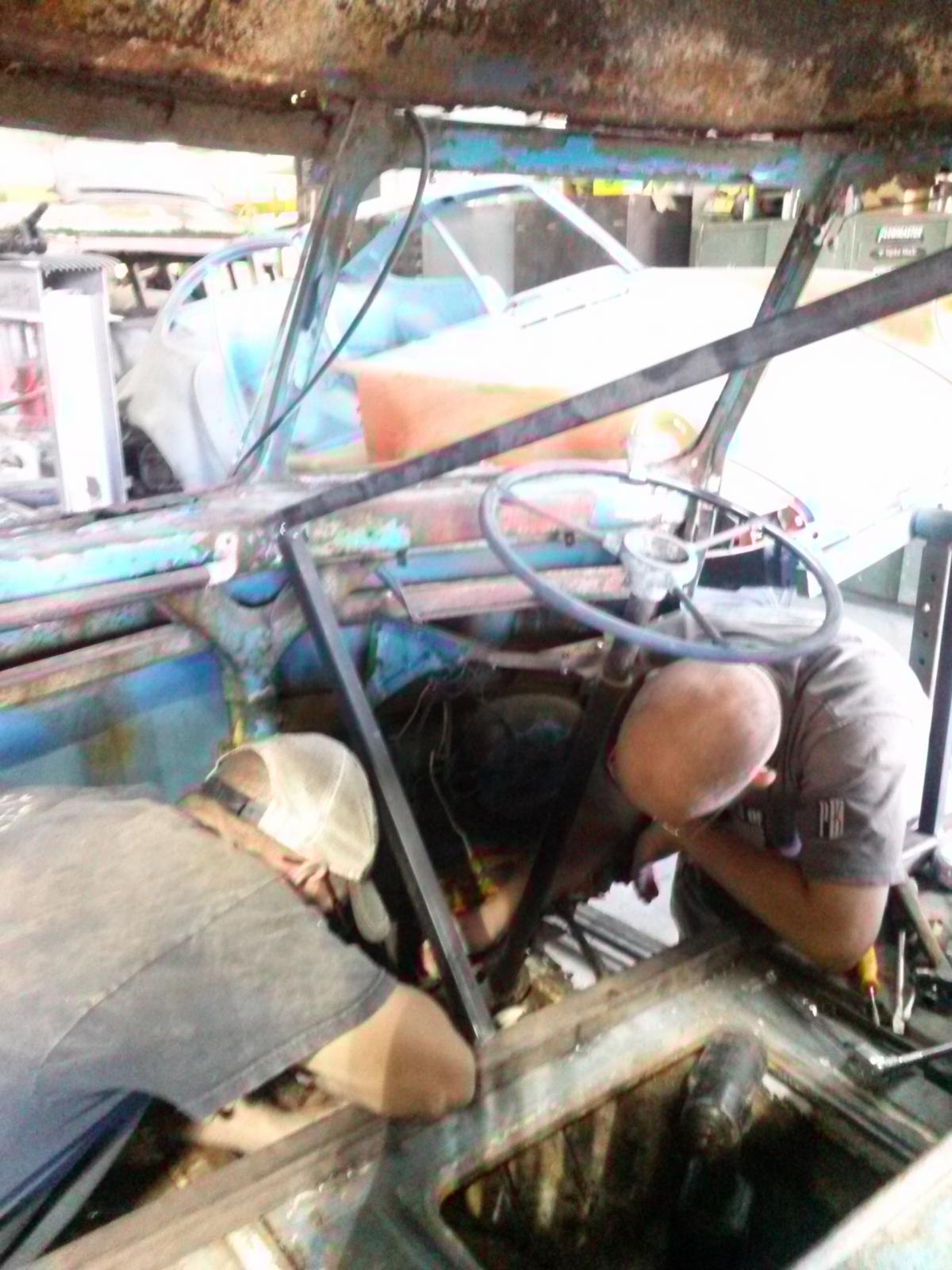

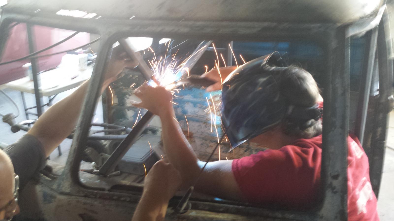

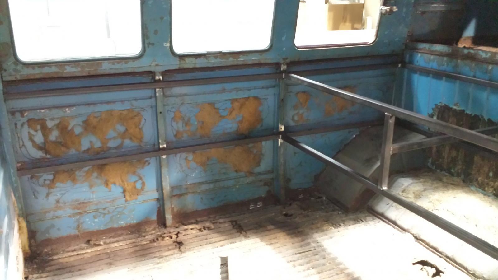

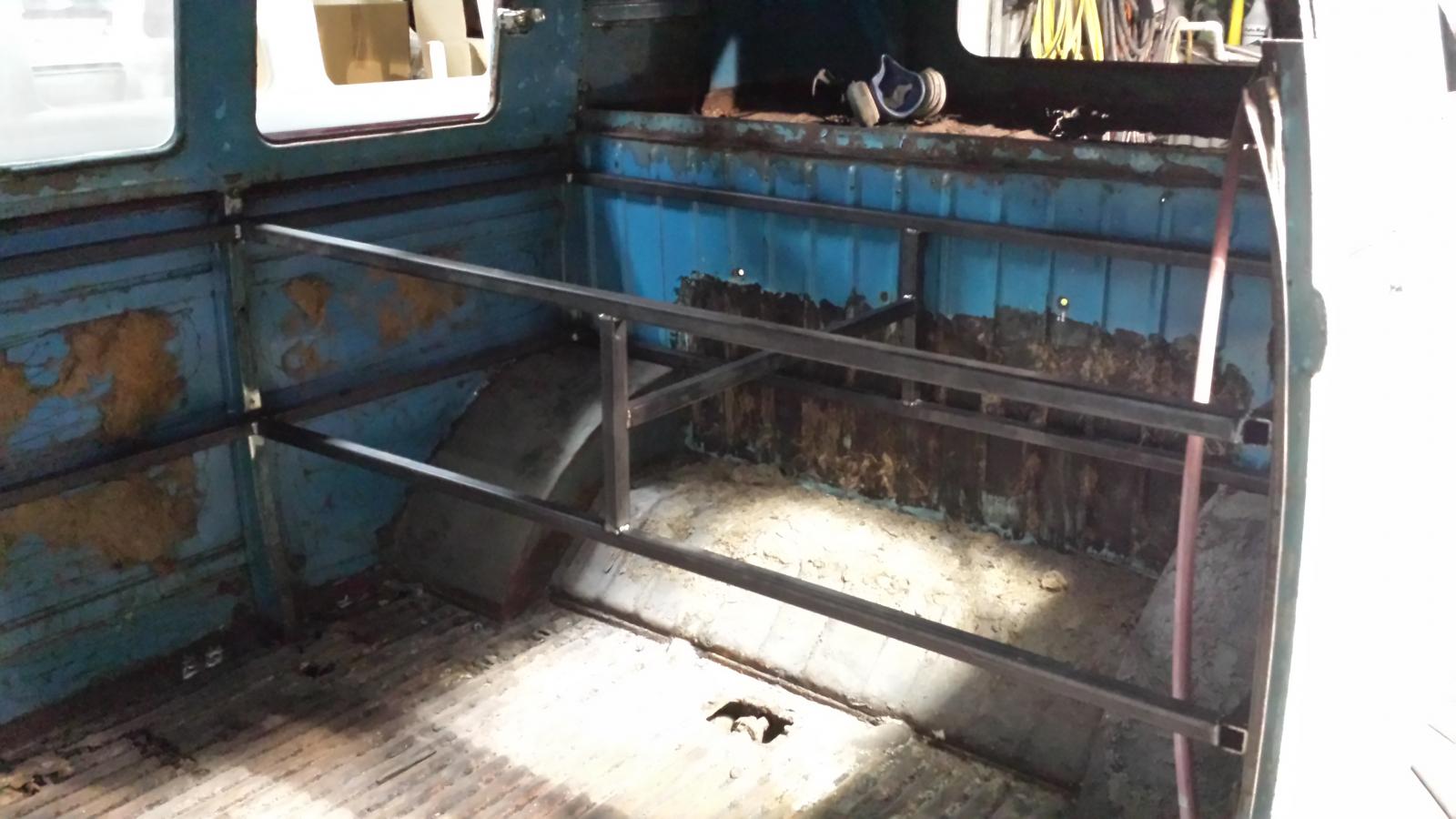

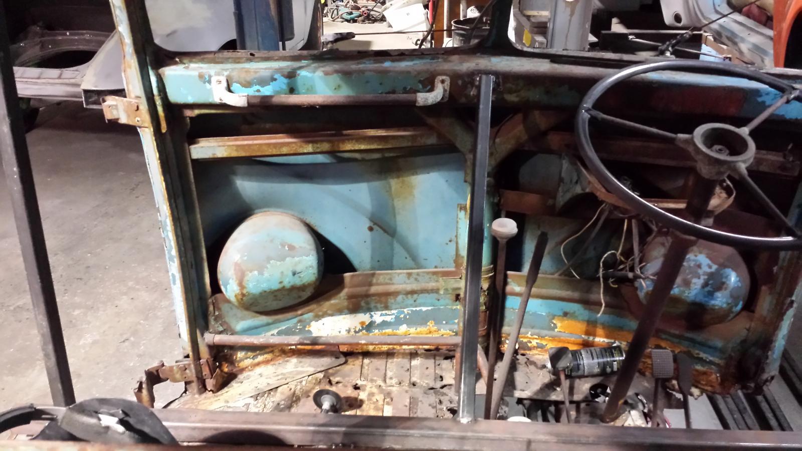

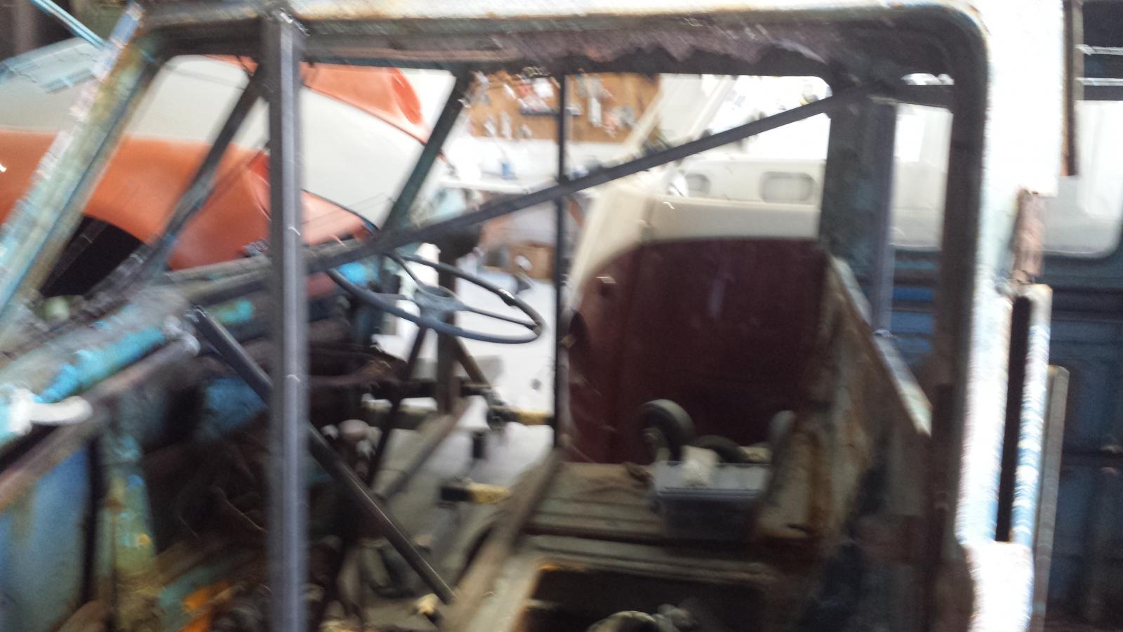

PostPosted: Tue Dec 17, 2013 7:31 pm    Post subject: Reply with quote

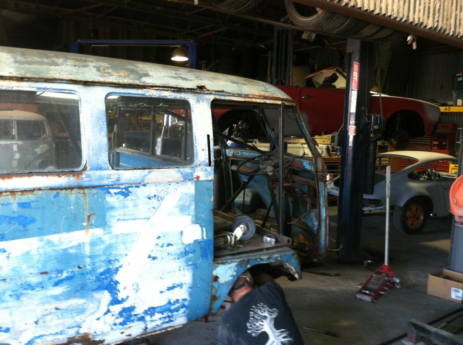

so the first step was to build a frame inside the body to give it support for the haircut it was about to happen to it.

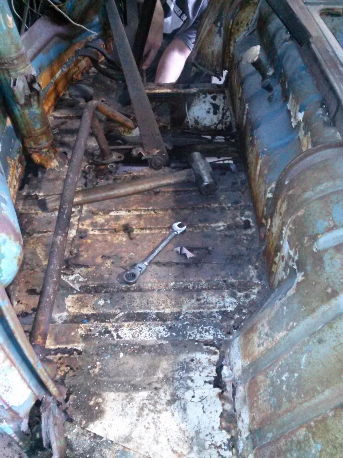

PostPosted: Tue Dec 17, 2013 8:04 pm    Post subject: Reply with quote
before i post the pictures of the top coming off i checked my old phone and found a couple more pictures. Czech them out
