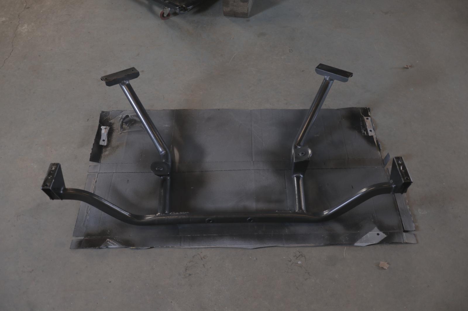

How about the end plugs for the engine carrier bar?
VW 070 199 219
seems NLA everywhere
Has anyone made those yet?
On mine one is missing, and the other is essentially perished. I have the engine out at the moment and am in the process of refurbishing the carrier bar. It seems blocking these water entry points would help in minimizing rust inside the bar.

^I can do them, would just need one to reverse engineer. I have a Suby conversion in my van.....
Me, too - with a moustache bar! Very Happy

I found this pic on the web for the engine carrier end caps. The remnant of the one I had is too destroyed to use as a template.

https://www.jwwinco.com/en-us/products/3.7-Connect...gK_DPD_BwE
I`m sure an industrial metric end plug can be found to fit...

I plan on making those plugs sometime in the near future. I retained the mustache bar as part of the support frame for my TDI conversion.
But right now I'm busy working on the exhaust and figuring out hoses, so it'll be a few weeks before the plugs are important enough to me to make up.

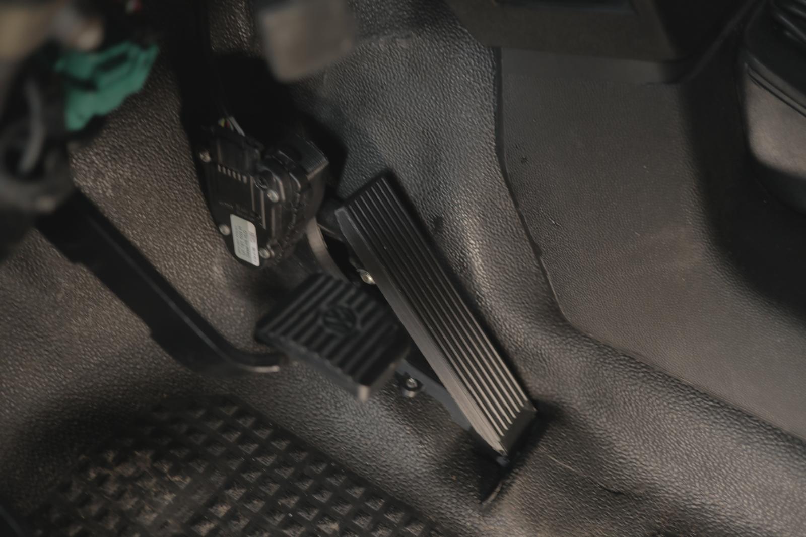

As my Doka ALH conversion nears completion, one of the last remaining puzzles was the throttle pedal. Rather than just taking the Jetta pedal and sticking it in the truck, I wanted to come up with something much more elegant. So I took apart the pedal and came up with a design so that it would function as a floor hinged pedal, as the original.
These are the pieces I would take from the Jetta pedal (the pin on the far right is actually from the original T3 pedal assembly):
Final printed throttle pedal. It's single assembly, so pedal and the potentiometer are aligned properly, and the whole thing is easily mounted:
Here it is fully mounted, an important part of my design was to make sure that, when at rest, the pedal was at the same angle as the original. VCDS shows the pedal functions properly, with a full range from 0-100%.

looks fantastic, very nice design, but im worried that the first hot day it will deform from heat. what infill percentage did you use? i try to print things as solid as possible for the heat range of a hot car which can soften PLA or ABS.
