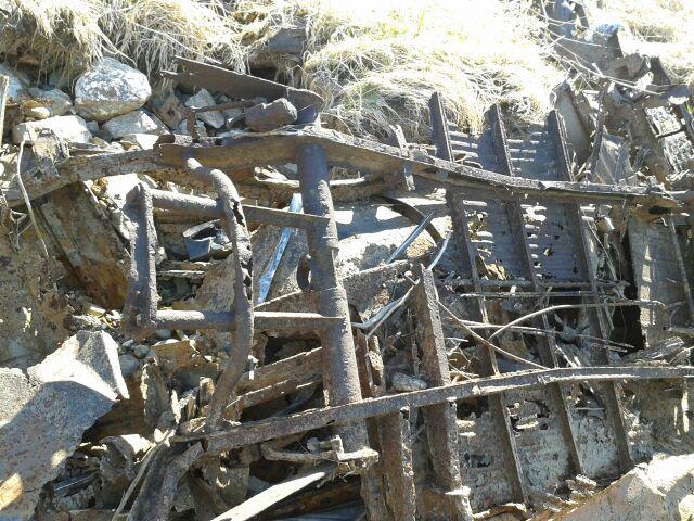

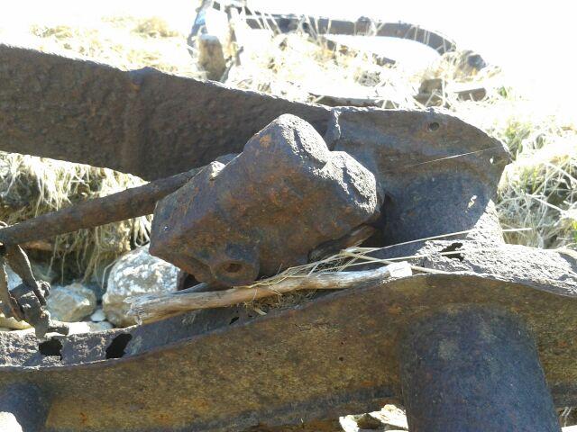

I was unable to locate vin number due to being submersed under water part of the year it is so corroded, where would vin usually be located ? Side of frame rail right?
So what do you guys think?

I wish I knew the whole story, but where I found it is in a spot where I think there used to be a junk yard on the river and they covered over it and made a park. There are cars or rather frames sticking out of the bank with rusted engine blocks sticking out of the bank......
Well I was walking with the girlfriend and the dog and just so happened to stop and walk over to the bank. Well I see the torsion bar suspension/ spring plate. Having done rust work on my split bus I instantly recognize the frame...... Excited I say that's a split bus!! Then i see the trans carrier tubing,Then I see the part by the spring plate and remember seeing that in the forums and knew it was barndoor..... Then I find 1/3 of the deck lid, then find some deluxe trim, then I crawl back up the bank and see the skylights.
I couldn't believe it!!! Shocked to say the least..... It was bittersweet..... I found a barn door...... Oh...... There's not even a vin number on the corroded chassis Laughing Laughing
Coolest thing is there is signs of faint logoing on the deck lid piece and other scraps I could find.
Seems the twisted aluminum trim survived the best, and there are some type of hooks in between the skylights???
Barn door pedals are very rough....
Not really much left and if its there it looks like it came off the titanic.... Anywhere I might of forgot to look form a vin?

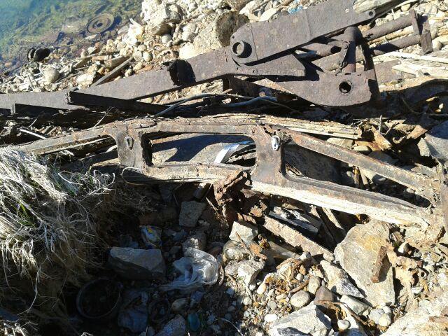

Nothing stamped on the frame rails. Just the engine bay and on the tag. Is there a front beam there?

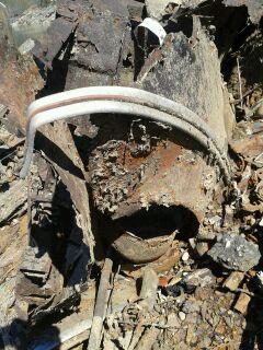

I don't see anything in those pics that would have a VIN #.
It's on the "hoop" above the transmission, where the seal rides:

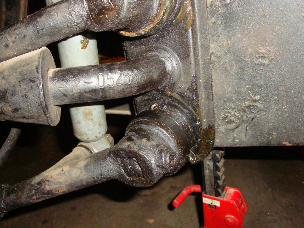

If there is some piece of front bulkhead there you could get the body #. It would behind the front passenger seat area.
Or the front beam has a stamped-in # on the right side arm that might give an idea of year.

Front beam is there! Its like a boat anchor but its there ! Why?

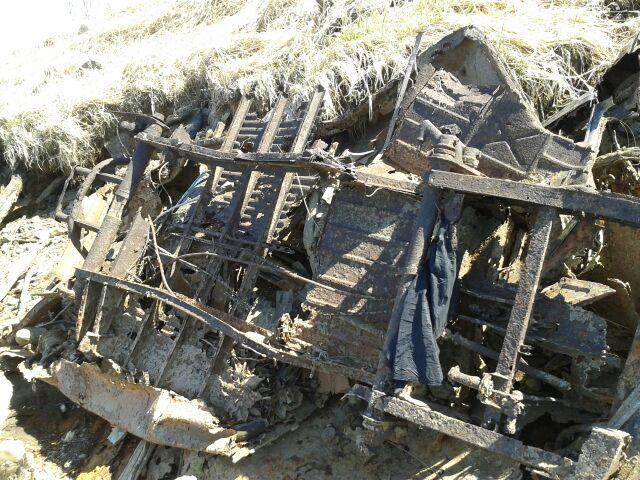

Here you can see the beam
And as for the trim I might have to do a lot of digging, lol, there's a rusted car push through what's left......

Did you drag it out for wall art. Like Everett said above there is a #stamped on the rubber snub mounts on the beam but it is a body number and not the vin. To narrow down the year. To me it looks mid 53. Early style trans horn reinforcement but shallow skylights.

Barndoor Front beam #
Then you can look it up here under Front Axle
http://www.thesamba.com/vw/archives/info/chassisdating.php

Zooming in closer. Those look like they are deep skylights. Any better pics of those? Or any front door parts to see if it has piano hinge vent windows?

I'll try to get better pics on the weekend, I can take a measurement to, know the measurement difference?

If you find a usable vin it's doable. I can think of 2 others being done which are just as bad.

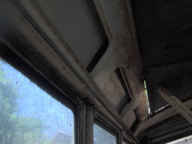

Can you check the skylights.
From the INSIDE if they have this recess...
Then it's a 53-55.
If it's flat from the INSIDE right up to the edge of the skylight opening then it's early 53 or before.
If you can find the dash that would say to. Look for a bit sticking out where the steering column goes.

The front axle number is stamped with large and quite deeply recessed numbers, you should be able to read it after some cleaning with wirebrush or scraper. As Everett posted the location here is where that would be on your sad heap Wink
