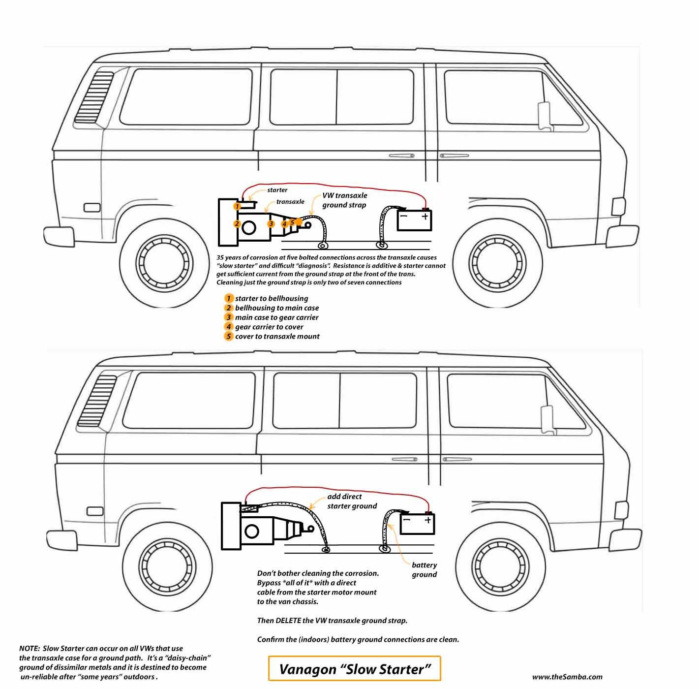

Incidentally you should add a dedicated ground from your alternator direct to the chassis.
That LiFePO4 battery, when its low, is gonna suck hard from your alternator, for a long time.
You want to ensure there are no lost volts.
And no stray amperage finding it's own way to ground due to 35 year old corroded connections.
Such as ruining your transmission bearings or wheel bearings and thru your parking brake cables etc.
If you add a dedicated ground then you only have to inspect two connections and ensure 100% of the amps willl travel there.
Here's a pic about slow starters, but it describes updating a (degrading) 35-year-old ground path.
