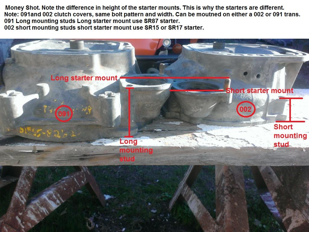

STARTER ID = WHICH CLUTCH COVER/BELL HOUSING YOU HAVE
1. To figure out which Starter you need. You first, need to figure out which Clutch Cover (bell housing) you have.
CLUTCH COVER ID
68-71 002 Clutch cover. (Note: No mounting ears and narrow engine mounting tabs)
72-75 002 Clutch cover. (Note: mounting ears and narrow engine mounting tabs)
76-79 091 Clutch cover. (Note: mounting ears and wide engine mounting tabs)
Note: 002 clutch cover mounting tabs are about 44mm (1 3/4"). Measure one of the bottom clutch cover mounting tabs. If it is about 1 3/4" (44mm) the clutch cover is a 002.
Note: 091 clutch cover mounting tabs are about 54mm (2 1/8"), 10mm wider than the 002
Note: the different widths of the starter mounts. This is why the starters
are different. The 091 starter mount is wider than the 002 mount.

STARTER ID
311 911 023 D, Bosch SR15, SR15X=Rebuilt: 002 Standard Trans. Requires new starter bushing.(Note: Pinion Gear is shorter than the SR87 091 starter)
(Note: SR17 can be used on all 002 clutch covers and does not require new starter bushing)
091 911 023, Bosch SR87, SR87X=Rebuilt: 091 Standard Trans. Requires new starter bushing.(Note: Pinion Gear is longer than the SR15 002 starter)
(Note: SR17 Auto starter, will not work with 1976-79 091 bell housing)
003 911 023 B, Bosch SR17, SR17X=Rebuilt: All Automatic Trans. 73-79
(Note: will fit all 002 standard clutch covers 1968-75 and does not require starter bushing)
(Note: Auto starter will not work with 1976-79 091 clutch cover)
