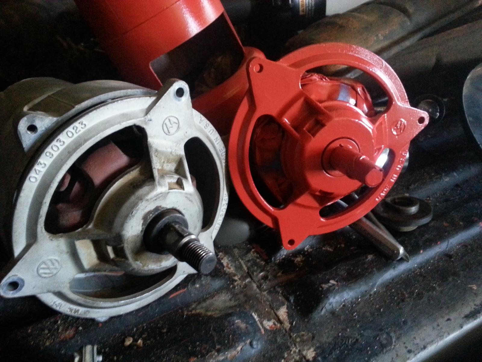

Thanks Dave. Now I wonder if after spending over $100 for a regulator that it could be a Diode as well. Do you know of any alternator parts sources for these? Or even what Model alternator that was called (model has been polished off)? It looks like an AL82 body except the brush/regulator area. _________________ -John Cox

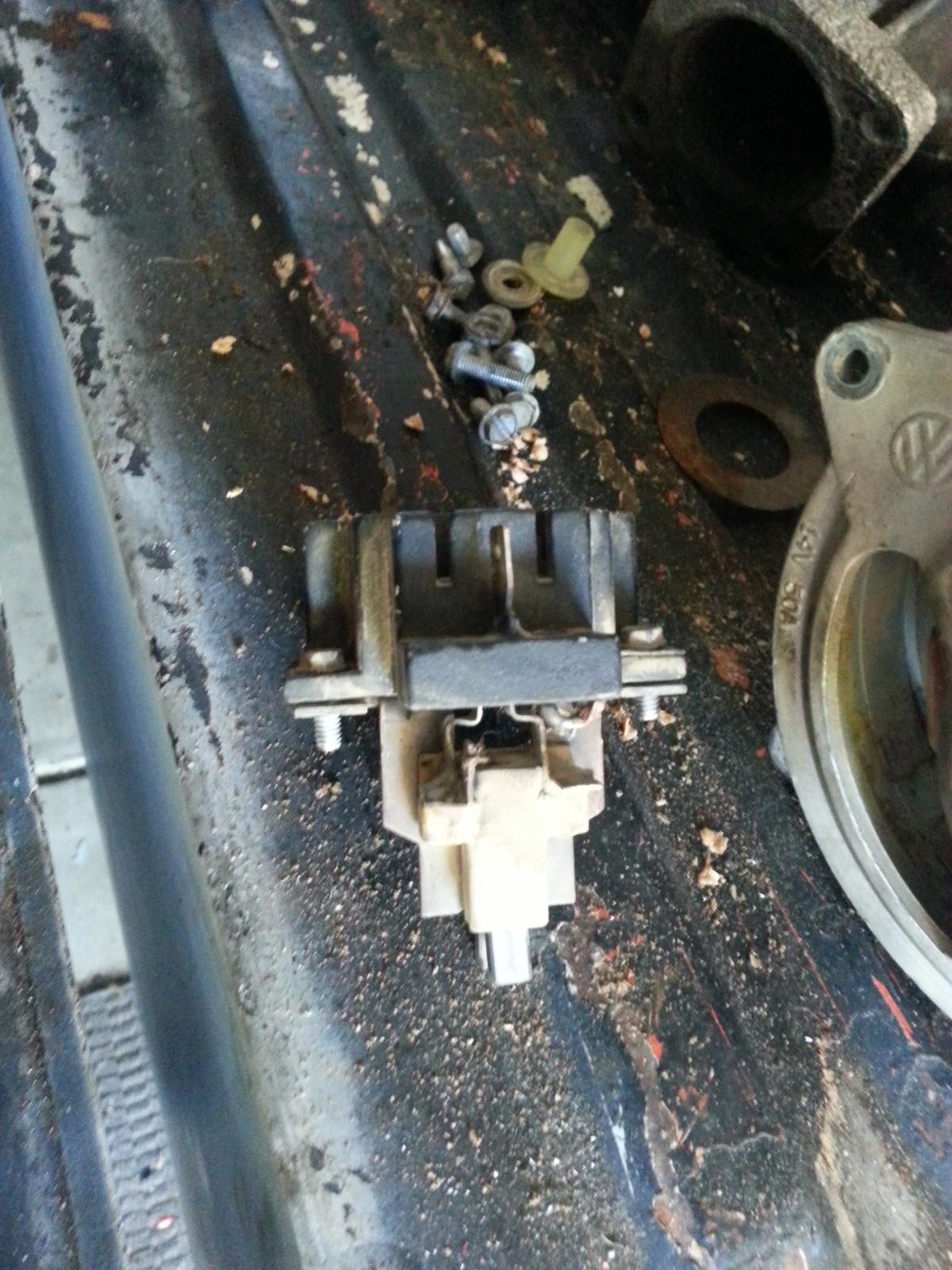

The light came on and it stopped charging so I took it off, took it apart and it looks like the regulator got pretty hot and probably died. Not sure on the diode but one of them might be gone as well. I threw it in the box and it's been there for a couple years. Rather than toss it when cleaning the garage I decided to see if I can revive it for my new 1957 Oval. _________________ -John Cox

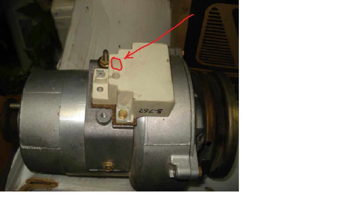

With all the numbers in the ad for the one you found it should be easier to source one.... Usually problem is finding a part number to begin with....
$4.31 ????????????
http://www.irpauto.com/SPEC.PDF
Some other numbers found...
The regulator 8RC2007, also goes by the stock numbers:
MA-240
105-762
M5-762
VR-1212
14991

You don't understand...... Yamaducci is looking for INTERNAL regulator for Motorola alternator...

This one...(ignore red arrow)
This actual unit...

You still have the wrong one. What Dale posted is what we are discussing and not what you have there. I did find a China maker who makes the ones I need but minimum order is 200 of them. If there was a high demand I woud do it but everyone has already moved on to the AL82 when they need a new one. Aparently _________________ -John Cox
