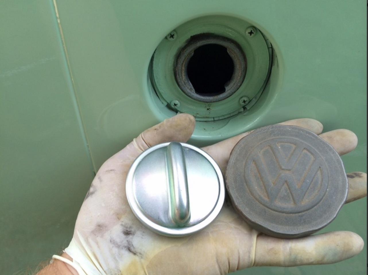

[b]Question 3: this one's easy - I had this old VW gas cap and wanted to use it, but it doesn't quite fit. Anyone know anywhere that makes a bigger cap that emulates this VW one, but for late bays?

welcome. The gas cap you need is a late cap made by Blau. You'll have to keep your eyes open for a nice one.
In the meantime go to your local Napa and get a Napa Balkamp BK 7031081 cap. As I recall, you can take the funky warning label off by pulling the screws, handle and then and putting them back after it is removed.

Oh, and Gas cap - would one like this, from a type 3 work? Looks like it would, but not sure on the measurements. Anyone know for sure?
I also found this if I can't do a VW script cap:
http://www.airheadparts.com/vintage-vw-parts/new-parts-past/gas-cap-locking-w-key-211201551-r
