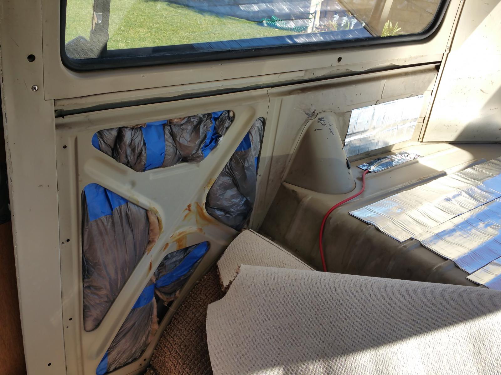

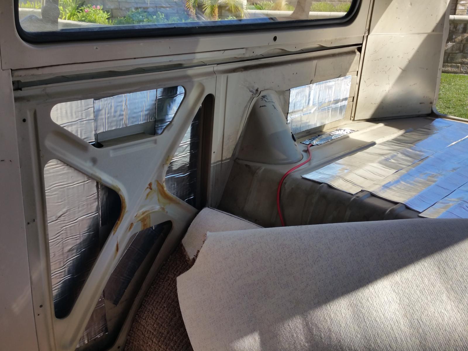

Just finished my last panel today.
Sound proofing and then insulation, followed by Birch panel.
Home made and proud. The rear door sounds like a new car when it closes.

Nice clean interior Dillion, I like it. Have you noticed a significant difference in road noise?

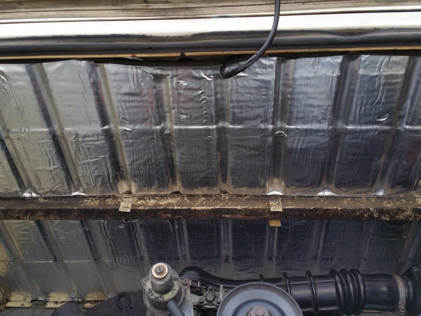

The difference is night and day. Now you can have a conversation with someone in the backseat at 55mph. The stereo sounds sooo much better too.
I plan on doing the engine compartment above the motor. I was going to do it on the inside on top of the motor compartment, but couldn't bring myself to cover the OG paint. It's just setting on there and not stuck down.

Do you have any pics of what you did around the front doors? I'd like to put thicker sound proofing material in there, but it might be tough with the window. I'm curious to see what you did. Thanks.

You can double layer some of the thinner materials out there for more density in larger panels, but remember, more material equals more weight.
I doubled the doors, side panels and every other strip on the ceiling. I will also double up the engine bay above the motor.

Engine bay top, done..... My arms are tired...
I wonder how that will handle the heat on a hot sunny day.
__________
’71 Westy build
Adventure thread
’65 Deluxe Build
dillon70
Joined: October 20, 2008
Posts: 234
Location: Ventura, Ca.
dillon70 is offline
PostPosted: Mon Jan 26, 2015 7:49 pm    Post subject: Reply with quote
I was thinking of some aluminum diamond plate pieces cut to fit. The existing tabs should keep it up and add some unseen bling.
I recently had to strip some of that stuff. I think it's stock Westy. heatgun melted it and made an unbelievable mess. Hair dryer on hi was about right used carefully. You could just pull it away intact---and sort of roll it away.
I don't think you'll have problems but you might try a hair dryer on a corner and see if you can make it sag. You can always poke it back when it cools.
