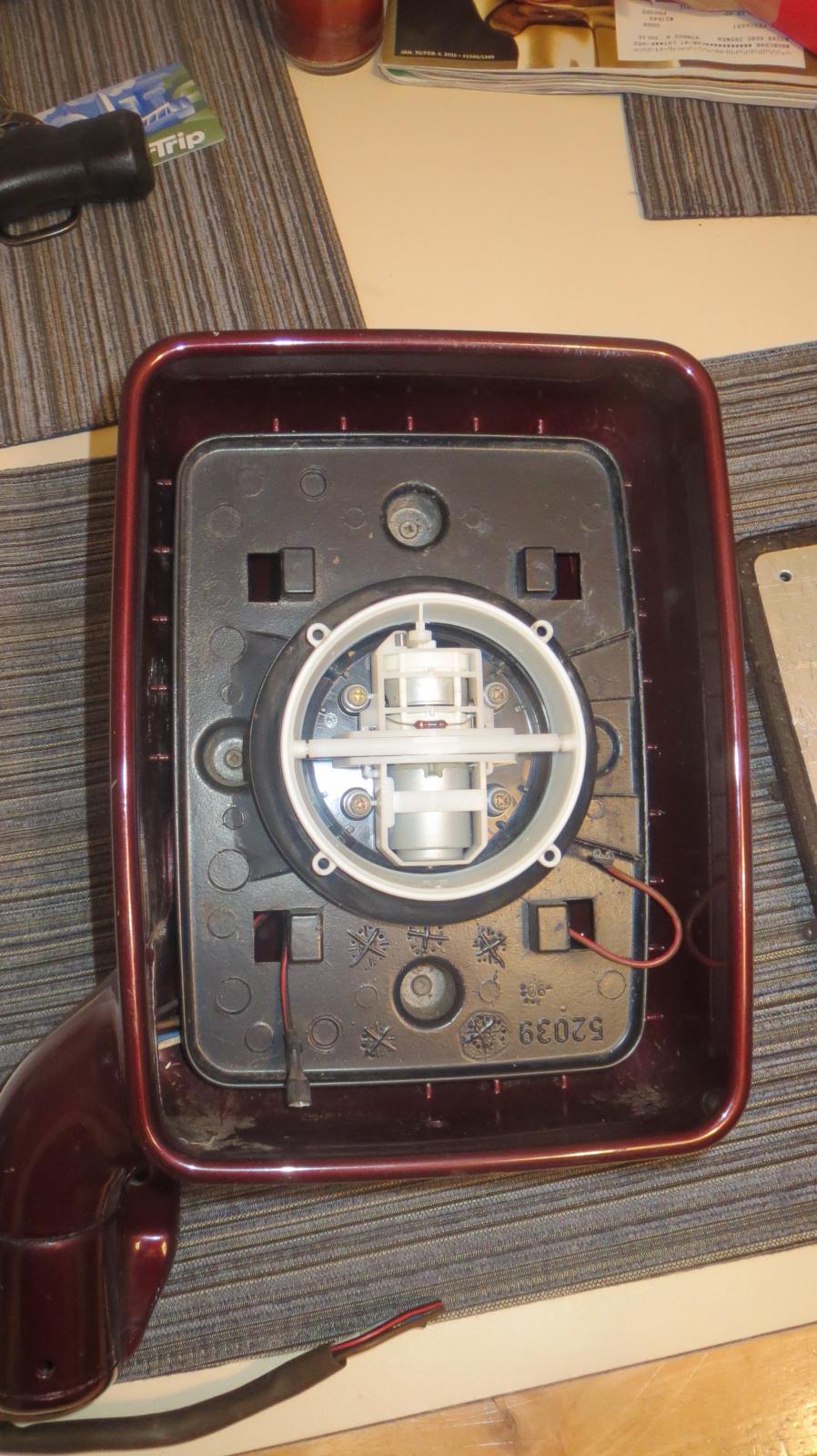

I had explained the process of removing the glass from it's backing on Vanagon.com but you can't put pix on there so here they are. I learned a little from the first one and applied that to my second attempt and it worked quite well. I actually got the glass off in one piece!! Starting with a corner, I wedged a small screwdriver in between the glass and the metal plate. Slowly working away from the corner in both directions I kept adding screwdrivers and tapping them in with a hammer up to the screwdriver handle. When I ran out of those, I started using wooden skewers to wedge into the largest opening and kept tapping them in as the glass slowly seperates along with a few squirts of Goo Gone to help he process I finally got the last 1/4 of glass to just pop off. Nice!!! I cleaned up the metal plates making sure I didn't lose the little retangle contacts (3) and glued them back into place. Now ready for the new glass mirror and then to get them wired and installed!! Oh, and whoever these mirrors came from must have been hearing a serious buzzing sound....LOL!!

Thanks for posting. What is being shown in the close up picture? Is that something to be avoided with the shims during mirror removal?
Where to source replacement glass? Is there anything special about the glass?

If you bought those mirrors from GW or VC they are designed to be an overlay. The heater will work as well as they did originally. If you look in my Gallery you will see where I froze one of them and hooked power to it and it worked like a dream.
Those mirror blanks are made from the finest German mirror and are totally distortion free.
I would not advise to remove the mirror from its backing as the plastic is flimsy and you can damage the heating unit. Once installed either way they are are a great low cost alternative to a complete plate.

Instructions on power mirror glass removal/replacement Bentley 66.3
This illustrates how to remove the mirror plate from the electric motor assembly housed within the body of the mirror.
This would be the first step in the process that the OP is illustrating to separate the glass from the plate........
Removing the glass from the plate is painfully slow, but it does look better than a double layer of glass.
