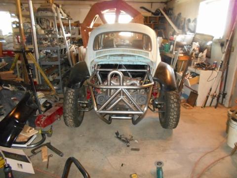

PostPosted: Mon Mar 16, 2015 10:02 pm    Post subject: Reply with quote
The ebay header
Working on the new engine cage last weekend
Hoping the final product looks something like this. With the paneling and air screens.

PostPosted: Sun Mar 29, 2015 9:06 am    Post subject: Reply with quote
^^^ Yeah they do look a lot alike. I'd be interested to see how the final product came out with your radiator and mounting.
I'm in a toss up between running a jeep cherokee radiator in the rear (35'' x11.5'')or mounting a radiator up front under the fiberglass.
Going to get back at it today.
Time to torque the flywheel with the ARP bolts i got, install the clutch and pressure plate (Kennedy Stage2 with HD Daikan Disk.) Get the engine back in and finalize the rear seat mounting! Cool pics likely to follow

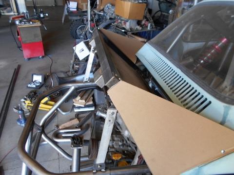

PostPosted: Sun May 03, 2015 9:41 pm    Post subject: Reply with quote
Little progress shot:
Went with a Jeep Cherokee Aluminum radiator, reconfigured the inlet & outlet and made an aluminum fan shroud for it.
Engine wise everything is about wrapped up and will be moving on to wiring and fuel system soon.
