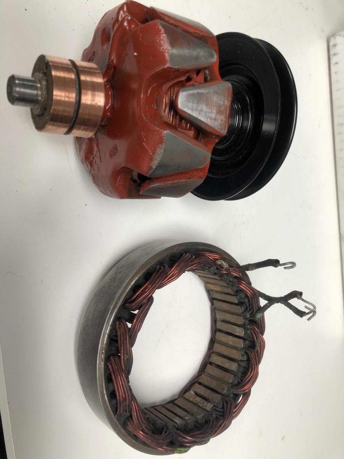

On the left are some parts that have been going well,
And on the right is a similar alt from a 914.
(In case i need to go back and see what I'm missing, or did wrong..) Embarassed
In the middle is my conundrum.. Back to that later.
We'll start with the good parts..
The pulley and rear cover plate got black powder-coat.
The fasteners went out to cad plating.
The front housing/cover got vapor blasted,
And,
Best of all,
The rotor got restored for me by Osuna's Auto Electric in Watsonville, CA.
They also soldered some new brushes in my holder there as well..

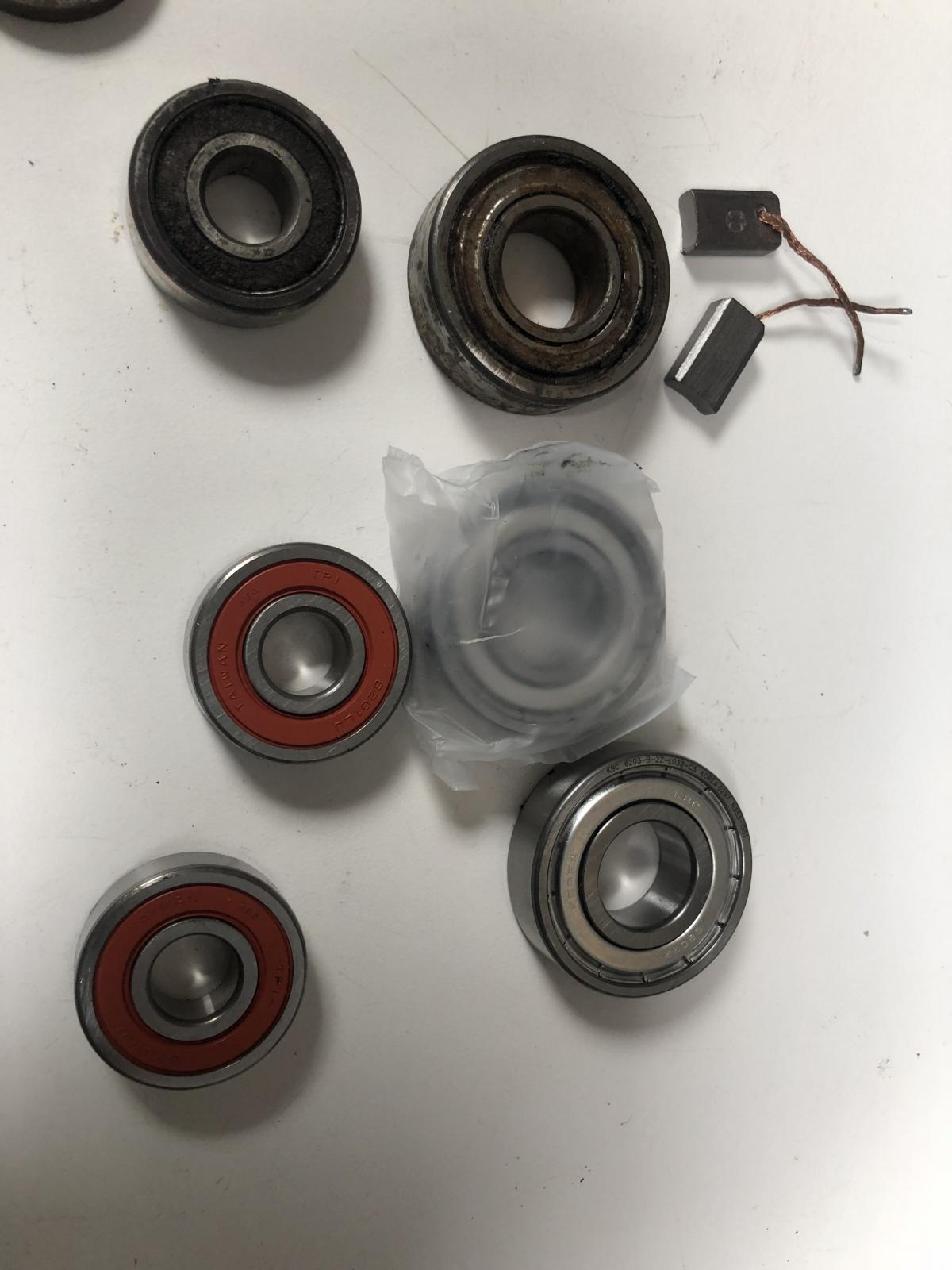

First question i have is about bearings.
The guys at Osuna say that these Korean bearings are the best available today,
and some China bearings were causing come-backs for them.
They had all of the stuff right there on the shelf! Shocked
Does anybody know where to get good German, say, SKF or FAG bearings?
Was going to start digging, doing Google-Fu, but maybe a Wise Wizard here knows where??

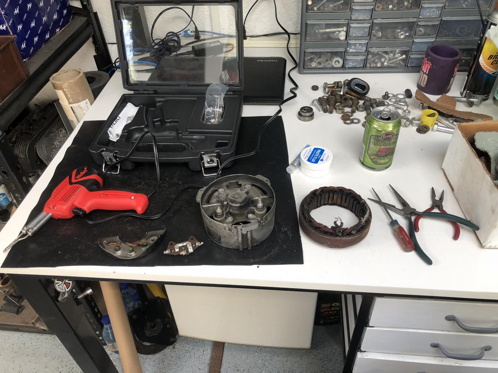

Here's where the crux of my problem lies:
How to get this un-soldered?
I tried using this little heat gun and tiny soldering pencil,
But,
As i might have guessed,
It wasn't near enough..
Who out there has a favorite proper soldering gun and/or kit?
With a couple of these here to do,
Might as well get a decent soldering iron..

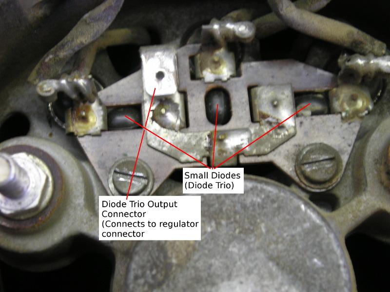

Look at the soldered connections here (just below the black positive diode plate):
See the three (unlabeled) wires coming from the stator assembly? Those are the only three wires you need to remove to test everything. I use a small sheet metal type soldering iron or a good 'ol Weller soldering gun for disassembly. Most soldering irons just don't have the heat capacity to get the job done. My temp controlled 60 watt Weller WP60 is barely adequate. What you want is a LOT of heat - but not that much temperature. 700 degrees F is plenty. But tip mass gets the job done.
Tin the iron tip, then carefully heat the wire junctions where the stator wires connect to the diode trio board:
Use a pair of needle nosed pliers to carefully loosen, unwrap, and free each stator wire. BE CAREFUL! The terminal strip they're connected to is made from bakelite, and is weak, brittle, and won't take much torque or force! Some people like to use a solder sucker or braid to remove the old solder first, then just unwrap the clean wire, but I find the old solder helps conduct heat into the joint. Try it both ways and see which works better for you. In any event, once the wires are off, remove as much of the remaining old solder as possible.
Once the stator wires are off, you can check all of the diodes with an ohmmeter. If they're all good, even though they are still connected together, they will show conduction with only one polarity of the ohmmeter leads. The opposite polarity will show infinite resistance. (Note: use the 'diode' ohmmeter range, if your meter has one.)

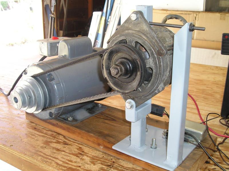

The fun part is getting the brush holder reinstalled and the rotor back into the case. I used a short 2" length of coat hanger wire or welding rod to hold the brushes into the brush holder frame by pushing the brushes into the holder, then snagging their lead wires, holding them in. Once everything is reinstalled, you can carefully pull out the wire, setting the brushes free.
Other pics:
Test stand:

can't help out with soldering or electrical, but those bearings look exactly like skateboard wheel bearings, if you cruise by your local skate shop you could see if they have swiss or ceramic, and make sure they are the same size. They will be packaged in 8's, but you said you have a couple to do.
https://bonesbearings.com/bones-reg-swiss-skateboard-bearings-8-pack

Went by my friendly local hardware store,
They had a 100/140 Weller gun for sale,
And it worked a treat!
Stuff just popped right apart..
So, how to properly clean the stator assembly here..?
Solvent tank?
Bead blast?
Does the red insulation paint go on afterwards?
With the surfaces adjacent to the rotor clean and paint-free, right?

Don't bead blast that stator, the red color on the wires is insulating varnish, remove some of that and they might get freindly with each other in a not so good way. Solvent or maybe brake kleen (if it's the stuff that doesn't dissolve the varnish) to clean and degrease (solvent and compressed air has always worked for me). Then perhaps tape up the wires and carefully wire brush or wire wheel the exposed steel parts and give them a light shot of paint?

PostPosted: Wed May 02, 2018 9:18 pm    Post subject: Re: Alternator Rebuild (long) Reply with quote
I wouldn’t use anything of a solvent nature or that is at all abrasive. I’d probably just use soap and water and a soft bristle brush. What’s the word from Telford?

PostPosted: Thu May 03, 2018 12:52 am    Post subject: Re: Alternator Rebuild (long) Reply with quote
My inclination would be to leave the stator alone. That enamel insulation is 40 years old and likely can't take a joke. Yeah, it looks nice when it's all clean and shiny, but I'd resist that temptation, as it won't improve performance or reliability one whit. Even the steel laminations making up the stator core have varnish on them so they don't short to each other (otherwise, the rotor will induce a circulating current into the core, causing severe losses, which is why the core, like all AC motors, is made up of insulated laminations, not solid metal).
Do inspect the stator carefully for burned insulation, bare spots, etc. There is a flying splice where the three coils which make up the stator come together. Make sure this isn't touching anything, causing a short. A small length of shrink tubing over it would be nice.

PostPosted: Sat May 05, 2018 4:08 pm    Post subject: Re: Alternator Rebuild (long) Reply with quote
OK,
Spent a bit of time with this..
The diodes al check out fine.
Washed the parts all down with some gas and a toothbrush;
Didn't dunk it under, just dip a toothbrush in gas and scrub it down.
It got hosed down with brake parts cleaner and compressed air.
Hit the OD of the thing, where the red paint was flaking off all crusty, with a wire wheel.
Also masked off the diodes and label for blasting..
So,
Should the entire stator get hosed down with that red insulation paint?
Seems like they had the whole ting painted from the factory...?

PostPosted: Sat May 05, 2018 4:14 pm    Post subject: Re: Alternator Rebuild (long) Reply with quote
Something else...
On the stator;
Does the area facing the rotor get the paint cleaned off so it doesn't get insulated?
The electric shop cleaned off the area on the rotor that faces the stator.
Everything else got painted with that red insulation paint.

PostPosted: Sat May 05, 2018 5:48 pm    Post subject: Re: Alternator Rebuild (long) Reply with quote
Clatter wrote:
On the stator;
The shop probably spray-painted the rotor with the red stuff, then cleaned it off of the pole faces so it wouldn't rub the stator, abrade off and get everywhere, making a mess. The stator and rotor operate very close together. As long as they don't touch / rub, operationally it doesn't matter if the red stuff is there or not. The red stuff will keep the metal underneath from rusting, which is good, and protect the windings from moisture and abrasion. Remember, there's a lot of cooling air blowing through there, and it's unfiltered. Any dust / grit would be kinda like sandblasting...
