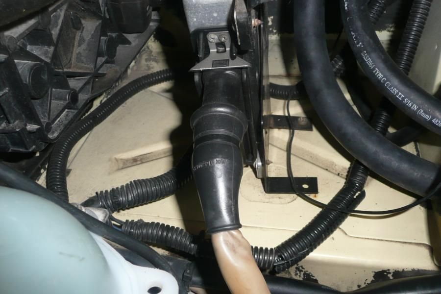

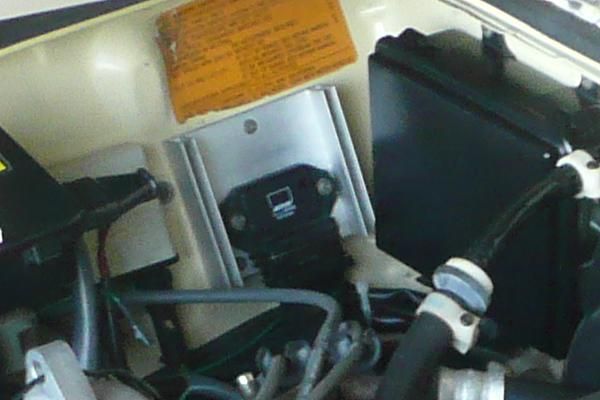

PostPosted: Fri Aug 05, 2016 8:26 am    Post subject: Re: Digijet controller locations? Reply with quote
Look for the ECU just forward of the left hand tail light:
And the Ignition Control towards the left front side of the engine bay:
If you remove that module you'll want to use some special paste behind it to assure good conductivity with the heat sink. 'Special' but I have heard that even toothpaste will work well enough.
