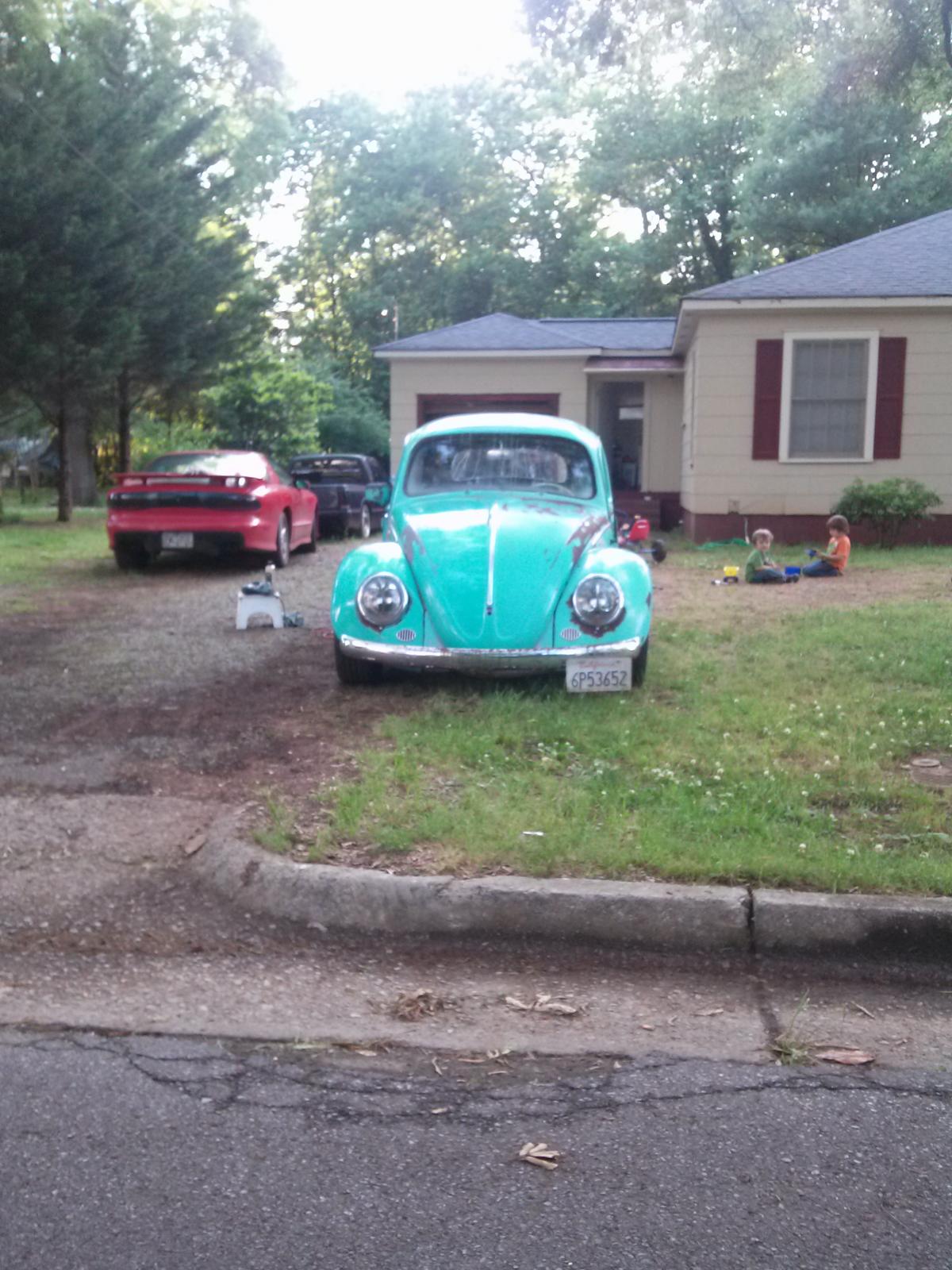

PostPosted: Thu Jul 09, 2015 12:26 pm    Post subject: Reply with quote
I like my adjustable beam i can go from stock hight to slammed in 5 mins any time i want to

63vbug82
Joined: April 16, 2015
Posts: 146
Location: Cedartown Ga
63vbug82 is offline
PostPosted: Fri Jul 10, 2015 1:09 pm    Post subject: Reply with quote
Airkewld wrote:
Is that with alignment too?
The alignment stays close but dose get thrown off some but nothing really bad but when i raise it fixs the alignment so its ok with me on that part because i can use a tow bar if i have to and not rip the front apron and fenders off

PostPosted: Fri Jul 10, 2015 2:19 pm    Post subject: Reply with quote
63vbug82 wrote:
Airkewld wrote:
Interesting. I have seen it change drastically from stock to slammed. How many inches are you talking about?

63vbug82
Posts: 146
63vbug82 is offline
PostPosted: Fri Jul 10, 2015 2:37 pm    Post subject: Reply with quote
63vbug82 wrote:
Airkewld wrote:
4 inch. No drop spendles
63vbug82
Posts: 146
63vbug82 is offline
PostPosted: Fri Jul 10, 2015 2:38 pm    Post subject: Reply with quote
63vbug82 wrote:
Airkewld wrote:
63vbug82
Posts: 146
63vbug82 is offline
PostPosted: Fri Jul 10, 2015 2:39 pm    Post subject: Reply with quote
63vbug82 wrote:
63vbug82 wrote:
Airkewld wrote:
Running wider rubber
