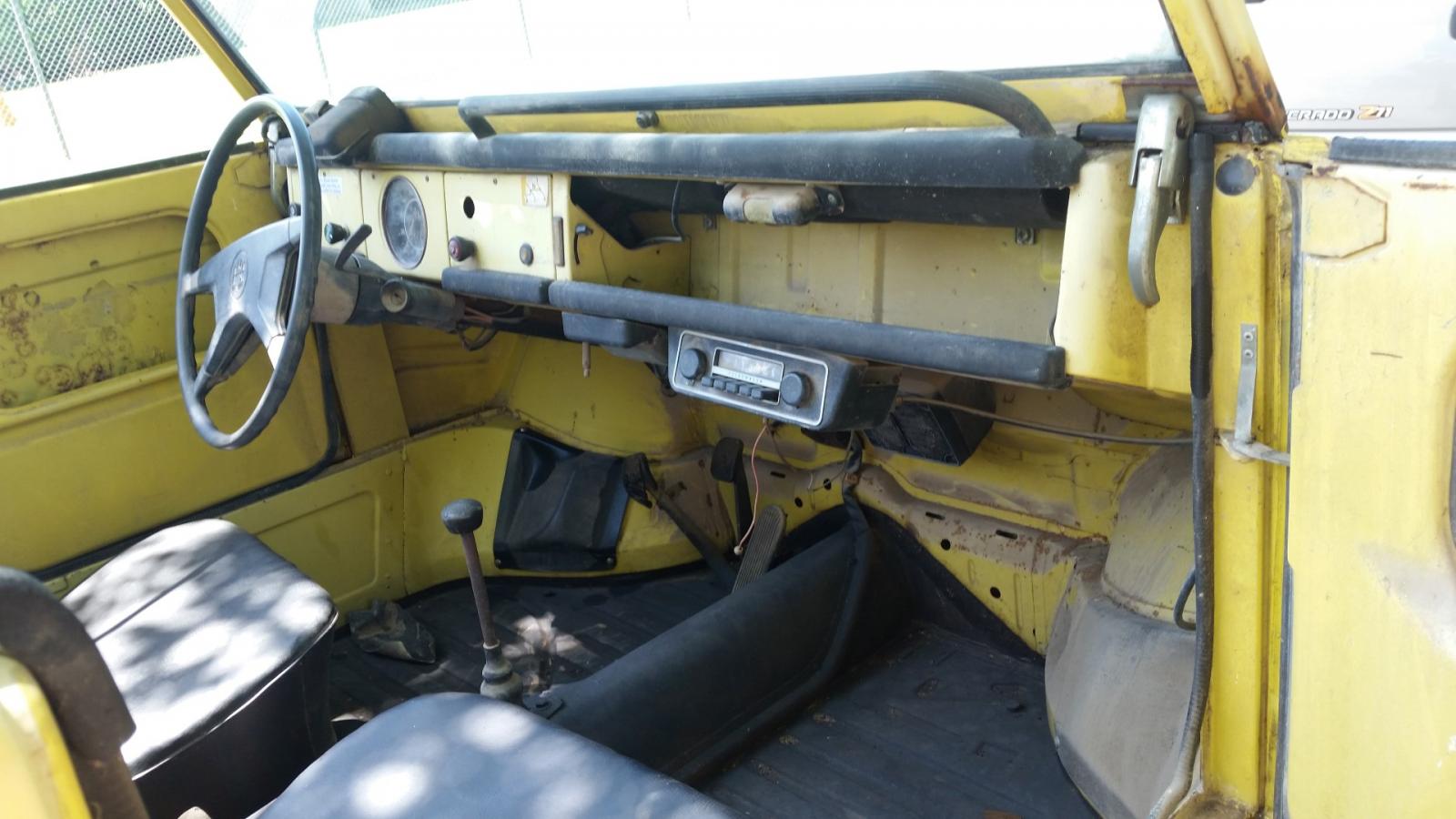

So today I was able to start assessing just what I've got.

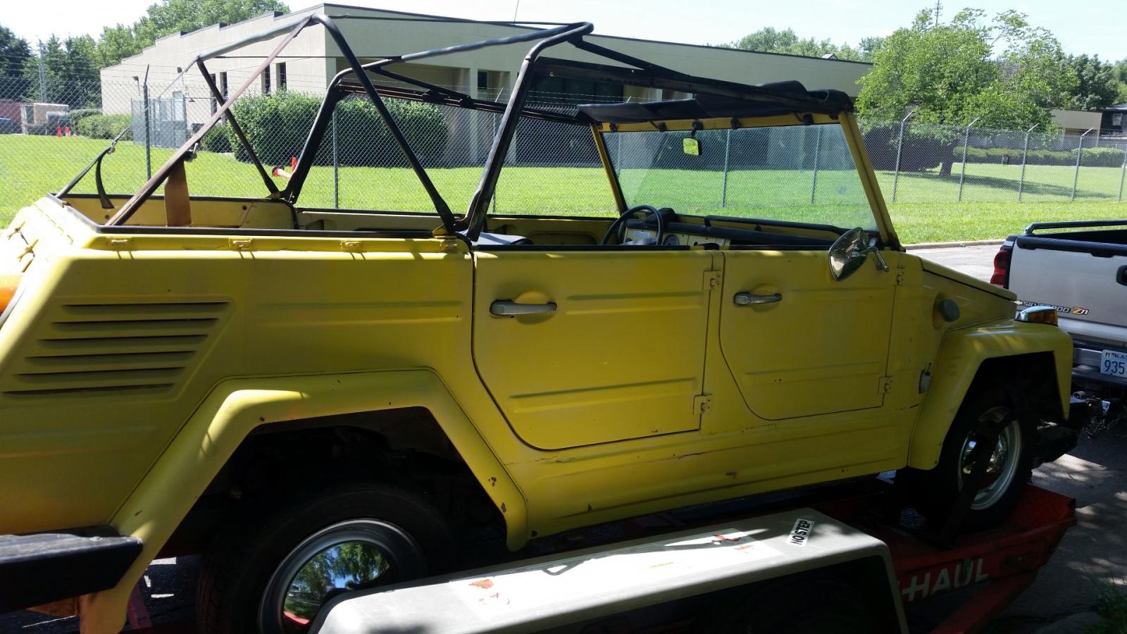

According to the guy I bought it from, it has sat for something like 25 years. He said the story he was told was that the original owner died 25 years ago and the family just stored it away until he bought it a little more than a year ago, but he didn't do anything at all with it, so he didn't know much more.
It seems to be pretty solid, the only rust besides some spots of surface rust seems to be the battery tray area. There are a couple spots of bondo that have repaired what must have been dents, one on the driver door, one on the hood, and one along the rocker on the passenger side.
The top is nearly completely rotted away, though the frame appears to be pretty solid.
The seats are all very surprisingly nice.
The engine does not seem to be seized. I can't shift into any gear, though.
Today I cleaned up the car with the idea that it is nicer to work on a clean car than a dirty one. I pulled the gas tank, and will need to have it repaired or something, as there is a rusted hole in it. All other fuel lines will be replaced

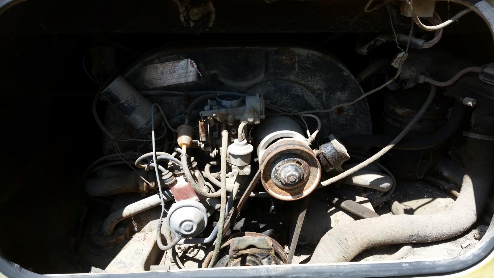

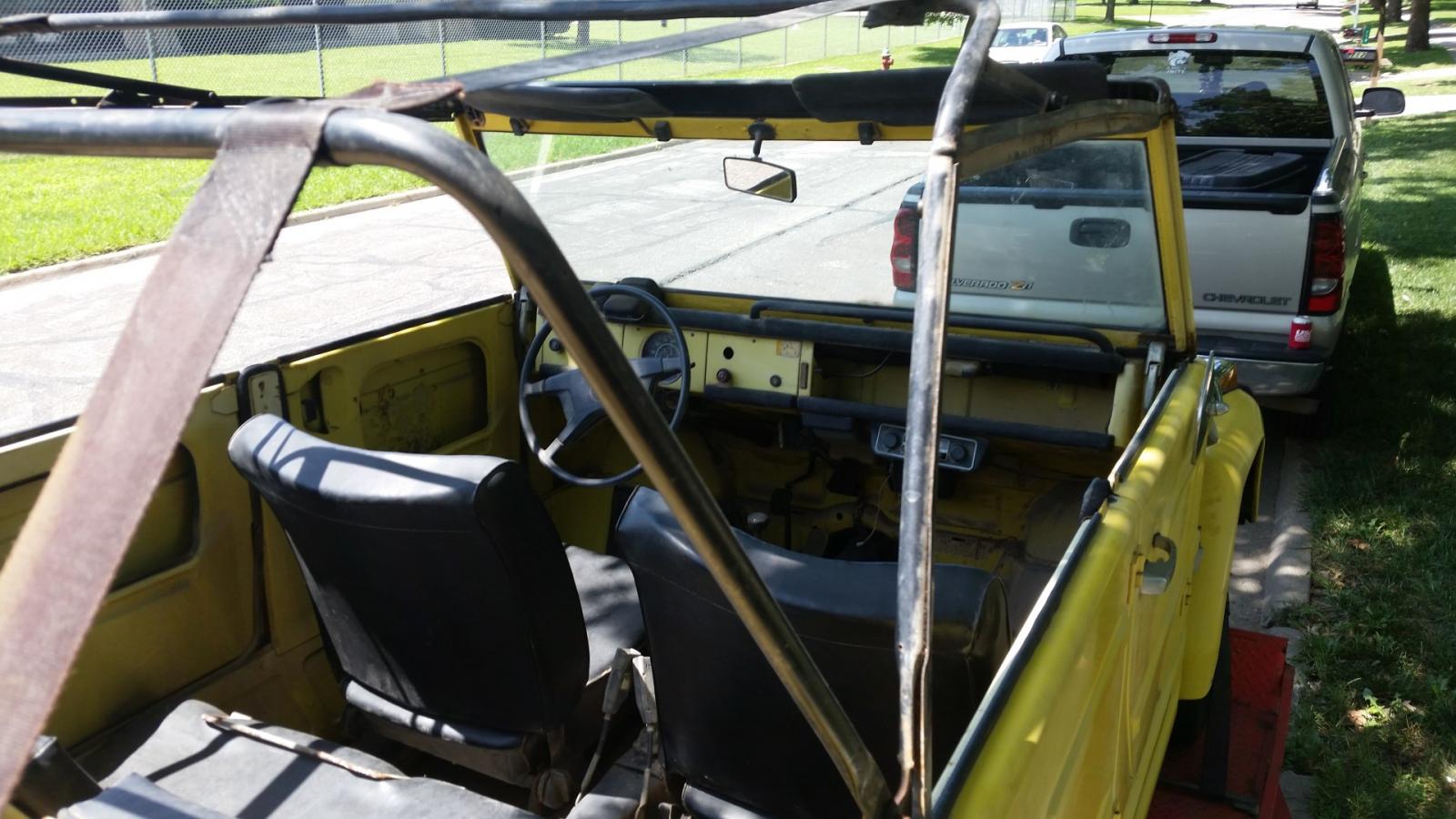

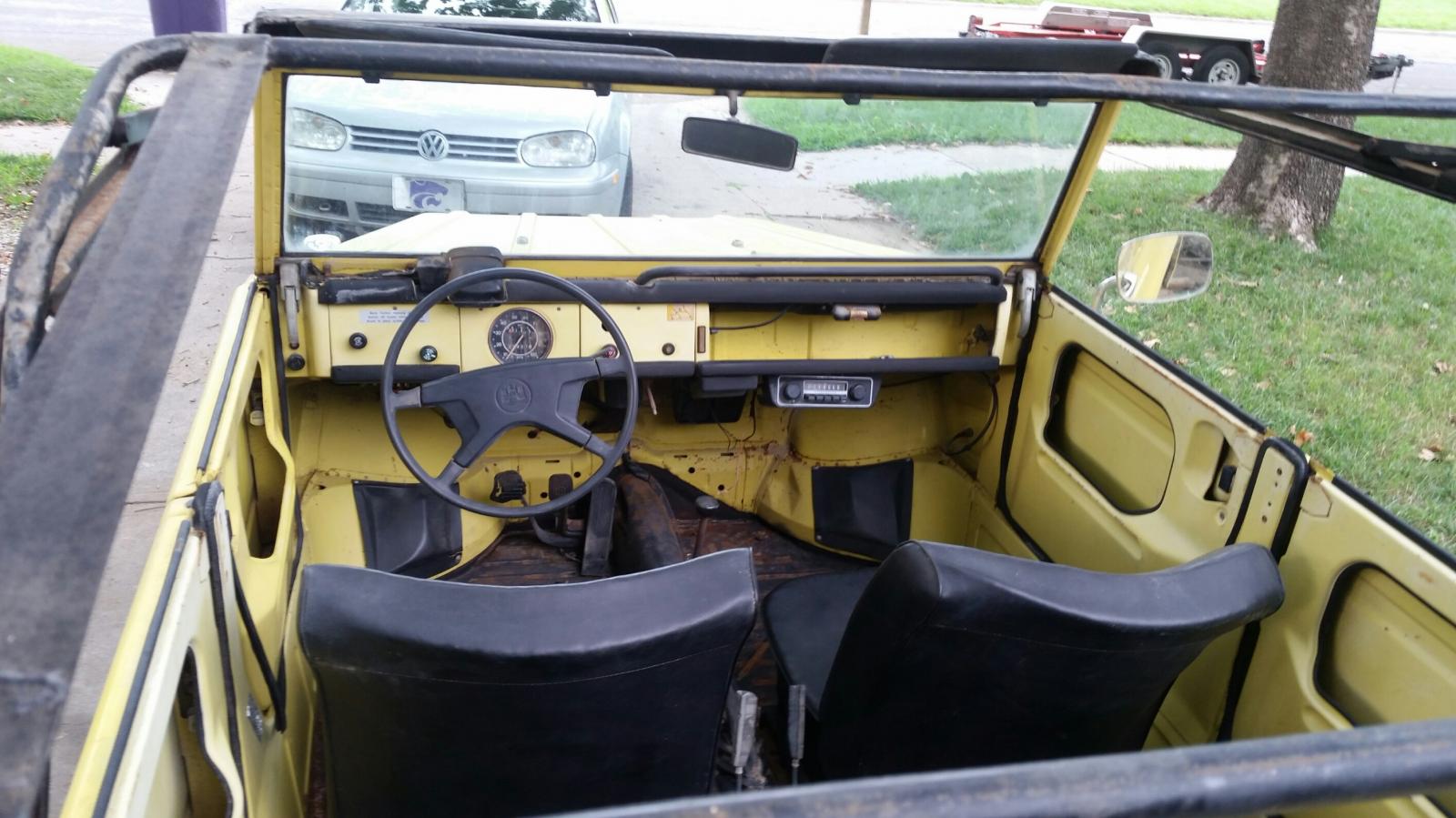

On the way home.
The rest are sitting on the trailer in front of my house before I started cleaning it up.

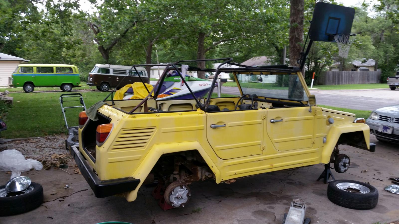

So yesterday I got started. Cleaned it pretty well, pulled the gas tank and started on the fuel lines.
The tank will need a lot of work to get useable again, but I think it can probably be cleaned and I can repair the pin holes that rusted in the bottom.
Today I ordered the advanced German brake repair kit from The Thing Shop as well as their "gas smell" kit and a couple other items to getting the brakes and fuel lines taken care of. I'm hoping to tear the carburetor apart tonight or tomorrow.
I need to figure out why the shifter doesn't seem to engage any gears. It won't push into anything, clutch pressed or not.
Can someone tell me how the rear seat backs are supposed to release?
I also need to order tires. The ones that came on it seem too short, but they are 25 years old and useless. Its a shame, because they look like they were fairly new when this Thing was parked.
I removed the engine lid, because the hinges are rusted and it was bending the metal on the lid. I'm hoping that some PB Blaster and gentle massaging will help free them up.
I was encouraged that one of my boys was asking to help work on it yesterday afternoon, so hopefully it'll be a fun project to get him involved with!
Here are a couple shots as it sits at the moment. You can see my two busses in my "auxillary parking." (The house is sitting empty, so I've traded doing mowing chores for the owner for permission to use their driveway.)

Nice find! That looks really solid, at least from the pictures. Shouldn't take much to get it back on the road (you hope!)
Plenty of knowledgeable folks here to answer questions, but be sure to use the search function too - most answers are already there.

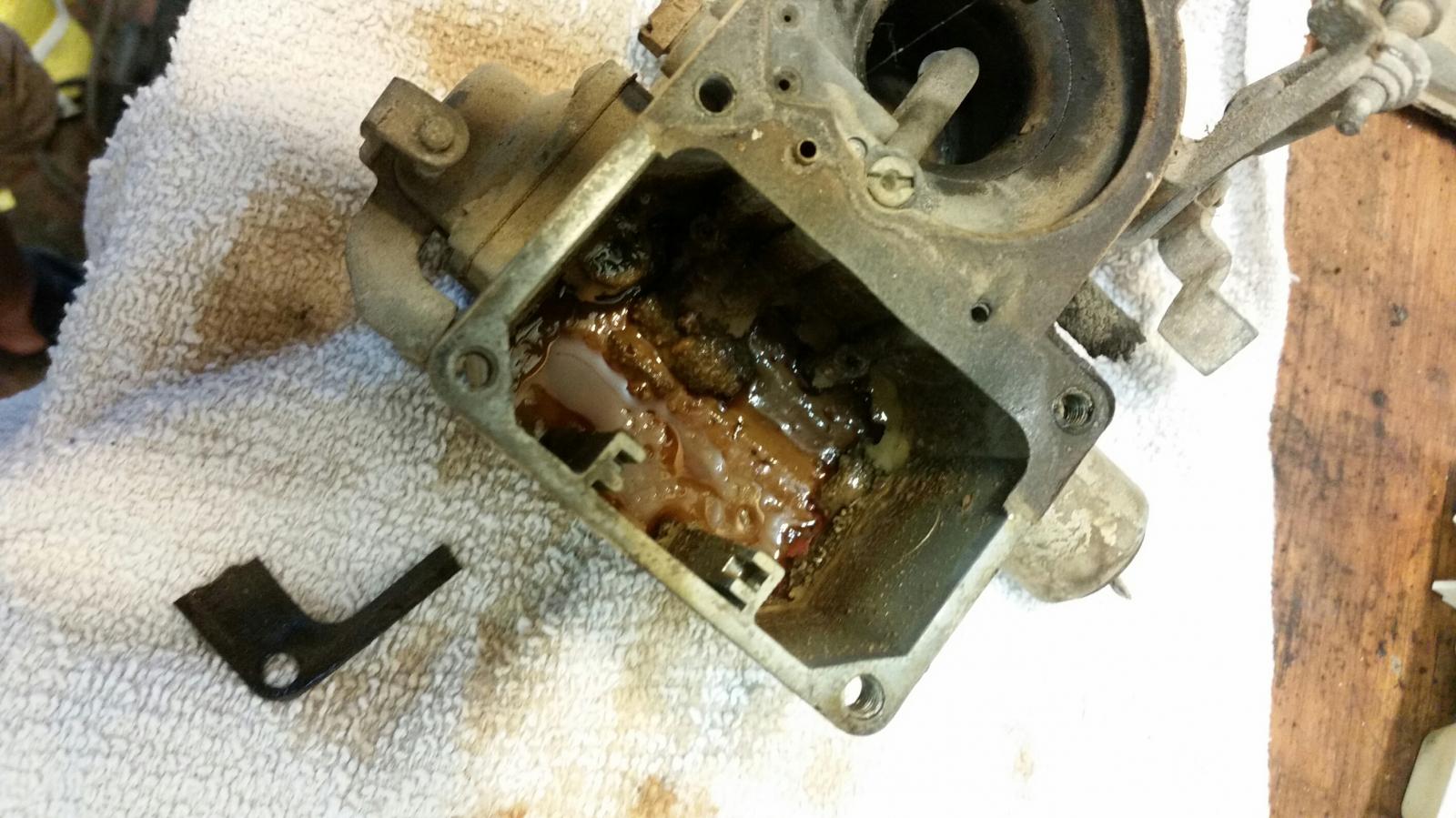

Was able to work on the carb this evening. Man, was it nasty inside!
Here is what I found when I popped the top off. Keep in mind, I did spray a bunch of carb cleaner into it yesterday before doing anything else.
It was super gross, but I think cleaned up ok. Hopefully I can get it put together tomorrow.
Maybe I can get the motor started up off a gas can while I wait for the tank and brake stuff to arrive from The Thing Shop.

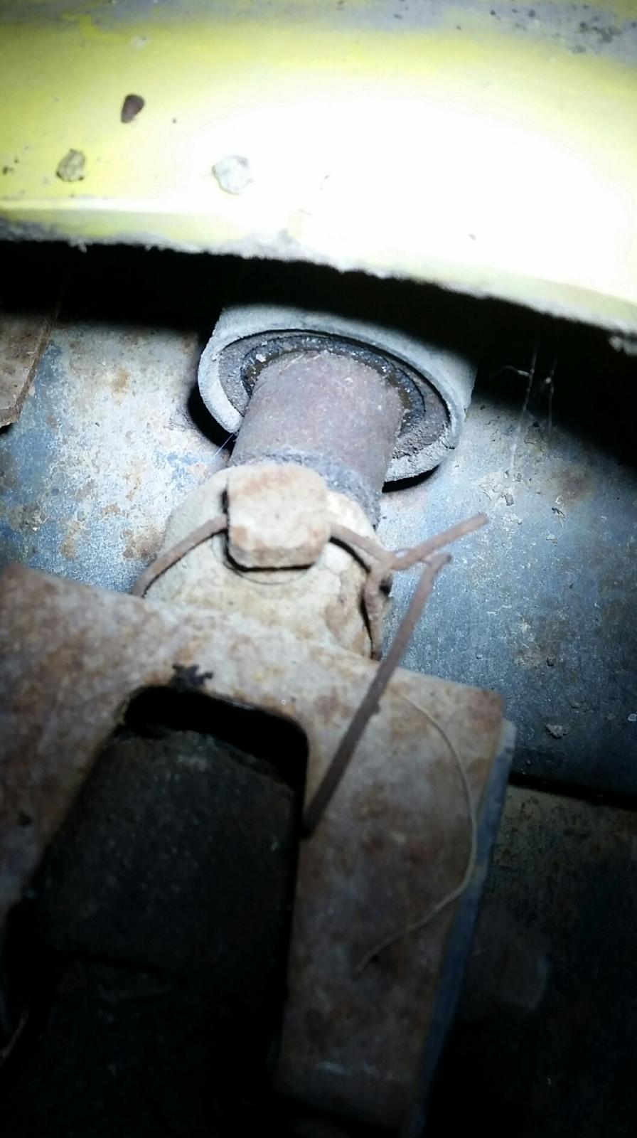

Finally got a chance to look at the bit of the hockey stick protruding from the trans.
There certainly is some surface rust that has formed on it! You can even see where it looks like it has fused a little to the bushing. So I'll be hitting it with some PB Blaster over the next several days to see if I can get it to break free. Hopefully that is all that will be required.

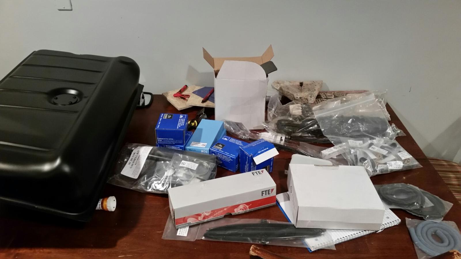

A couple boxes from The Thing Shop arrived today!
I got the Fuel Smell kit, a gas tank, the full German brake rebuild kit, and a few other bits and bobs. I'm hoping to get a lot of work done tomorrow afternoon!

The smoke was starting to clear up, but I think the fuel pump is dead. I only got fuel to the carb with an electric pump and it would always die pretty quick after removing the electric pump.
But the engine sounded pretty decent given that it hasn't run in 25 years and has a few little holes in the exhaust.

Looks great love the smoke. The way the carb looked and the fuel tank i would also say the pump is gone also. On my 73 that sat out in the open for 8 years it took the whole fuel system and after that fired right up and runs perfect.
