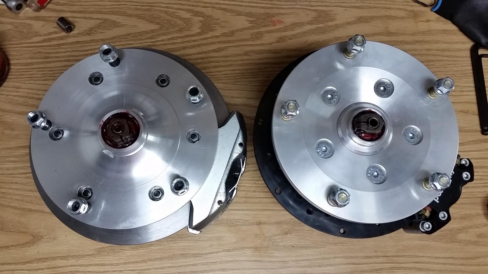

I couldn't find where anyone has done a direct side by side comparison for the Type 3 of these two brake kits so I'm starting this thread - hopefully, it'll answer questions and provide information.
This thread aims to provide information about CSP vs. Airkewld front disc brake kits in 5 x 205 bolt pattern. I'll be updating it over time or in response to questions, so feel free to ask away!

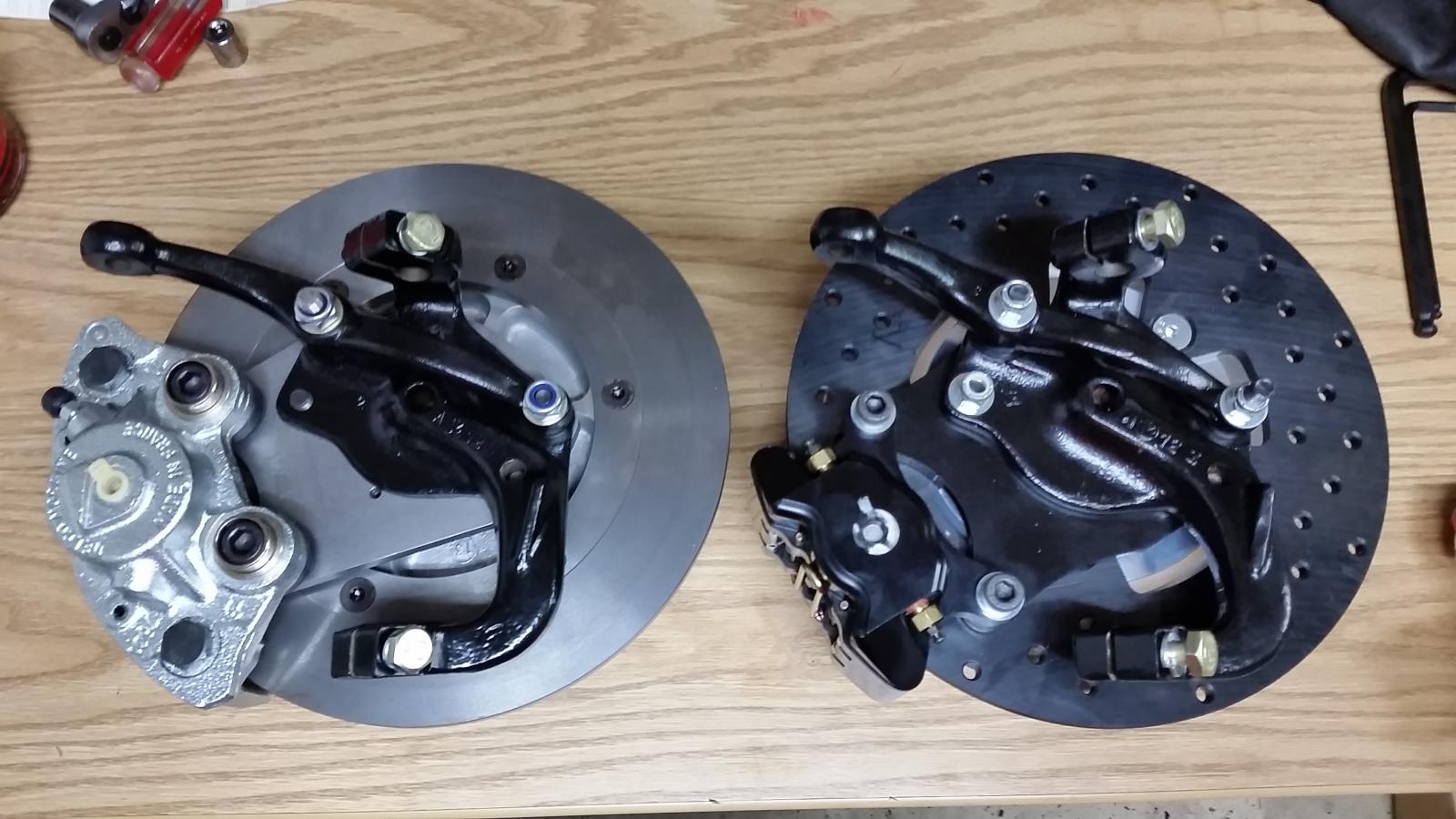

CSP front disc brake on the left, Airkewld front disc brake on the right.
There are quite a few differences between the two kits and I'll do what I can to identify them as this thread evolves and document below.

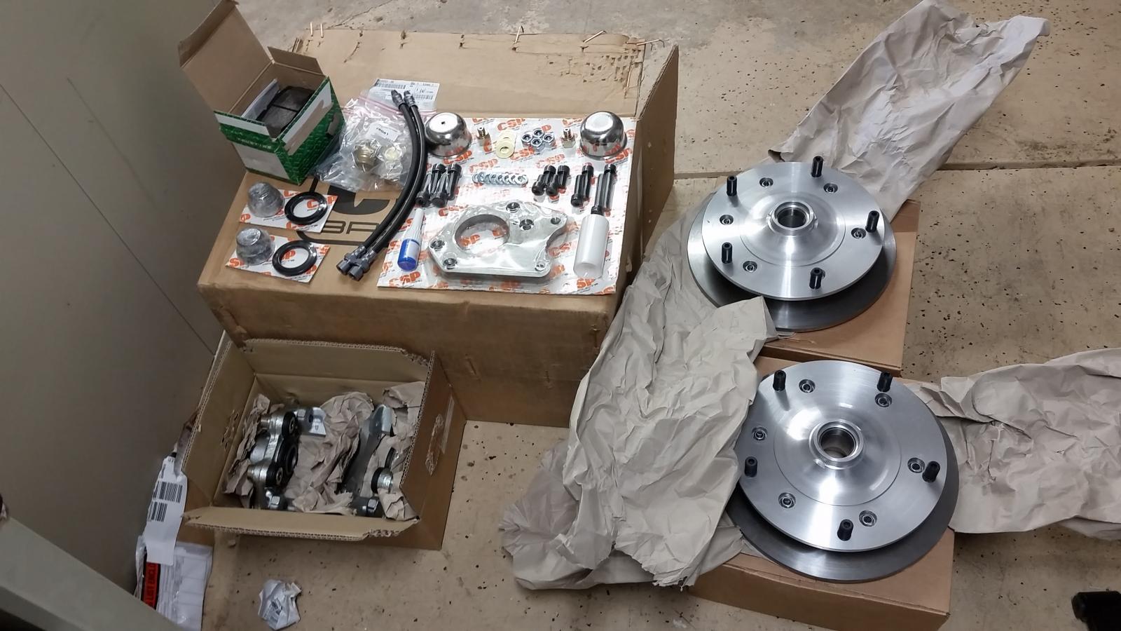

CSP
What's in the box:
* Rotor/hub assembly with pre-installed bearing races
* Instructions with photos for orientation and confirmation of correct installation (also online as a web page or .pdf download)
* Exploded view of how the parts go together
* Brake pads
* 48mm dia. GM floating type caliper (with dust seals) made in France
* Blister card of hardware/tools
* Bearings and seals on a separate blister card (not with hardware)
* Stainless steel bearing hub caps
* Rubber brake hoses and hose end adapters for the calipers
What's NOT in the box:
* Lug nuts not included (I used M14 R12 ball seat from Otis LA)
Specifics:
* Uses stock drum spindles with zero modifications
* 14mm stud diameter, uses R12 ball seat lug nut
* 30mm stud length (measured from the face of the hub to the end of the stud)
* Caliper bracket is steel, smooth on all sides and indicates "L" and "R" on the bracket - approximately 10mm thick
* Each caliper uses one 1mm spacer under each mounting hole between the caliper and bracket
* CSP specifically states that the spindle CANNOT be painted or powder coated on the mounting face of both the spindle and their bracket
* TUV certified
* Cannot be used on 14" wheels or early Type 3 slotted wheels, per enclosed instructions
* Adds approximately 10mm of track to each side
* Approximate weight per spindle: 32# (includes steering arm - without ball joints/tie rod end)
* CIP1 website, CSP instructions both show a backing plate/splash guard in the photos but it is NOT included with the kit
* A 19mm disc brake capable master cylinder made for the Type 3 is absolutely a minimum requirement for these brakes (per CSP) with rear drum brakes
* CSP strongly recommends use of this master cylinder with 4 wheel disc brake systems

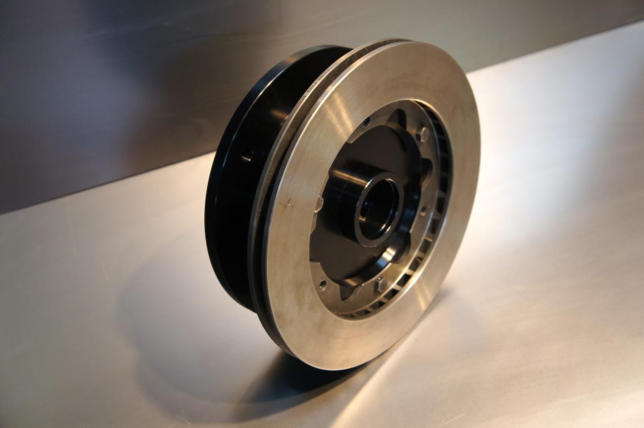

* No instructions were included in my box - Airkewld says they're now included (instructions online). Pictures for reference are on Airkewld Facebook link. Photos and written instructions don't match at the time of this post. Written instructions reference 12 photos, there are 11 on the Facebook link.
* Brake pads
* Wilwood DynaPro Single two piston calipers (1.38"/35.052mm diameter pistons)
* Bag of hardware - up to the user to know if they have the right hardware
* Wheel seals
* Zinc plated steel bearing hub caps

A couple of questions.
Are those both direct bolt on to drum brake spindles?
Are they both single piston calipers?
What is the 5 lug pattern of the AirKewld kit?
Just going off those 2 pics, the CSP kit looks like the better set up, due to the hardware used. Is this what you found when assembling them?
1. Are those both direct bolt on to drum brake spindles?
2. Are they both single piston calipers?
3. What is the 5 lug pattern of the AirKewld kit?
Just going off those 2 pics, the CSP kit looks like the better set up, due to the hardware used. 4. Is this what you found when assembling them?
1. Yes -although the Airkewld kit requires the threads to be drilled out on both of the steering arm holes due to the bolt they use having a small shoulder that wouldn't otherwise clear the threads. You will only learn of this when you read the installation instructions on their website because they don't include instructions with the brake kit when they ship it to you.
2. The CSP is a floating single piston modified GM caliper. The Airkewld uses a Wilwood DynaPro Single caliper.
3. Not sure what you're asking - both are wide 5 bolt pattern, 5/205
4. The CSP kit was much easier to assemble - mostly due to pre-installed bearing races and better manufacturing tolerances (no stacking washers to properly space the caliper on the disc).

PostPosted: Sat Aug 01, 2015 11:53 am    Post subject: Reply with quote
I was meaning the "inner" 5 bolt pattern. Looks like a 4 3/4 on a 5 from the pics.
Bob 65 Notch S with Sunroof

Bobnotch wrote:
I didn't measure that because that hardware holds the two halves together.

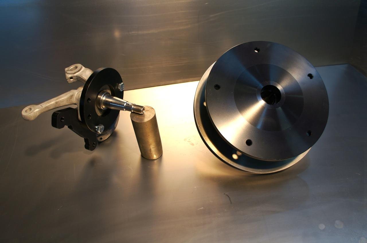

Airkewld brake kit uses a flat bracket with some rough edges:
CSP brake kit has a thicker/cleaner bracket:

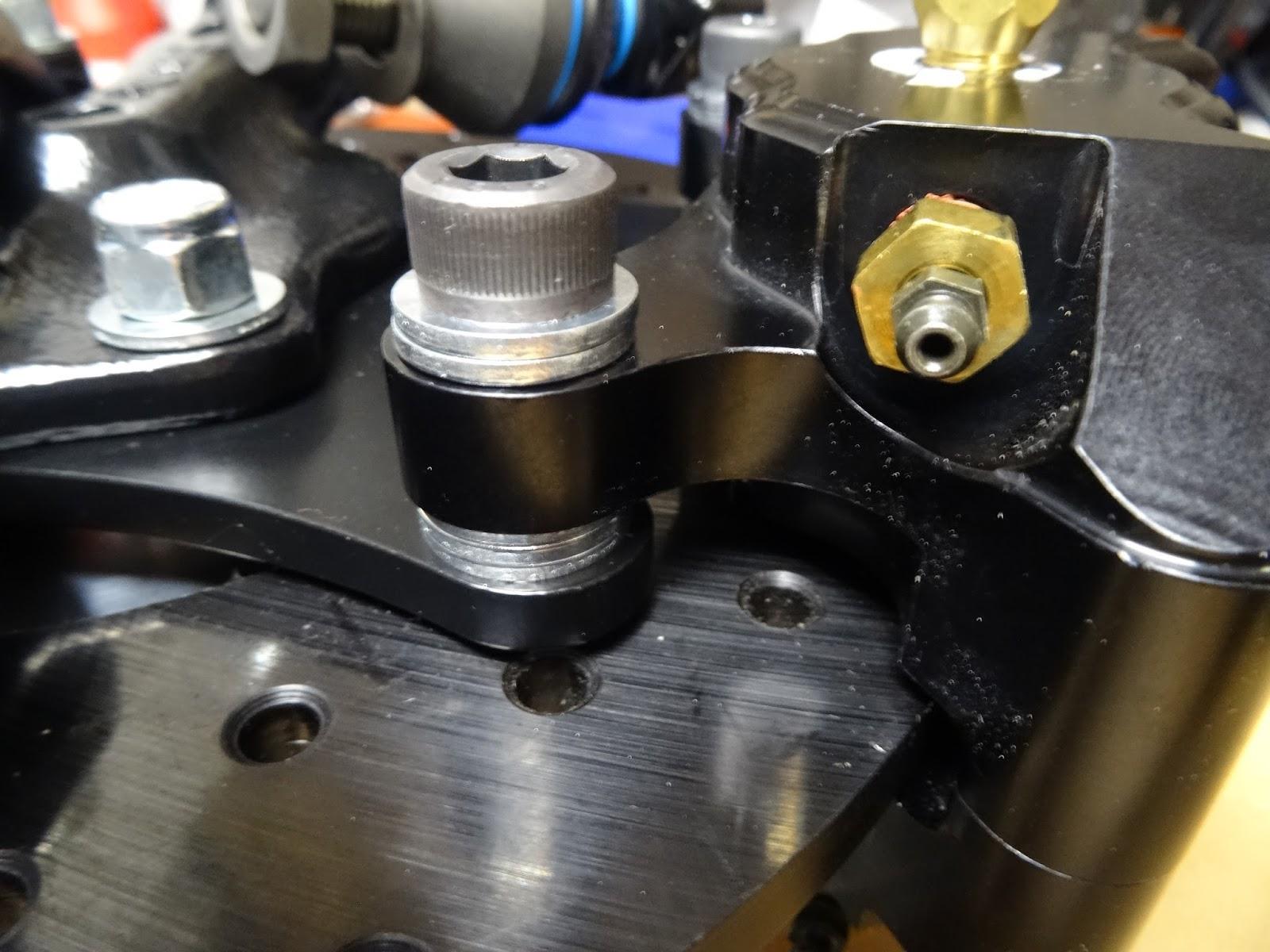

Airkewld kit: Had to bore out the holes on the Wilwood calipers to get the bolts to fit:

Airkewld :
Bracket is steel and 6.3mm thick with paint
Alloy hub

I received my CSP early Type 3 front brake kit late this past week. I ordered them direct from CSP in Germany because CIP was out of stock. They gave me an excellent price to help offset shipping costs. EURO exchange rate is still favorable, too, so I ended up saving some money on the entry price.
I'm not happy with the way they package their stuff:
CSP used a blister pack for the caliper brackets and hardware. The caliper brackets are heavy and have relatively sharp edges, so they cut right though the blister plastic during shipping. One of the long caliper mounting bolts also escaped the blister pack and was trapped under the loose caliper brackets, but miraculously no damage was done to the bolt threads.
The calipers shifted in their box and crushed and tore a big hole in the box containing the brake pads. Again, everything looks fine.
The bearings and wheel seals were blister packed to a small card inside the rotor boxes. The brake rotors also shifted and pinned the wheel seals. Damage was cosmetic.
Please publish the FAG wheel bearing part numbers. I don't think I'll need them right away, but if I do I'll want to be able to source quality replacements.
Have you been able to cross reference the wheel seals? I'm coming up empty.
All this BS aside, I was doing pretty well with everything until I stumbled onto Section 3.3 Wheels on Page 7 of the installation document. Apparently, the early 'slotted Type 3 steel wheels' are incompatible.
Guess what I have on my car?

Odd that you had so many issues with packaging. Everything in my kit was clean and in place when I got it - traveled from Germany to Canada, then to Illinois. The Airkewld kit was a giant f'ing mess when it arrived and it only traveled from Arizona.
I'm using Timken bearings (SET4 - you can get them on Amazon) going forward...the FAG bearings came out of my stash of parts - the only way I'd get numbers off of them now is to remove them from the car. Boxes are gone.
I'm almost positive that the seals are Type 1. I got the same seals in both brake kits. I couldn't get them to work in the Airkewld kit so I used Type 3 seals and they fit just fine.
That sucks about the wheels...I didn't catch that - I'm using the 64 / 65 wheels. I bet the welds on the back interfere with the caliper. Both brake kits are tight on space on the back side.

The piece of your design that makes the whole thing work: two piece caliper bracket.
You in the market to manufacture these for sale? Very Happy
