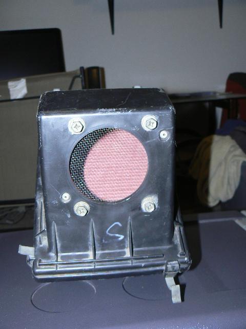

I think it is a good question. The KEP filter didn't seem to be at the level of OE quality you can find in the junkyard. Plus I'm surprised people haven't found a used alternative over buying something new.
When I was looking for a compact filter for a different conversion, I found a square 10x10x6 Nissan airbox with inlet on one end and outlet on the other. I think it was on an older Maxima.
I also found a tiny airbox from a Chrysler Dogde. It came on V6 Dynasty, LeBaron, and similar late 80s and early nineties cars.
Both of these fit into the D pillar but I think the smaller one might fit in line on firewall. You'd probably have make an intake adapter but they both looked promising so I grabbed them. I may try to fit one on my subie 2.5.
Nissan one:
Dodge one:
Size comparison:

That Nissan one pictured actually fits the factory Subaru air filter correctly(1990-94 Legacy), they are identical and interchange. Good choice, I think way back I researched that one and it also fit an older Sentra. A look on Ebay might confirm this.

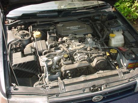

The common early 2.2l Subaru OEM filter housing (1990-1994) has a 90 degree connection to the MAF. Here is a picture:
Common later Subaru OEM filter housings (1995+) have a 45 degree connection to the MAF.
The later ones fit a little better in a Vanagon.
