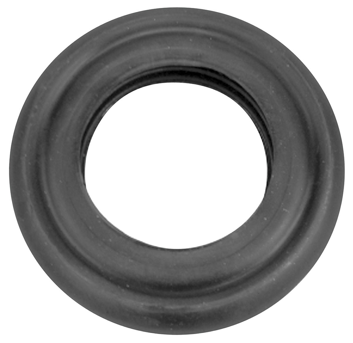

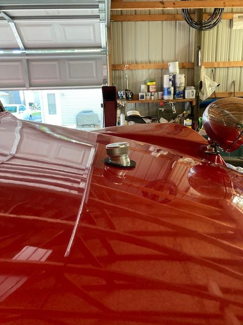

So, My "temporary" solution was to take Dale M's advise. I used a filler without flange. To fill the gap between the filler and the edge of the hole I had a spud gasket from a commercial toilet. Looks OK for now.
Looks clean and neat, seems like a forever fix....

PostPosted: Wed Oct 07, 2020 10:23 am    Post subject: Re: Fuel filler angle Reply with quote
I'm going to cut a "V" below the flange of the $80 polished stainless filler and reweld it. That will match the angle of the hood. No rubber filler piece will be needed around it either. I don't have stainless welding capabilities right now so its destined to the "future projects shelf".
