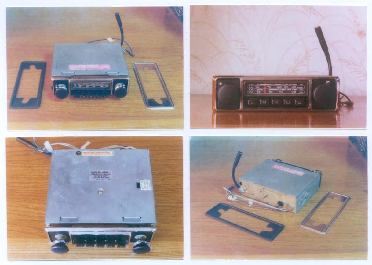

· 26th August 1975 – Retro-fitted a Japanese made, Javelin 9044, single-speaker, mono radio, with Long Wave: 150~280 kHz; Medium Wave: 540~1600 kHz; Short Wave: 5•95~6•2 MHz; VHF (aka FM): 88~108 MHz. A single speaker was mounted below the central, horizontal dashboard grille.

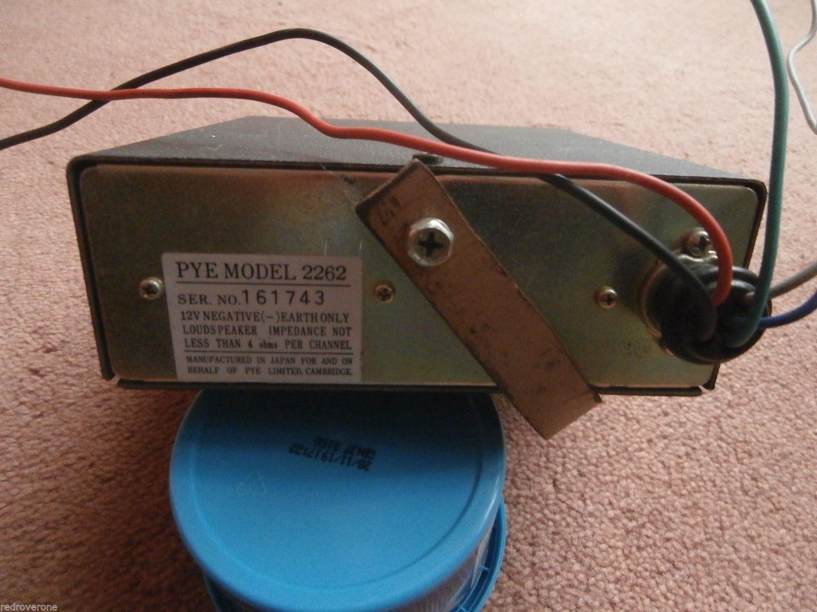

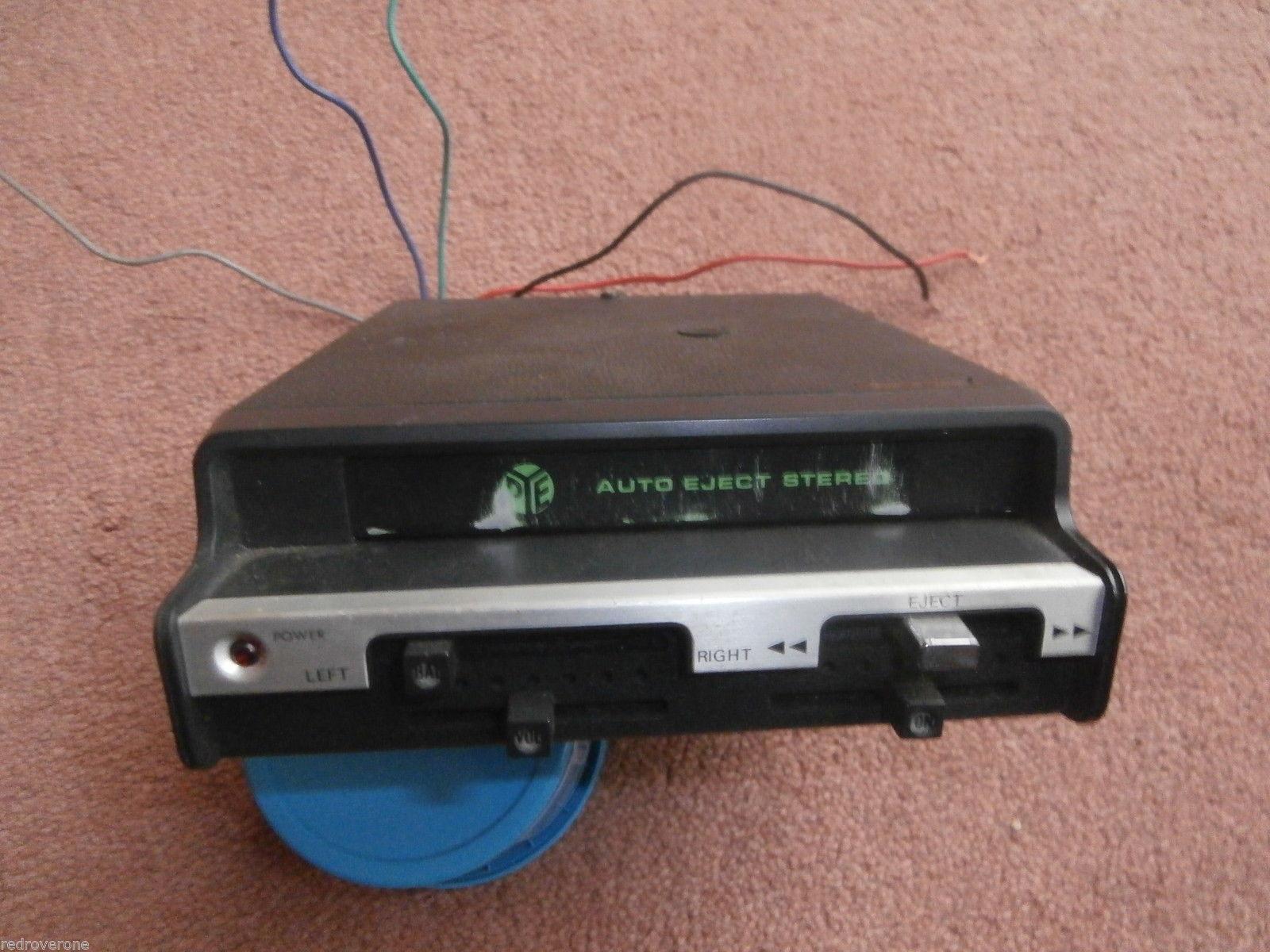

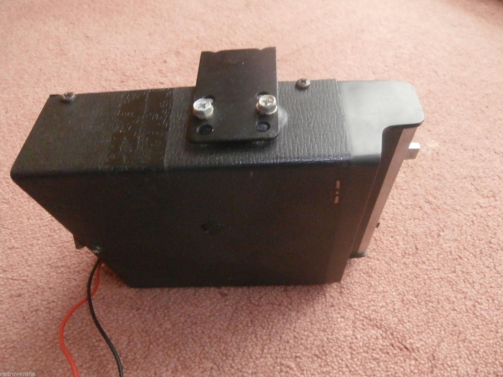

· 26th August 1975 – Retro-fitted a PYE 2262, twin-speaker, stereo audio-cassette player. A matched pair of “parcel-shelf type” speaker pods, were attached to the front-cab ceiling, behind the driver and front-passenger seats.

Japanese made, Javelin 9044, single-speaker, mono radio (serial No. 2090540)
PYE model 2262 car stereo cassette player
