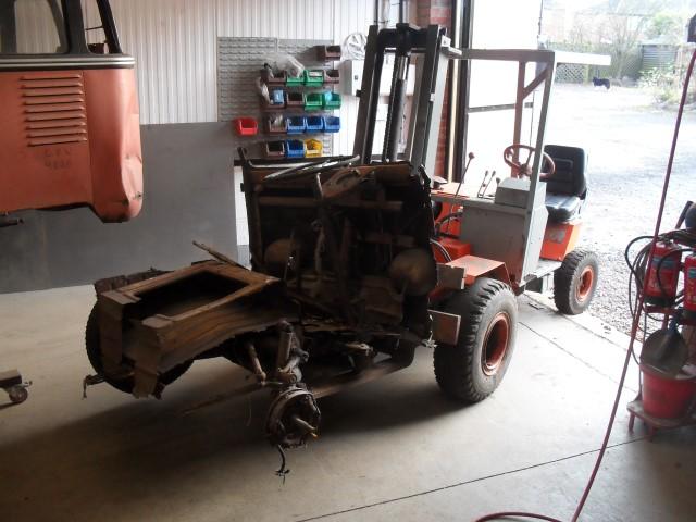

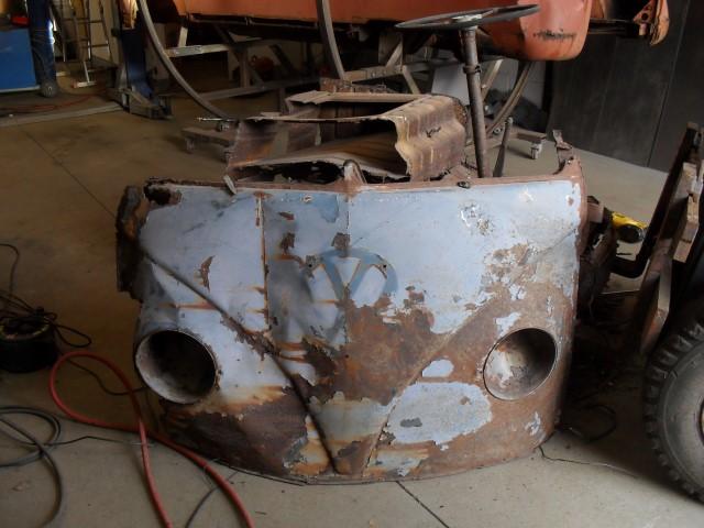

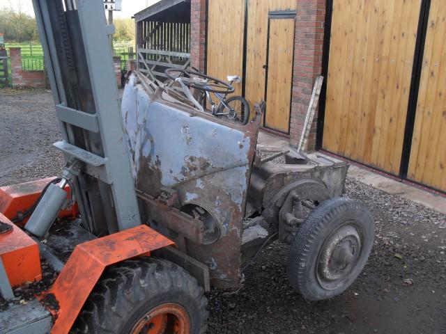

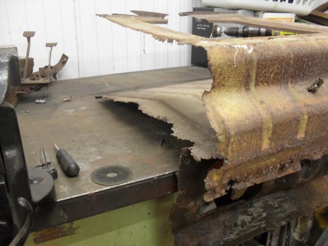

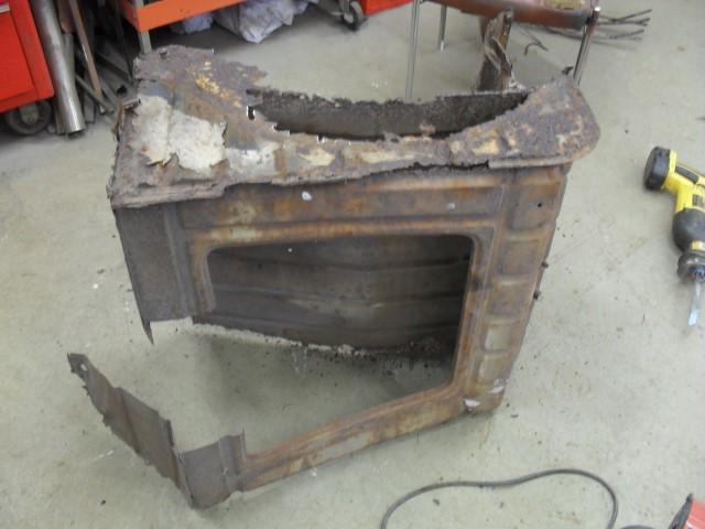

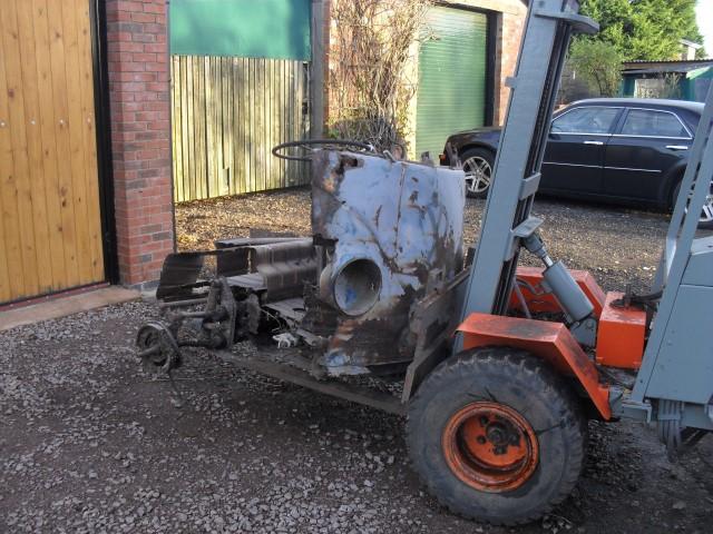

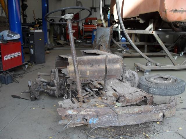

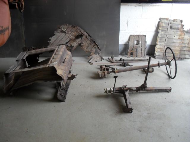

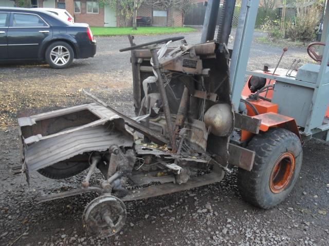

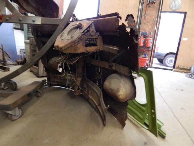

So last week we had to try and work out what to do with the front end, because what's left is a bit of a mess!!!
Still some major parts that we hope to use and so the front lump was dragged into the shop for the strip down to begin
This bus really does need breaking down into its component parts in order to repair them and reassemble them, there's just no way to try and repair these panels in situ. Off with the front then ..... for now
and then tear this apart ...... carefully! ...... to see what else we can salvage
and finally a pile of vaguely useful stuff to start working on! Twisted Evil

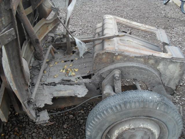

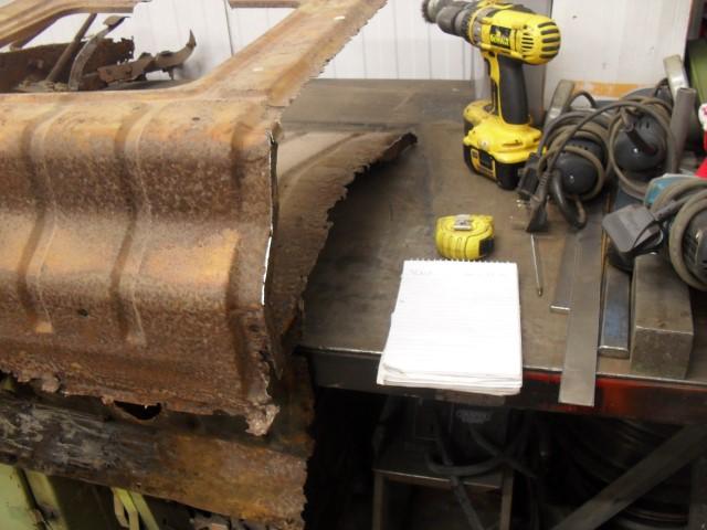

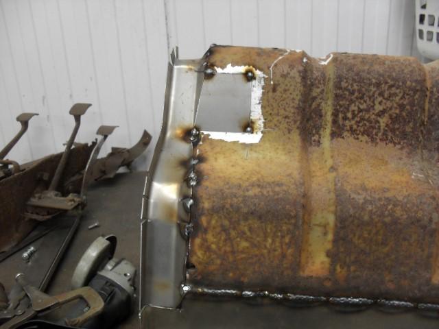

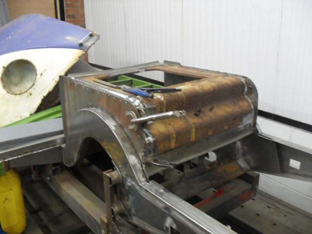

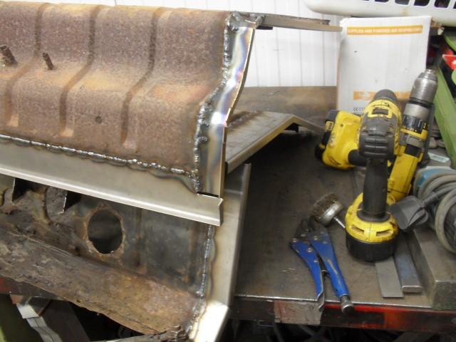

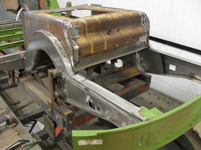

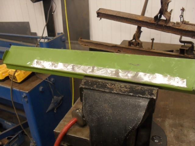

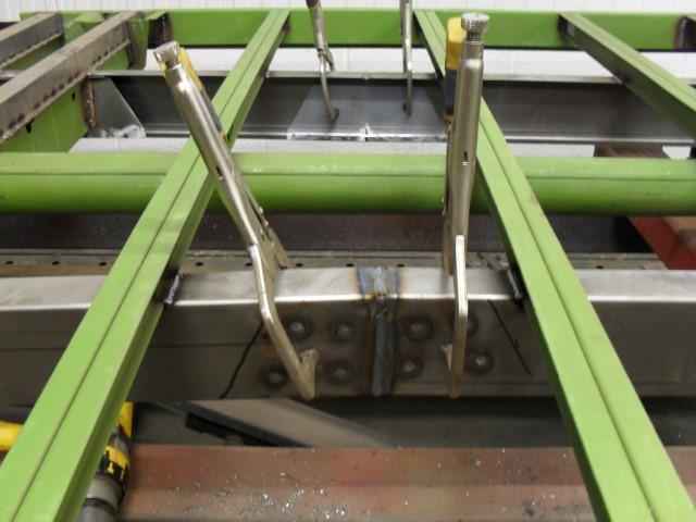

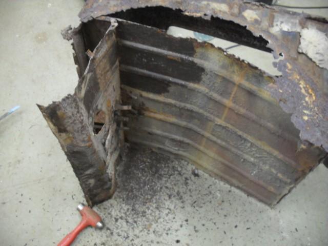

So first up for some work was the tool box section. The top and bottom of the toolbox had survived ....... just! ..... as had the strengthening piece that runs underneath with all the cut-outs in for the steering gear, etc. This lump was pretty solid for the main part, but all the edges had been eaten away
So we started starting fabricating and letting in new metal
Not the most fun job in the world Laughing
Anyway, we persevered and eventually the section was back where it should be. It would have been way easier to just use new panels but it's great to actually see some original metal going back onto this thing .......
........ although sometimes there is just nothing left to use but new metal!

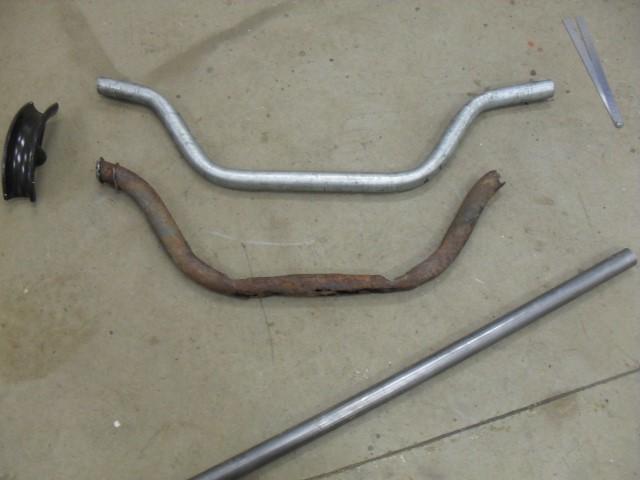

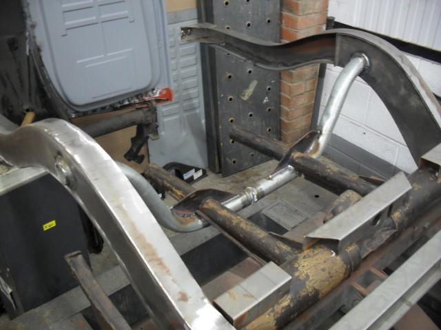

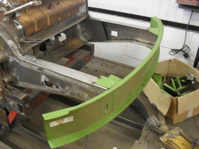

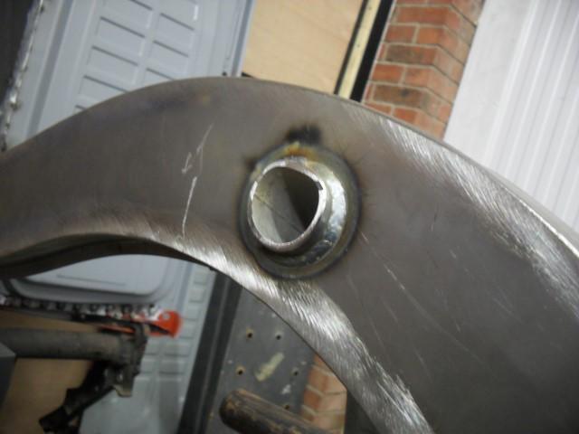

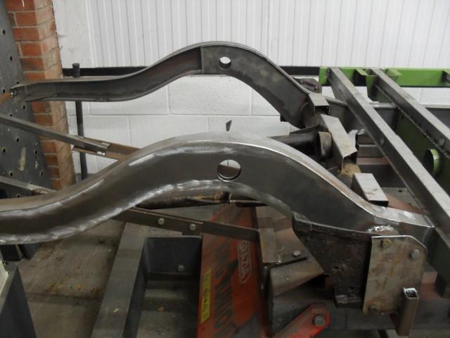

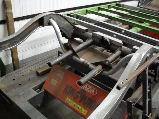

At the rear of the bus the chassis was still missing its cradle, which was lying, half rusted away on the floor.......
and because it was decided it wasn't really fixable, a new cradle was bent up to match the original
and then welded into position
with everything finished neatly with the usual attention to detail Cool
With a few other bits and pieces taken care of and finished,
the chassis is starting to look pretty good!!

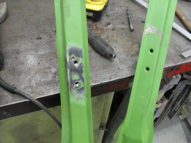

Well once the chassis is complete it's time to start building upwards......

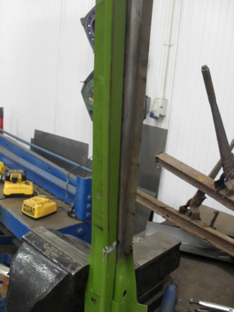

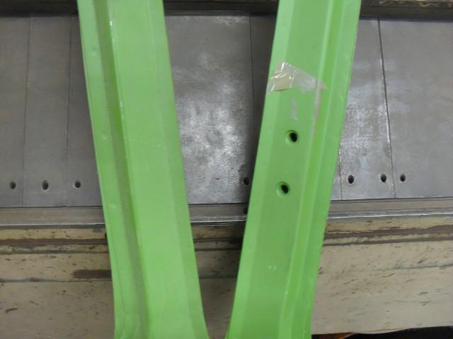

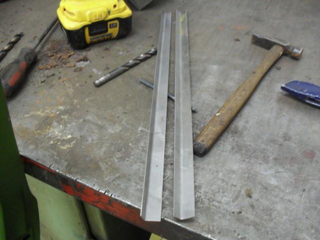

Because the front end is ever so slightly rusty Confused we decided to use new Gerson a-posts and screen surround to give us something strong to build from.
Whilst many buses of this age only have one mirror arm, it was possible to order a second from the factory, and this bus did appear to have mirror arm fittings on both a-posts. (After driving my lhd panel about with only one mirror it will be a great luxury to have two!!). Only one KF a-post had the internal screws so this was quickly dealt with.
but they were still not ready, they needed more work yet Rolling Eyes

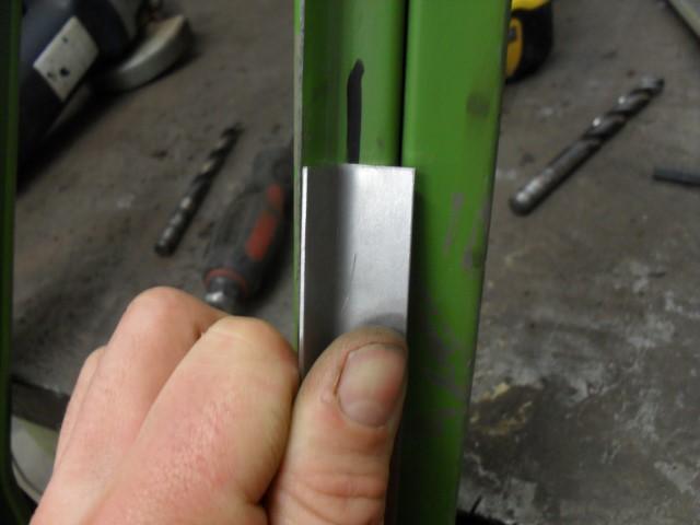

A few years back, the most famous Barndoor owner on the planet Laughing was fitting his new safaris when he spotted that early and late Barndoor a-posts differ slightly in profile and the positioning of the door channel. This is a nice detail to get right on an early bus, and although no-one sells these 50-52 a-posts, later posts can be modified. Scottys thread is here for further detail:
http://www.thesamba.com/vw/forum/viewtopic.php?t=428324&highlight=

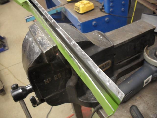

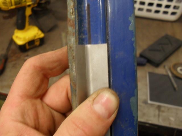

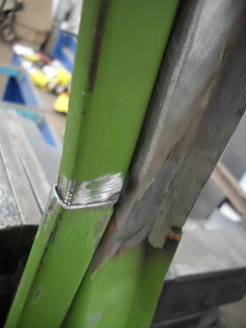

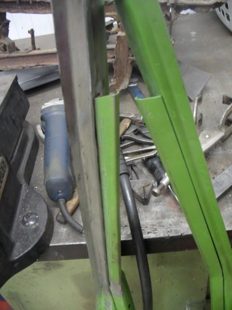

Well we read and re-read all this, looked at a lot of photos, studied my other buses a-posts, and spent a long time talking about it, but to be honest we ended up confusing each other quite a lot. The Welsh Wonder came up trumps by posting us a section of (Rather Cool ) early a-post to use as a guide. Here you can see what I'm talking about .......... the Gerson a-post is 52+ Barndoor, and the blue is early:
So new, "wider" sections were fabricated
and then with the door seal channel removed
so that the a-posts could be modified
before the channel was spot welded back on. Here's the modified "early" post compared to the normal, later one........
........ and side by side with the section of original early style post
and an early style a-post ready to use Very Happy
with all the little details looking nice and original. This is how my Jan '51 looks, a handy reference to have in the garage Cool
