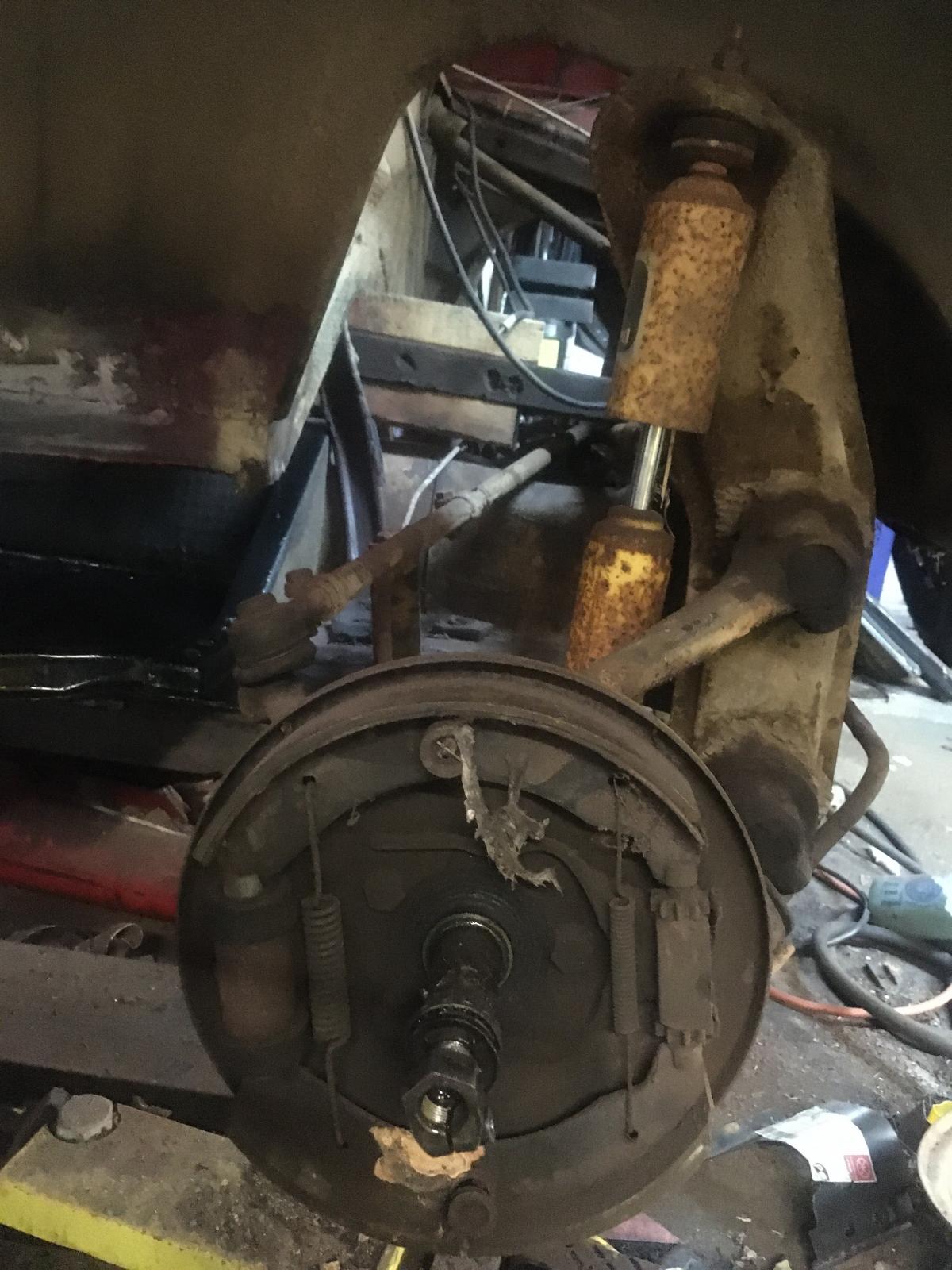

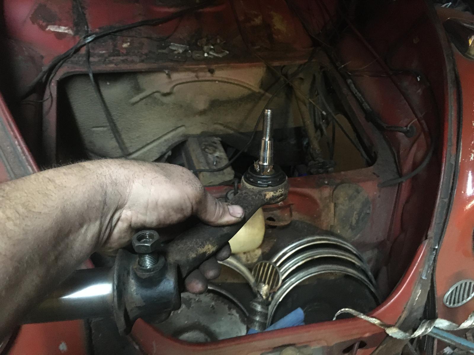

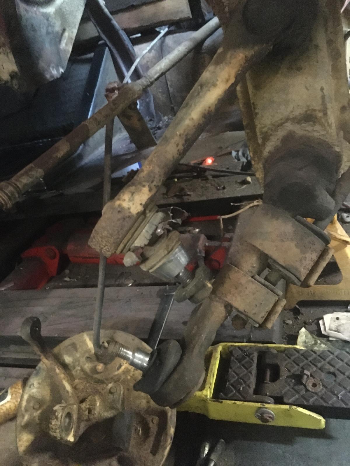

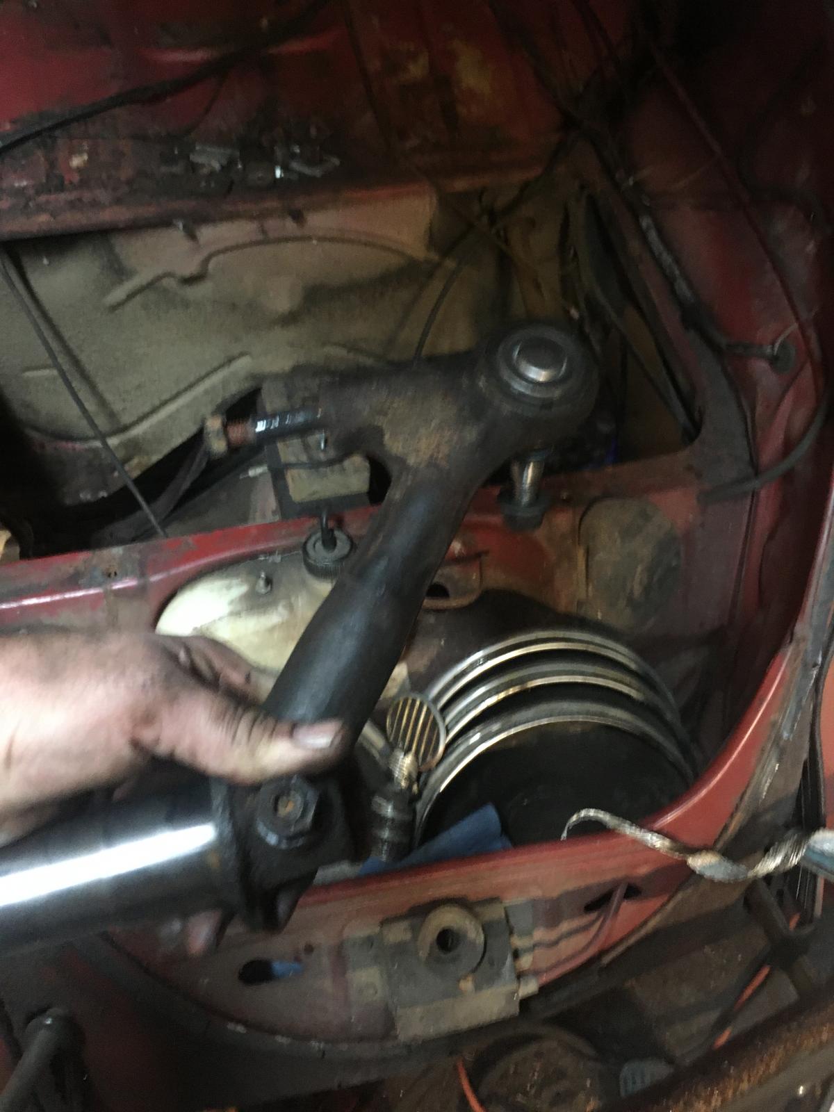

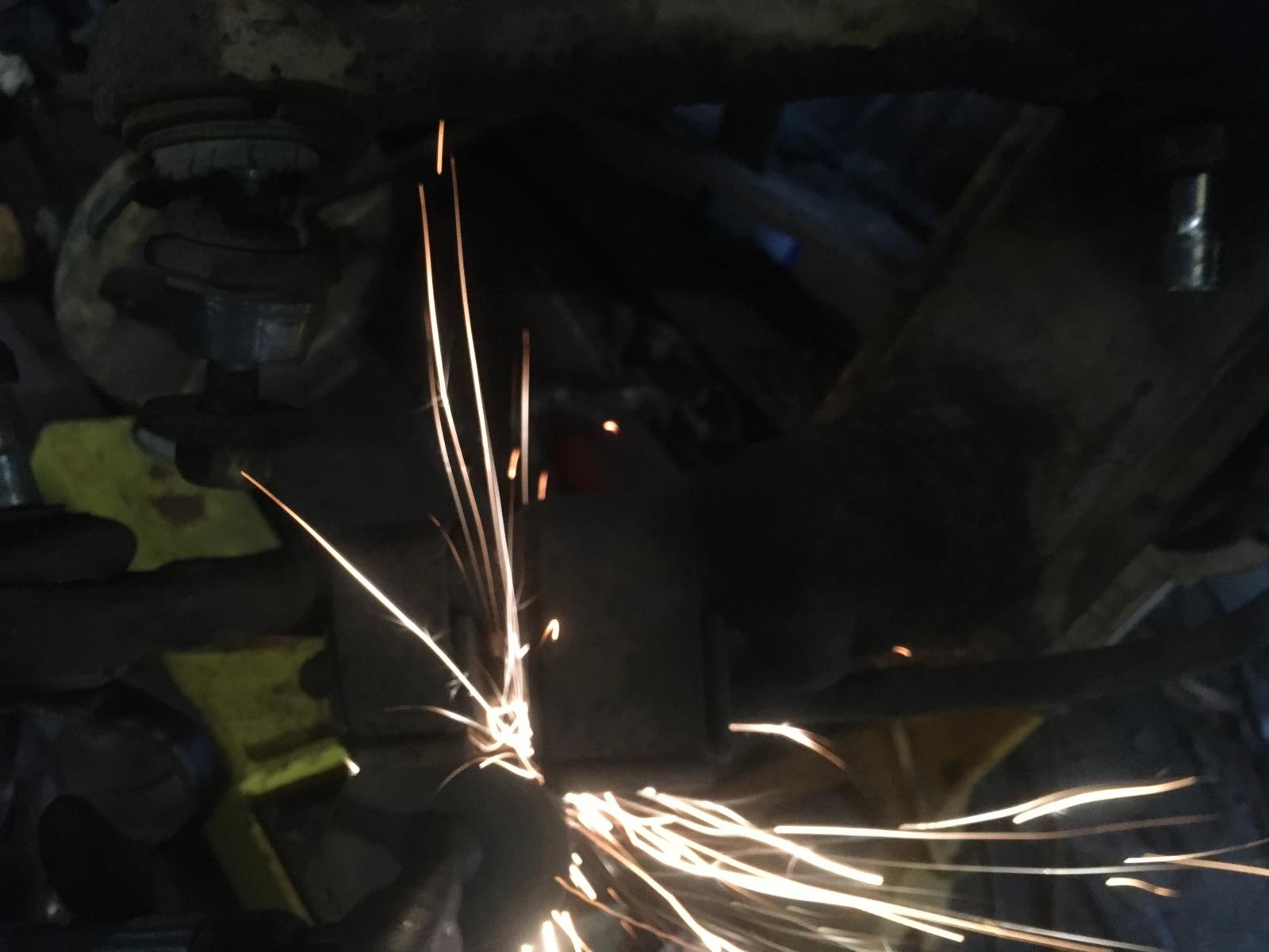

TDCTDI wrote:
….so I started to disassemble the front beam.
I had to heat up the nut on the top of the shock to persuade it off.
And once that was off, I had to do the same to get the sleeve off of the trailing arm.
While trying to remove the spindle, I noticed that the steering was binding but I managed to remove it once I popped the ball joints loose.
I then cut the sway bar clamps off.
After removing the trailing arms, I realized why the steering was binding, the ball joints had been clocked incorrectly the last time they were replaced.
You can see how the indexing notches are not perpendicular to the bearing races on the trailing arms. You can also see that the ball joint wasn't completely pressed into the arm.
After removing the boots from the new ball joints, I pressed them into the arms.
