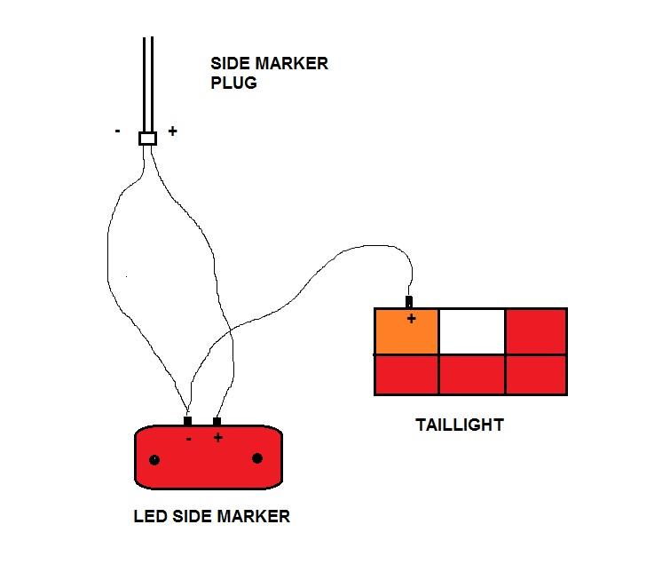

I kinda get the idea.
Is it like this?

PostPosted: Sat Dec 26, 2015 10:33 am    Post subject: Re: How do I make the rear side marker lights blink? Reply with quote
Just take the ground wire from the side marker light and connect it to the hot side of the turn signal light. The marker light will glow normally when the running lights are on, but will go off each time the turn signal flashes.
Zeitgeist 13
Joined: March 05, 2009
Posts: 12177
Location: Port Manteau
Zeitgeist 13 is offline
PostPosted: Sat Dec 26, 2015 10:36 am    Post subject: Re: How do I make the rear side marker lights blink? Reply with quote
Sorta, except you don't use the chassis ground on the side marker at all. Grounding for the LED comes solely from the positive side of the rear turn signal.

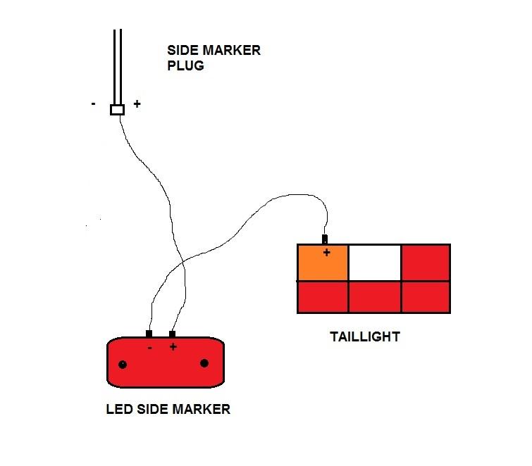

PostPosted: Sat Dec 26, 2015 10:47 am    Post subject: Re: How do I make the rear side marker lights blink? Reply with quote
So this, right?
PostPosted: Sat Dec 26, 2015 10:49 am    Post subject: Re: How do I make the rear side marker lights blink? Reply with quote
Yes

PostPosted: Sat Dec 26, 2015 10:55 am    Post subject: Re: How do I make the rear side marker lights blink? Reply with quote
love seeing more vans with this essential (IMNSHO) update.. I don't even consider it a mod.
and kinda cool to see me quoted above..
disconnect/don't use the oem side light -Neg wire it'll pop your turn fuse the way you have it drawn
