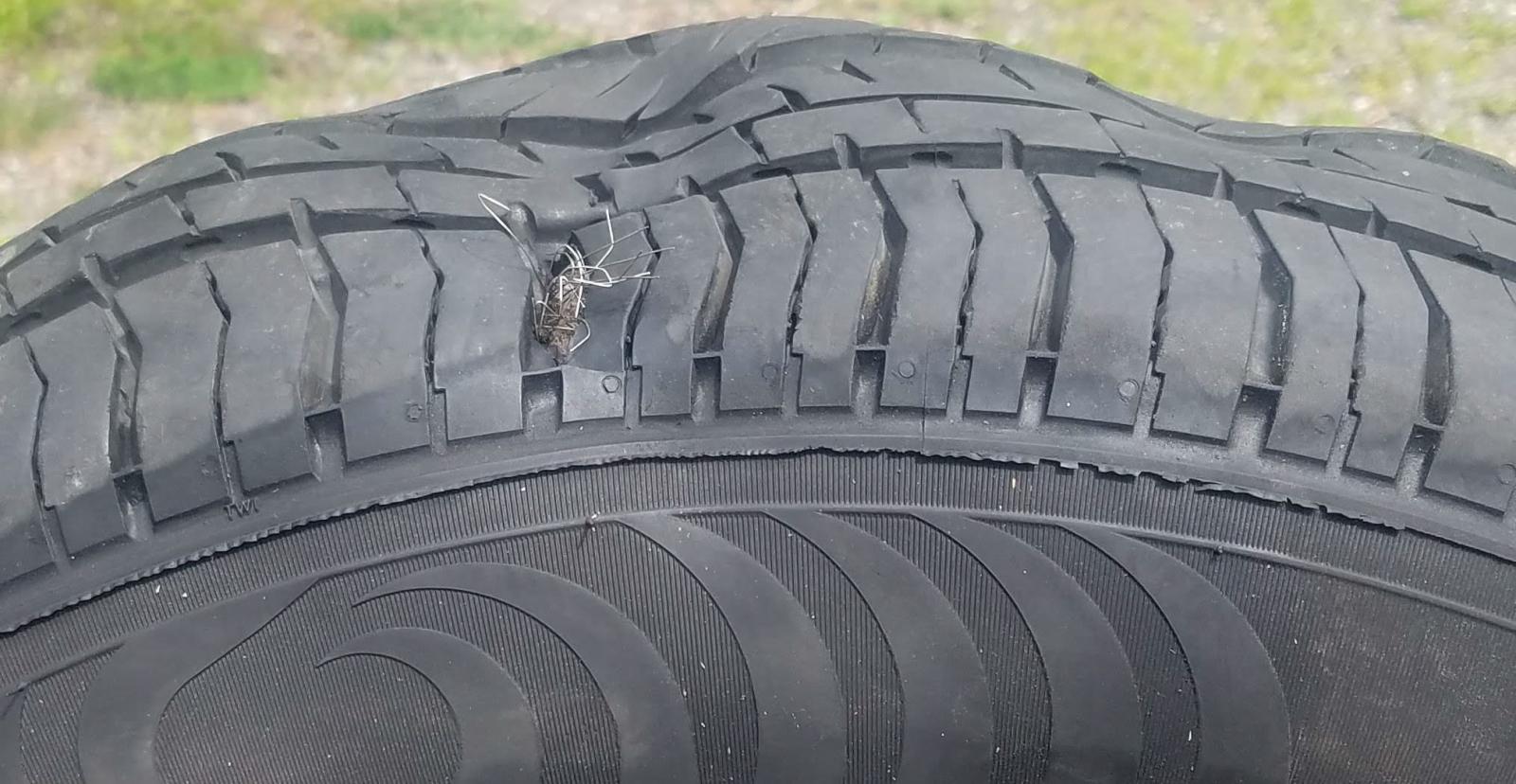

Steele belt broken inside the tire until it finally blew out. Looking at the tire showed nothing visible, better to take to a tire shop if you can't narrow it down.
I had a similar failure on my 3/4 ton truck last year. I felt it when I took off from home one morning so turned around and went back to the house to put on another tire. I couldn't see or feel either a bulge in the tread or sidewall, and just laid the old tire against a tree after I did the swap and went about my business. When I came home at the end of the day the subject tire had split apart worse than what you show. It appears there must have been a minor puncture through the tread that let water get into the steel belts and the steel cord rusted as a result. The tires were old and high mileage, but still had about 1/2 of their original tread depth. These were Avon tires (think motorcycles) and showed no visual cracking of the rubber and if I could have gotten another set of the same I would have.

E1 wrote:
Wildthing’s comment about “buying another set of his Avons” brings up a point.
I do not think Tim’s tire should be interpreted as a manufacturer’s failure.
It’s pretty clear it impacted something, like a piece of angle iron, or whatever.
Nope! The tires was vibrating for weeks and knew it was coming from the rear. Jacked up and inspected all four corners and couldn't tell a thing. Took wheels off and inspected again and still nothing.
The tire was a 1 year old Nokian. Have run over a bolts in the road and blew a tire out and have had the entire tread become detached and flapping down the road.
This one made me thing next time it will go to the tire shop first.
