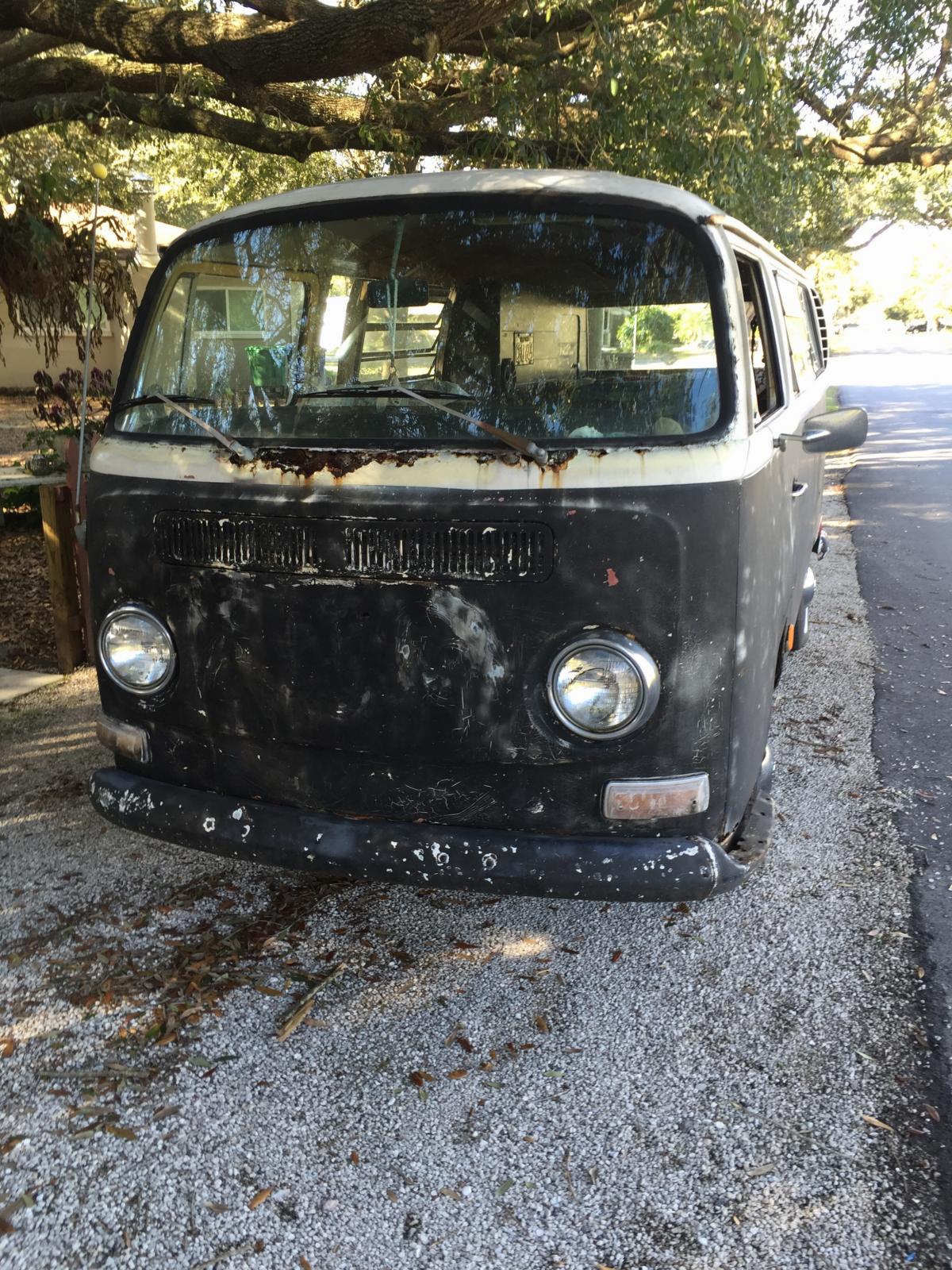

So this past Saturday (1/23/16) I took out the $3,000 I'd been saving up to go and buy a bus I had only seen pictures of. It was 35 minutes from my house and it was exactly what I have been endlessly searching for for months.
I have wanted a bus probably my entire life and now i have one!
Here's the story:
My dad and I get to the sellers house and he was a great guy. He told me all about his 19 years with the bus and how he was extremely sad to part with it.
I told him I would take extrordindary care of "Linda."
This was the first car I bought with my own, hard earned cash so I have extreme pride in every rust hole, squeak, noise and quirk in my bus.
I plan to restore this bus as originally as I can. It has A LOT of rust but the frame is the best I've seen on a bus, it cruises 50-55 all day long, stops as good as its three drum brakes (one brake line is crimped) will let it and the interior is about 90% complete.
Anyways, here she is! I hope everyone here enjoys looking at her as much as I do!

How old are those tires? Likely not something you really should be trusting your life to.

Wildthings - To tell you the truth, I have no idea. I couldn't find a date code anywhere. Shocked There is no dry rot and the tread is next to perfect so I hope I don't have to replace them right away. The PO gave me a spare tire too and I think that tire is about as old as the bus! Laughing

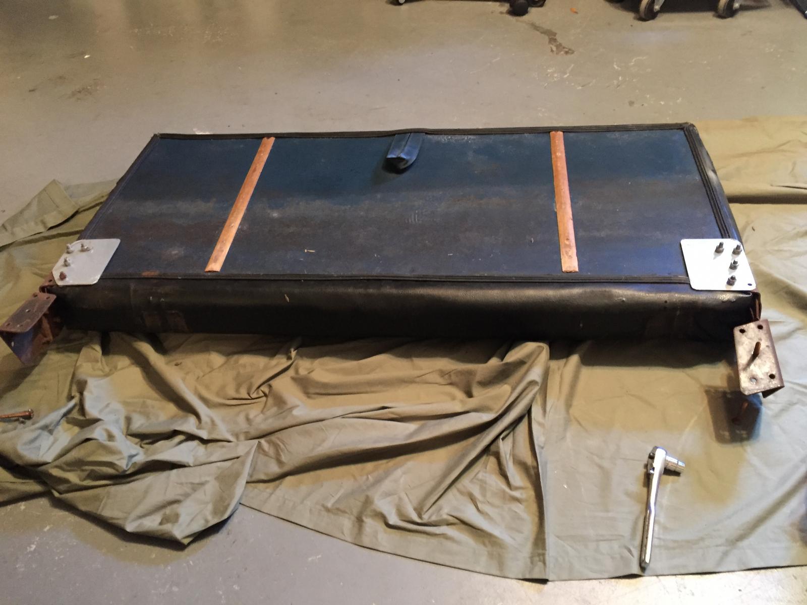

So I got up early yesterday before work and started to do some minor deconstruction and some cleaning.
I started using BlueMagic leather and vinyl cleaner and followed it with their conditioner. The seat behind the driver's seat (if someone could give me the proper name for it that would be great!) was extremely dirty so i also hit it with some Purple Power and a light brush.
Then I was testing out the maneuverability of the z-bed. It was super hard to get it to recline even a little bit so I decided to unscrew the hinges from the bottom part of the seat and pulled out the top and hinges for a cleaning, sanding, painting and regreasing.
As I was taking off the hinges I noticed three different screws being used. Confused
I am assuming the long bronze-ish on is the right one.Also, how many screws are supposed to be attached on each side and where can i buy new ones?
Yes I know it is stripped.

Your shorter flat head screw is probably the original, but maybe not a single one is. I really don't know. Most hardware stores have quite the selection of wood and sheet metal screws these days, you just have to be willing to pull out a lot of drawers to see what is hidden on the shelves. It is quite possible that some of you holes have been stripped so you will end up with more than one diameter screw which since the larger screws will also have larger screwheads can possibly cause problems.
It looks to me like your tires are probably P185/75r14 tires (or something close to that size) which are way underrated for a bus and especially if they are very old could fail all to readily.

Wildthings - That's what i was going to do if I could not find originals. I'll measure the thread pitch when i get home. Also, the tires are 195/75/14. What do you mean by underrated?

Tires are only designed to carry so much weight. You wouldn't expect to see the tire designed for a Smart Car installed on a semi. Your present tires have a load index of 92 which means they are only designed to handle 1389# in passenger car use or 1264# when derated for MPV/light truck use, while your weight rating is going to require a stronger tire. A P205/70R14XL (load index 98 ) or P215/70R14 (load index 96) will meet the load requirements of your vehicle, but many people think you need to go even stronger and use a 185R14C truck tire or even something heavier. There are also 195/75R14LT (LR 96) tires that will meet your needs, these tires are available in a more aggressive tread.
