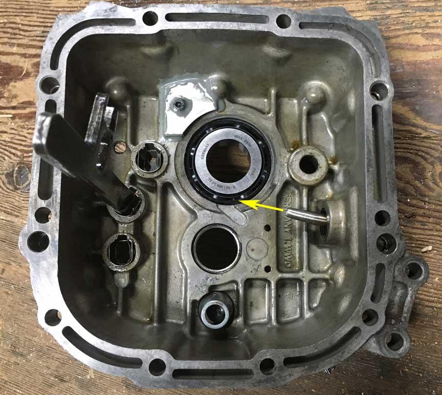

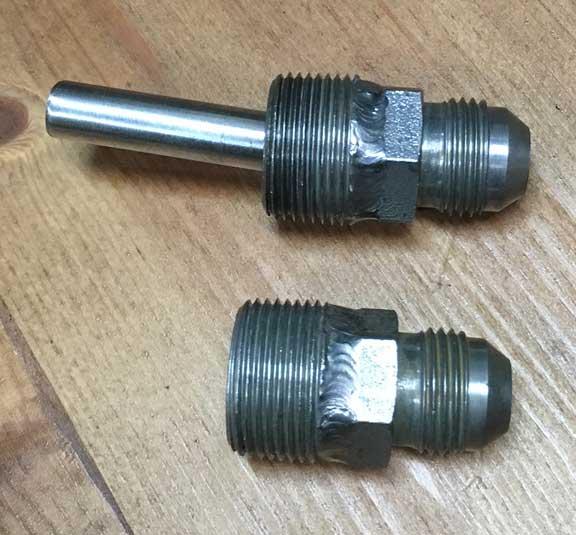

Goofing around with the TIG welder today. I made a set of 8AN bung fittings for the case that a guy wants to add the pump & cooler system to a trans thats in the van. These fittings are made from VW bungs obviously. The drain bung won't work on a Smallcar bellhousing, pretty sure it's for a VW bellhousing only. (?) Weddle pump, cooler and filter come with 8AN fittings.
I tapered a stainless pipe into a nozzle and aimed it at the mainshaft bearing. Current transaxual wisdom holds that 4th gear and the mainshaft bearing are trouble points for big engines, driving fast (65mph+). Because they are so far above the oil level they can overheat and sometimes even melt the plastic needle bearing cage inside the gear. It's a good location to squirt your cooled oil.
You'd have to mark the fitting, and add some teflon tape and "clock it" to aim at the (1/8") gap between 4th gear and the Mainshaft bearing. The nozzle took a lot of time, was a challenge. Inspired by the nozzle in Gears' thread.
Nozzle welded inside.

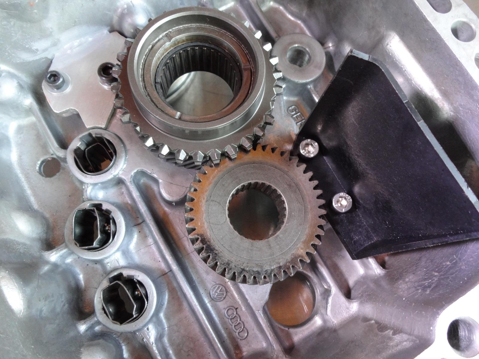

Will that still work with the SA oil plates?

I think so. You can see the two holes for the SA oiling plates it's pretty clear of those holes.
If pipe is centered over the "MA" of "GERMANY" it aims right at the lower opening of the bearing.

Sodo wrote:
I think so. You can see the two holes for the SA oiling plates it's pretty clear of those holes. It goes directly above the R of "GERMANY".
I was kinda hoping that the volume of oil the pump is moving would create a splash on that plate and throw some in the direction of 4th gear.
I do like seeing it aimed in the right direction.

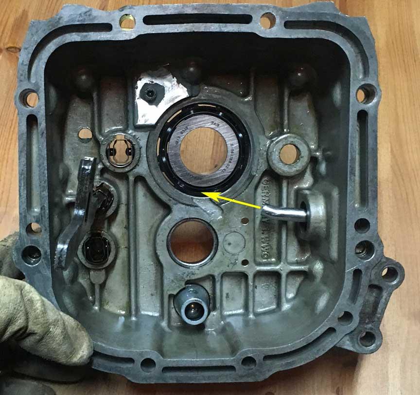

PostPosted: Sat Feb 06, 2016 12:11 am    Post subject: Re: Manual Transaxle oil cooler bung fittings (homebrew) Reply with quote
I made another set.
4th gear and the bearing spin in the direction to gobble up the blast of oil. Straight pipe aims at the little oil-gathering channel below the bearing. The maximum possible angle points at this channel.
A little more angle would be preferable, but that rib (between GERMANY and the bunghole) limits how far the pipe can wobble off-axis as the bung is screwing into its threads.
Here's the set.
Then I decided to bend it a little. It wasn't easy. Next time I'd bend a longer piece of tubing THEN cut it after bending.
This angle is better. If it was just a little longer it might be better, but I don't know if it's gonna collide with stuff (such as the SA oiling plates). I don't have the oiling plates. But you can see the screwholes for the plates that Weddle put in this case.

I specifically left out the 4th gear splash plate because I assumed it was going to interfere with direct oiling via the fill port. If the choice was between oiling via splash plate or via circulation there is no contest as to which is better. If you were shooting oil straight in (as was my original plan) the danger is that the oil could all just shoot downward off the plate instead of upwards, to the detriment of 4th gear and the mainshaft bearing. If you could get both with a nozzle like this then it would be a win-win.

If anybody wants to bring me an SA splash plate I'd like to bolt it onto my housing and verify a nozzle can get by it. Also would like to extend the nozzle a little. I think there are a lot of splash plates already installed by the big-engine crowd because it was the best option available.
