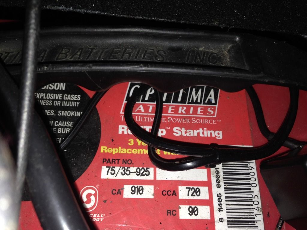

PostPosted: Tue Feb 16, 2016 8:47 am    Post subject: Re: Which modern battery for 1973 Thing? Reply with quote
I realized I really didn't answer your original question...
I took a look this morning and have a pic of the label on my battery. I was certain I had a battery from Advance Auto Parts, but somehow I've actually got an Optima agm battery in there....(? My memory is really bad.....)
Anyway, here ya go! Part number is right on the label, for reference.
I'll also note that I installed the plastic terminal covers, to insulate them from any potential contact with the seat springs. Added peace of mind.

SomeThing
Joined: February 16, 2010
Posts: 43
SomeThing is offline
PostPosted: Tue Feb 16, 2016 12:19 pm    Post subject: Re: Which modern battery for 1973 Thing? Reply with quote
Very helpful. Thanks, again Joe!
