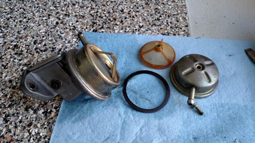

I think that's a great move on your part! Again, I LLOOVVEE those Pierburg pumps. They were so well made that I rarely see any worn parts inside them other than the diaphragms and gaskets. Just double check the inlet and outlet pipes are tight (I'm sure they will be) and put a bunch of grease in the pump lever area before install.
Here's some pictures from when I rebuilt my 67 bug engines pump. In one of the pictures, you can see the engine is running and the fuel pressure gauge is at 3psi. You have to love NOS rebuild kits. Smile

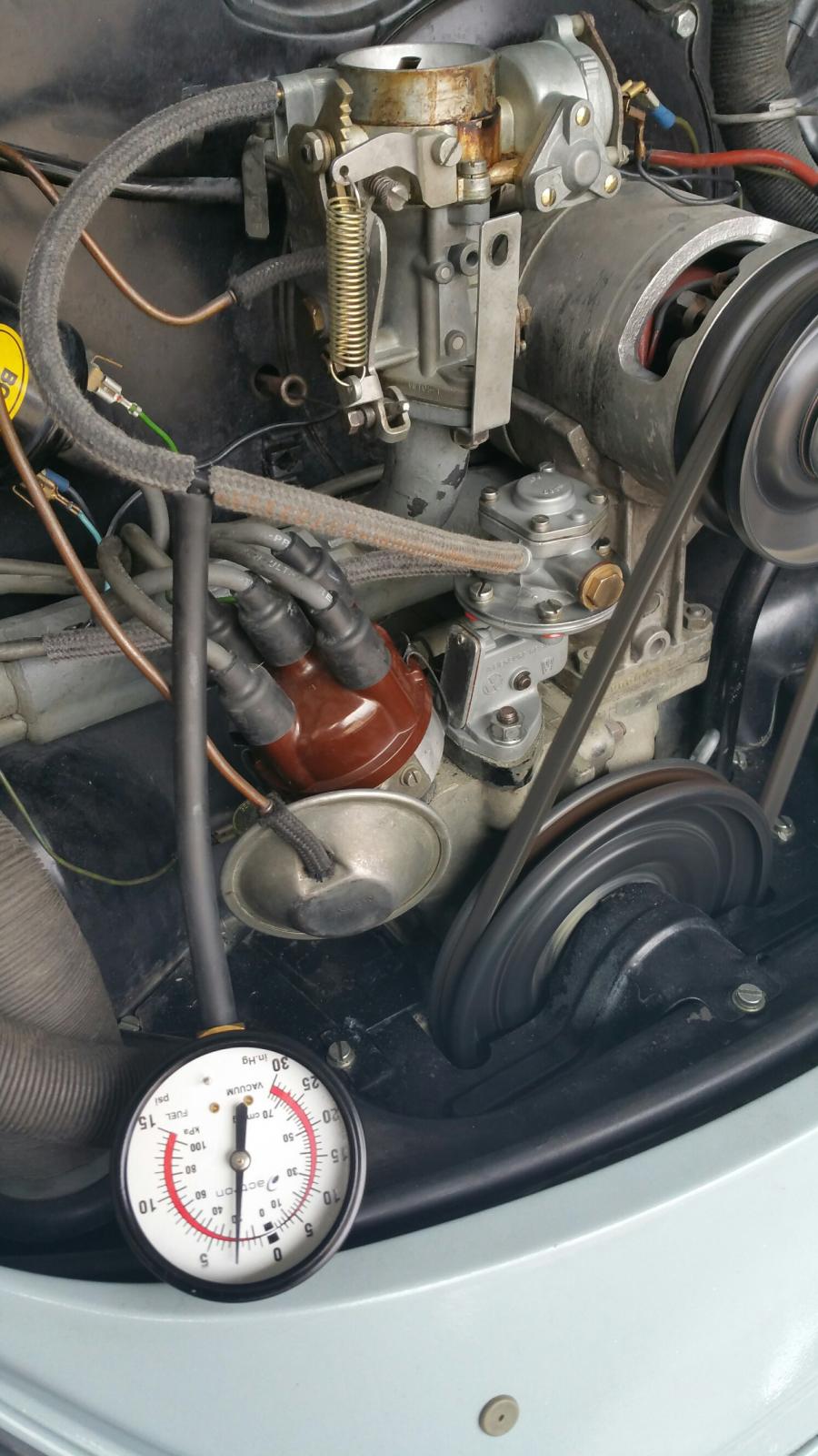

PostPosted: Sun Mar 06, 2016 6:05 pm    Post subject: Re: Brosol fuel pump rebuild kit. Obsolete? Reply with quote
A pic to match yours Bill. It took 3 gaskets total but it's steady at 2.8psi. It really did not like the initial 4psi and was still unhappy even at 3.2 before the 3rd gasket.
However, it's seeping a bit at the top delivery valve plate and I believe that's because the top has been sucked down through the years and contacts at the corners, not compressing the gasket/ring enough. Will try putting that on a sander to remove a small amount at the corners or Bob that sold me the pump is hunting his stash for a good plate.
