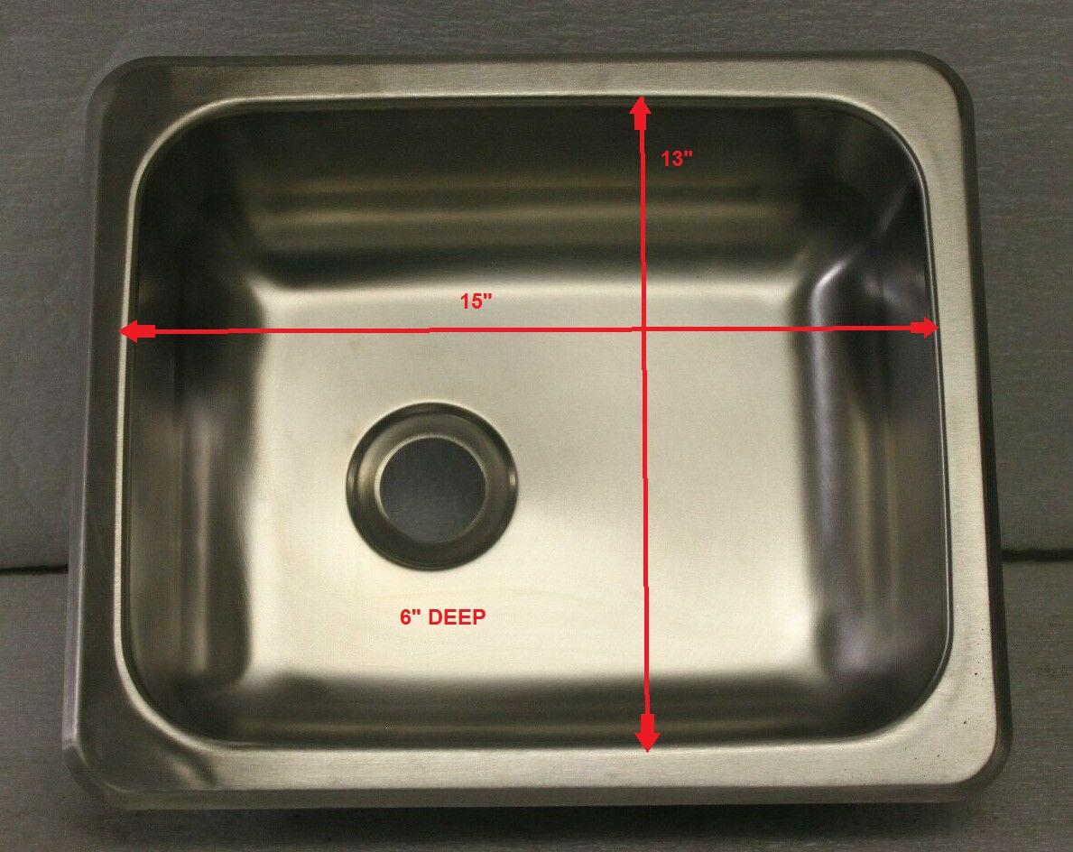

The Westy kitchen is fine for me. But if I were starting from scratch I'd make the sink a little larger and have a corner drain to allow for a proper-size drawer, change the stove grate style, and put an adjustable shelf in the cabinet. As for the fridge, for me, I'd put a drawer above a Truckfridge.

So a sink like this one vs the Westy round one?

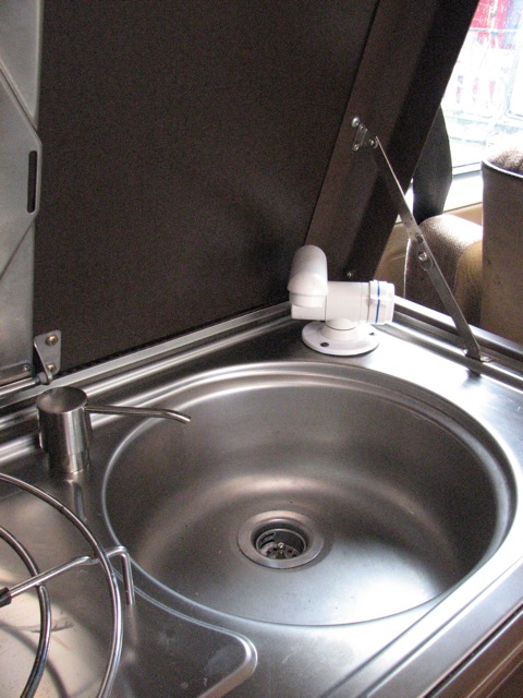

I’d would like a higher than 2.75 inches for the top, then I would have ease to put a soap dispenser.
The soap dispenser reservoir then would be under the sink, and the arm would goes in the sink, as we see often in a house kitchen.
An idea - hope it helps.
Martin from Montréal
1986 Vanagon GL full camper westfalia
(brown/tan interior)
Timwhy
Joined: January 01, 2009
Posts: 4101
Location: Maine
Timwhy is offline
PostPosted: Fri Apr 10, 2020 9:38 am    Post subject: Re: Westy Sink / Stove Dimensions Reply with quote
Here's one.
Member 1621 his install.
https://www.thesamba.com/vw/forum/viewtopic.php?t=...=soap+1621

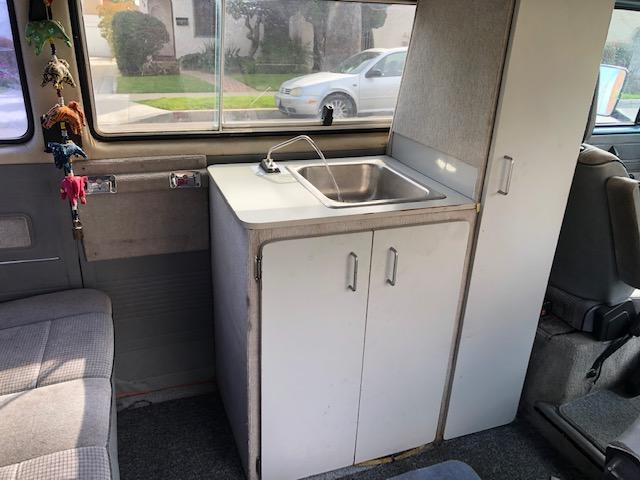

Good point. I just bought this sink in the classifieds. It's out of a Country Homes van. Measures 11-3/4 x 12-3/4. 5" deep.
Thanks for the input on the Truckfridge and cooking burner use. Those two subjects will be on another post.

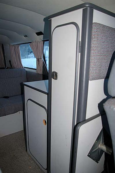

Dang, that's really nice...
This is more my speed

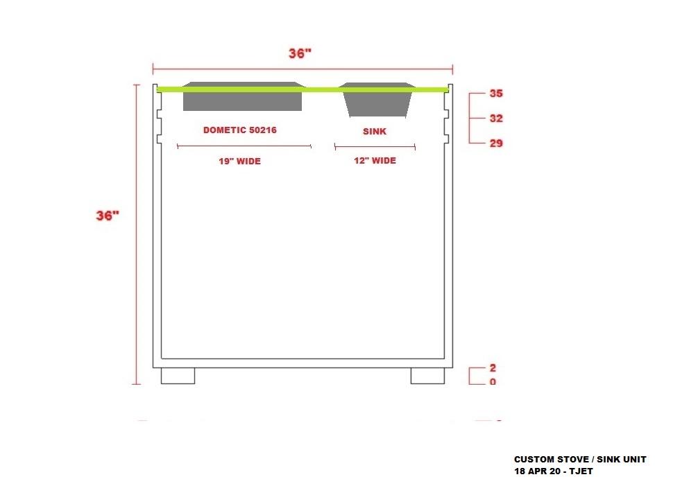

So I've been pondering over the overall size of my custom sink / stove cabinet for my tintop passenger van. I've been scratching my head on the stove height because of my current "low" ceiling. I came up with the idea to make it adjustable from aprox 28" to 36" by sliding out the counter top & putting it in lower grooves.
The unit itself will be 34" high by 36" wide. Eventually, after I install a poptop or highroof, I can raise the unit 2 more inches with blocks to a total height of 36", which incidentally, is the most common stove height in the US. The 34 & 36" heights would be flush with the counter. The width measurement is approximate, dependent on z-bed clearance.
I'm still working on the details for the Truckfridge placement, drawers, and a recessed folding leaf on the aft side.
The side panel facing the sliding door will have a removable screen to fill in the adjustable height gap.
I will make a mock up first to see if I like or hate it.
https://www.dometic.com/en-us/us/products/food-and...ifications
