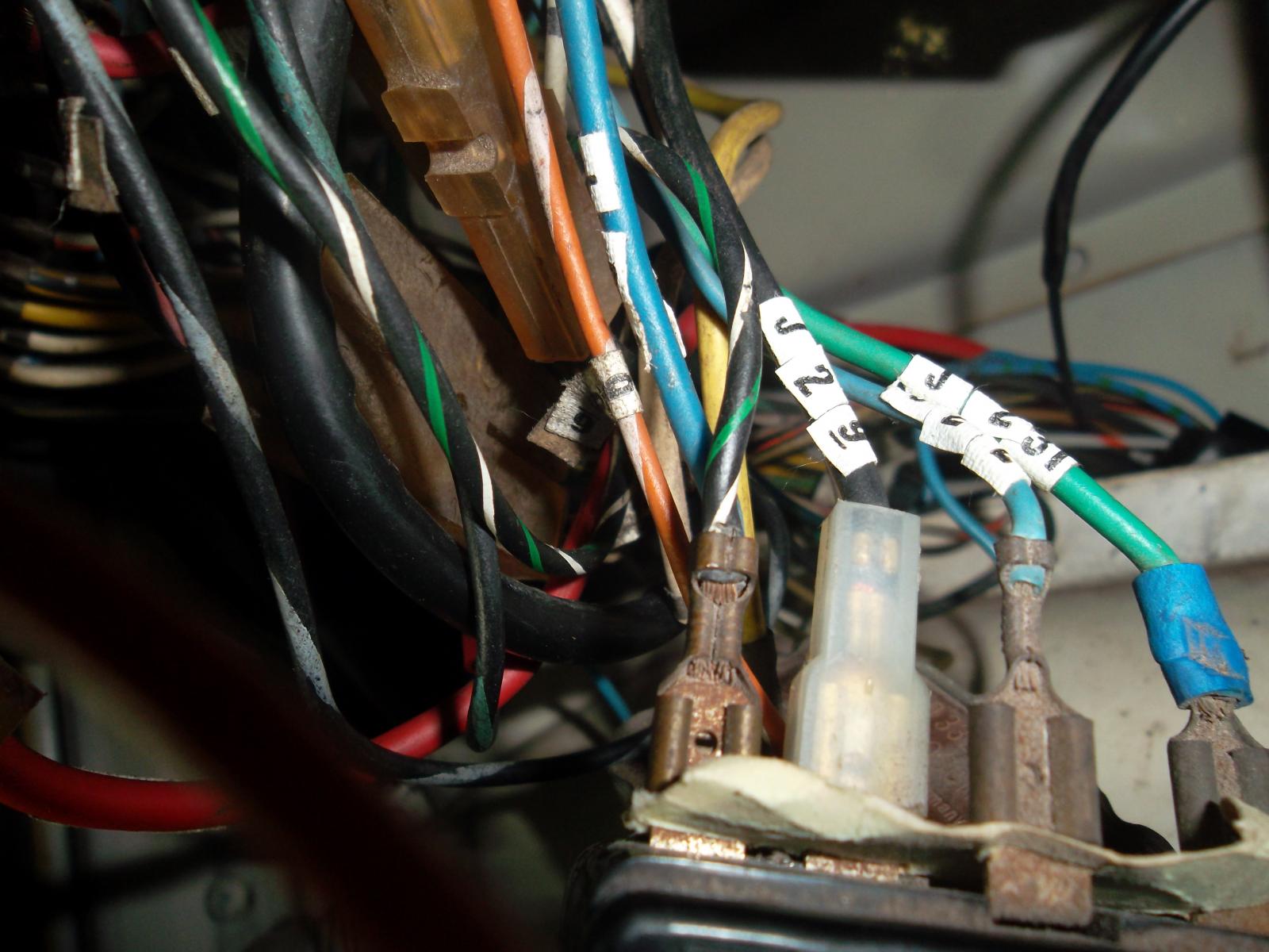

Turn signals, hazards, work great as theyre supposed to. Actual lights are blinking and the turn signals on the dash blink together.
However, with the ignition in the 'Run' position, the blinkers work, but I get no blinkers on the dash. When I use the hazard light, same thing: actual lights are blinking, but no signals blinking on the dash..
Any ideas?

Ahhhh...., thanks for adding that, so many different signal circuits it's impossible to cover issues with a blanket fix. Start by counting the terminals on your flasher, if it's the OG one it likely has 4, if it's a replacement it's probably got 2 or 3, Kbl needs to be piggybacked on 49a if it has less than 4, or your OG 4 terminal relay has issues internally.
All this assumes your fuel gauge and idiot lights work normally.

Replaced my aftermarket 4 prong flasher with a new one just in case..
Same issues: blinkers and flashers work fine , just no lights on the instrument cluster while key is in "run" position. Instrument blinkers work fine in the "acc" position.,,

Sorry: wasn't clear and had it wrong:
Key out or "off": hazards are blinking and lights blinking on dash
Key in and turned at least one position to the right: hazards blinking and lights blinking on the dash
Key turned two positions to the right: hazards blink but no blinkers on dash- all idiot lights on and fuel gauge indicating fuel level.
Also- turn signals work but no lights on dash

Oh my goodness:
Trava : hazards blink and indicate on dash
Desl: hazards blink and indicate on dash
Lig: hazards blink but do not indicate on dash. Blinkers blink but do not indicate on the dash
Partida: start position- not concerned about the lighting
I did wire the flasher as BD mentioned: basically did a one for one wire swap from OG relay to new 4 prong aftermarket one

So the Kbl wire is piggybacked on to terminal #49a?

No- I wired each corresponding to its match on the aftermarket. KbL went to K1, which seemed logical..

The new after market flasher units HAVE to have 21 Watt max bulbs F&R to work right. WolfsburgWest part # N177322 (single element) and N177372 (dbl element) $1.70 each.

thanks. I'm actually talking about the blinker INDICATORS on the dash, not the external lights....the external lights work great .

OK well try switching 49 and 49a incase you got them backwards unless you marked the wires when removing from the old flasher. 49 goes to the emergency flasher switch and 49a goes to a triple connector.

Follow the Green wire on E3 E-Switch #15 to the fuse box. Make sure the Green wire and the Black wire from the dash turn signal lights are connected to that fuse on the fuse box.

Ok- so I piggyback kbl onto 49a on the relay. Lights now come on the dash with the key "on"...
But it's both blinkers on the dash blinking now, whether I do left or right turn signal Smile
