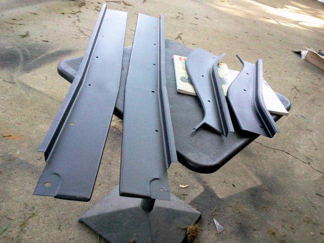

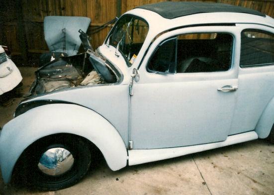

OK. We only get a few hours a week to work on this thing. It started life as a decent 63 canvas top bug. Then an old woman in a new Cadillac smashed it up. We then took a rusted out shell of a 56 (dash, cowl, doors) and started surgery.
I will post more pictures soon but now we are working on the floor pans so thats gonna be the first pics. Just needed a place to start putting these pics. Very Happy

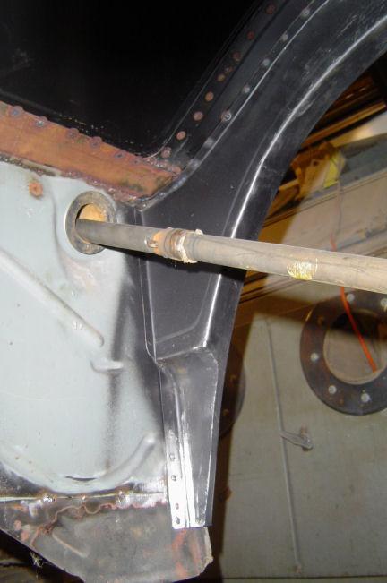

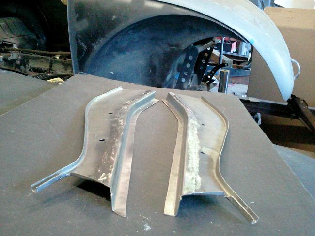

Now the pan edges are in DP90 and ready to weld together. Next will be putting in the recess for the pan fasteners.

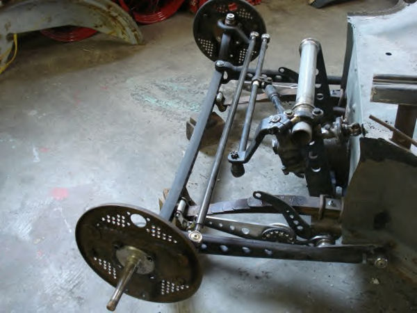

Steering arm for the flipped steering box. Made from laminated 1/4" plate. 3 pieces make a 3/4" thick arm. Cut the clamping area from an original arm and turned it around backwards.
Here's how it fits. Going to use grease "dough" instead of liquidy oil in the steering box. You can see the old oil is leaking onto the leaf spring.

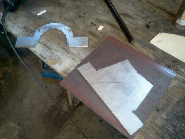

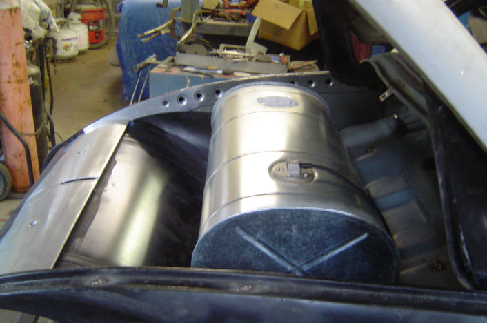

Gas Tank.
Repo Ford Model T Gas Tank sits up front like so. Gas tank has threaded outlet. Gas cap is a threaded brass spinner.

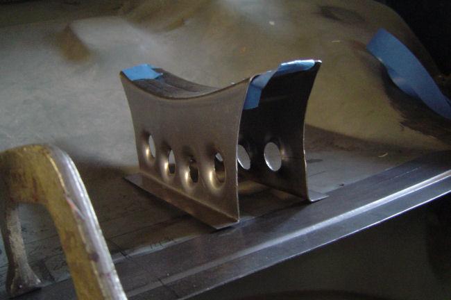

DIY Gas Tank Brackets. Made from 4 separate pieces but they match up and butt welded great. DP90 for now.
DP90 looks like shit right when you spray it. But it dries pretty.

PostPosted: Thu Apr 25, 2013 9:36 pm    Post subject: Reply with quote
A view of the tank area. There are inner panels that meet the elements. Then there are interior panels both front and back. We gots a hood prop too. It's shaped to fit over the gas tank.

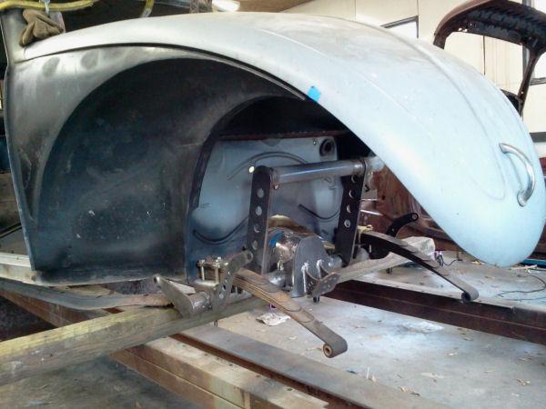

The area where the fenders bolt on has been removed. Tranny raised 2" and the torsion housing raised 1-1/2".

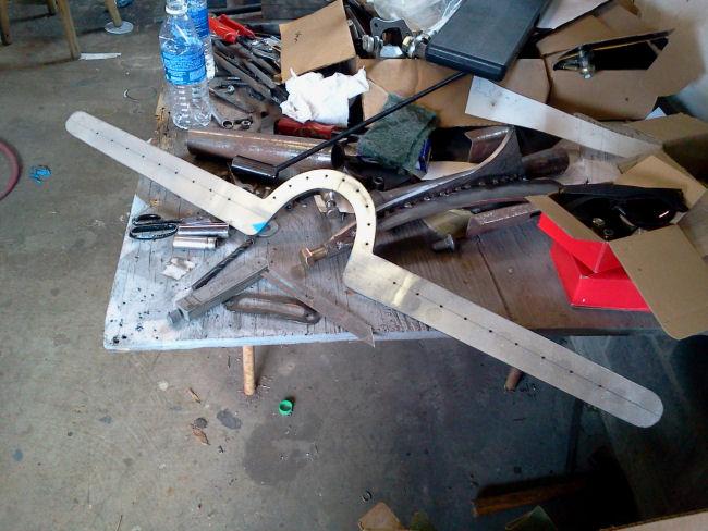

PostPosted: Sat Apr 27, 2013 6:11 am    Post subject: Reply with quote
Thanks aaronr25. Its a 34 Ford 5W. Here are some more parts.

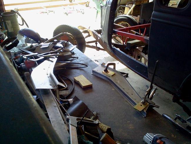

The shifter so far.
The steering column drop.

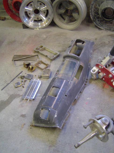

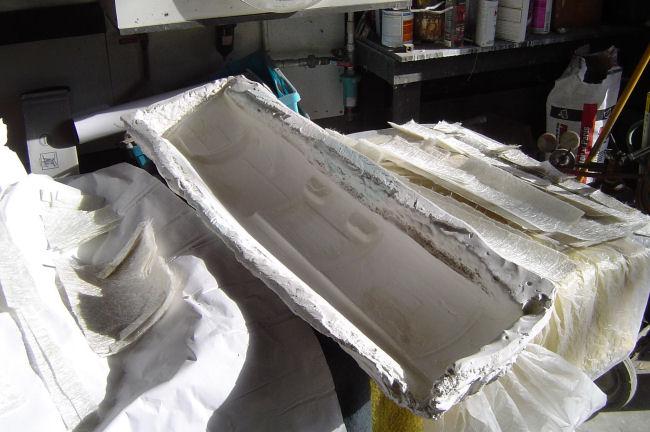

Took a stock 40 Ford dash, stripped it down, and made a plaster mold in order to make a fiberglass version for the bug. After the fiberglass copy was dry, it was narrowed and then shaped on top and ends to fit over a stock oval dash.

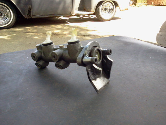

PostPosted: Sat Apr 27, 2013 12:40 pm    Post subject: Reply with quote

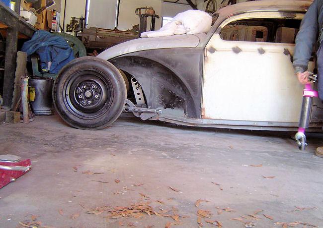

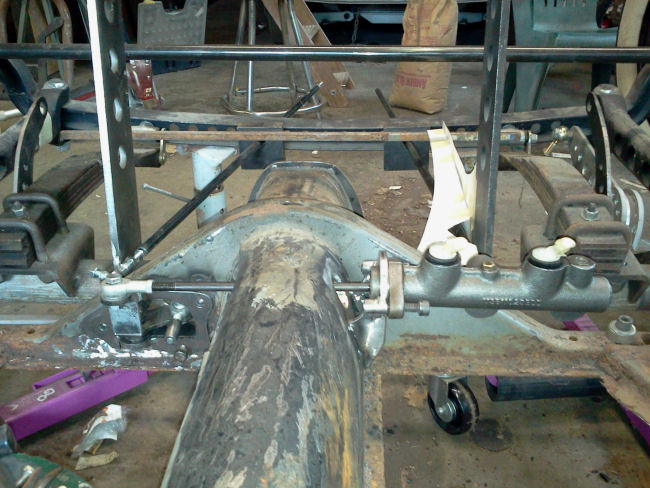

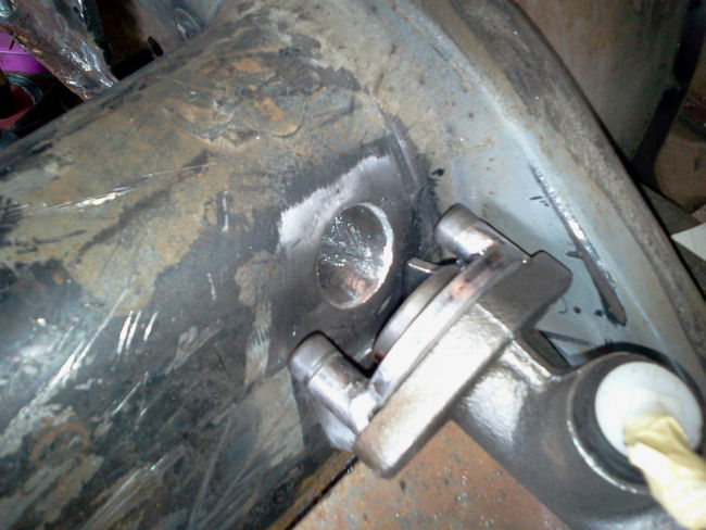

Frame Head.
Front Shocks.
Brake Master Cylinder.
Stance.

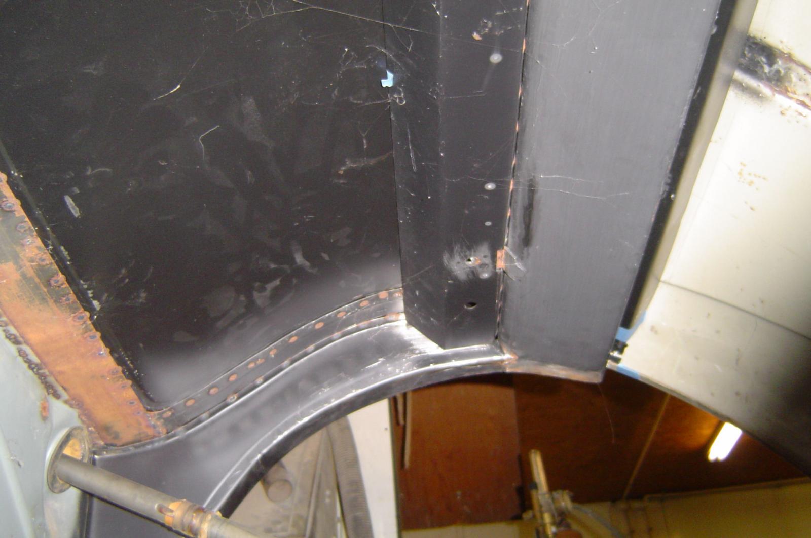

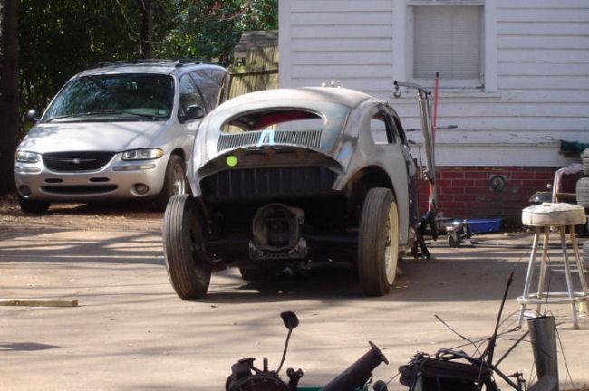

How the metal work looks under the gas tank area.

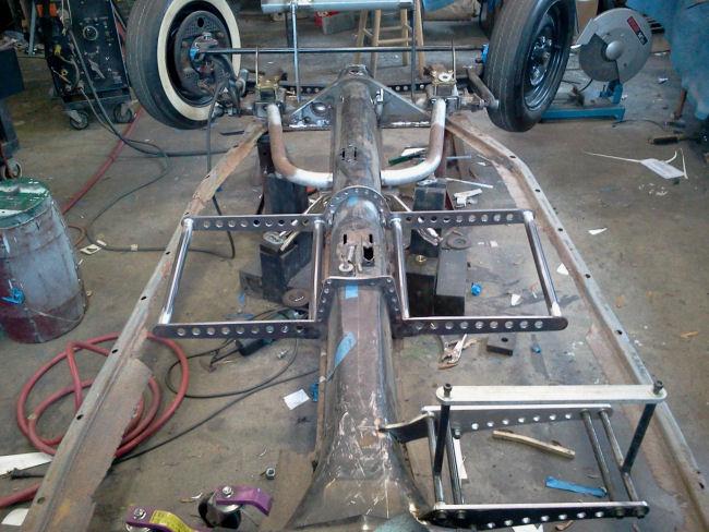

PostPosted: Sun Apr 28, 2013 8:07 pm    Post subject: Reply with quote

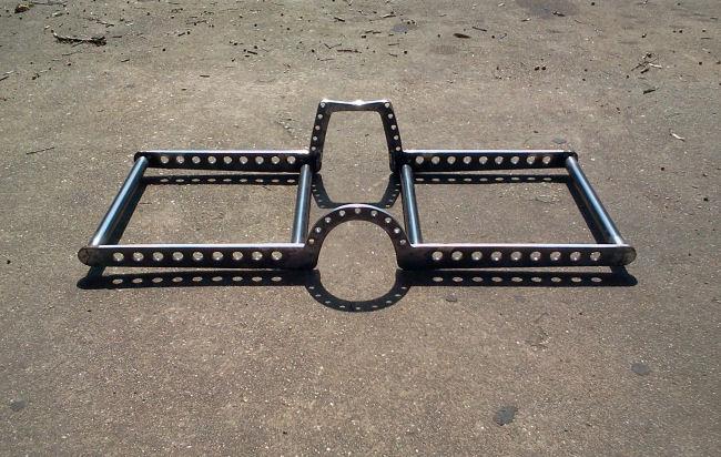

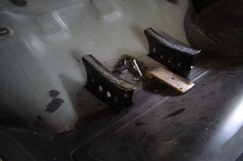

Seat Brackets.

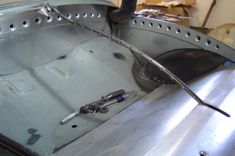

PostPosted: Sun Apr 28, 2013 8:09 pm    Post subject: Reply with quote

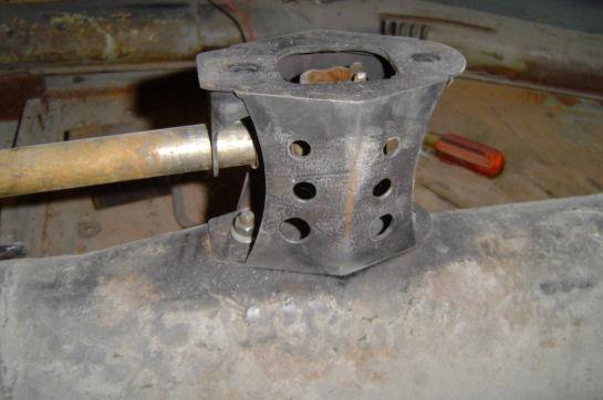

Hood Prop goes here.

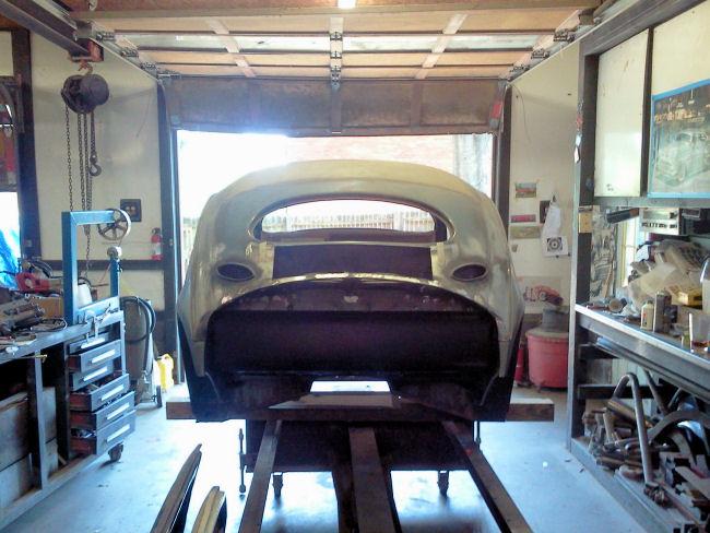

PostPosted: Sun Apr 28, 2013 8:10 pm    Post subject: Reply with quote

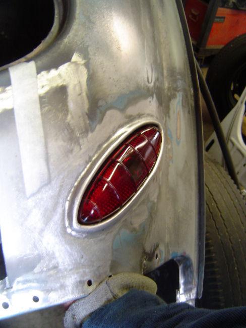

49 - 50 Ford tailites. Will be louvered under window.

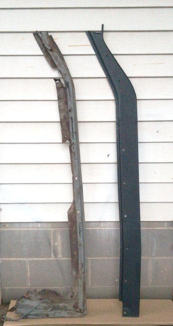

PostPosted: Tue Apr 30, 2013 9:21 am    Post subject: Reply with quote

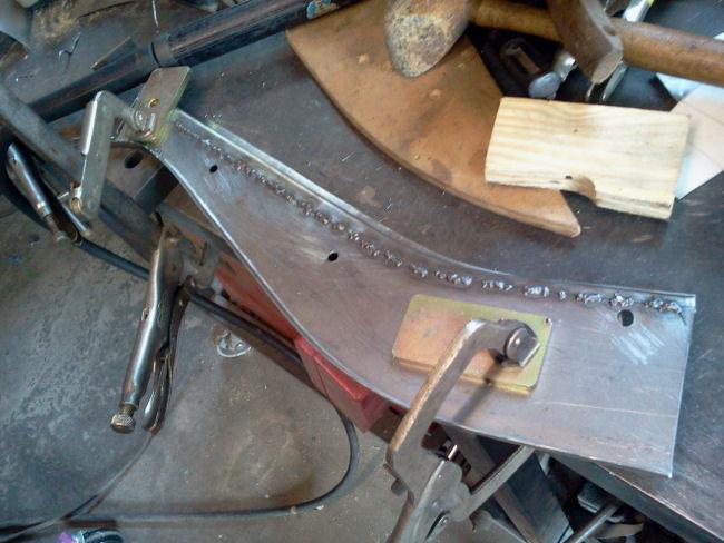

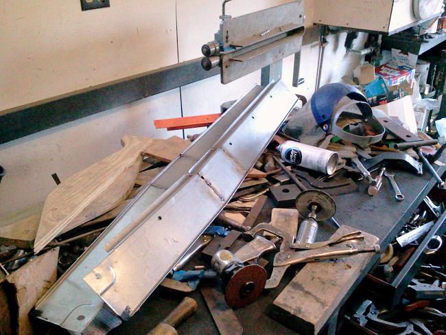

Current picture from today. Finally, pan edges are one piece!!!!!!!!!!

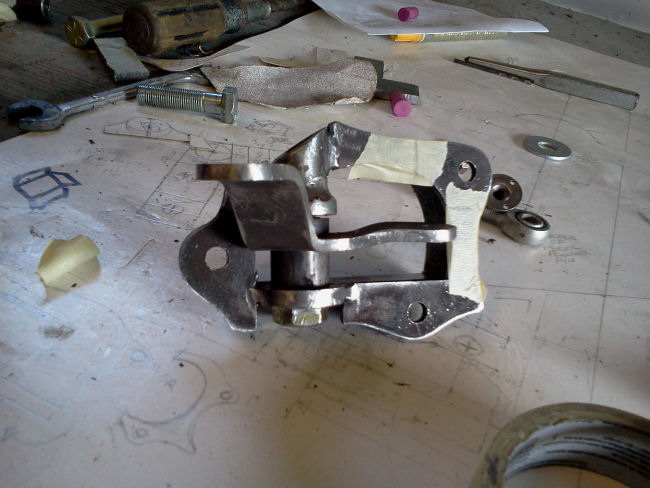

PostPosted: Sun May 05, 2013 10:14 am    Post subject: Reply with quote

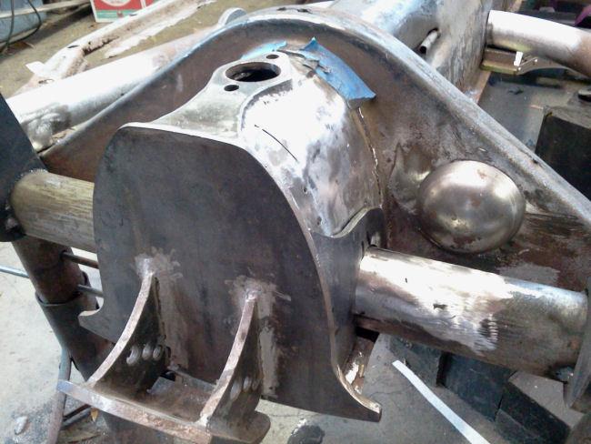

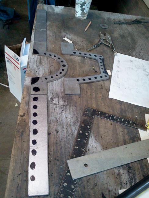

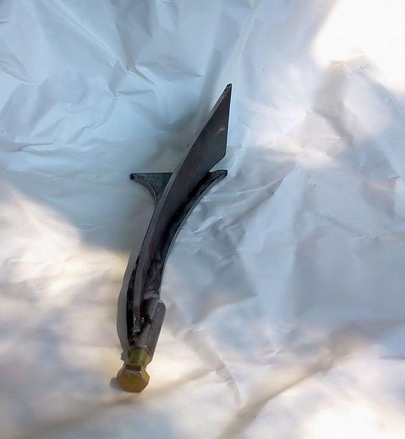

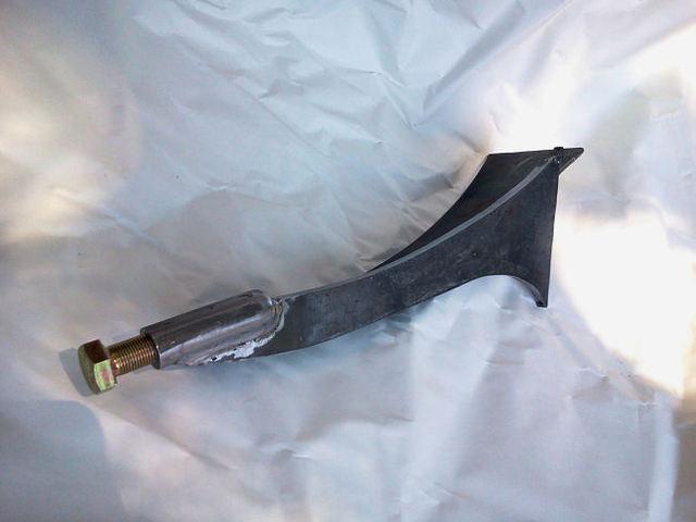

Front Panhard Rod Bracket. 1/4 plate and a reciprocating saw.
