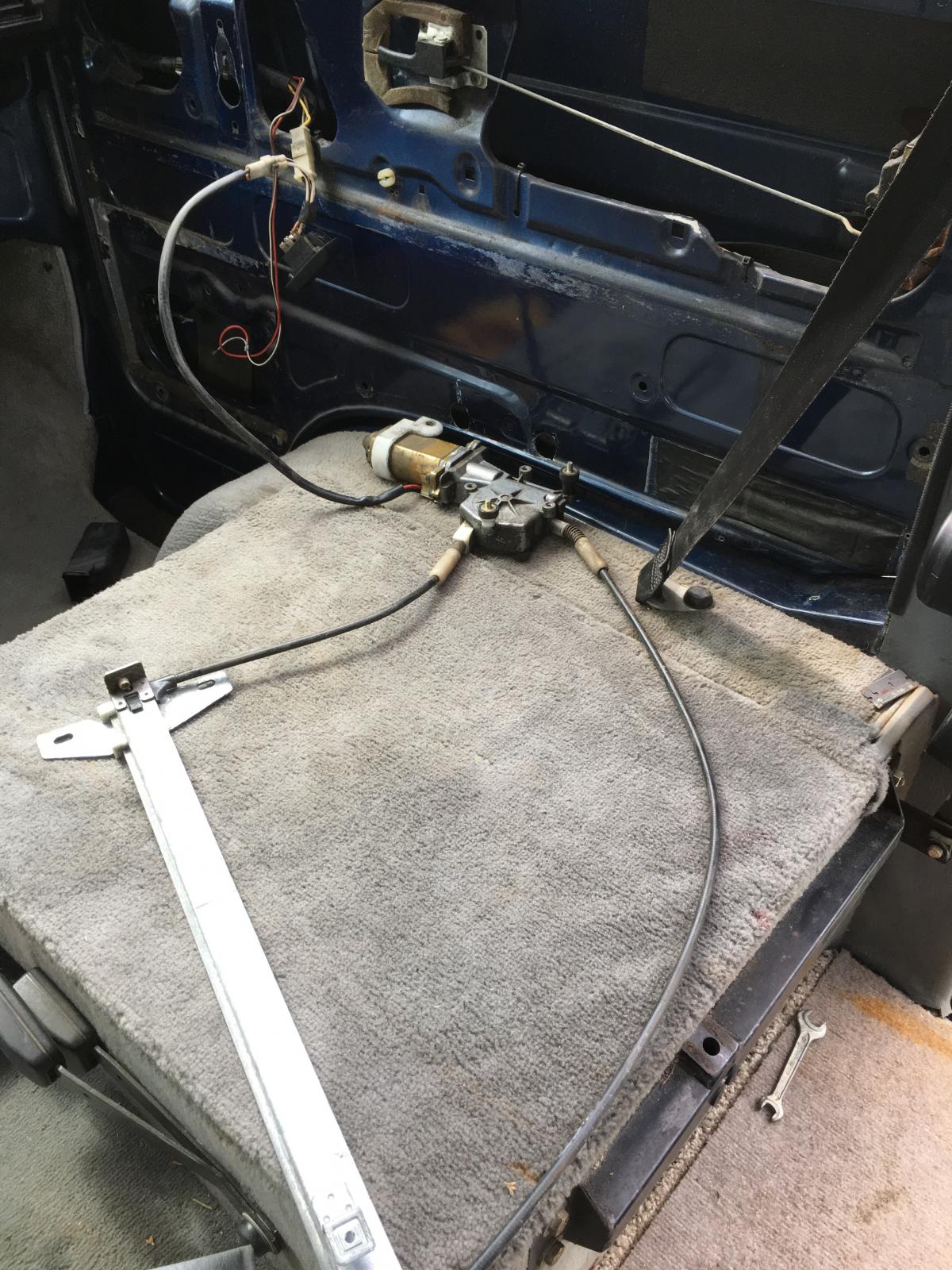

This is actually pretty interesting that someone who is incredibly familiar with regulators and motors had the same problem as I did and both of us came up with the right solution.
So I'll post these for anyone who has this issue as it's easier to get the window up or out that it is to snake the regulator out of it's mouse hole. I am baffled by how the original German designer calculated that the regulator could come and go through such a small hole and then committed to big bucks tooling for the inner door panel. I wonder if the motor and regulator had to be "tweaked" slightly to allow it to happen. NO extra room.
Any way, I did pull the driver's side panel away enough at the top so I could peak in and see how far down the window had to drop for the hole to line up with the bolt. 1" So I measured the total window distance travel--~20" and measured down 19" from the existing hole. But where, from front to back. By aligning a stick against the vent window pillar I was able to make a Sharpie mark in line with that on the bottom of the door line. Ditto for the back edge. Then I measured the upper bolt access hole from both front and back and transferred that to the tin at the bottom. When peeking at the driver's side, I noted that the hole is for the front bolt and by lowering the window a tad more found that the bolts are 4" apart. So 4" back from the first mark I made a second, I didn't have a metal cutting hole saw so did the postage stamp removal method and cleaned up the uglies with a rotary file chucked in the drill.
And low and behold, you can see the bolt right in the center of the hole.
And the second hole with the two bolts successfully removed. That's a 10" woofer magnet harvested from a failed item and it held the bolts in the socket for a safe removal without dropping them. After the bolts were out, I removed the regulator slide bolts both at the top and the underside of the door and removed the glass. My scrapers were in desperate shape and the wind wing window needs a mod too so that's why the glass came out, but if it's only the regulator, then it can stay in place.
Proof that the system worked.
After about ten minutes of tugging and removing the plastic cap that covers the door holder-opener thingy, out it came. Now the fun part. I had checked power and continuity to the motor itself, so know it's really the motor. Pulled the cover off the gear box and the two mounting bolts, but can't withdraw the motor so will have to find a thread or YouTube that explains it all.
For anyone with this problem, Here is the easy out--pun intended. The front hole needs to be 2 ½" forward of the panel securing snap hole, and the other 1 ½" behind the snap hole.
I love it when Samba can help others--It's what we're all about--and bragging rights for having figured it out too, of course.
