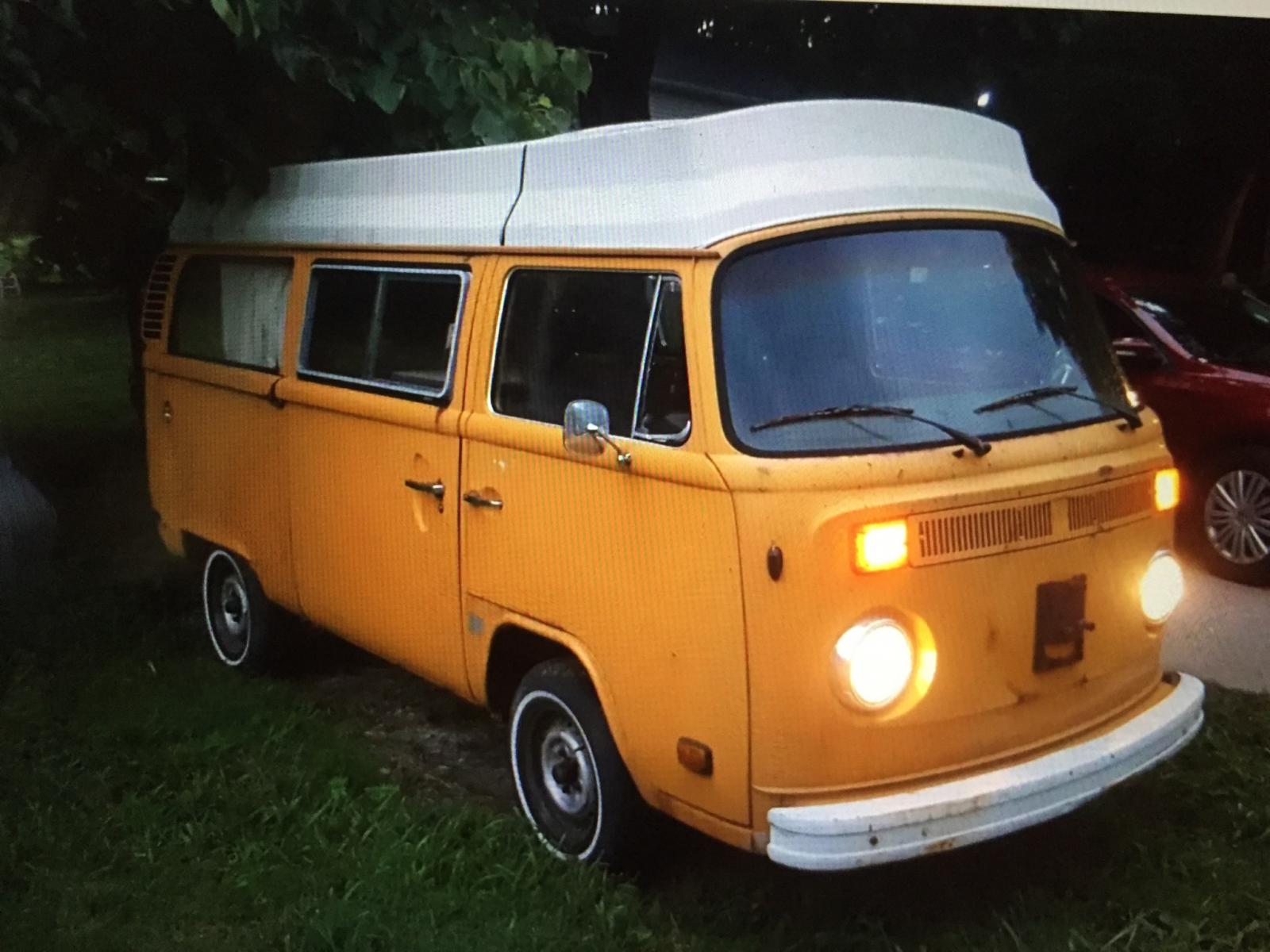

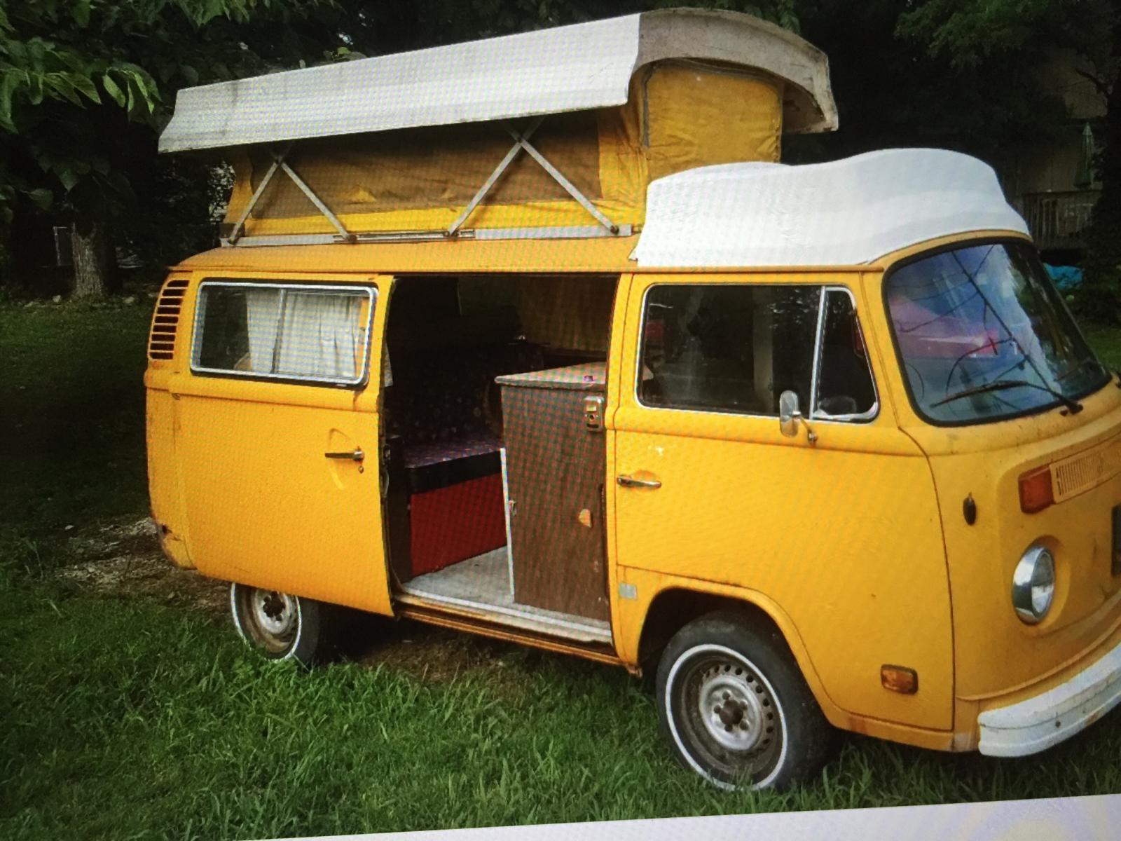

BUT I lucked out a couple weeks ago with a 1976 Riviera that came up on eBay. It's got a few problems (well, hopefully just a few), but I'm more confident in my mechanical abilities now than I was back them. So bring on the challenge!
The first challenge.... getting the Bus from Missouri to So Calif. It's taken 3 weeks, but it's due to be delivered on Tuesday. And I feel as excited as a six-year-old on xmas eve.

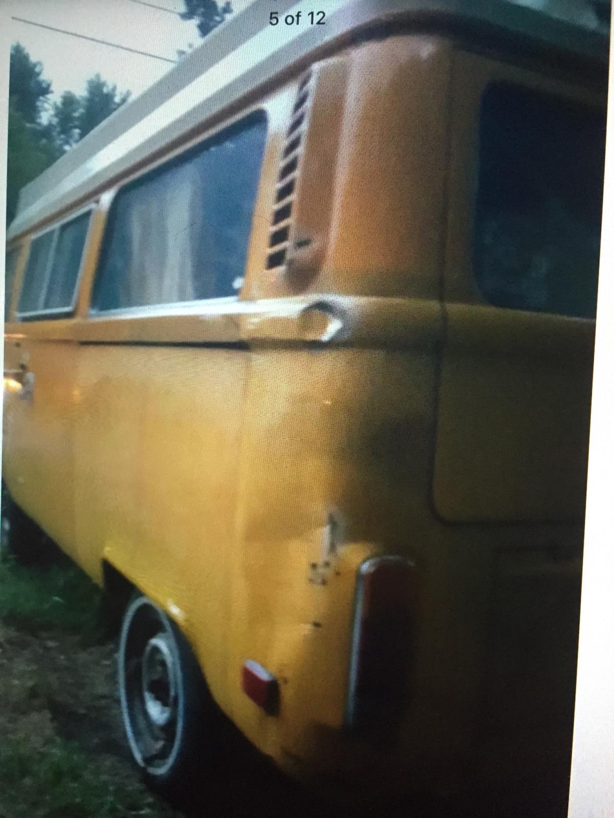

I'll show the pics as I saw them on eBay....
Overall, it doesn't look too rough. A bit of damage and some rust in the expected places. According to the seller, it runs "when it wants". And he included a short YouTube video of it running the day the ad was posted, and it sounded decent.

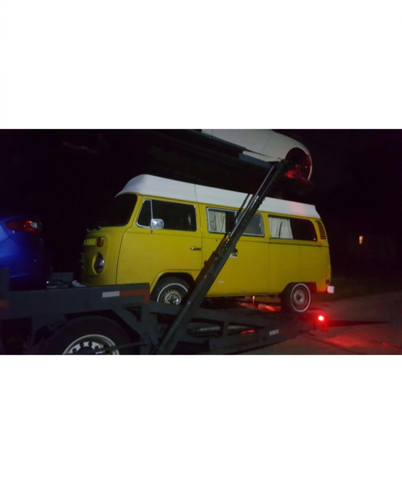

When it was picked up for transport, it made it onto the trailer under its own power. Woo hoo! (even tho I had to pay a $150 surcharge in case it didn't. And a $200 surcharge due to its height. But don't get me started on that road.)
So here are my thoughts on how to proceed with this bus...
I'd like to have it as alternate daily transportation, in case my incredibly reliable Mazda Tribute with 186,000 miles decides to take a break. And it's a camper, so of course it's for those 3- to 5-day getaways for camping in Malibu, Yosemite, Kings Canyon, Grand Canyon, or any of the other amazing escapes that can be found relatively nearby.
Since it's not going to be a show bus for me, I plan on making it a reliable source of transportation, and to stop any deterioration (and maybe reverse the ravages) in case a future owner decides he/she would like to show it.
Living in the Sonoran Desert of So. Calif, rust is not an issue. I can't even remember the last time it rained, although, ironically, the bus is due to be delivered on a day with a 40% chance of rain. (Maybe it's a good omen that the drought is ending?!?). And salting the roads....well, you get the idea. This isn't Missoula. We save the salt for Margaritas.

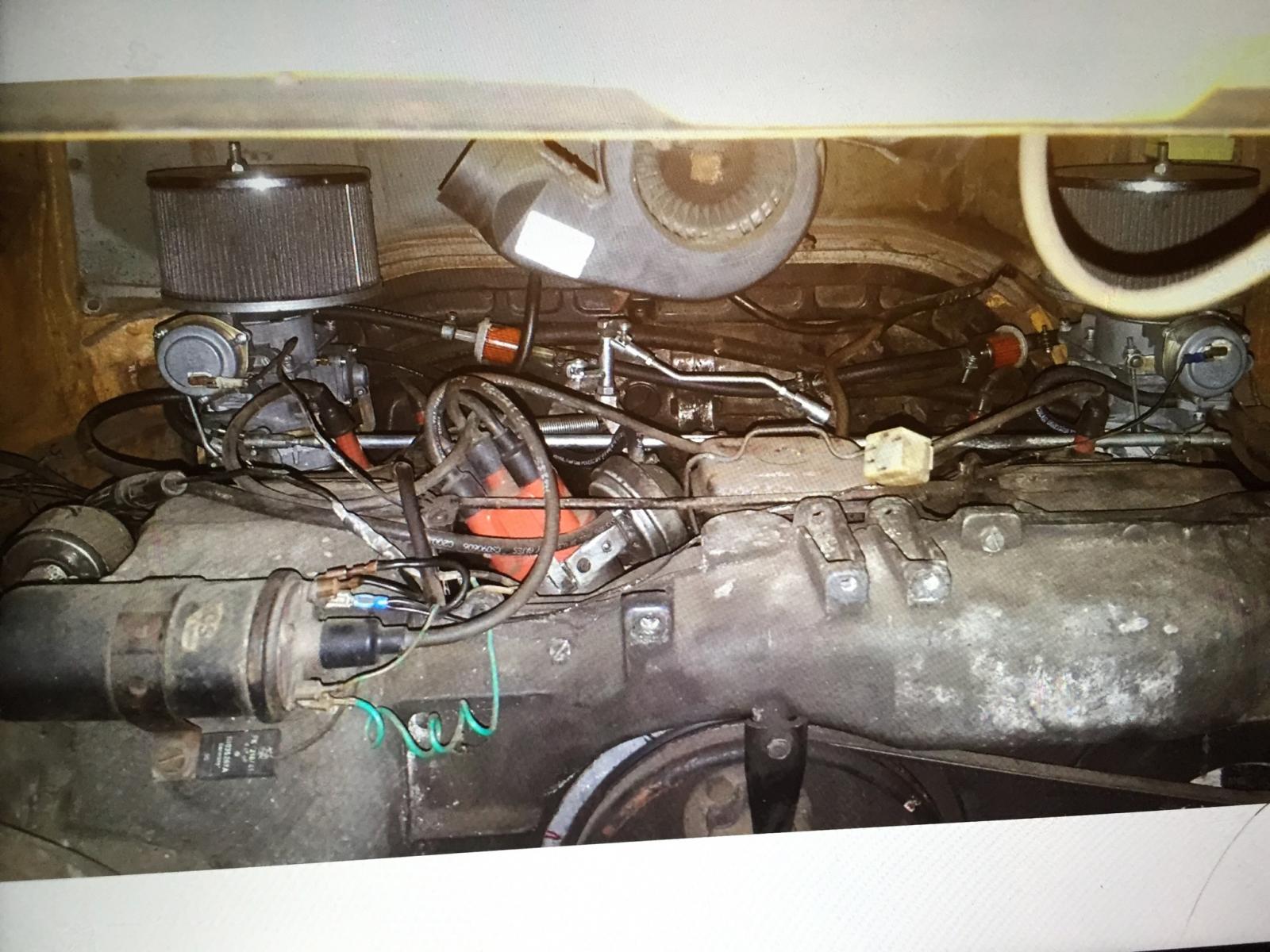

As soon as the bus arrives, it's going into the garage for a couple weeks to replace fuel hoses/filters and brake lines, belt, check timing/compression, change all fluids, drain gas, and an assortment of various things. (If it sounds like I know what I'm doing, it is almost entirely from reading every tech article and Bay forum on this site. It has been an invaluable tool, and steers me to getting and reading Bentley, Muir, and the Haynes Restoration book. You guys' knowledge has started to permeate my skull and, while not being proficient yet, has given me enough info to know what to look for and what to be aware of. Yes, Tcash.... 9 ft-lb. Got it!) Lol. Laughing

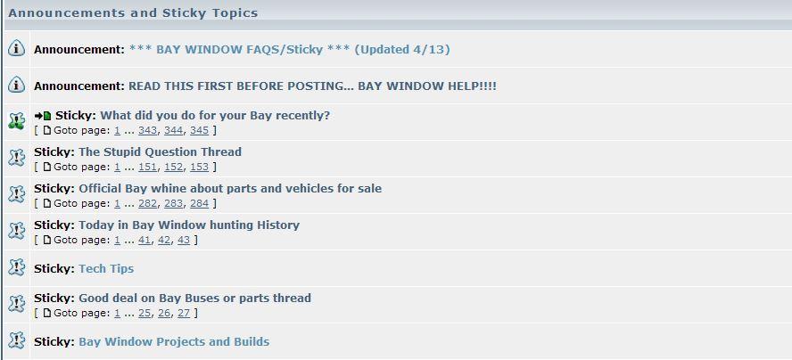

So between the "Stupid Questions" sticky and this thread, I'm hoping to have fun and learn a lot.

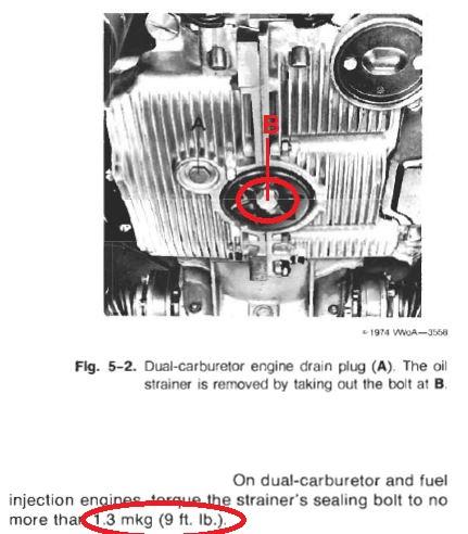

Every Type IV engine owner should know this!!!
If you over tighten the Oil Strainer bolt, you will brake the engine case!
There is a Oil strainer in there.
TORQUE THE STRAINER BOLT TO NO MORE THAN 9 FT. LBS.

With the Carburetors you may have problems smogging it in CA.

The carbs may cause the problem? I hadn't thought about that. Thanks... I'll check into it. They were just rebuilt last month, according to the listing.
When I bought it, I thought the Calif DMV only required smog checks for vehicles 25 years and newer. It wasn't until the eBay auction ended that I looked it up on the DMV website. Wadyaknow... all vehicles with model years 1976 and newer require it. Embarassed This happens to be a 1976.
(Edit: I lived in Seattle in the 90's, and up there, smog isn't required for vehicles more than 25 years old. I got it confused with Calif. That oversight is gonna cost me! Shocked )
I did check the smog laws in Missouri, and checks are required in the county this bus Is coming from. So maybe it will pass? I need to ask the seller when he last did it....or if he did it. It may have sat inop for the two years he owned it.
Btw... There is the YouTube video of it running right after the carbs were rebuilt. Since I can't figure how to post from YouTube, search "1976 Volkswagen Riviera with rebuilt carbs".[/youtube]
You are correct sir. You will need to restore all of the fuel injection equipment to pass the visual inspection portion of smog even before they sniff your tailpipe.
Congrats on the bus! These buses must be on the endangered list when California guys are buying from Miz to get one. I have a '76 too so feel free to reach out.

Swapping carbs for FI can't be that difficult....right?!? Rolling Eyes
This bus may be inop in my garage for longer than expected. But I'm still excited to get it. Only two more days till it arrives.

KentPS, congrats on the bus. I would like to issue an advance apology for the CARB requirements you are about to lose sleep over. With the help of the fine folks on this site, you can get it correct. I'm not going to say it will be easy, but it will be possible with hard work. And it will be fun in the end! Very Happy
EDIT: It looks like I see the 72-74 heat exchanger setup going into the muffler in one of the pictures. I do not know if this will be cause for a visual failure point on the smog test, but it's something we'll have to consider, later down the line.
aerosurfer wrote:
Question for the California smog guys, does the visual inspection differentiate between the early style EGR and later?
Depends on the quality of the referee… There is a functional test of EGR required on 1976 buses. My ref held the engine to about 2,000 RPM and disconnected the EGR vacuum line. The engine changed in RPM then, and it changed again when he hooked it back up. I do not know how this would be done on the '77 and later mechanical linkage system. There might be literature in their Secret Books detailing the systems as well. My guy was impatient and lazy, so he just asked me. But he also tested me regularly when I asked for a pre-test the first time, so just find someone who communicates well and understands human beings.
