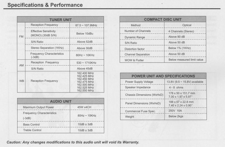

For those interested in specifications, see below for what was in the manual with the radio. From what I have been told, don't buy a radio on specs alone since they may not accurately represent what a radio will do or sound like.

I was looking to find the sensitivity and the selectivity for these radios, but couldn't find the information. I thought I read somewhere that a low (dBf?) number for sensitivity is good while a high number for selectivity is good. Does that sound right?
