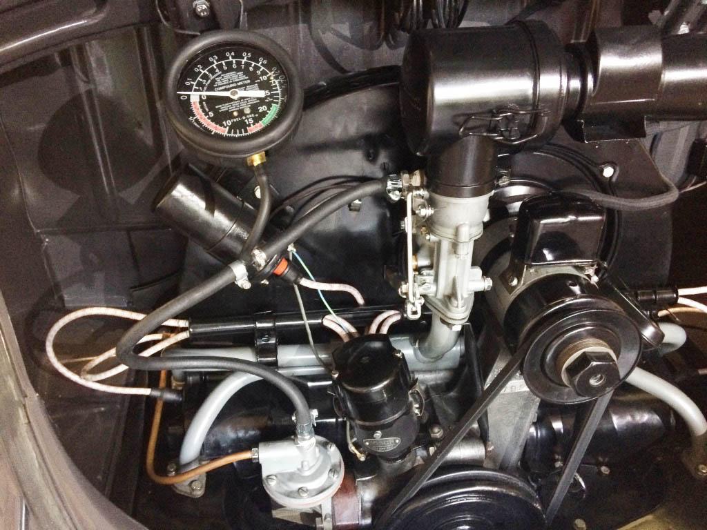

Yesterday I did a new try on my Split bug and its 26 VFIS.
Only after applying starter spray the engine fired up. But only kept running for 3 seconds. This typically means there was a remaining amount of gaz in the floating bowl which now has been left the carb to the combustion chamber ... but no more gaz is available keeping the bowl fill up, even with a full tank and trying switching the fuel tab from open to reserve. So ... although my pressure measuring testing gave me a correct pressure of about 0,1 Bar from the pump ... it still could be too low. Maybe the testing setup's manometer is flawed and gives unprecise results ... who knows.
EDIT:
This week I will go on with an extended diagnosis:
    - disassembling the fuel pump again and check the two little backflow preventing spring valves and bakelite plates of the pumps cover if all has been mounted really really correctly, cause if not this could result in a significant backflow of the fuel level in the fuel pipe trough the pump when the engine is switched off.
    - after this rechecking the fuel pressure and trying to rise the pressure a bit from 0,1 to approx 0,12 - 0,13 Bar by pulling a bit the diaphragms spring or using minimal thinner flange seals
    - rechecking both fuel filters in the tanks fuel tab and the tab itself
    - maybe tighten all nuts of the fuel pipe connections from pump and carb using more torque so no "air" could slowly enter the pipe system which also here would result in a back flow of fuel from the pump to the chassis and tank. So whats the correct torque for fastening the fuel pipe nuts?

PostPosted: Tue Nov 22, 2016 1:09 am    Post subject: Re: Why is carb float bowl empty after sitting? Reply with quote
Problem solved.
Quoting my assumption:
Because ... even if there would be such an evaporation which would result in no more remaining fuel in the carbs float bowl after some days, ... a starting procedure of about 5 Seconds should make the fuel pump directly fill up the carbs floating bowl so the gasoline "level" in the carb would be correctly high enough also in the emulsion tube housing for making the negative air pressure resulting the vaporized gas going down the suction pipe of the carb to the combustion chamber ... and ... the engine starts.
So ... in my case I thought "why won't the floating bowl fill up correctly when using the starter".
After a deep re-diagnose I figured out that it was the low pressure of the fuel pump "when starting". I checked the pressure many times before when "the engine was running" between 850 and 3000 rpm and the pressure was about 1.5 psi, means totally correct. So ... with the less amount of rpm the starter produces it showed that the pump wasn't able to deliver enough of fuel to the (maybe empty) carb.
So I removed the pumps cover, preloaded the diaphragm again (as I did a few weeks before) and ... used again new little bakelite plates for the little two valves within the fuel pump cover. The little springs where ok.
After reassembling the fuel pump again a pressure test showed suddenly 5-6 psi.
So I used new flange seals to lower the pressure till 2,5-2,7 psi where archived.
It's a bit above the factory recommendation but float needle valves and fuel line connections in general should stand a pressure up to 2,9 psi without problems.
With that setup and "a few days later" cold sitting, I was able to fire up the engine with just 3-4 turns of the starter. A test drive on the highway showed that all connections of fuel pipes at pump and carb where leakproof and no fuel overflow within the carb occurred.
So in my case ...
a) as the little valves in the fuel pump cover seemed not to be 100% closed at default, I assume that after a few days the fuel won't be kept in the pipe but moves down from the pipe through the pump to maybe the pipe area of the chassis
b) the pump delivered enough pressure when running at 850-3000 rpm but not when starting, that's why the fuel did not rise up fast enough to the carb – maybe cause of a)
Now with this working setup I did an even tougher check and closed the fuel tab while the engine was idling till it stopped so all fuel devices, lines and pipes in the chassis and engine compartment where free from fuel. I waited 2 days, opened the fuel tab and tried to start the engine. Now, even with "no fuel in the lines from the tank" and after these days cold sitting, it took the fuel only about 8 seconds when starting to reach the carb and make the engine firing up.

Do you have a hard line between the pump and the carb? I do and I'm wondering how to setup the pressure gauge inline. Any description or pictures would be appreciated
Thanks

PostPosted: Wed Nov 23, 2016 9:51 pm    Post subject: Re: Why is carb float bowl empty after sitting? Reply with quote
I have done this by using some spare junk parts I had around to have metal fittings for each end but rubber lines with a gauge in the center.
Cut original parts

On a 36hp engine it would be the same setup.
Best would be also installing an open/close valve between the t-piece (below the gauge) and the carb which simulates a closed float needle valve.
This setup was built using the following tools:
http://www.ebay.com/itm/Petrol-and-diesel-fuel-pum...1438339963
http://www.ebay.com/itm/Fuel-Pump-Vacuum-Tester-Ga...0680598717
The first one I bought a time ago to check my K-Jetronic on my 911 SC, so I also purchased the gauge of the second link as it comes with the psi range that is needed for measuring a VW mechanical pump pressure.
