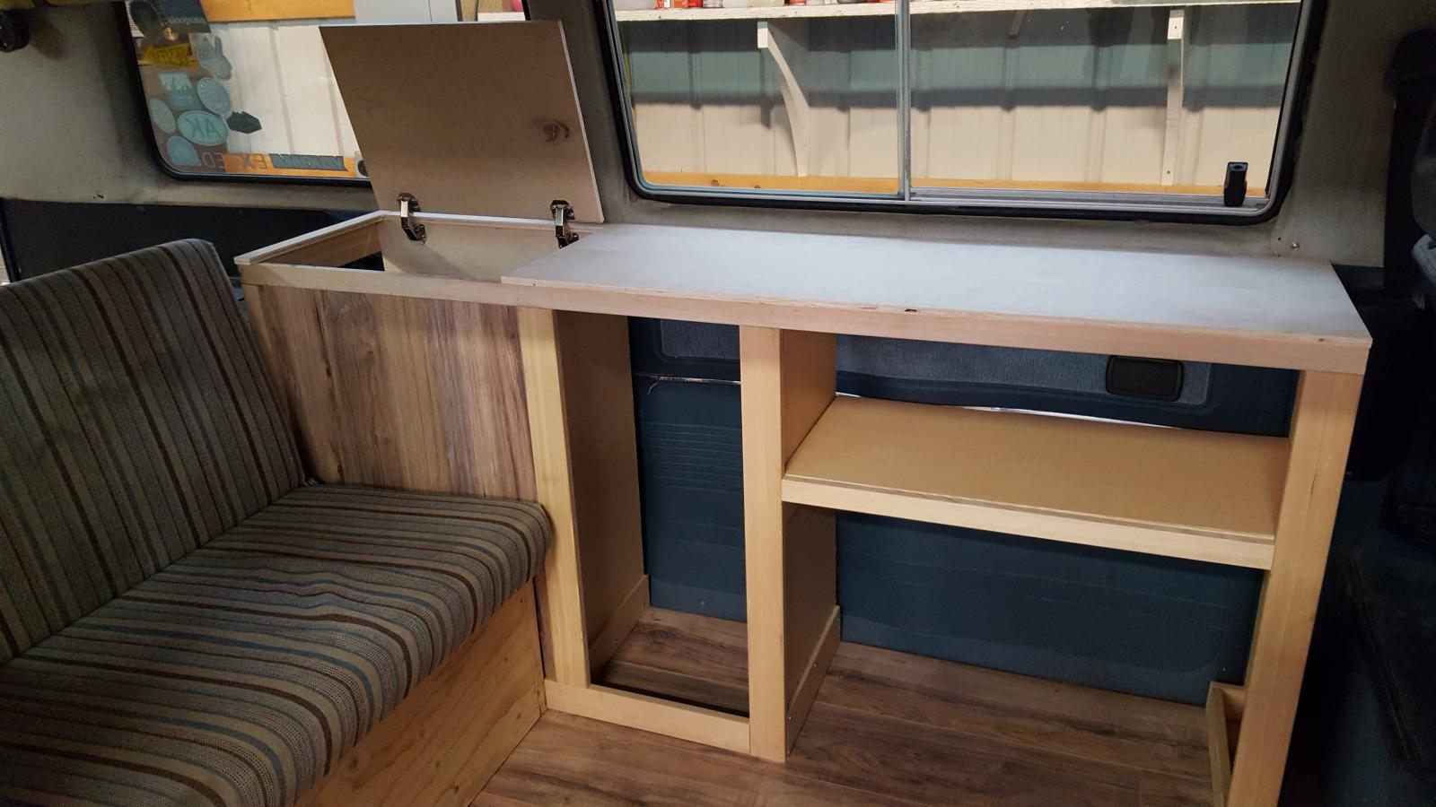

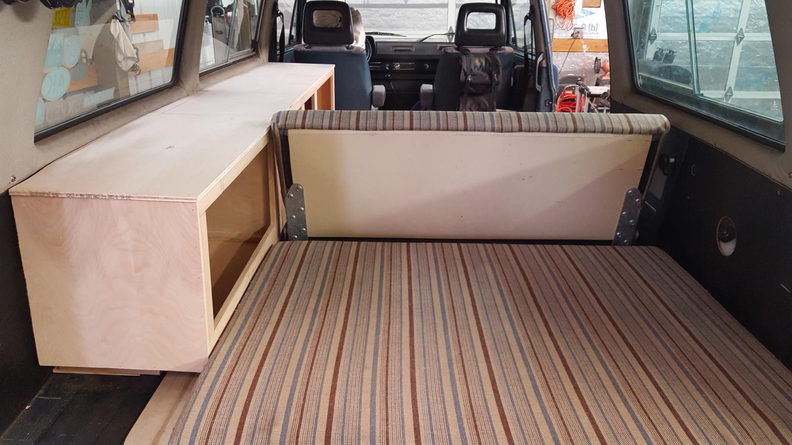

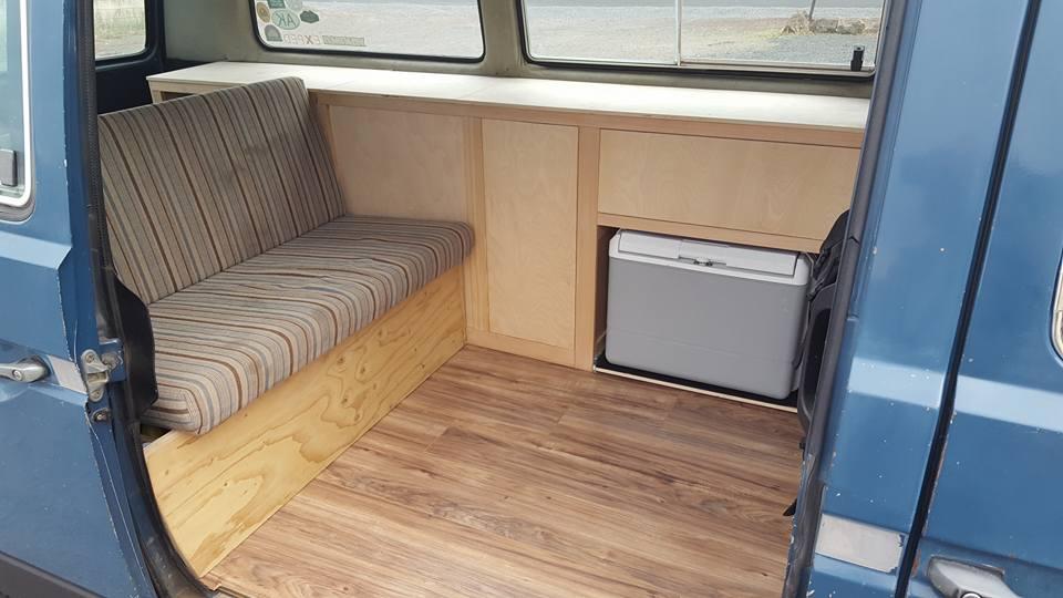

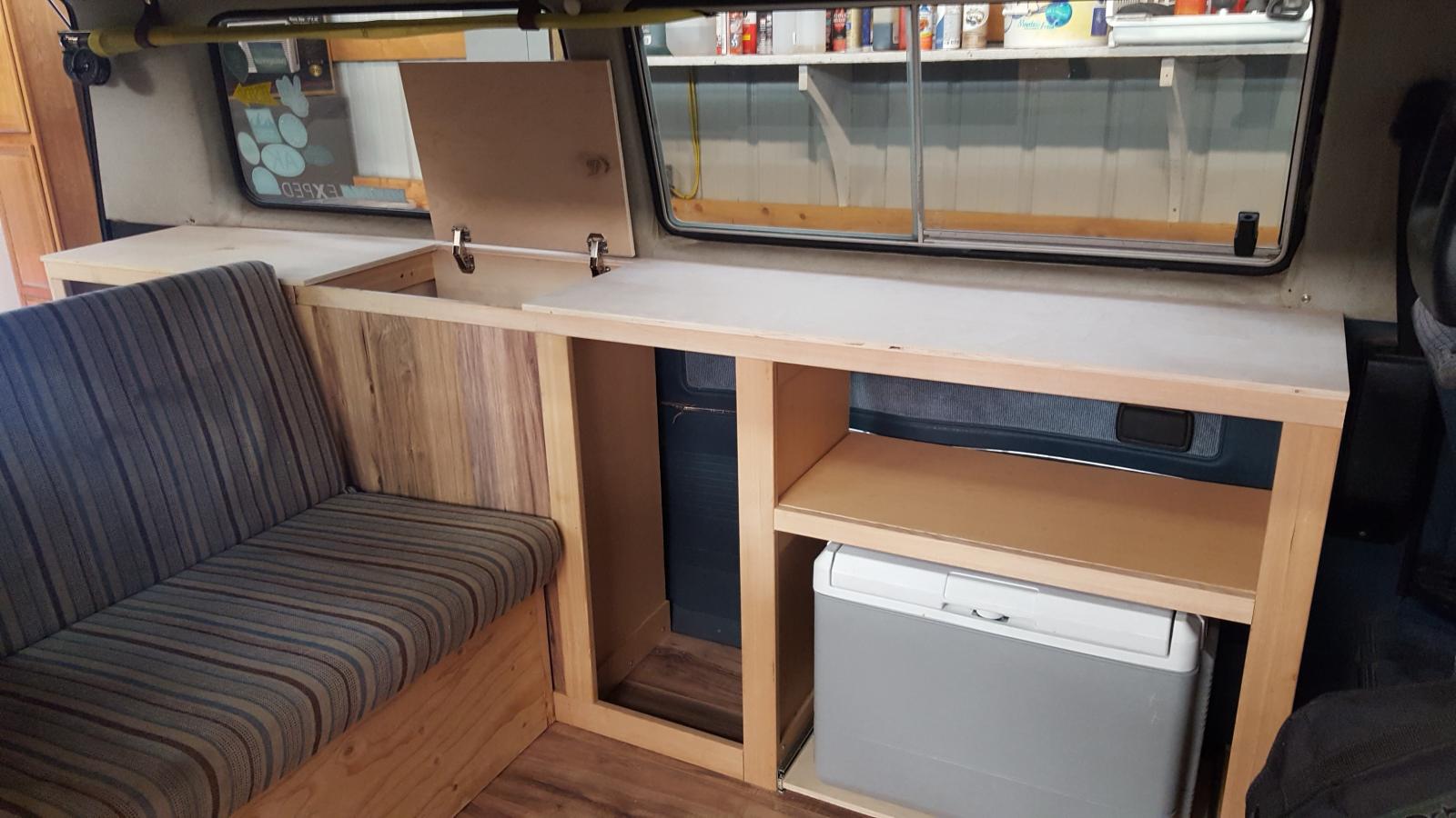

Thought I would post a few pics of my current cabinet project for my tin top. Last time I made cabinets for a van I incorporated a bunch of aspects I never actually utilized when living in it, so this time I am starting simple, then will add things as needed. I have since swapped out the middle panel, beside the seat, with another sheet of birch, replacing the flooring. This is a deep top load section, intended for my hiking backpacks.

Steve M. Samba Member
Joined: July 30, 2013 Posts: 5171 Location: Fort Lauderdale, Fl.
Posted: Wed Nov 23, 2016 11:08 pm Post subject: Re: Building new cabinets |
Looks good. I should be getting my replacement kitchen cabinets come Monday so I'll be starting on mine soon. I'll be making the bed a bit narrower as I want a coat closet on the passenger side.
Nothing too wide, just a space to hang a winter coat or two, store a tripod without having to climb back in to get them on the other side of the interior.
My 68 Westy had that setup and really made use of it. It's great for hanging a wet jacket before getting it into the inside where it gets everything else wet too. _________________ This free advice is worth exactly what you paid for it.

metropoj Samba Member
Joined: April 23, 2004 Posts: 1302
Posted: Thu Nov 24, 2016 10:55 am Post subject: Re: Building new cabinets |

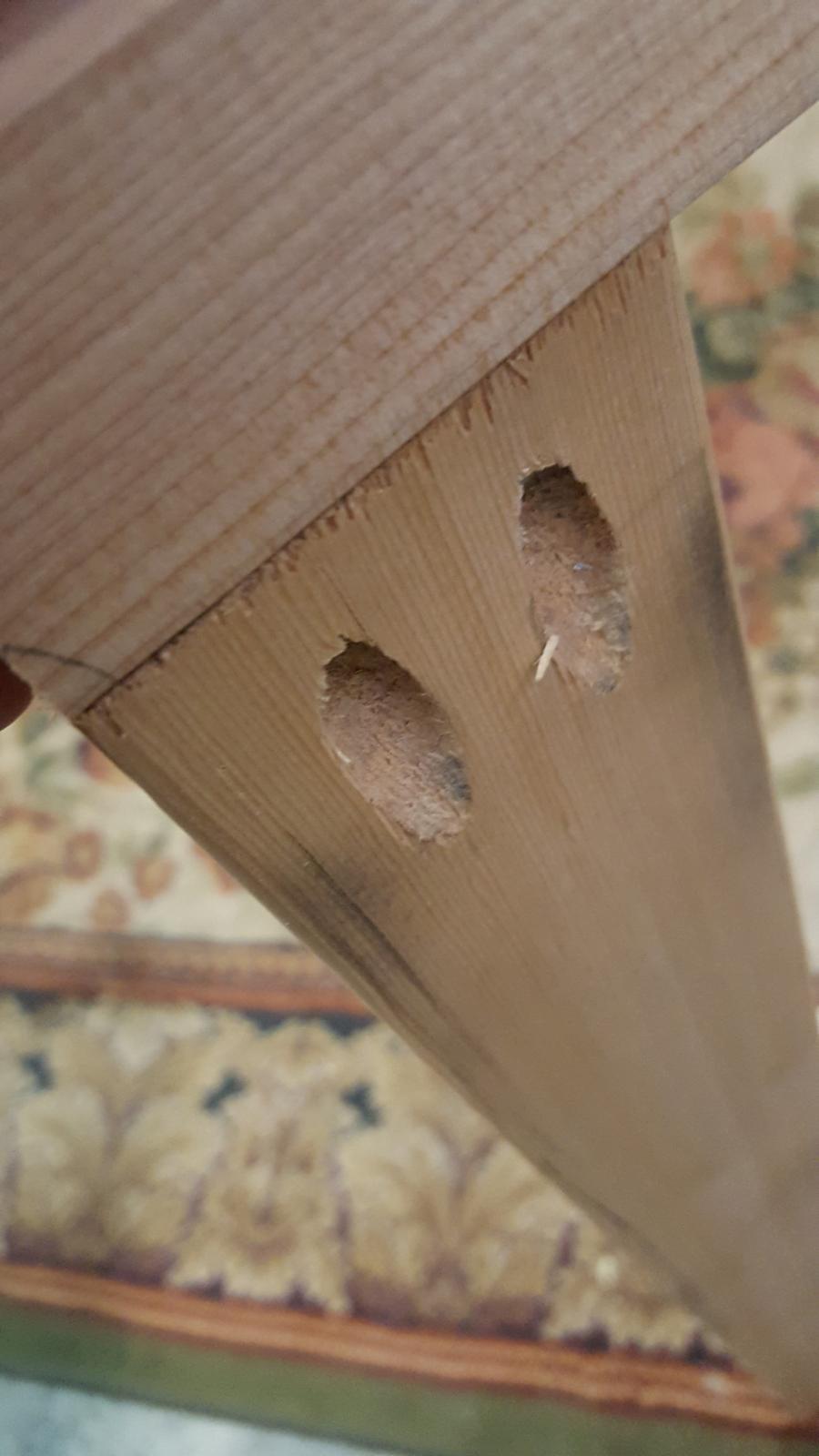

I'm really horrible in sighting woods. Is the whole frame etc out of birch ? To my untrained eye, the frame looked like cedar ...
Now the end cabinet doesn't go all the way to the rear of the van. Is this for any future particular reason or issues with removing the engine hatch or ?
Thanks. I like what you are doing here .... _________________ John.

Posted: Thu Nov 24, 2016 3:56 pm Post subject: Re: Building new cabinets |
Thank you all. Yes, River (my dog) is less than impressed with the build.
metropoj wrote: |
Thanks. I like what you are doing here .... |
The frame is clear hemlock, and the cabinet doors and top are birch plywood.
I had a van back in 2011 that i built cabinets for, and it had a closet, but it didn't go all the way to the back either. In the end, I found that having that nook was really helpful. Nice place to toss shoes, dirty clothes bag, or to stand things up that are too tall to fit in the cabinet. The nook is a little less than 1'x1'. |

tates1882 Samba Member
Joined: August 07, 2012 Posts: 254 Location: Southeast Idaho
Posted: Thu Nov 24, 2016 6:28 pm Post subject: Re: Building new cabinets |
outstanding work!!! I think the dog just super happy to be chilling with you. Nothing better the hanging with the human!!! _________________ 88 Vanaru, ej22, naht |

DAV!D Samba Member
Joined: September 10, 2013 Posts: 978 Location: EL CAMINO
Posted: Fri Nov 25, 2016 8:52 pm Post subject: Re: Building new cabinets |
Looks like a nice start. This set up is pretty similar to what I did.
I'm going to soon be rebuilding my entire set up after 1.5 years of use. My biggest complaint with my set up is not being able to open the one cabinet door while in bed position.
Depending what you keep in yours you might find the same issue. I'd also say having the recessed sections on the tops of my cabinets was very handy for extra storage of smaller items. _________________ 86 Syncro Build - Ecotec Motor Swap - Pop Top Conversion - Camper Build & Syncro Conversion |

Atadloco Samba Member
Joined: July 13, 2012 Posts: 223 Location: New Hampshire
Posted: Sat Nov 26, 2016 7:48 am Post subject: Re: Building new cabinets |
Looks great. Have you decided what you're going to do with a closet for the back? Or just leave it open. I'm still undecided if I want a full closet or just build out a window height one.

VanagonPDX Samba Member
Joined: April 25, 2012 Posts: 101 Location: Portland Oregon
Posted: Sat Nov 26, 2016 6:58 pm Post subject: Re: Building new cabinets |
DAV!D wrote: |
Depending what you keep in yours you might find the same issue. I'd also say having the recessed sections on the tops of my cabinets was very handy for extra storage of smaller items. |
As I was planning my setup I came across a couple similar setups, yours included, that helped shape my final plan. The one door next to the bed will not not be able to be opened when the bed is down, but I think that will be fine (famous last words). I will just have to be sure to pack accordingly. I am going to do the bypass cabinet doors in the back cabinet. The one to the front folds down, and will have a support strap to make it a small additional work space in the "kitchen". |
Posted: Sat Nov 26, 2016 7:01 pm Post subject: Re: Building new cabinets |
Atadloco wrote: |
Looks great. Have you decided what you're going to do with a closet for the back? Or just leave it open. I'm still undecided if I want a full closet or just build out a window height one. |
Currently I don't think I will have a "closet". I like the single level all the way back. That being said, if I run out of storage room, I will build another cabinet that sits on top back there. Still no hanging room, but would give more space for stuff.

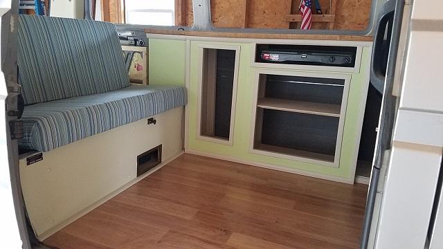

Posted: Sat Nov 26, 2016 7:07 pm Post subject: Re: Building new cabinets |

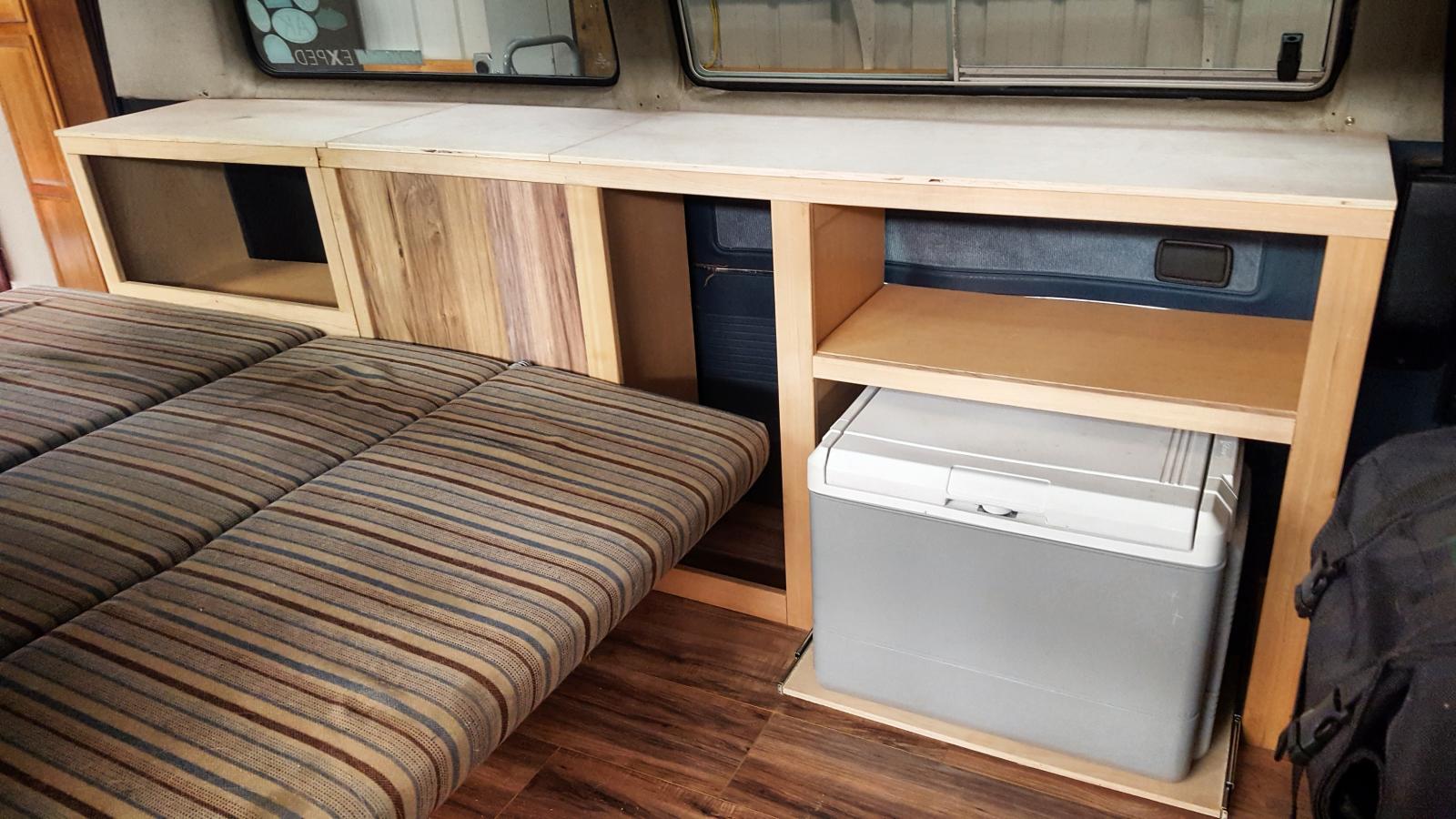

Replaced the flooring panel with another piece of birch. This panel, unlike the doors, is set back 1/2" from the face. The thought is that I will mount a 110 outlet, solar charger, and a USB port on that panel next to the chair. Having it set back from flush should keep me from having any issues with the bed going up and down.
Posted: Sun Nov 27, 2016 11:25 pm Post subject: Re: Building new cabinets |

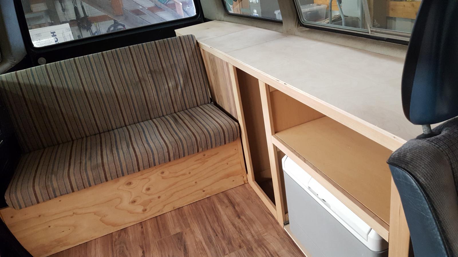

Someone asked how things open up, so thought I would share that photo here too.
Back to top |
pbrown Samba Member
Joined: July 15, 2008 Posts: 361 Location: Seattle, WA
Posted: Mon Nov 28, 2016 2:21 pm Post subject: Re: Building new cabinets |
VanagonPDX wrote: |
Will the low door close to the bench seat open when in bed configuration? It doesn't look like it will. Consider splitting that door and adding two hinges so that the upper part of the door can swing open over the seat cushion.
That looks really good BTW. _________________ Patrick Brown
1986 Westy Syncro EJ25
Flickr --> https://flic.kr/s/aHsmQNUXEF |

SCM Samba Member
Joined: January 26, 2011 Posts: 2517 Location: Bozeman MT
Posted: Mon Nov 28, 2016 3:31 pm Post subject: Re: Building new cabinets |
VanagonPDX wrote: |
Replaced the flooring panel with another piece of birch. |
I think that looks a lot nicer too. Too many different patterns and textures etc. end up looking cluttered sometimes. _________________ '91 Westfalia GL Automatic (GTA "Turbo" Rebuild w/Peloquin) and 2.3L GoWesty Engine |
Posted: Mon Nov 28, 2016 8:32 pm Post subject: Re: Building new cabinets |
SCM wrote: |
I think that looks a lot nicer too. Too many different patterns and textures etc. end up looking cluttered sometimes. |
Definitely agree that it looks cleaner with the same type all the way down. Need to get a thin sheet to face the panel under the seat now too. |
