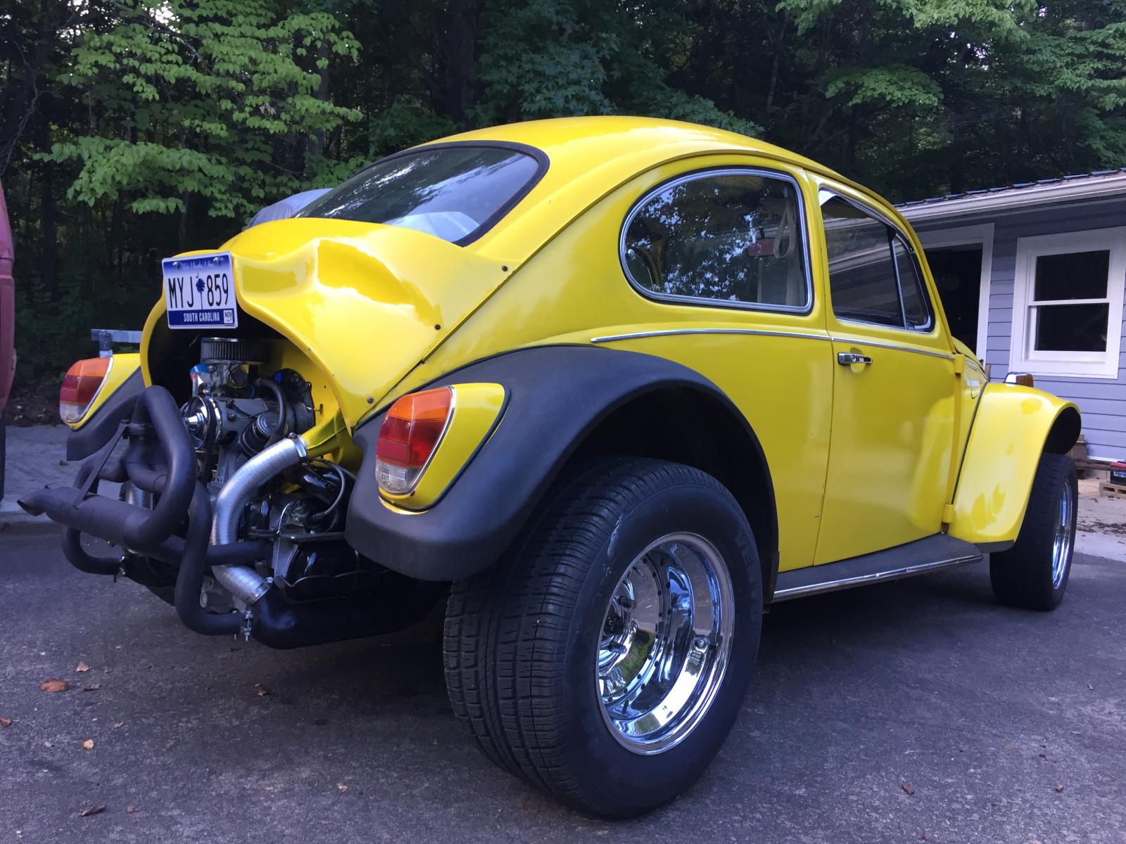

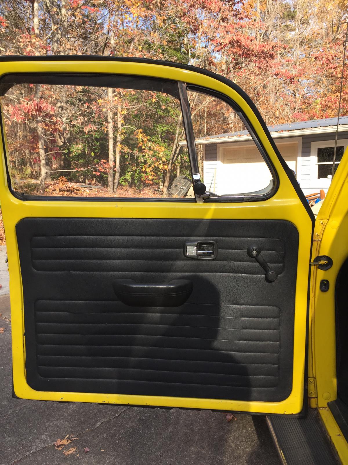

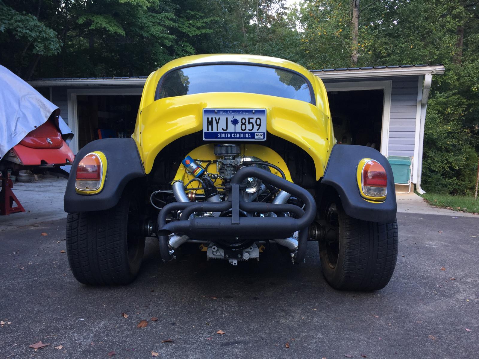

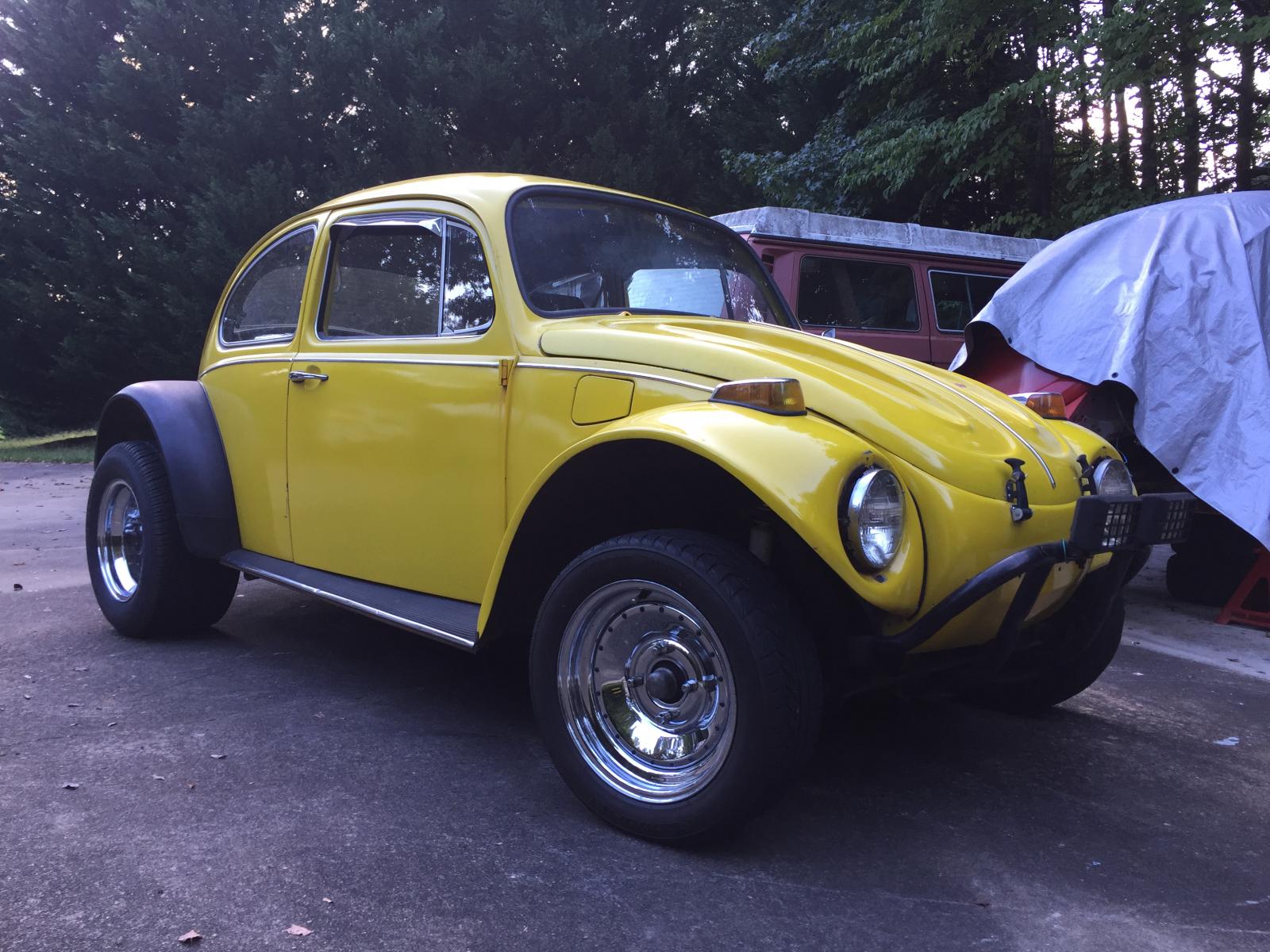

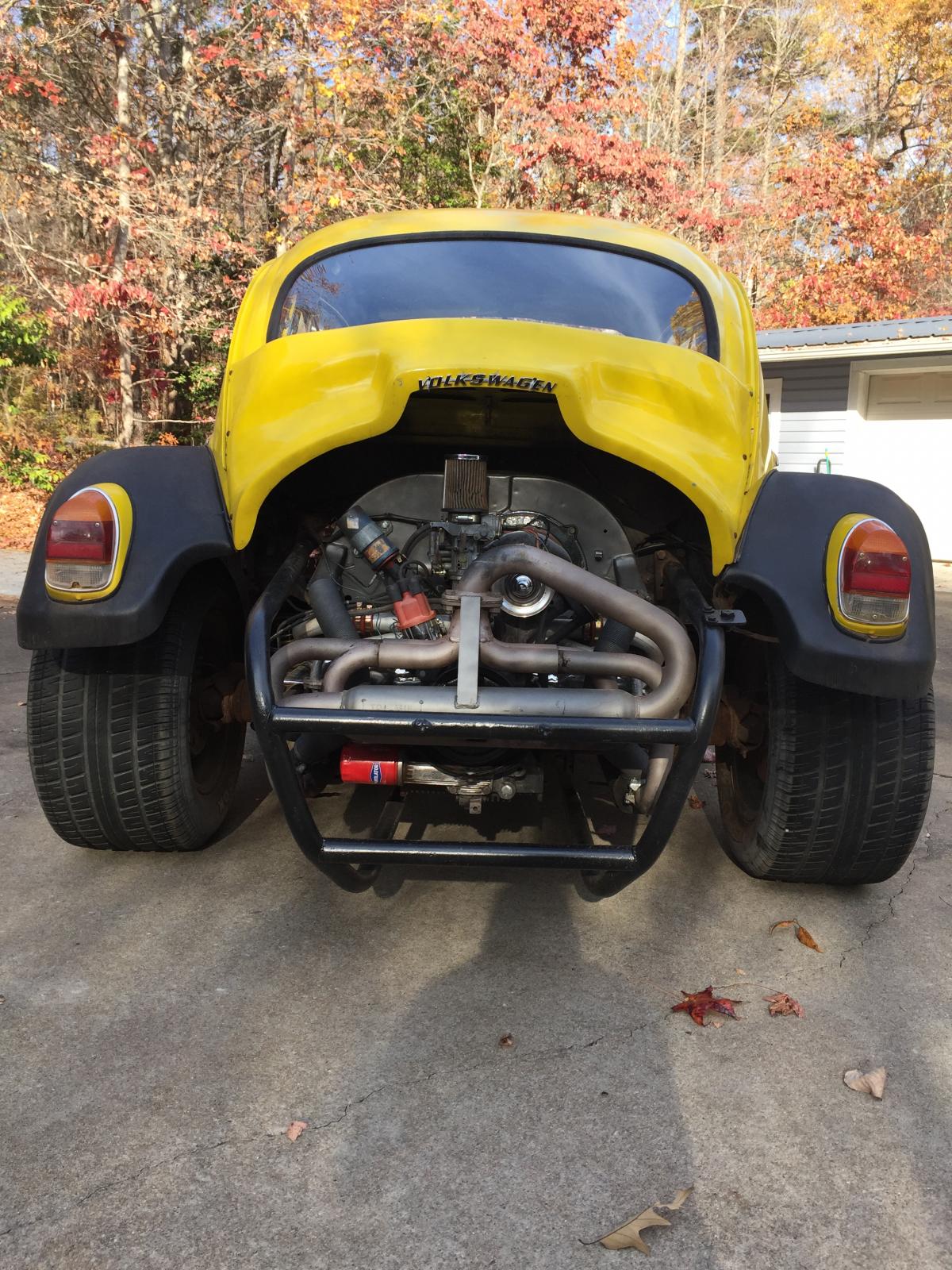

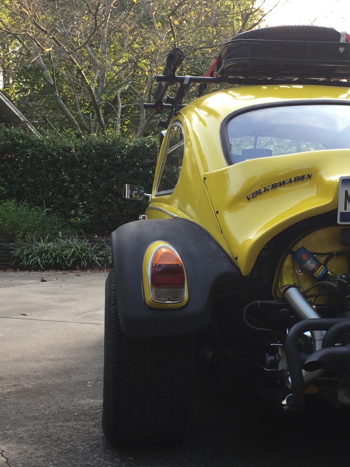

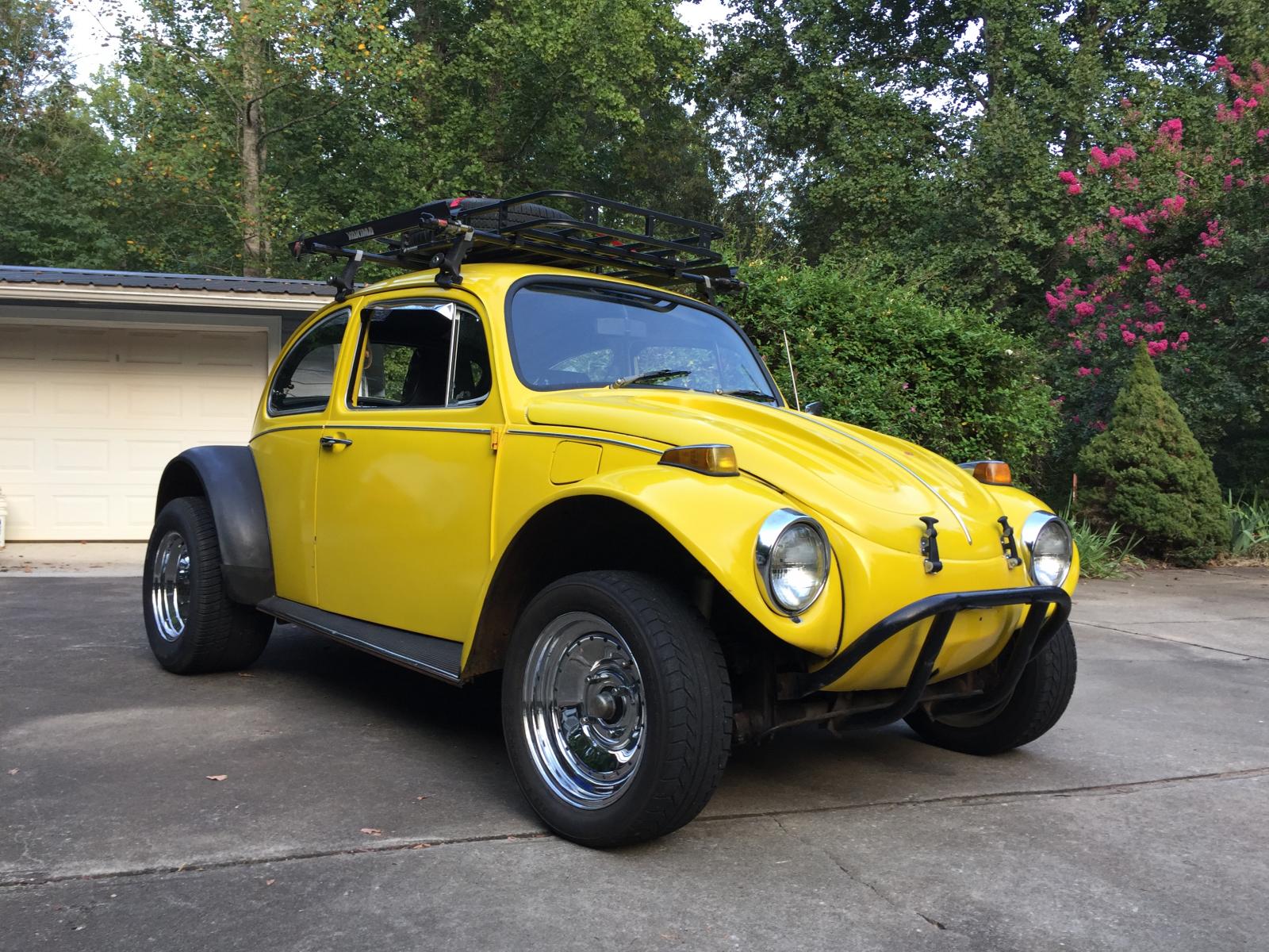

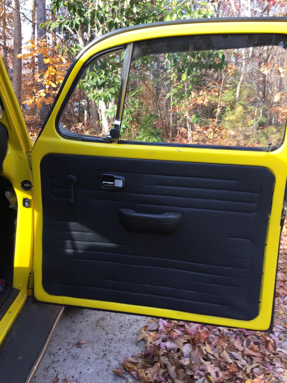

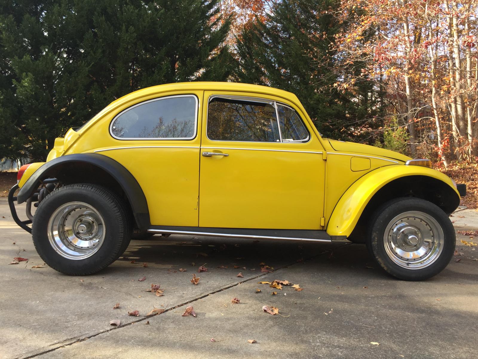

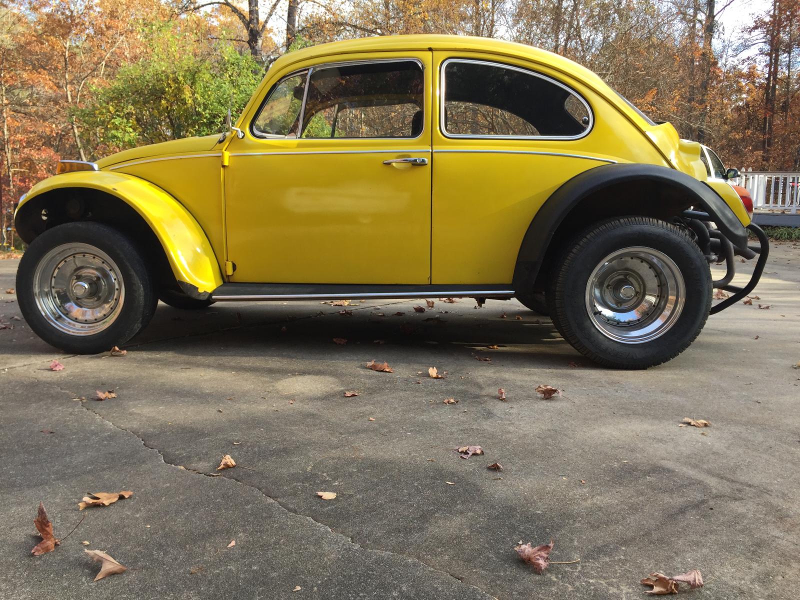

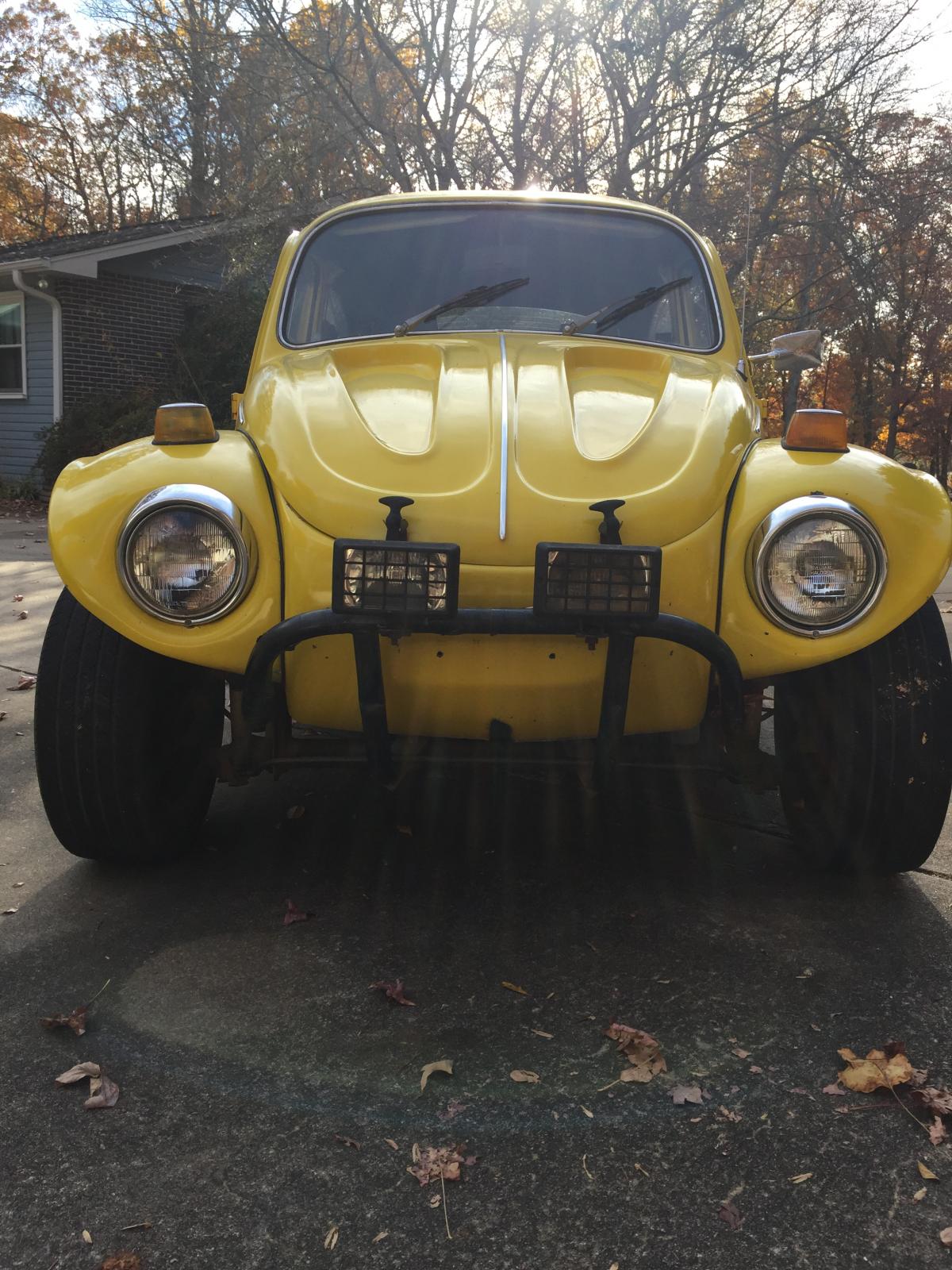

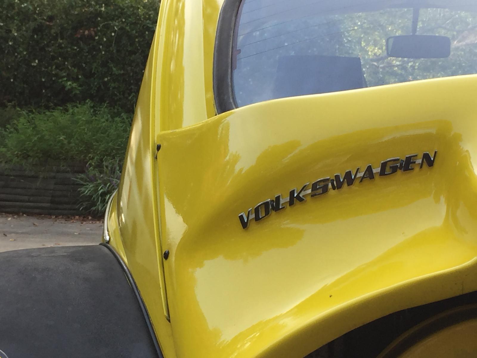

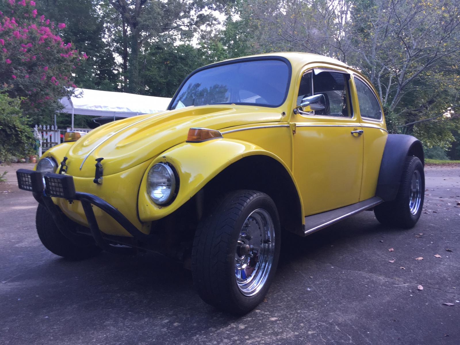

so I just posted up my wife's 1970 Classic Beetle , now it's time to post up some photos of my new rig.
As I was looking for a classic Beetle for my wife, I realized that one of the vehicles I always wanted was a Baja Bug. I've had my dream Jeep ('97 Wrangler - built for crawlin!), and I've done the convertible sports car (1979 Fiat Spyder and 1999 Mazda Miata). I lived Motorcycles for a number of years, it was time to get my bug on!
I found this Baja bug not far from home and it turned out to be a pretty solid rig. The plan is to enjoy driving it and working on it as I learn about Beetles.
I've hardly even driven the bug as yet, working through an injury to my clutch foot. Not sure what the rig really needs, the engine is recently built (about 15 hours on it now, maybe 300 miles or so) and it is relatively solid in body. One for sure plan is to replace the front brakes with a disk conversion kit.
Just looking forward to getting out and driving it for now.

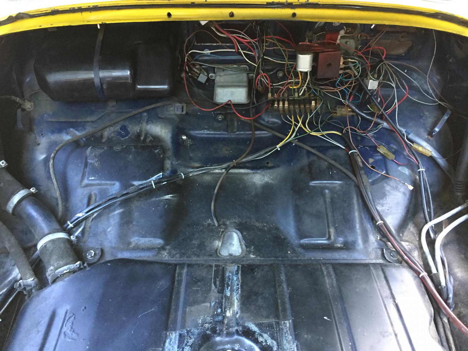

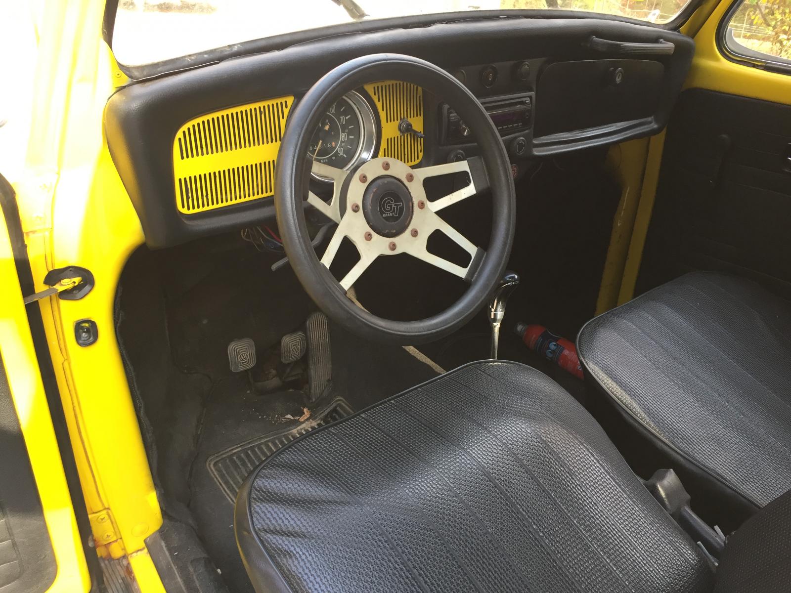

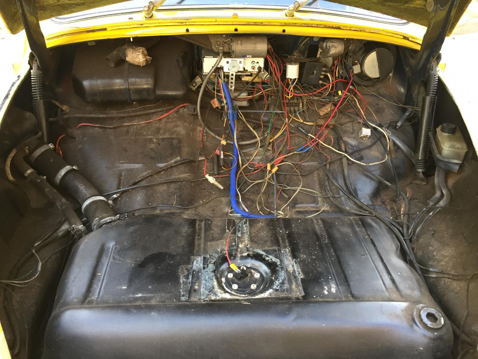

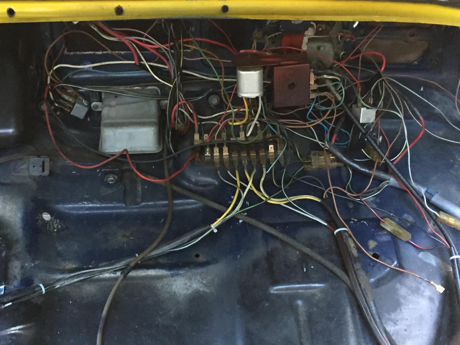

Have fun with the wiring, That looks like most every VW I have ever purchased and had to undo it. Laughing

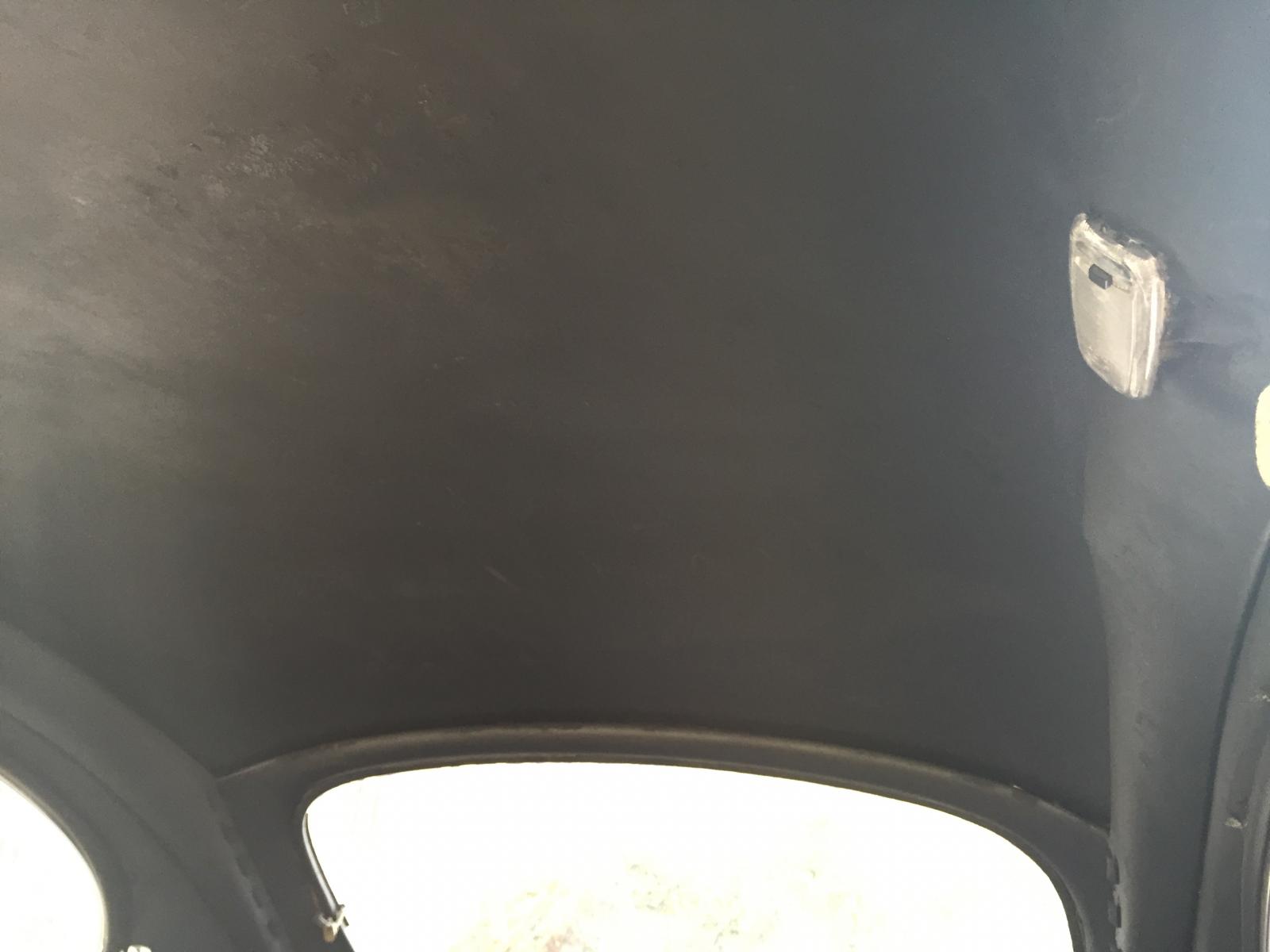

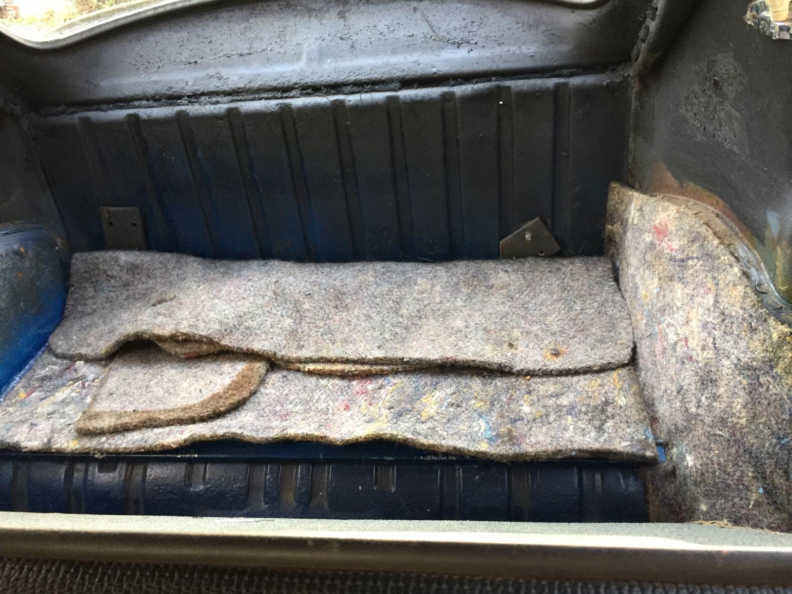

The car definitely needs some sound deadening and I've been reading various threads with different suggestions. Will make that happen soon.

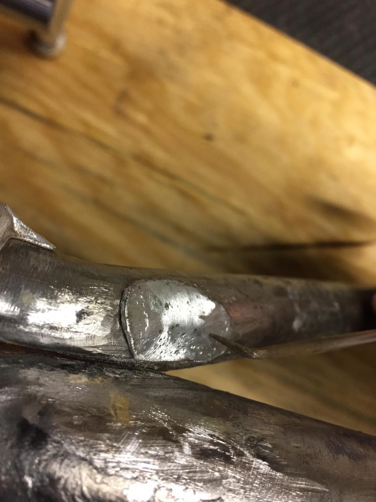

Yes, the rear bumper is not mounted well at all. I may just fab something completely new that does link into the main body rather than the way it is currently mounted. Either way it does need work.
Yes, this should provide hours of entertainment. Very Happy

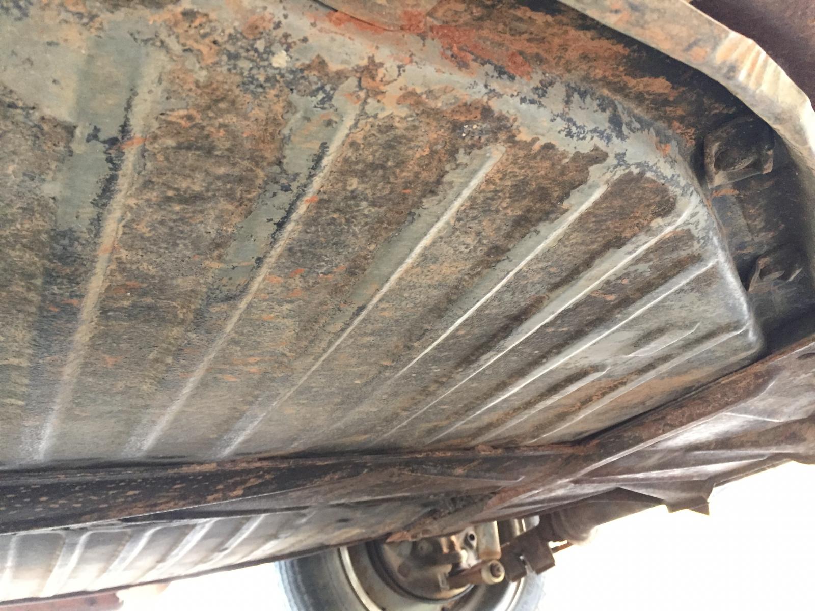

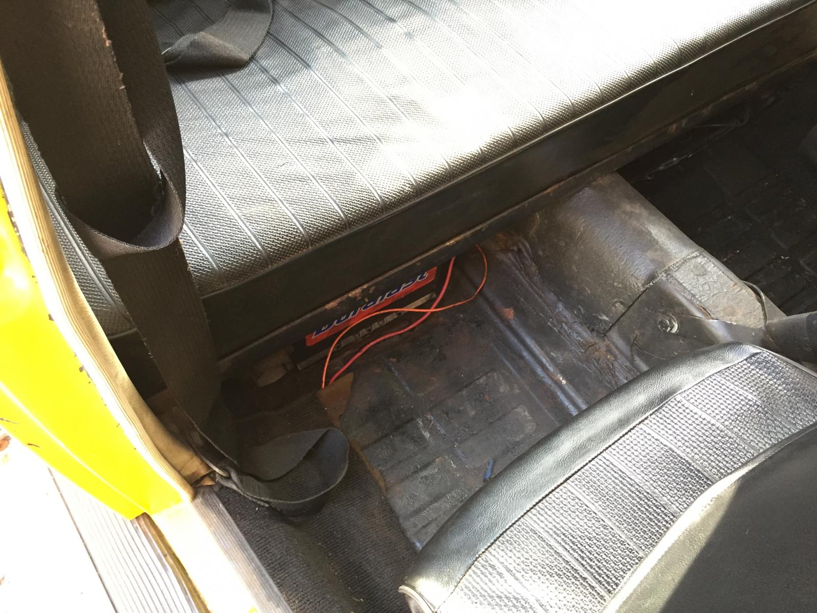

Think I have a bad feeling about all of that tape residue on the gas tank around the sender. Confused

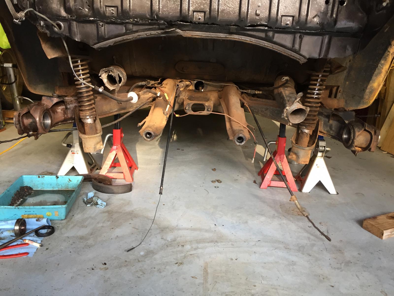

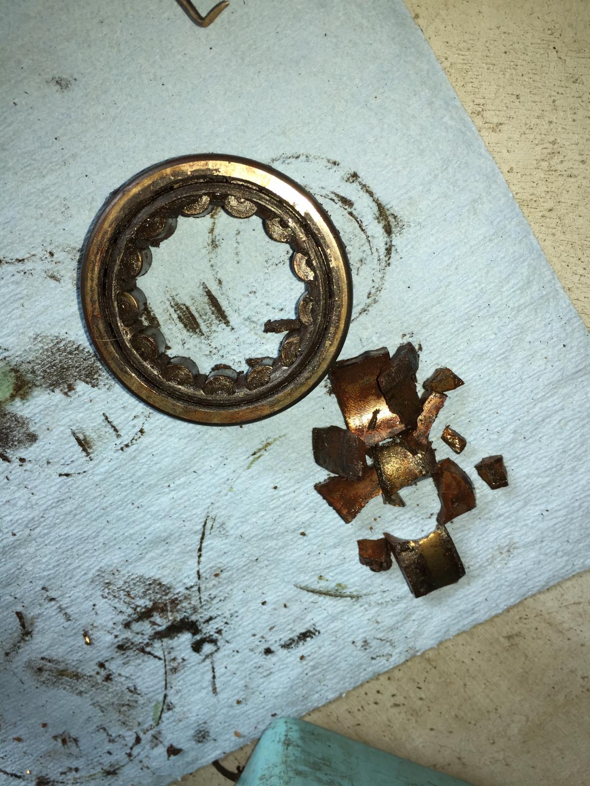

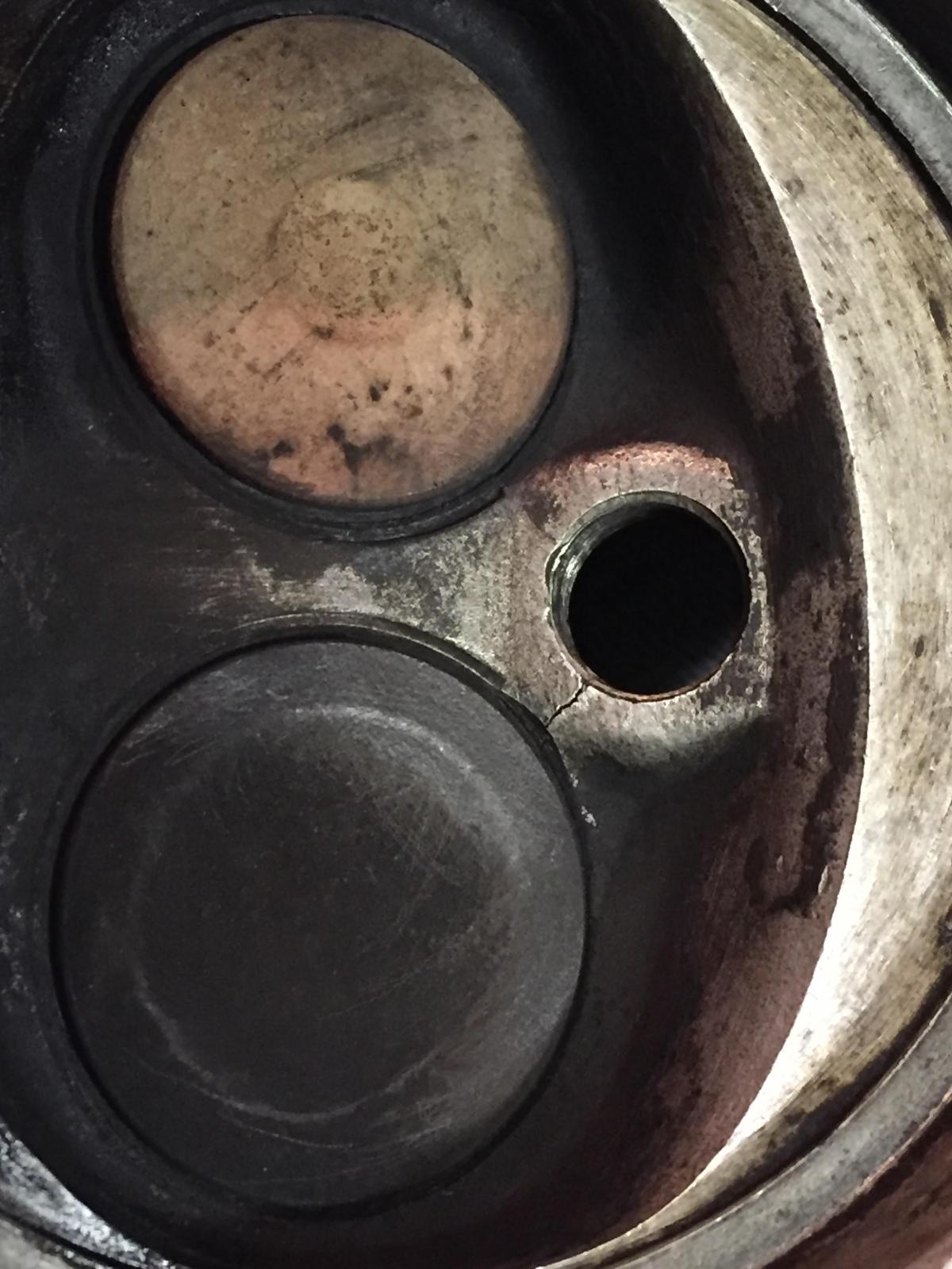

So things have been tough for me and my Baja. Tried to get it running well and had no success. After some frustration I decided to go back to the basics and did a compression check. Low compression on number 3 made me do a leak down and found a bad intake valve. I pulled the head and found the fatal crack
That made me decide to pull the other head and I found a similar result.
After some investigation of parts pricing I called a (relatively) local guy for a quote on a full engine rebuild. His price was good and with several recommendations and his 30+ years of experience I decided I'd just turn the engine over to him and let him do the rebuild.
While the engine was out I began to look at other systems on the rig. With perfect timing someone had posted up about their clearing of the heat risers on the intake manifold. I tried clearing the risers with a cable with no success. Finally I decided to follow others who had drilled a hole in the riser and used a very long drill bit to clear the carbon from it. That left me with a rather large hole in the riser and I needed to braze it closed. My first attempt at brazing it up was a dismal failure.
After additional investigation on this site I decided the appropriate method was to use silver solder and a patch and that resulted in much greater success.

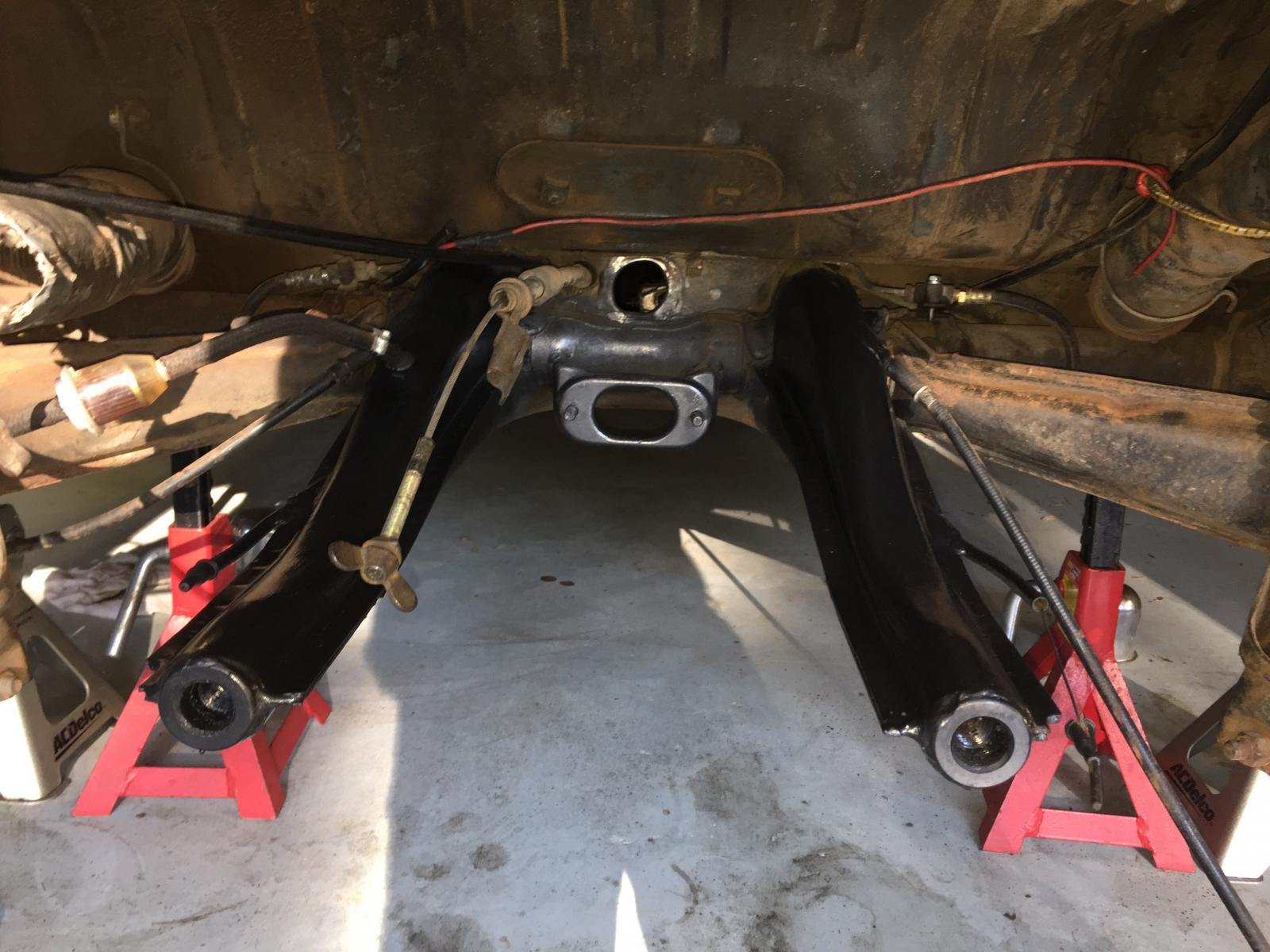

I also wanted to upgrade to front disks so that was launching me into a full brake rebuild. The front brakes were pretty straightforward thanks to having access to a hydraulic press at a friends shop. No photos of the front but I got started on the rear brakes during that time as well.
It was the rear brakes that really sent me deep into the back end of the car. Once the drums were removed i decided to pull the backing plates just to clean them up before I put completely new brakes and turned rotors. Of course to get the backing plates off I had to pull the bearing housing off. I had started on the passenger side and the outer bearing came right out after the backing plate was removed. It showed a bit of rust so I decided I have to go further and replace the bearings.
Of course nothing is easy and I stripped a couple of the bolts attaching the CV joint to the spindle. With some penetrating oil and a good set if vise grips I finally got them removed. The rest of that side (passenger side) was relatively straightforward.
I was surprised once I got to the driver side to find that the outer roller bearing's inner race fell apart in my hands.
The rear bearing work is still in progress, it seems I failed to order the proper O-ring and I need a new outer spacer on the driver side. Those parts are on order now and I hope to have them soon.
Since I had already ordered rear transmission mounts, in my last parts order I added a front transmission mount. With the engine out and the axles disconnected from the spindles I decided just to pull the transmission. At a minimum I would clean it up before I reinstalled it. Simple green is some pretty amazing stuff and the baked on grease and grime came off with only a bit of elbow grease.
I found that the trans vent was clogged and was able to clear that up as well as replace the gear oil in the trans. Very easy with the trans sitting on the jack stands.

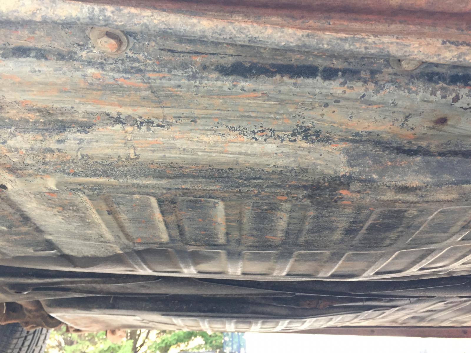

Of course while the back of the car was so exposed I thought it was a good idea to clean and paint whatever I could get to.
I have all of the rear bearings installed and the backing plates cleaned, painted and sitting in place with the e-brake cables installed. That's how she sits tonight.
I still want to remove and clean or replace those cool-over shocks. Cleaning and Painting the suspension parts will also help me feel good about the condition of those components. I have new bump stops and I have a bit of electrical work to clean up under there. thankfully I'm in the reassembly mode for the most part. Unless I find something else that needs replacing......

If I could make a suggestion, pull off those crappy EMPI spring assisted rear shocks, and through some stockers on there. Those things are so stiff, even in the softest setting, that they make the rear of the car so stiff and hard that it just bounces around on the road with every little dip and bump. Ask me how I know.... Laughing

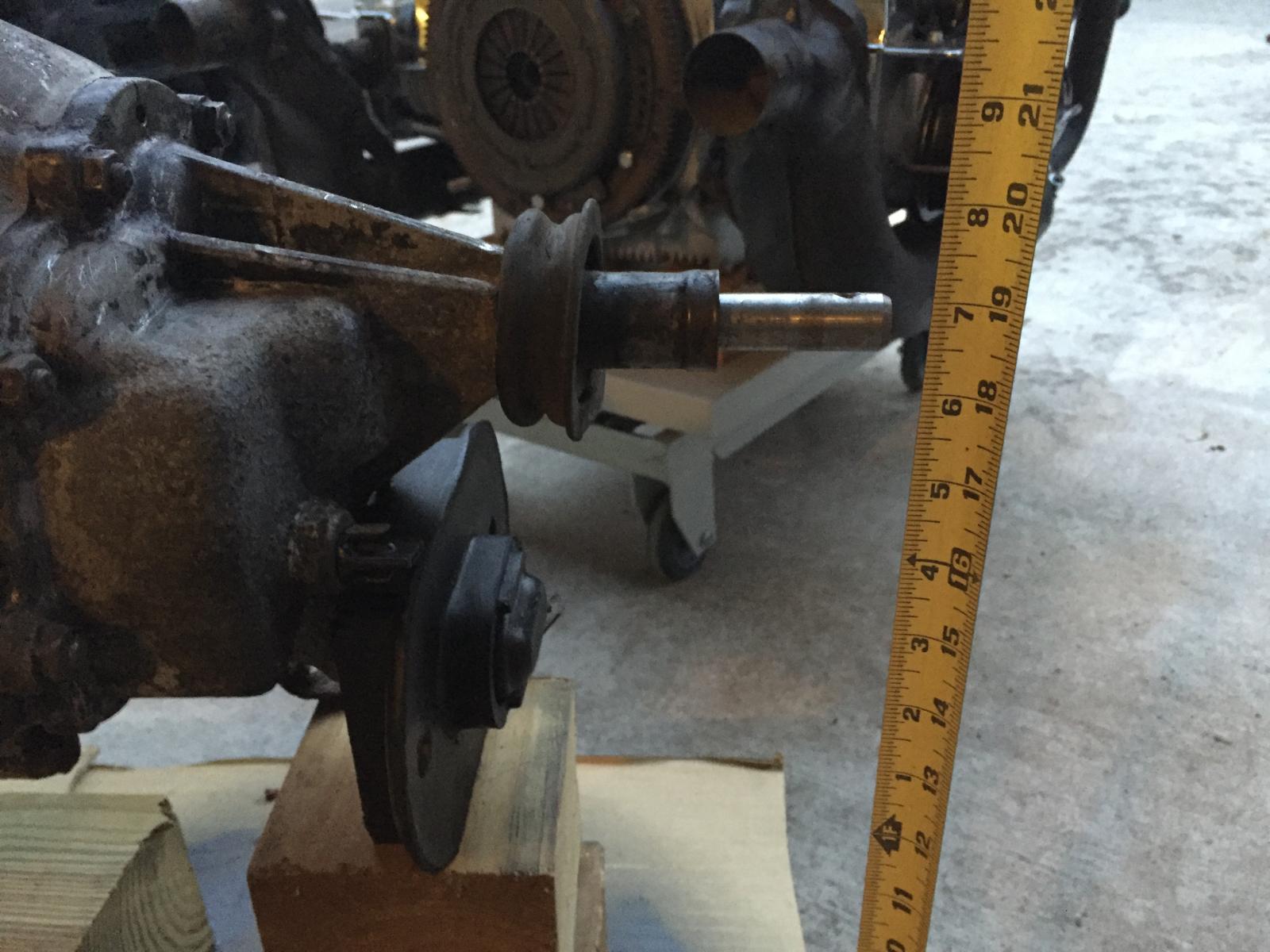

PostPosted: Mon Mar 20, 2017 6:11 pm    Post subject: Re: madworks 1970 Baja Reply with quote

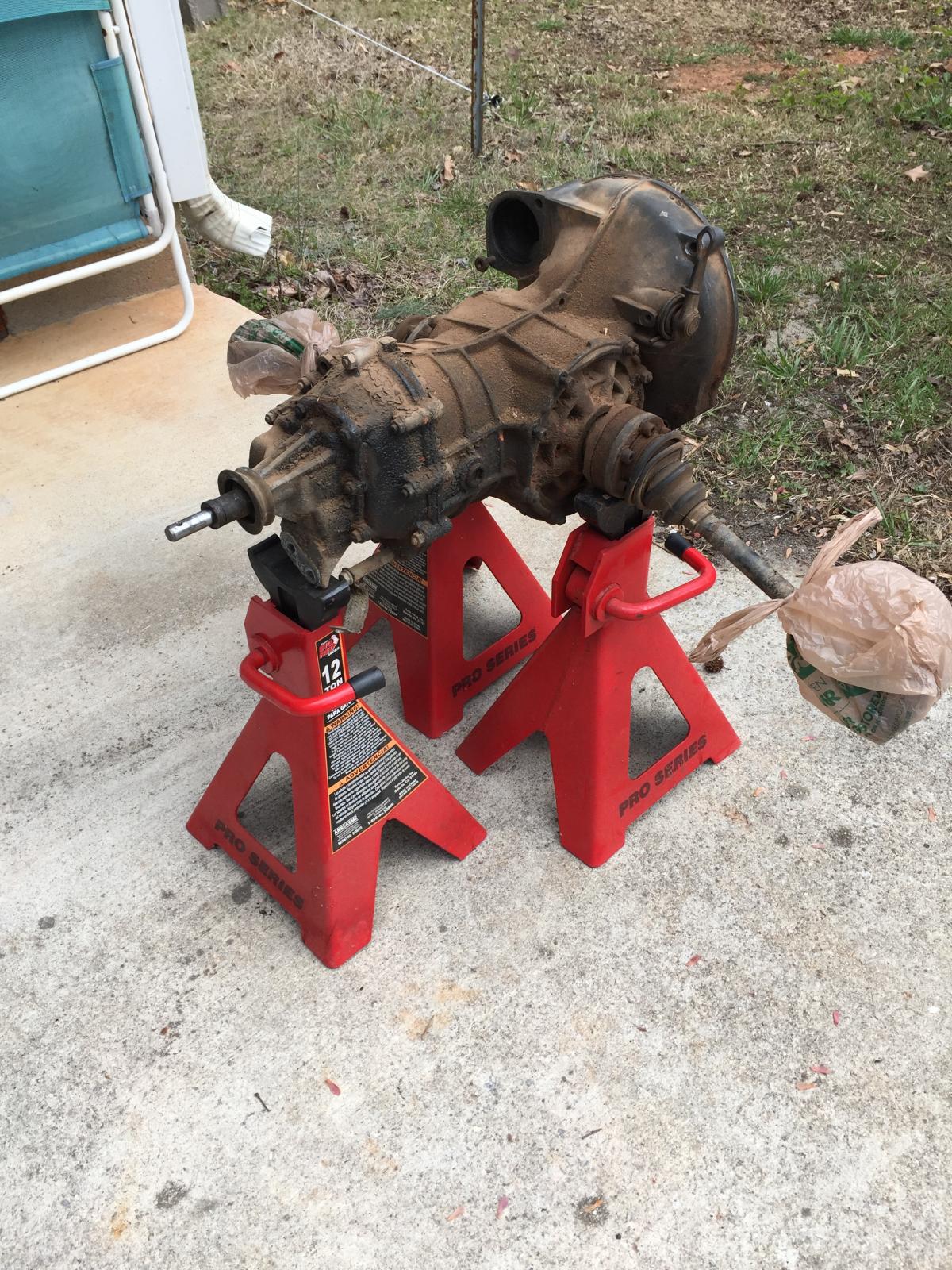

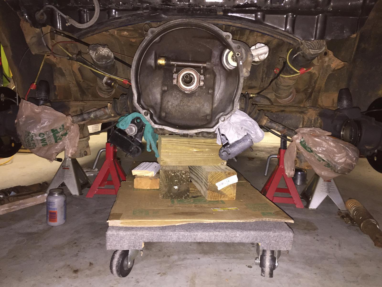

Tonight I installed the transmission. Used a piano dolly and some wood blocks to get it to the correct height
Then I rolled it right into place!
It still took some jockeying but I didn't have to support the weight at all. Overall it went very smooth.

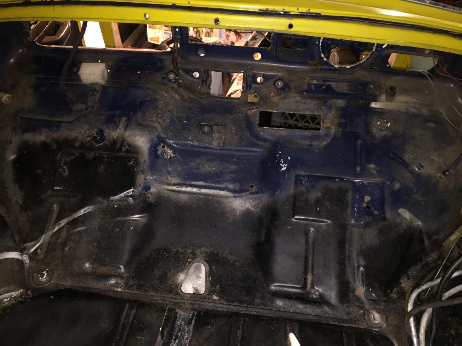

The saga continues. After the new front disk brake conversion, all new rear brakes and all new hoses, along with a new master cylinder and brake switches, she finally sits on her own feet.

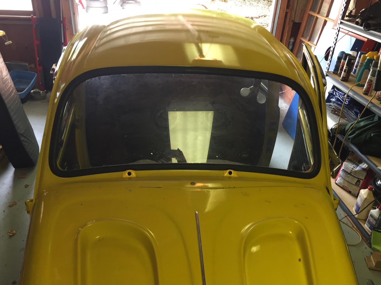

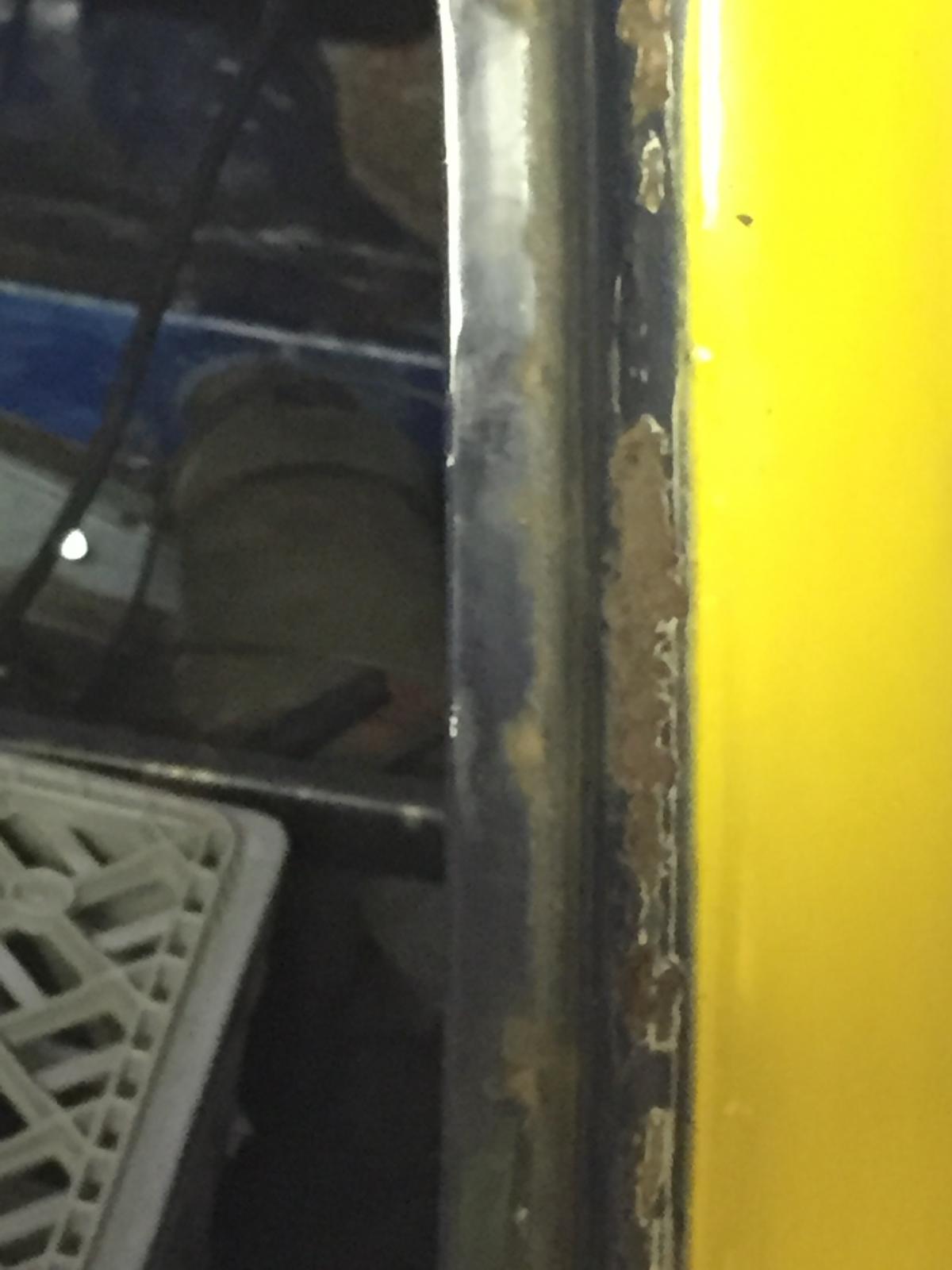

Before I could take her out, I needed to put a new windshield seal. When I pulled the windshield it made me realize how bad the dash really was. Once I pulled the dash I decided to pull the electrical system apart because it's a huge mess. This is how it looks tonight.
madwork's 1970 Baja http://www.thesamba.com/vw/forum/viewtopic.php?t=668092&highlight=

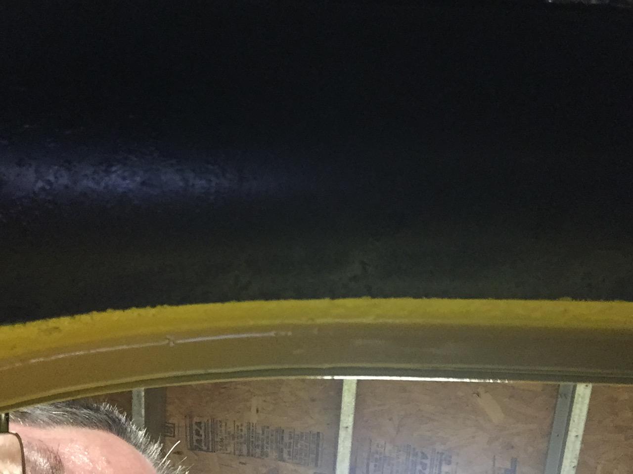

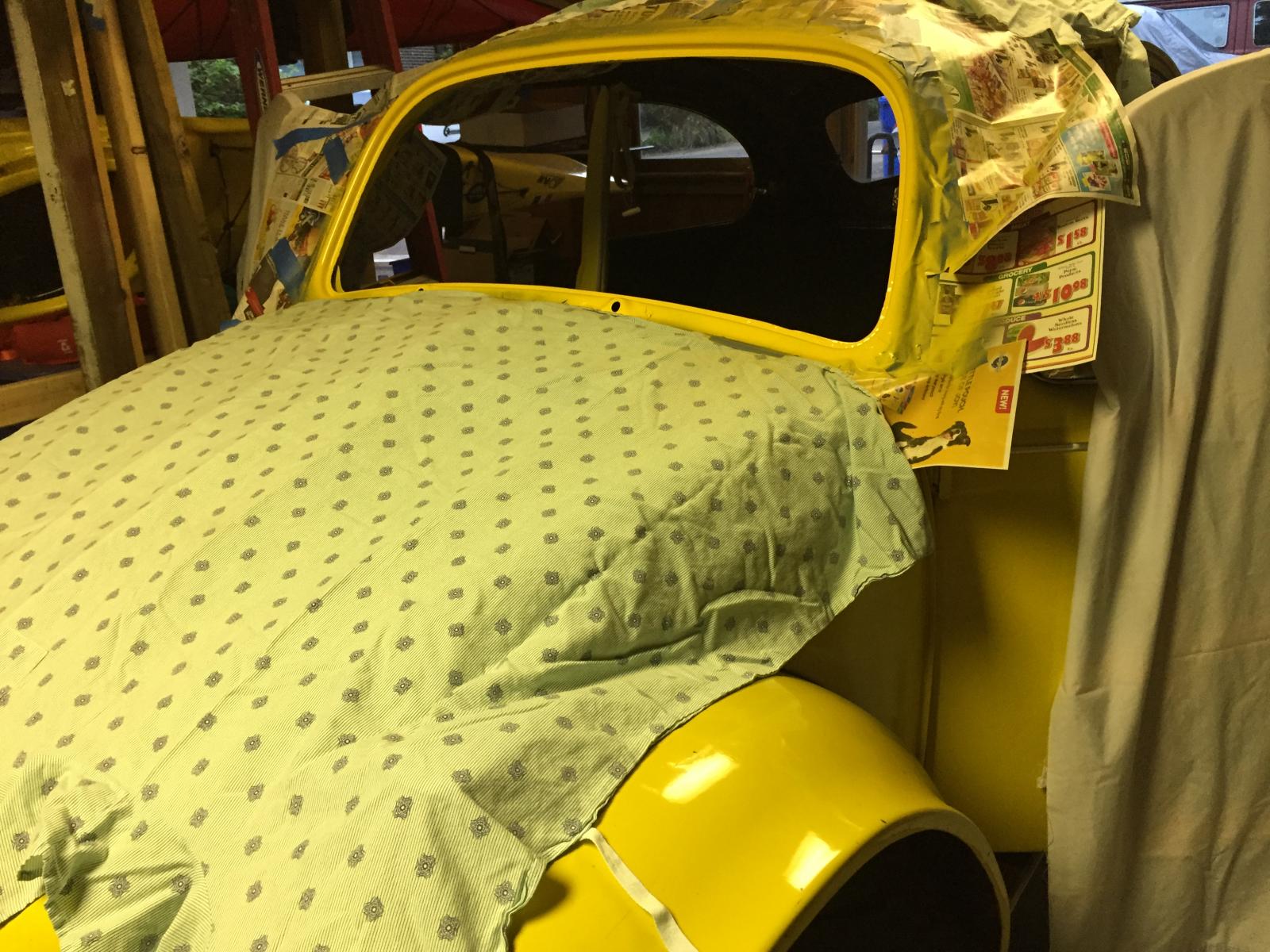

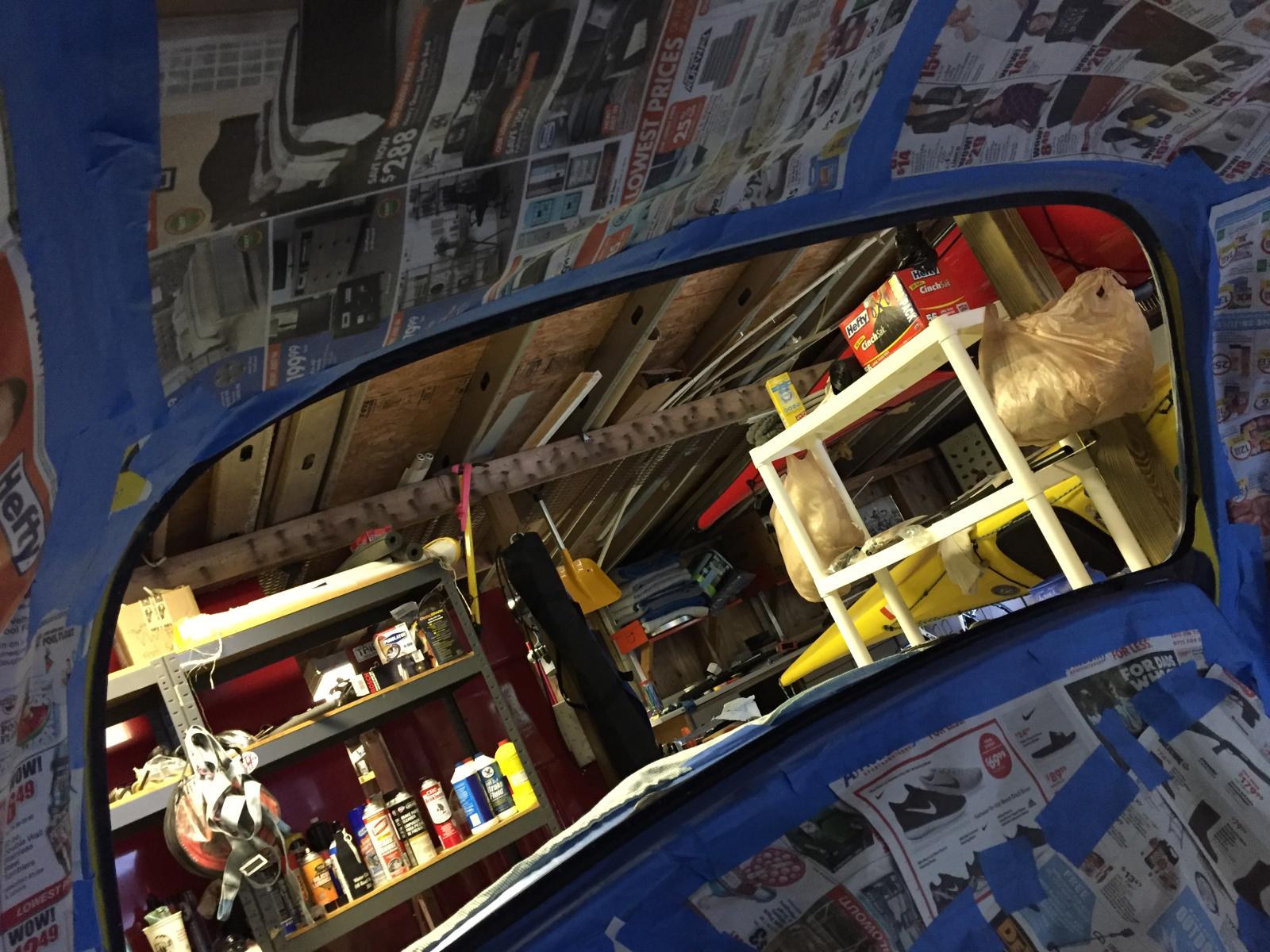

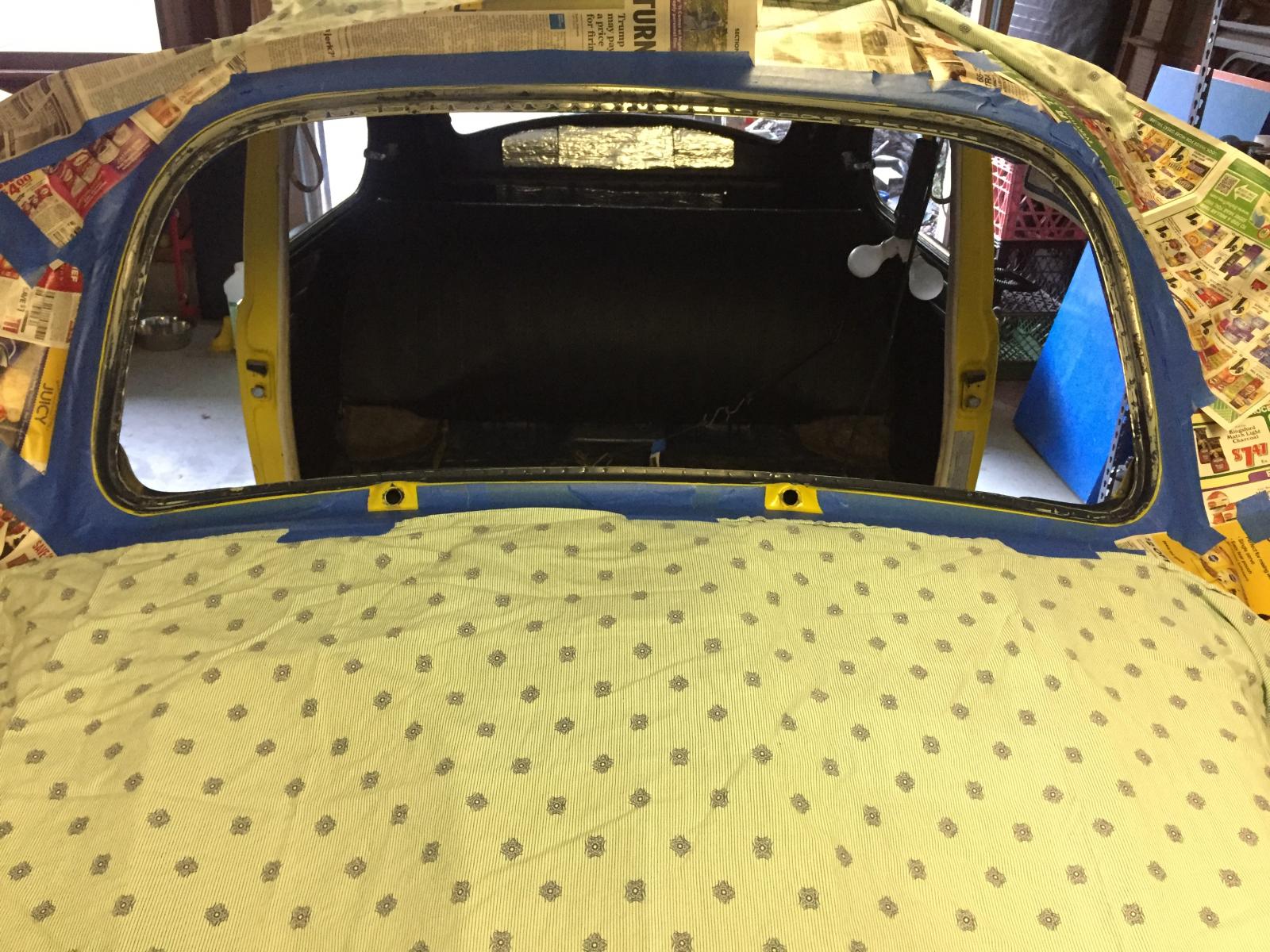

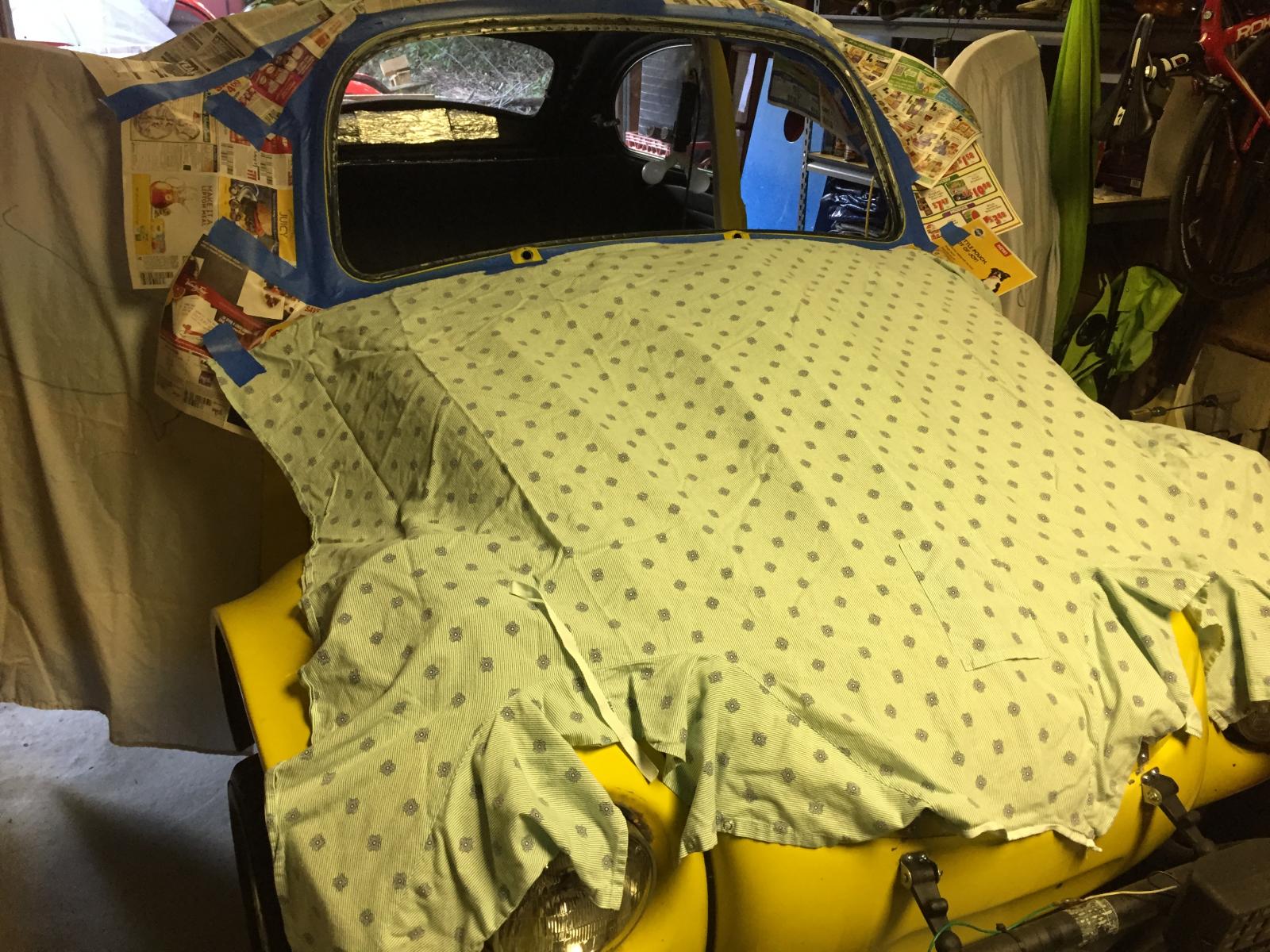

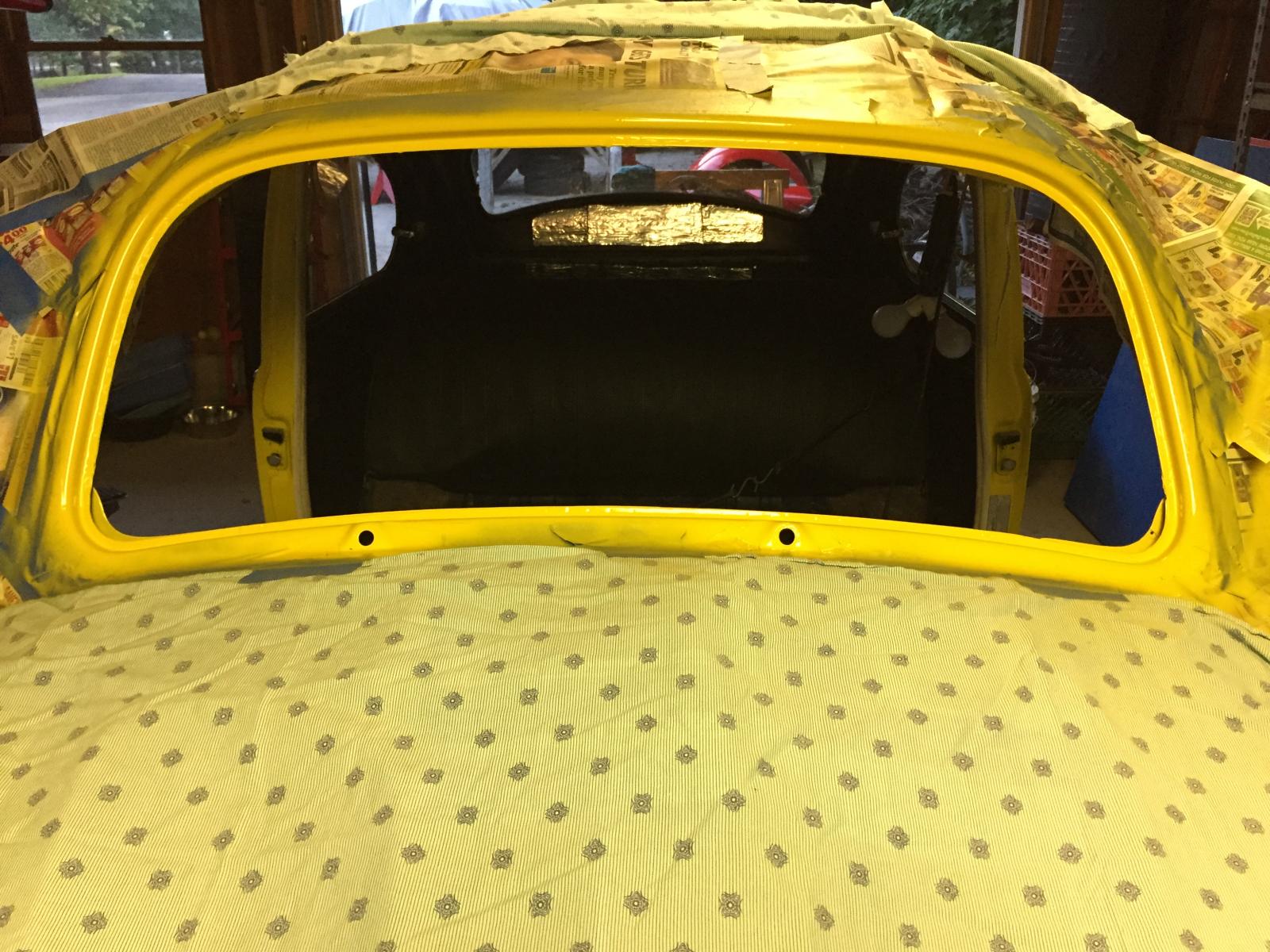

The rust on the windshield frame wasn't bad at all, just surface rust.
So I tried to read up on dealing it's the relatively small amount of rust I had on the windshield frame and decided to go with a product I found at Home Depot that was recommended in a thread about rust removal. I'll have to look at the bottle to remember the exact product name but it was phosphoric acid if I recall correctly.
After sanding as much as I could remove, leaving only a slightly dark area in the metal, I applied this product to the rust areas.
Then I spent a bunch of time masking the windshield frame.
Yes, that is a hospital gown on the hood.
Shot two good coats of self etching primer then two or three coats of rustoleum enamel paint.
That's the way it sits now. With little time to work on it I figure it doesn't hurt to let that paint cure for a while. Next step Is stripping the masking. Then I can get back on the electrical system.

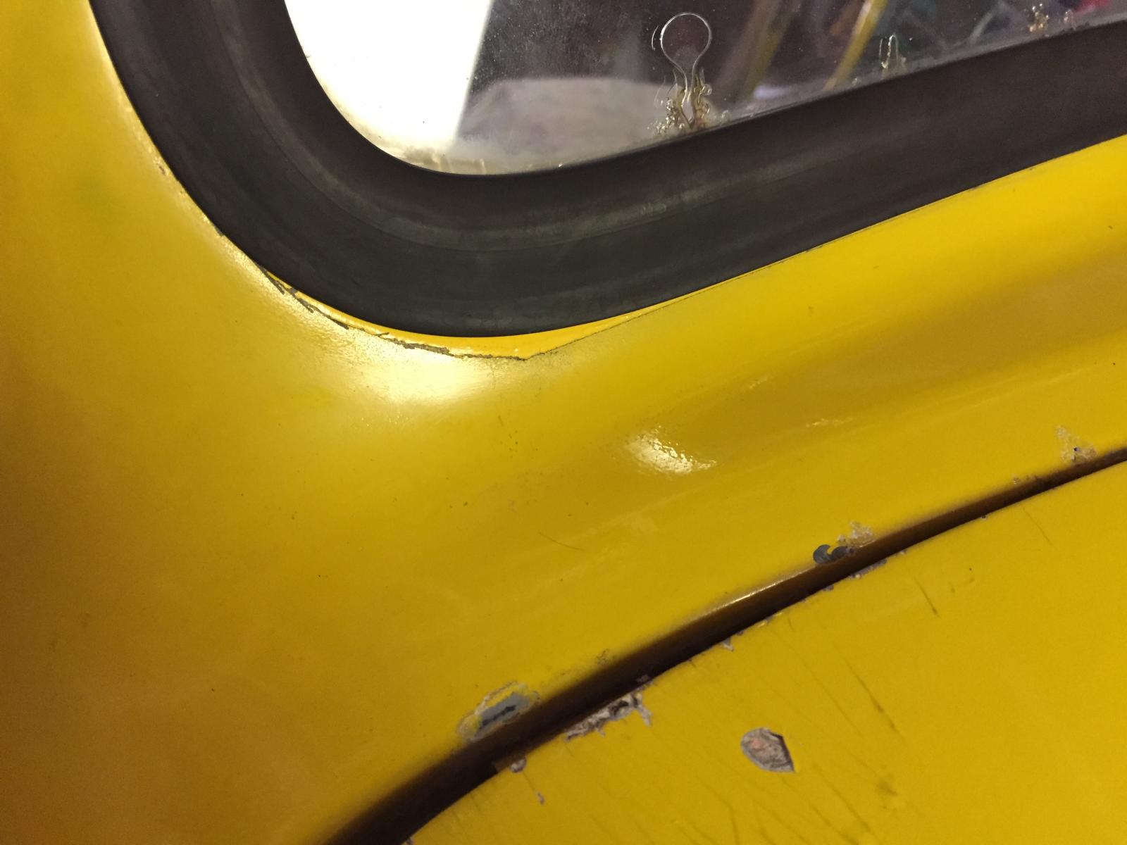

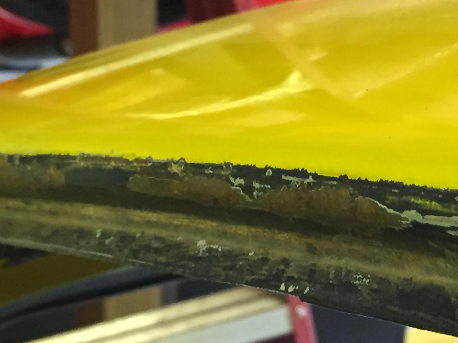

Its been about 3 weeks or so since I painted the windshield frame and tonight I pulled the masking off. Yes, 3 weeks. I did spend two weeks out of town so really I've only let it sit for about a week.... Wink
I knew the paint I had was not a match, but I didn't realize how bad of a match it was.
Thankfully, it looks like it will almost completely be covered by the new windshield rubber, except for the spots around the windshield wipers and possibly on the interior. I'll have to think about what I need to do about that. I was considering adding some black paint for the hood, may have to consider a design that covers the wiper shaft area.
anyway, small but forward progress tonight. Next steps are to install the windshield and finish up the electrical system rebuild. Then I can install the dash.

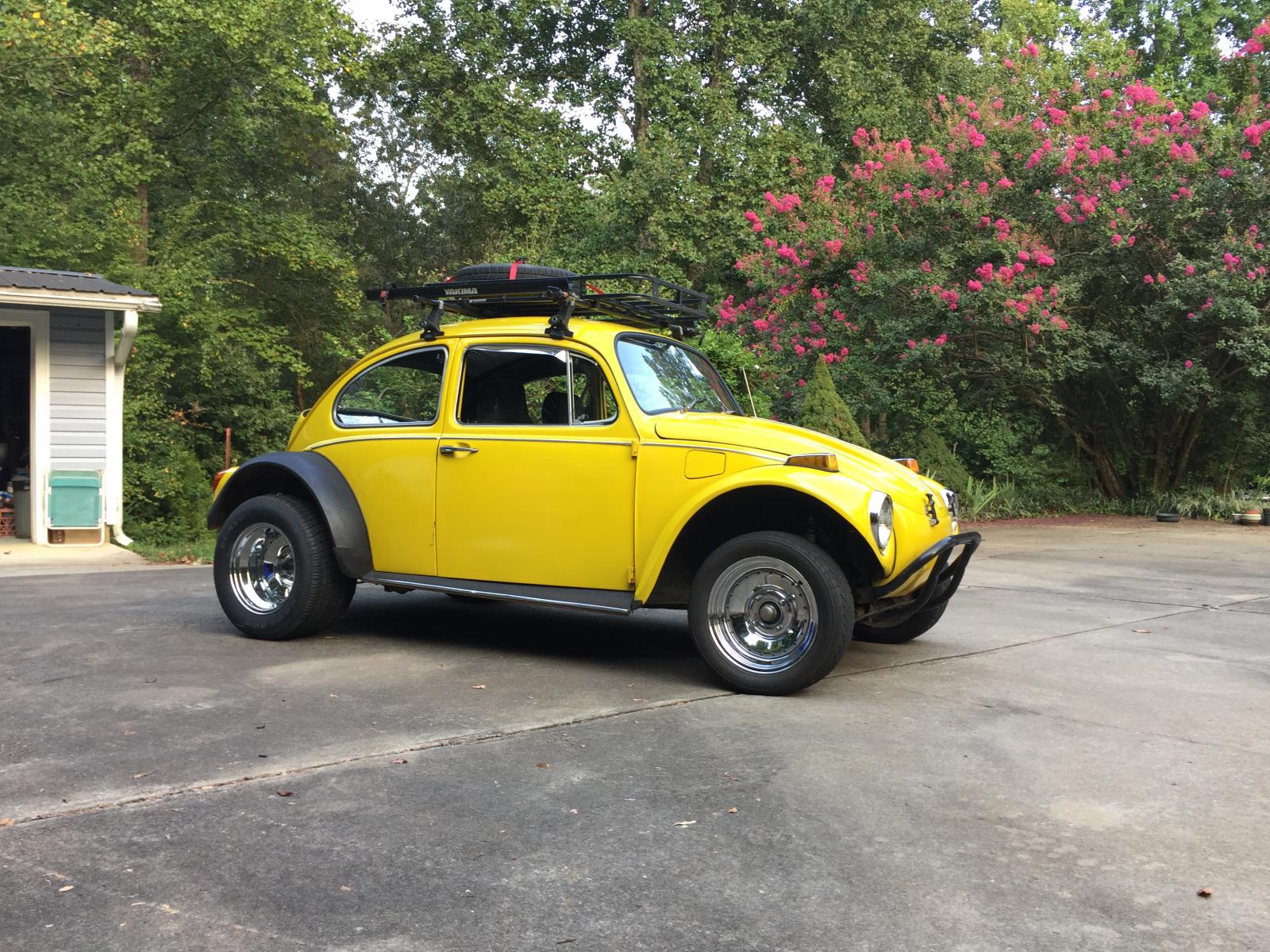

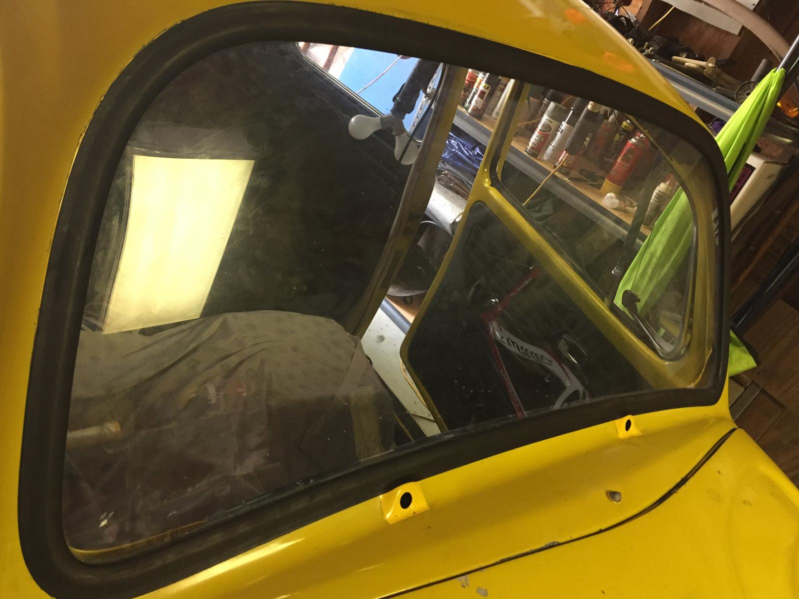

lol, at least someone's watching! Since I'd already started this thread in the readers rides section seemed like the best thing to keep it in one spot as much as possible. Anyway, it's just for me to document what's happening with my ride.

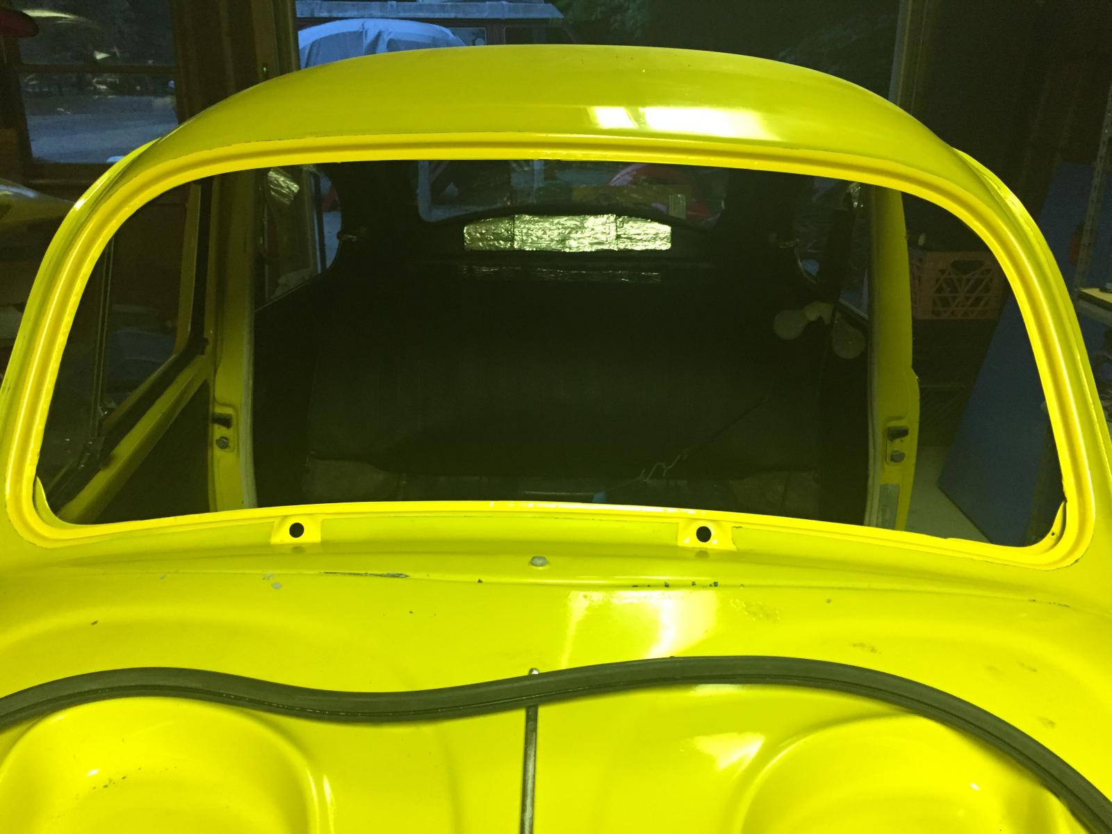

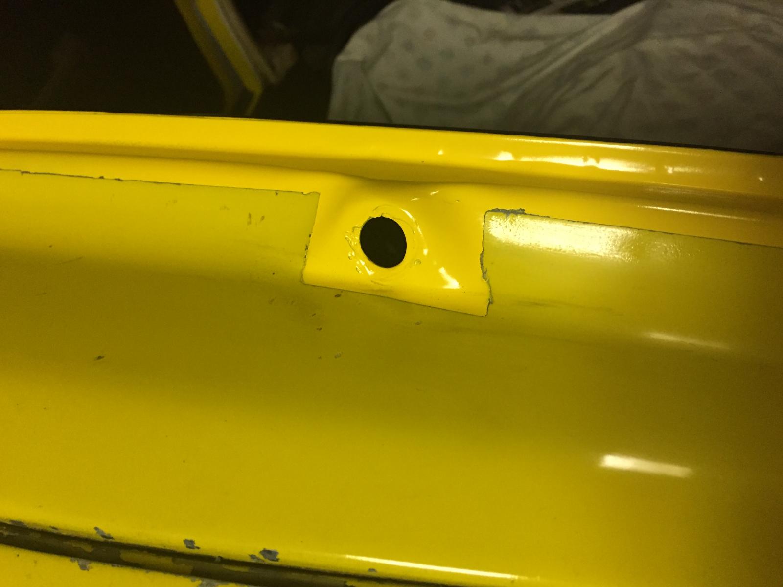

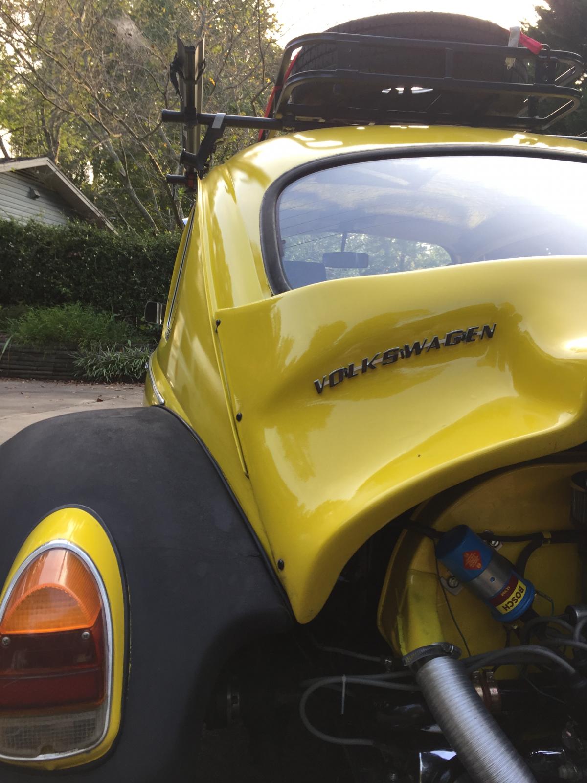

Got the windshield in this weekend. After seeing some of the online vids and reading some of the comments, I was thinking it would be challenging for me to do it by myself. Turned out it wasn't any issue at all.
I followed the recommendations - warm day (hot really), cleaned the glass up as much as I could, stretched the seal over the glass, then put some weed wacker line in the frame groove (along with a little silicone spray to help it on the install).
Once I got all that finished up I put it in place, slapped it around a bit until it was pretty well seated in the frame, then started pulling the line. The only little bit about the line that I realized very quickly was to pull it more or less straight up - with my hand near the windshield. That gave the best results in getting the rubber over the frame.
Easy as pie.
You can see a little of my bad yellow color peeking through outside the seal, but hey, it is now protected from rust. That was the point.

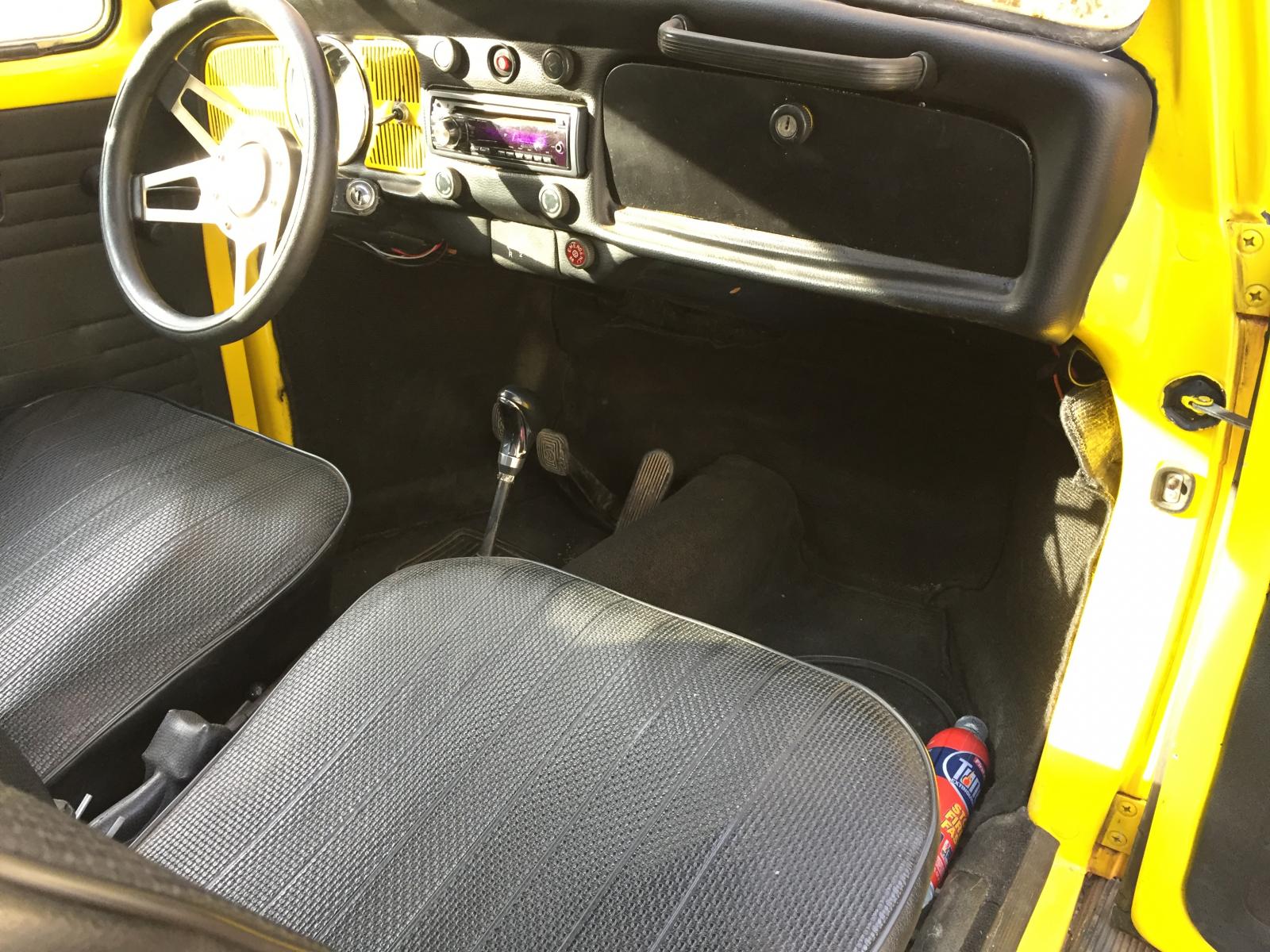

I forgot to take some photos, but I've also got the dash re-installed along with the glove box.

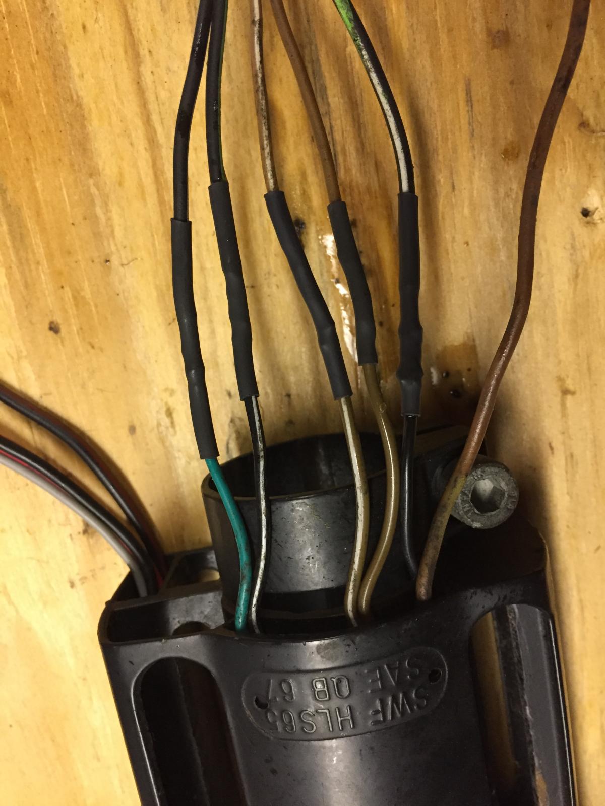

Tonight's little project was to clean up some crimp connectors from the ignition / steering column. I still have some work to do but I need to stop at the electrical supply store to pick up some larger shrink wrap. I'll shrink wrap the wires in the groups like the factory ignition is done. I re-used the wires that were already on there - everything (except the horn) worked previously. The horn didn't work because the connections at the horn were bad. Those are now fixed as well.

The engine is ready to go. After having a bunch of trouble tuning it after I got the long block back from the builder I took the complete engine back to him. I suspected a problem with the carb and after his troubleshooting he determined that it was the carb. He replaced the carb with a rebuild and fired it right up. So, the engine is done, I just need to finish up with this electrical and it's ready to ride! I'm hoping I'll make some real progress this weekend so I can drive it to cars and coffee the following weekend.

PostPosted: Wed Aug 23, 2017 4:14 pm    Post subject: Re: madworks 1970 Baja build thread Reply with quote
This is how she looks tonight. I got the electrical to a point where I could start her on Sunday. Drove her monday night for a short test drive, then again last night. Still work to be done but having a functional vehicle is a big step. I have some noises from the chassis going on and I ran her out of gas last night. Thankfully it was just inside my driveway! Going to put some gas and go for another test drive this eve to see if I can narrow down the chassis noise.
Madworks 1970 Classic Sedan http://www.thesamba.com/vw/forum/viewtopic.php?t=668073&highlight=
Madworks 1980 Vanagon Westy
https://www.thesamba.com/vw/forum/viewtopic.php?t=672496&highlight=
madworks
Joined: November 09, 2016
Posts: 118
Location: Greenville, SC
madworks is offline

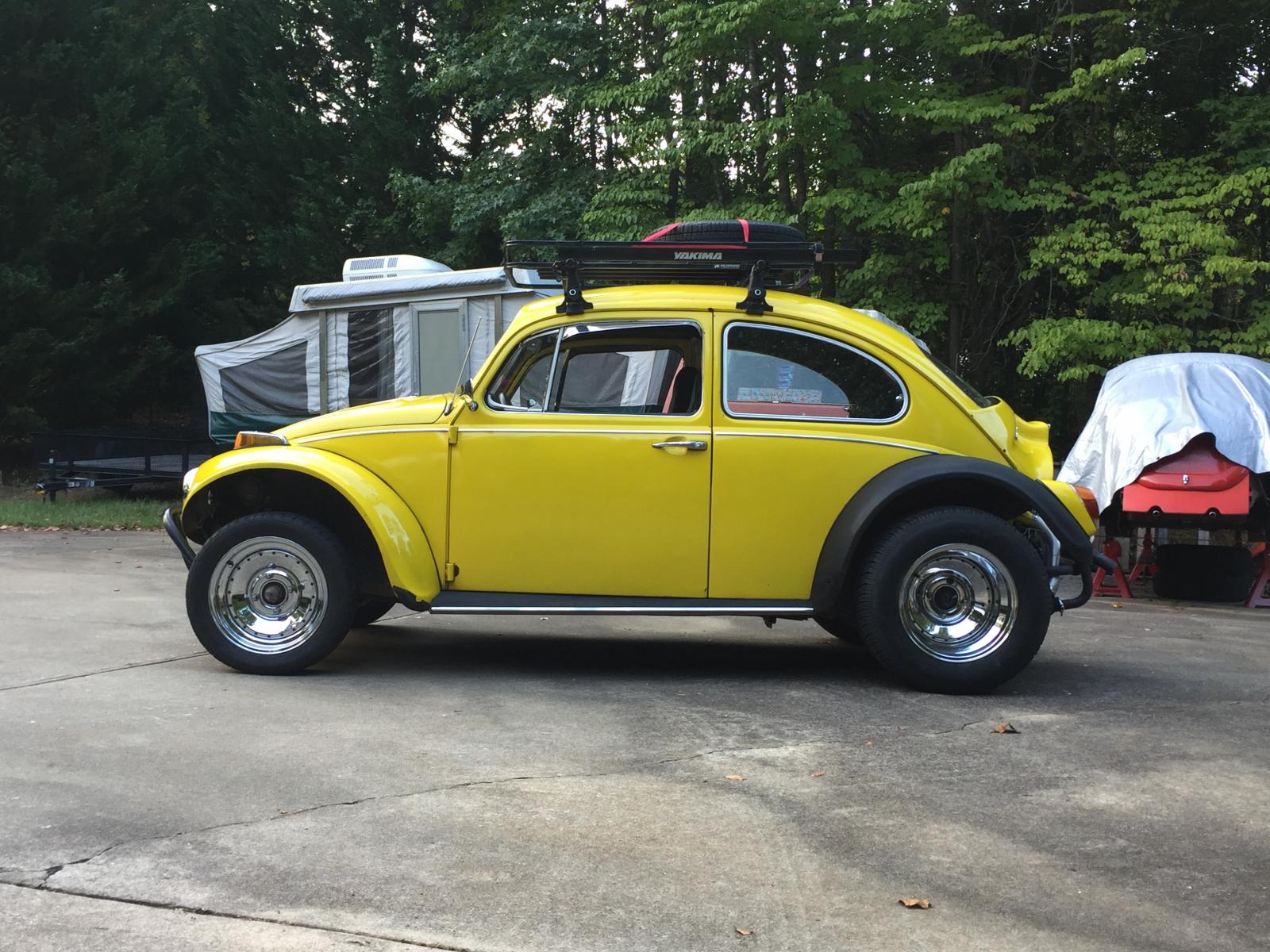

PostPosted: Sun Aug 27, 2017 5:43 pm    Post subject: Re: madworks 1970 Baja build thread Reply with quote
The test rides have gone well. Drove her to work on Friday, then all the way to Vee Dub Oasis in Travelers Rest after work. She's running well. Chassis noise seems to be diminishing and only happening at full turn.
I'd wanted to take her to Cars and Coffee on Saturday and I felt good about driving her so there she sits amongst four other classic beetles. She's the only Baja and the others are very nicely restored while she is more of a preservation. Hey, I didn't care, I'm driving!
Today I decided to work on some of the details that still need to be finished up. One item is the Volkswagen badge on the back. I colored the letters with a sharpie just to see how they look in black. I may just have to paint it.
I also installed the windshield wipers and the chrome trim rings on the headlights. When I paint the front fenders black, the trim rings may get painted yellow along with the turn signal housing. For now the stay chrome.
I also installed my Yakima rack with the Wilderness Systems basket. That was a very cool part of my Wrangler that I decided to keep after selling the Wrangler. Glad I did, it looks good on the Baja.
I also had some carpeting coming unglued inside the car. Bought some spray adhesive and now that's all squared away.
