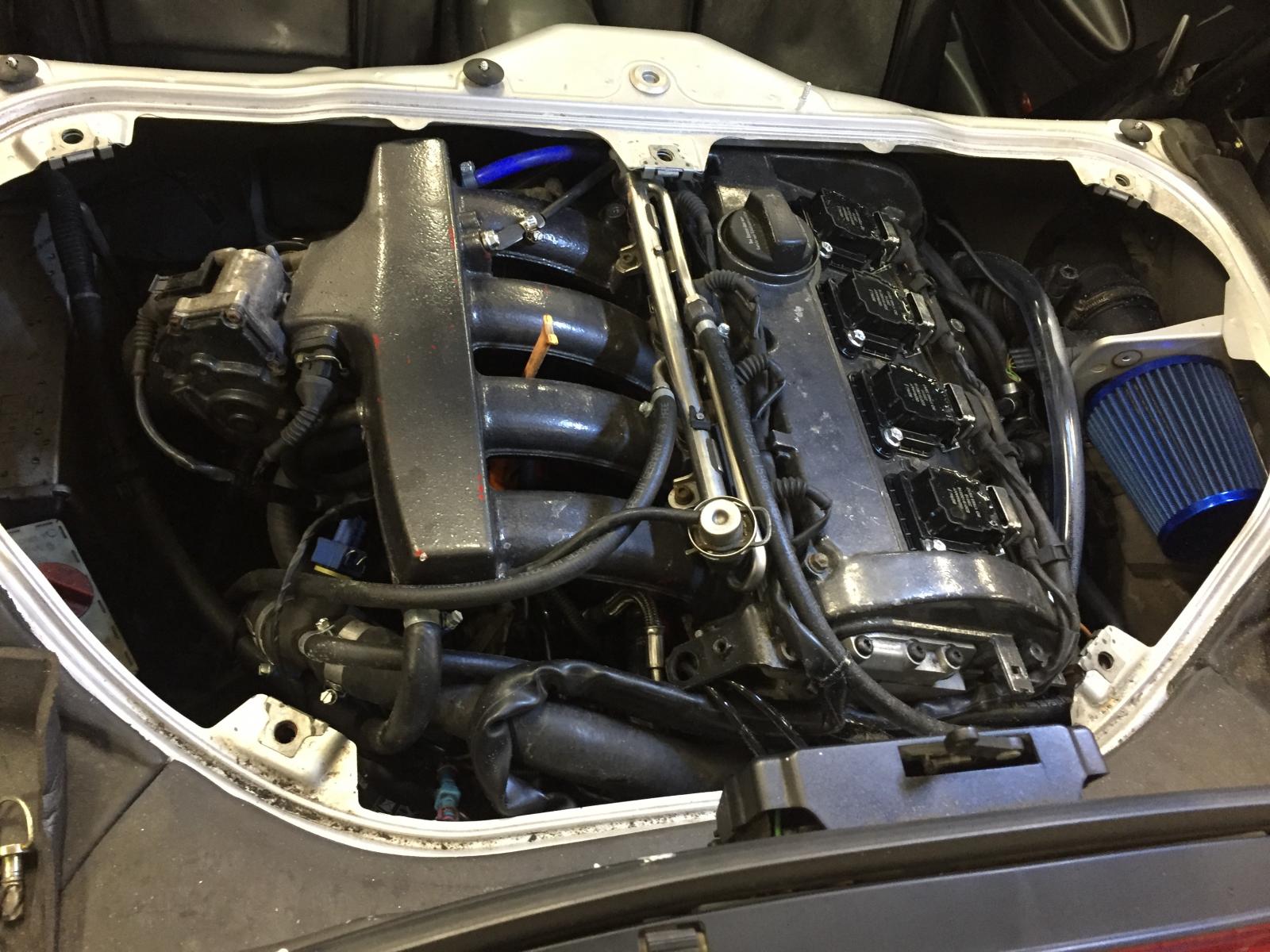

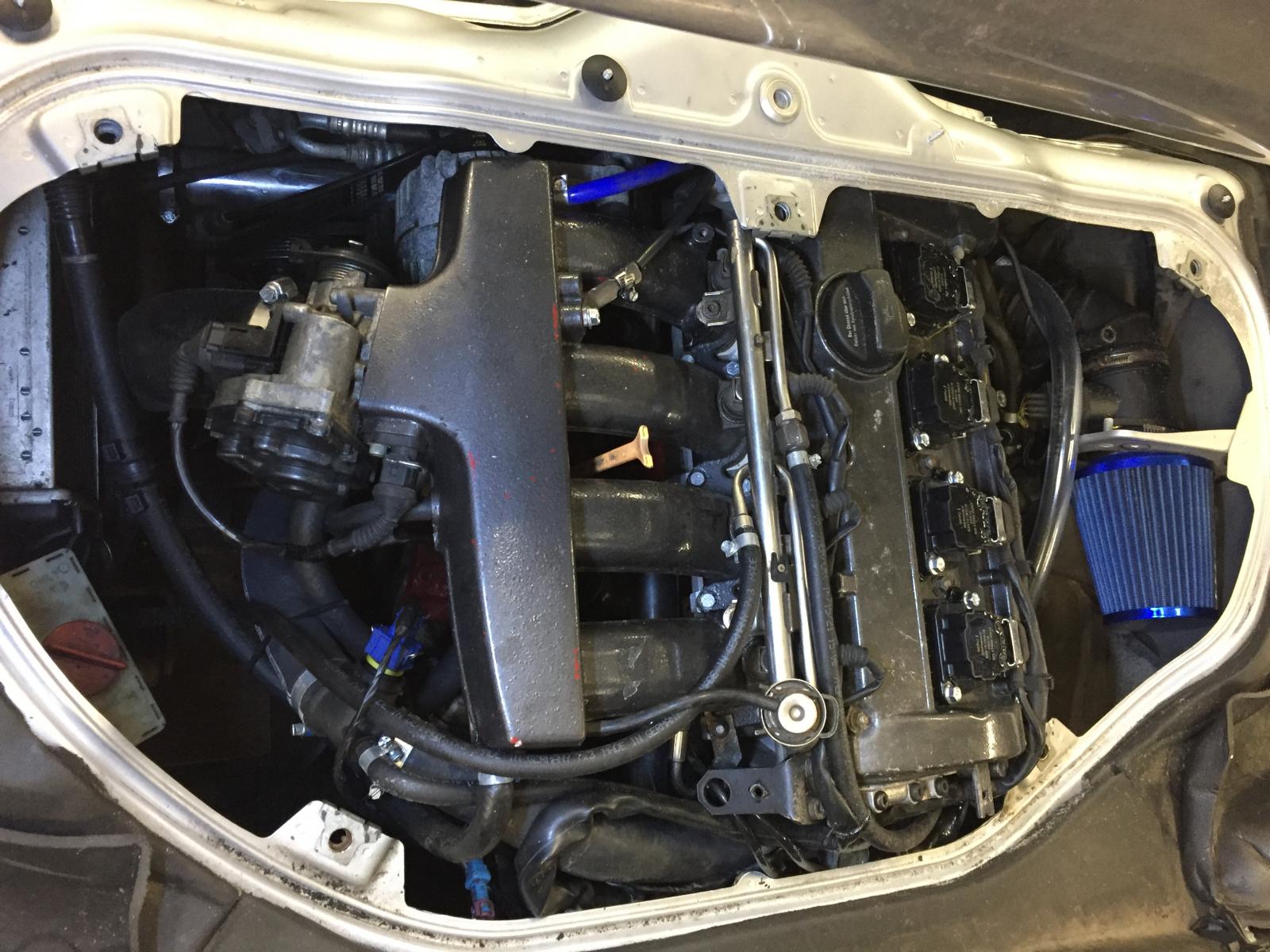

Hey guys, how about an update for those that are following.
The Boxster sat untouched for over a year. I had a very busy year building a new house on top of a mountain. I moved into it in May and am enjoying the off-grid life. Last week I found some time to bring in the Porsche and put some more time into it. When I had last worked on it, the engine was in and mounted and would yard drive but had not road-tested.
I had to put a bulge in the rear engine cover to make it clear the engine. I got all the intake lines and hoses hooked up, neatened up a lot of the wiring, and finished up the cooling system. I then got to finally take it out on the road for that long awaited first road test. It was very rewarding, the car feels very nice. I'm running an APR tune that should bring the power to around 200hp, the stock flat 6 cylinder of the Boxster was 209hp. The new engine reduces the weight about 150lbs.
Stay tuned for a video coming soon........
