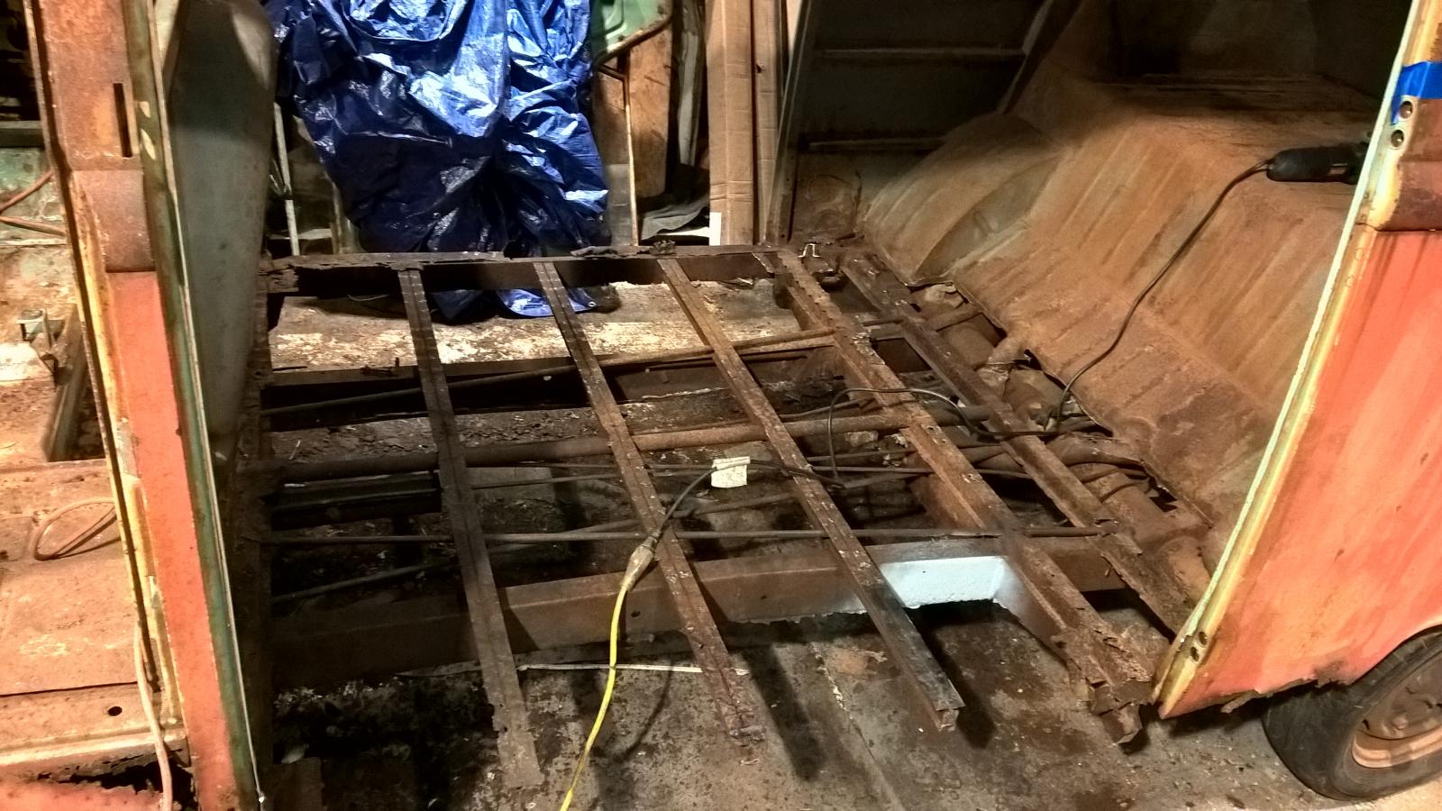

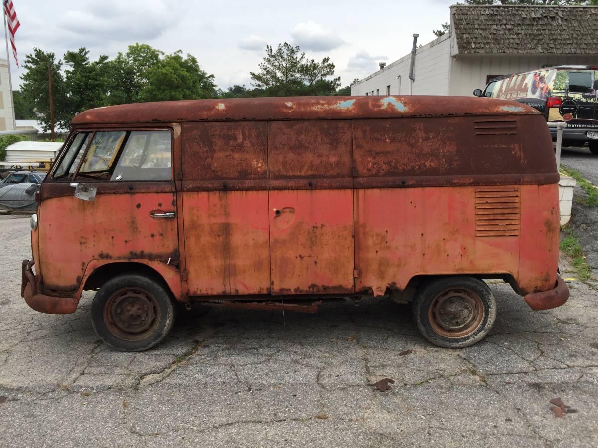

I have owned 58 cars so far and #59 is a project my wife suggested. Its a VW split window bus. fresh off a 3 year restoration of a 74 MGB http://www.mgexp.com/member/chgrec#journal I just sold, my wife wanted me to do a VW bus and she specifically suggested a split window because of the look. Since I love my wife and she is much smarter than I am, I agreed.
So I begin with a double door van....One because I could afford it and two because it lends itself well to the vision my wife and I have toward the end result. That end result I'll share later....
For now, I'll share the starting point and try to post as I go forward. I had a blog on the MG experience but didn't see blog spot here so a new topic seemed to be the best way to share this journey. I love to work on cars and really love learning new marquees as well as have a respect for the engineering that went in to different cars so I will try to stay true to what the original designers thought with a nod to some modern conveniences....
Hopefully I can help others learn as I am sure to learn from others here....
First step, rip the floors....
[/img]

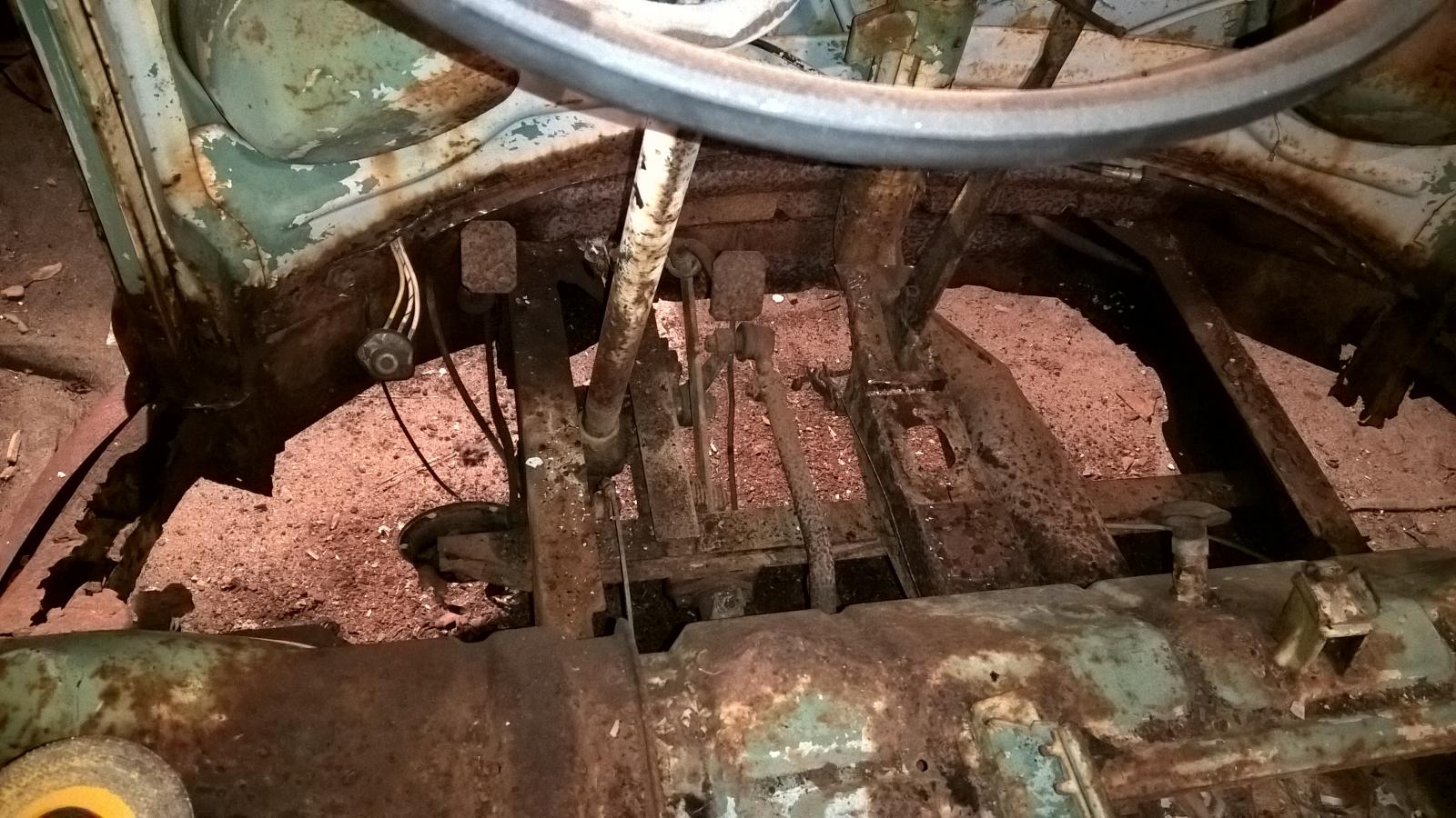

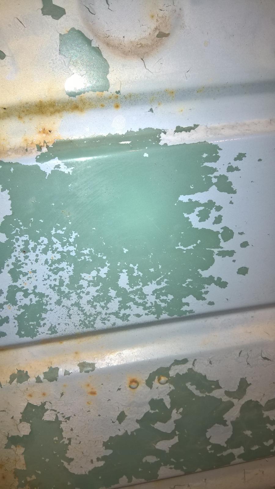

I am indeed going to paint it as its original color was a very nice green. L380 Green according to the M plate. It will take me a few weeks to get all the toasted metal off the bottom half of the bus as I only work on it a couple hours each weeknight.
I have ordered a variety of initial replacement steel bits from a variety of places (Wolfsburg west, bus depot, Klassic fab) so I can get a feel for each place's quality & ordering process.
I am amazed how rusted the nuts and bolts are though not really surprised given the appearance. I have had to cut a few off but many are breaking free after soaking in PB blaster and hitting it with an air wrench. So back to the cutting and now it's a Flintstone bus.

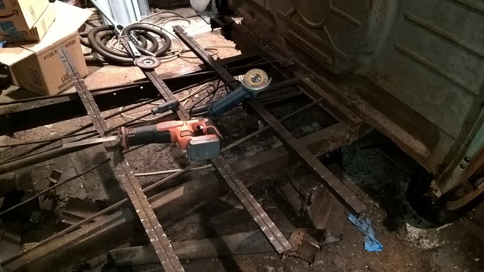

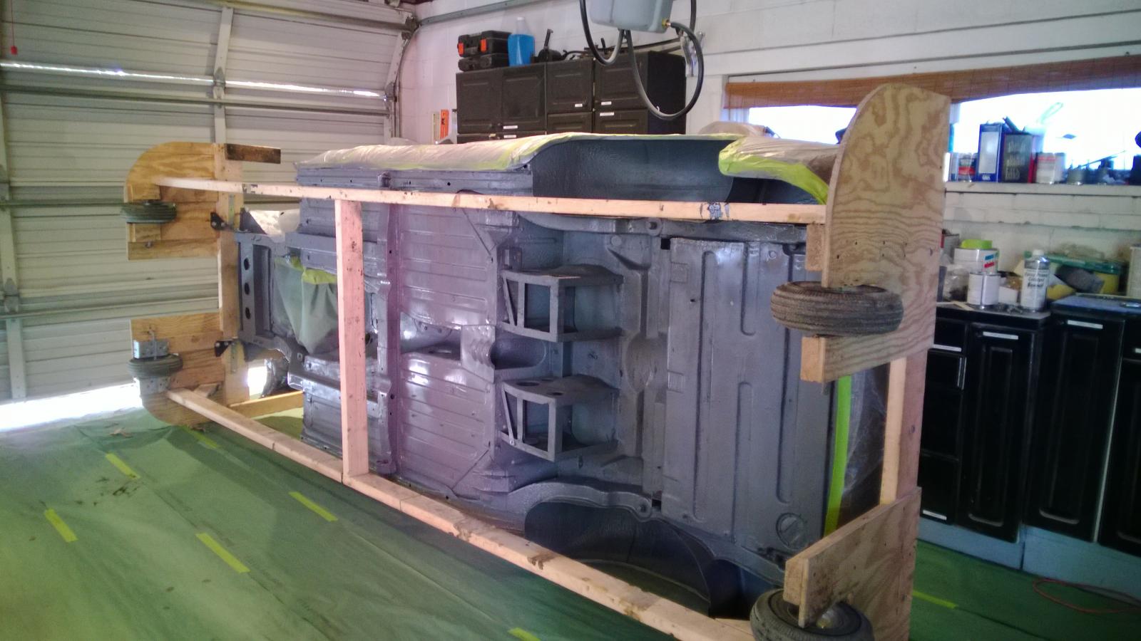

Working my way through it still....Yeah, there's a little rust...I got all the doors off though I had to drill a few screws. I figure I'll leave it on its suspension for now, at least until I get the structural bits replaced. I may also weld in some re-enforcement to keep the "frame" straight and true. Seems that's the only part that's not rusted and Id hate to goof it up but twisting it before its ready.
Then I'll see if it will fit on my home made rotisserie I used for my B. Might only need a little tailoring to fit.
Got some of my first replacement metal today and more is coming tomorrow.
Should keep me busy through the holidays!

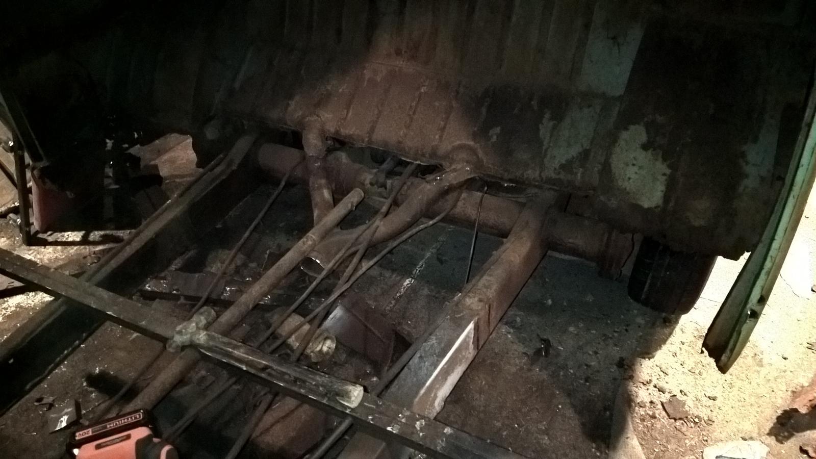

Thanks for the kind words. I am motivated to get this done in much less time that the MGB took. I got some of my new metal yesterday, very exciting to see what it should look like without all that pesky rust. Hard to make much progress this time of year with all the Christmas events, family things and church stuff but those are priorities.
So slowly I cut, bit by bit....

Maybe this would be a good time to brace the body some like you mentioned? With as little of floor as it had before though, I'm not sure if it's going to make a difference if it's not going on the rotisserie yet. It may have twisted some already over the years if it was going to.
You may have to just figure out what the measurements should be so the doors and everything line up right when you weld it all up. I'm no expert on metal work but I'm sure some others (and old threads) can give you good advice on this if you need it.
Were there any signs left of the belly pans or were they totally rusted away?

Bracing is the next step and I have found some detailed dimensions here and on other sites that I'll reference to make sure its all lined up properly.
The doors, as rusty as they are, all closed with good gaps so I am pretty confident its still "square". I figure as long as I keep it level on the floor and on its suspension, I should be ok to weld up the bracing and then roll it over....
My theory will be tested when I put it all back together!
Chris
Edit: And I missed your question....Yes, the center belly pan & the passenger side were both intact and attached. Not salvageable but intact. The driver side was 1/2 gone...
