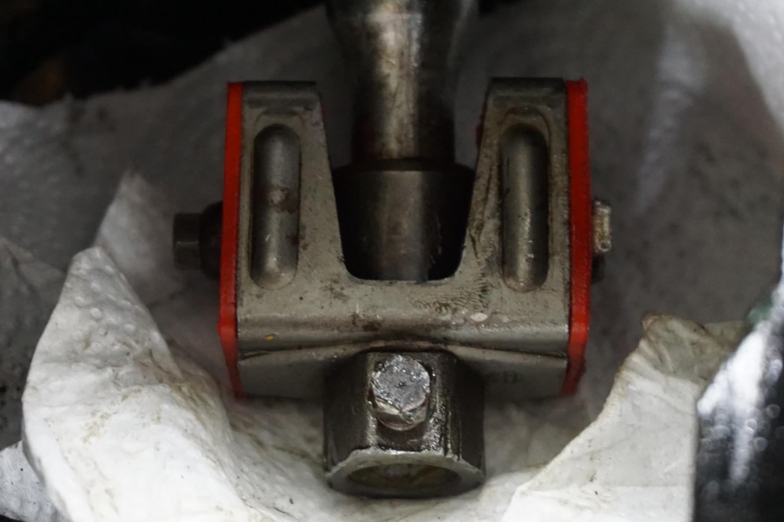

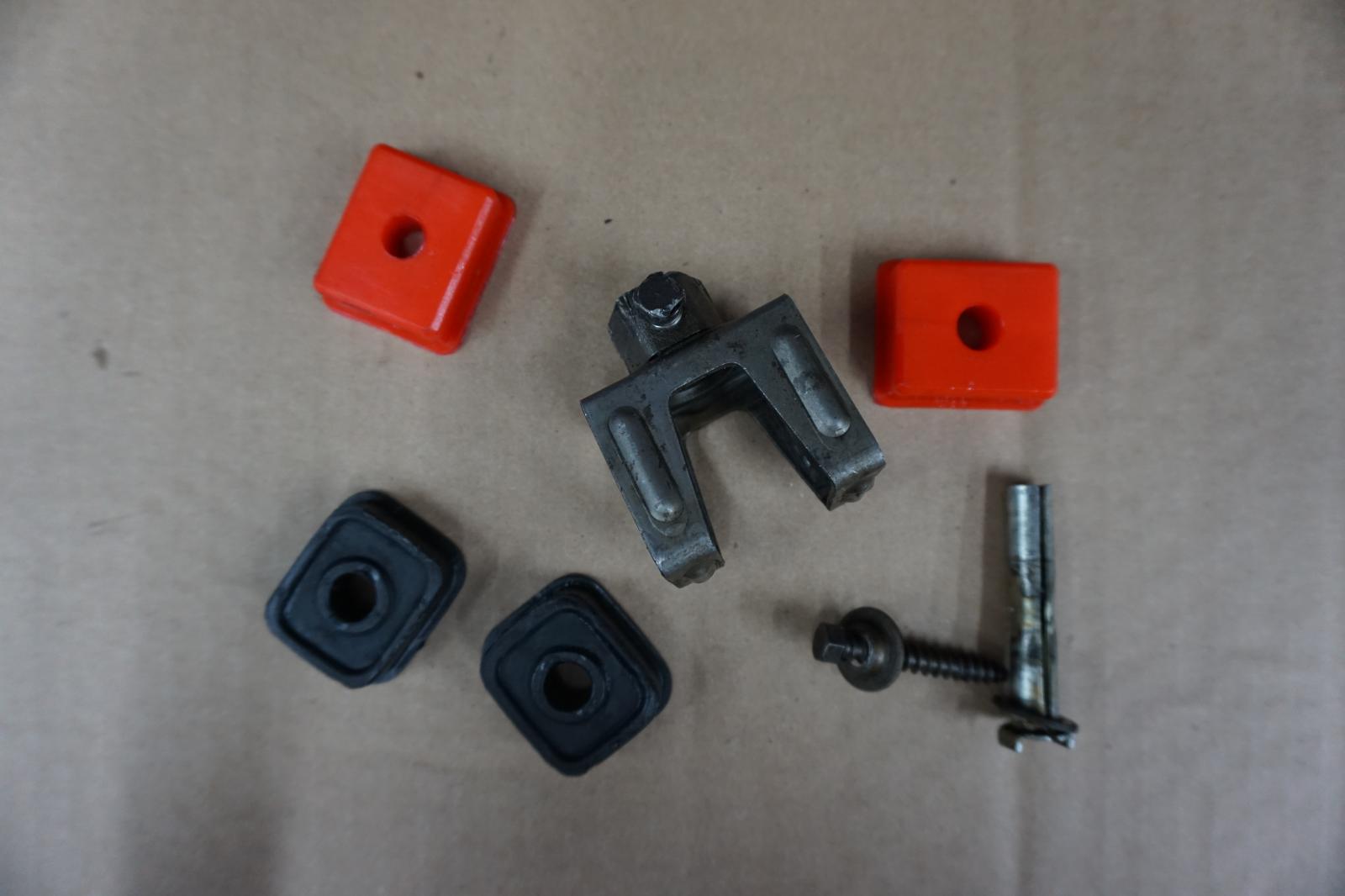

I found urethane in wide use and the oem rubber types are hard to find unless you want to buy an entire coupler.
I measured both my old rubber ones (original VW) and the Empi 16-5104-0 urethanes. There is a slight dimensional difference in the thickness.
OEM:
Overall thickness 12.9-13.7 mm (variation due to worn spots)
Flange thickness: 1.5 mm
Empi:
Overall thickness 12.8 mm
Flange thickness: 2.1 mm
Despite the differences, the urethane still had a snug fit on the shift rod.

Thanks for the pics answered a lot of questions. I think the coupler is my problem everything else seems ok i.e. shift rod bushing and everything in line with that.
