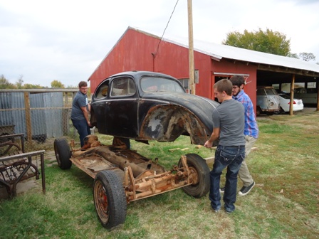

... I have a friend who is a mechanical engineer and performs the simplest tasks using his complex mind, to make things work. Most methods he employs really impress me though, but is not the way, I would do it... That's okay as there are many ways to approach everything... my simple mind just lifts things up.
Looking forward to see what you come up with.
... when working alone, I use jacks, 2x4s and pedestals and slowly lift the body off. When it's at 24 inches, I remove the wheels and slide the pan out, pulling with my single cab... then slide a pan in and lower everything. I have always installed an engine at a later time...
strait up, off and strait down on... but more than one way to do everything.

... yes sir, 24 inches from the ground, with the wheels off will allow the pan to be slid out... and no angle is considered for my simple mind... just strait up and strait down... then, nudge the body around, until the mounting holes line up.
I rarely can muster 4 helpers and do most everything utilizing the solo
method.
... below see another solo method, I tried... jacking the body up a little and sliding it off. Man, that was cumbersome and not efficient (to me)... just goes to show, there are more than one way, to do everything... I did it, but not recommended.

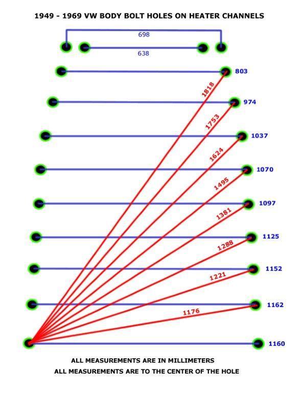

I don't if this will help, but here's some dimension info that was posted a while back here on Samba:

Great pics! However, the first seem to be a 1958-1964 body?
Could be, I didn't look at the pictures closely, but I thought they might be helpful as a starting point for you.
