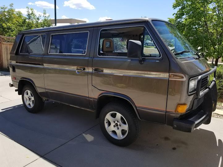

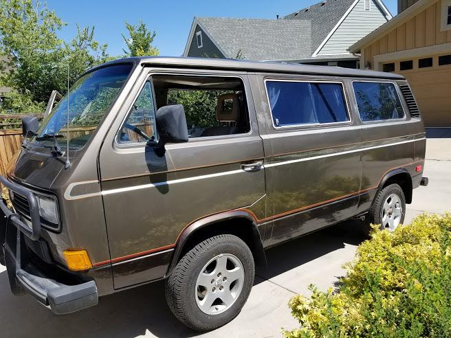

Here we go. I picked up the van from RMW on Friday morning. Mike was his usual outstanding self in getting everything ready to go; I ended up with a completely rebuilt front end, cooling system, tires, and new brakes all around, as well as a repaired speedometer, new rear spring perches, and a few other items. I also left RMW with some fantastic goodies that I'll install later.
The van drove very well back to Denver, but LOUD. The exhaust will be dealt with later today. I hate sounding like a ricer.
The purpose of this Syncro is to be an around-town minivan for transporting kids and gear as well as a weekend mountain goat. My 2wd will still be the camper and tailgater, but it's going to spend more time in the garage.

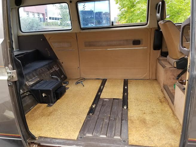

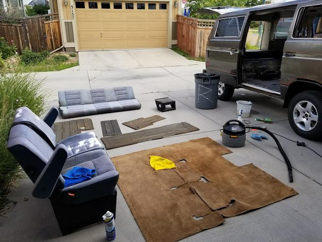

The first thing to do was clean it up and see what I'm dealing with.

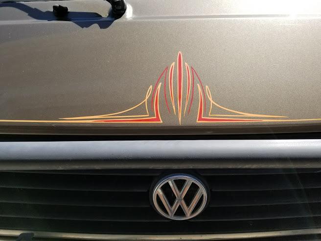

Tramp Stamp which, according to unbiased onlookers, resembles a feature of the female anatomy. While I strongly disagree with the exterior styling, I do appreciate that the previous owner obviously cared about the van and spent good money customizing it as he saw fit.
Gigantic Blaupunkt stereo (broken). If it was operational, I might have tried to save it. I'm also not a fan of the shift extension, so it went as well.

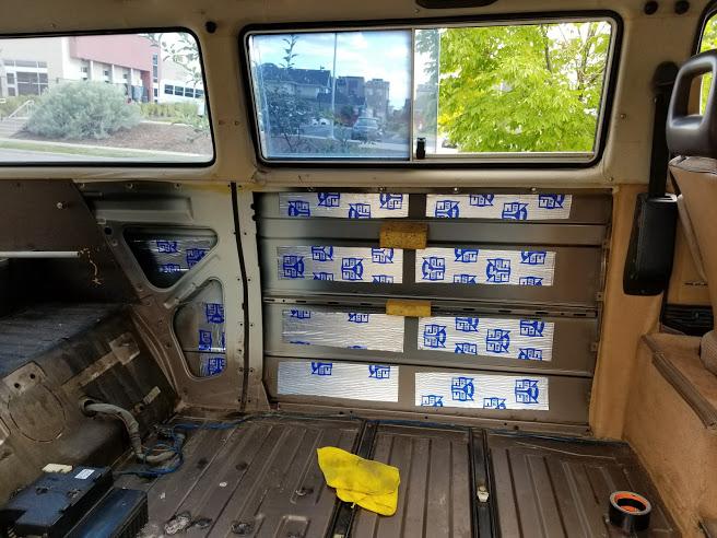

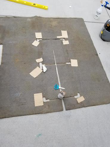

Everything came out, and props to somebody here who recommended diluted bleach for the floor underlayment. Lots of cleaning, scrubbing, and baking in the sun.
The interior smelled like a combination of piss and mouse. I can only assume that it's dog piss, because if it was cat piss, I wouldn't have found so much mouse poop behind the panels. Gloves, goggles, mask, bleach, and a shop vac took care of the mouse stuff. I also found two mouse corpses.
According to Carfax, this was a Pennsylvania van for the first 50k miles of its life, so I was concerned with what kind of rust I'd find. There was a little bit here and there, but I was relieved to find very little rust in the bottom of the panels and along the seams. What I did find was cleaned up and brushed with rust converter. After that, I added some sound deadener. I had some Fat Mat in the garage from a prior project, so I used it up before switching to Dynamat Extreme.
The carpet is in remarkably good shape except for a few rips here and there. I'm a big fan of carpet tape.
I found a neighbor with a fresh nose to smell everything and make sure the piss smell was gone; once I got an affirmative, everything went back in.

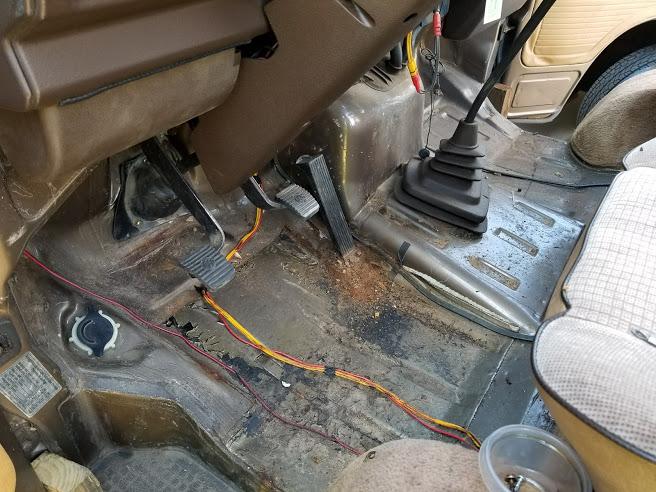

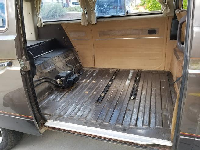

Then I got back to the Syncro. I pulled out everything in the front and found rust around the gas pedal, but not rusted through.
I wire brushed the loose rust out, cleaned everything thoroughly, and applied more rust converter.
I didn't get any more pics of any of this but there are plenty in other threads that show the exact same process. Cleaning, cleaning, and sound deadening.
After that, I repaired the AC tunnel (sagging badly) and called it a day.

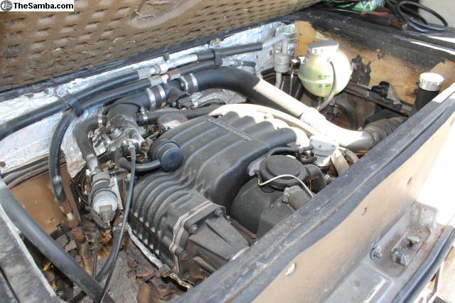

This is an odd setup with the ABA and supercharger. The supercharger seems to be hesitating on acceleration. When it does kick in, it'll snap your head back. It's on the list of things to address, as well as the sorry state of the engine cover set up.

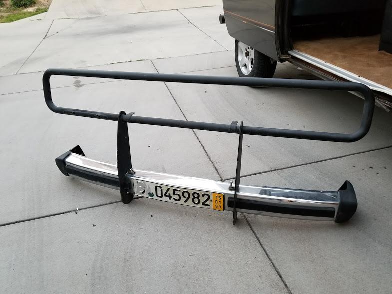

After dinner I removed the big floppy aftermarket mud flaps, and also got the bull bar and front bumper off before the nightly mosquito attack.
Much cleaner. New bumper install tomorrow I hope. I was pleasantly surprised to find only minor surface rust under the bumper; the seam area along the top had already been treated at some point. Progress.

Steve M. wrote:
The guys here are drooling for pictures of the Supercharger! Laughing
It looks good. Congratulations on having it.
Thanks! I'll get some photos of it tomorrow. It is a weird setup. I've been reading up on this supercharger in the Vortex archives, and my symptoms are leading me to believe it might need a rebuild. I'm thinking maybe I'll try maintenance (take it apart, clean it up, change the oil, etc.) and see if that helps.
Here's a pic from the Samba ad:
It's a pretty inefficient use of space as far as the engine cover goes. I think with a little ingenuity I can shave it a couple of inches. Or will a supercharger operate with the engine at 50 degrees?
Edit to answer my own question: There's no way this thing will go in at 50 degrees. The throttle body/intake setup on the back of the motor (towards the front of the van) actually hangs over the top rim of the engine bay. It's hard to see it from the picture, but that back wall with the AC hoses actually extends further into the cabin. I think even with creative sheet metal cutting it wouldn't fit under there.
